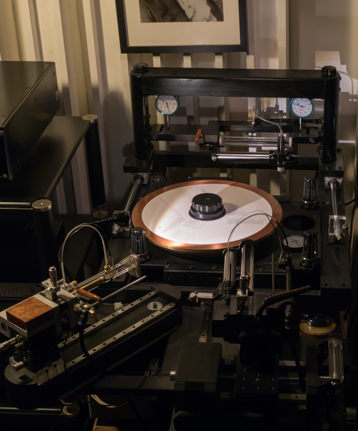

Here is a family photo of all three air bearing arms.

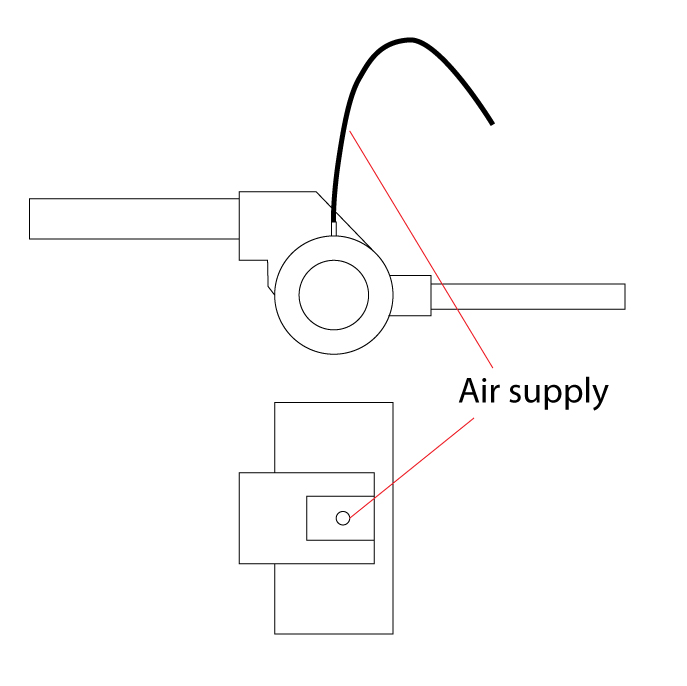

Please see the images. I did a simple sketch to show you the construction of Kuzma arm.

One thing I don't understand...looking at the Kuzma's overall construction, I can't understand how the arm tube is connected/attached to the bushing. There is a structure around the bushing but I just don't get how everytthing is assembled. I was hoping you could light up a bit this for me.

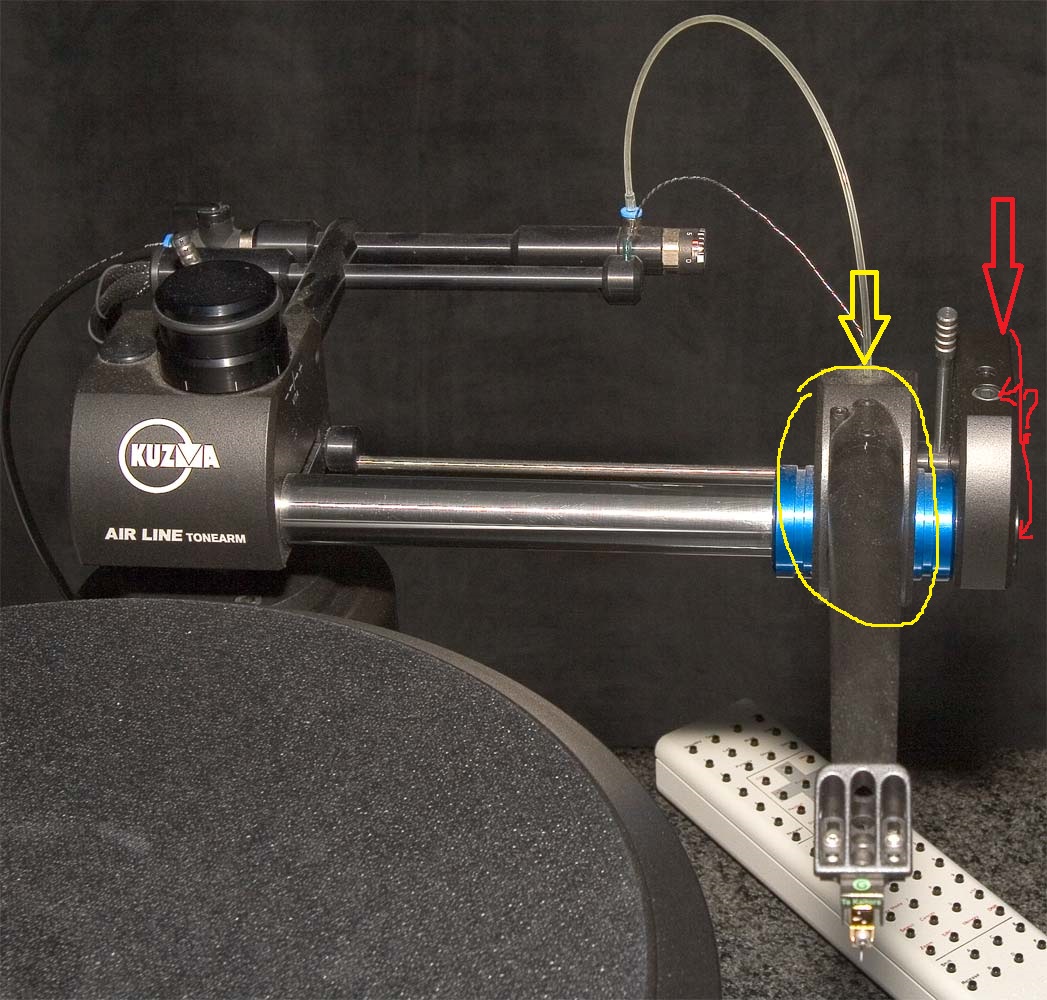

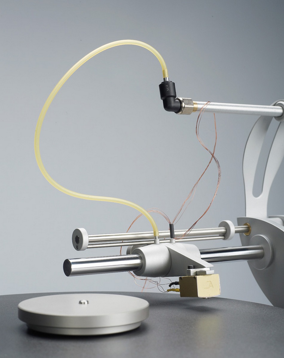

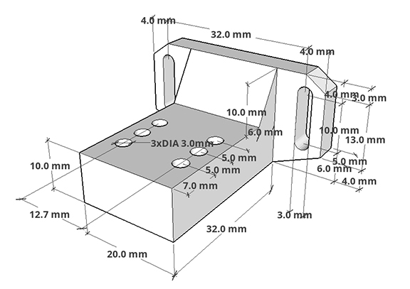

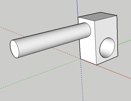

Regarding my question about how they attached the structure that holds the tonearm and the threaded bar for the counterweight around the bushing, allow me to show you a picture. The yellow arrow points to the block around the bushing. Is that a one piece aluminum or two pieces and screwed together? If it is one piece, how do they precisely fit it over the bushing? I assume it is critical to get most centering position, do you need a fixture to perfectly center it?
Moreover, looking at the red arrow: how do they connect the end block to the shaft and secure the rest of the assembly?
The manual says that in order to remove the bushing for cleaning, you only need to unscrew the top screw highlighted in red.
How can that remove the ending block from the rest of the assembly or in other words, secure the structure? I couldn't find a definitive answer by just looking at online pictures and pictures on the manual.
Once I understand how all the parts assemble one with another I will start making solidworks drawing and share them, but first I need to understand how everything connects.

I am not sure how Kuzma did it in detail. However, it is not necessary to do same as Kuzma’s. Here is a sketch of my suggestion for your reference if you want to do long arm wand.
It looks to me just a set screw to fasten the piece on the shaft. Again, I don’t see the need to do exactly same as Kuzma’s. I attached the part on the air bearing by using epoxy. A while ago, someone said it was not elegant design. In fact, I think it is very elegant way to do it especially for short arm wand. It minimizes the distance from LP to the center of bearing and total mass of the arm.

I like the Simon Yorke design I have attached here. My intention would be to make the block that goes over the air bushing a one piece including the shaft for the counterweight in order to increase rigidity.
The problem I see with this construction is that it doesn't allow azimuth adjustment and it needs a retrieving mechanism.
I need to think how to make the arm easily be leveled, adjust azimuth having a solid one piece construction (perhaps impossible? The only thing I can think is the classic headshell attached to the main structure secured with set screws that can be rotated to achieve proper azimuth setting, but this would decrease rigidity of course).
What would you suggest for these features? Once I have in mind how to accomplish I will make drawings for your to critique.
I wouldn’t advise to follow Simon Yorke’s design. It is simply not a good design at all. He doesn’t know what he is doing. Kuzma is the guy who knows what he is doing. So is Walker Audio. V.Y.G.E.R. is another good looking but not a good design to follow. In Michael Fremer’s review, he couldn’t find arm/cartridge resonance for their arm. And, their reaction to Michael Fremer’s review was groundless.

I have two kind structures to adjust azimuth. If you want to buy head shell, I highly recommend Audio Technica Technihard head shell. For me, I use 2024 aluminum alloy for everything touchs head shell. I prefer 2024 aluminum over magnesium and carbon fiber.

I thought you would have liked the Simon Yorke's short arm design.
Why do you think it is not good?

Hi Stefano
When I saw Simon Yorker’s arm first time, I said to myself he didn’t know what he was doing. From the photo, he uses 1/8” latex tubing. Latex tubing’s max working pressure is about 30 psi. His arm uses low air pressure, 22 psi, it is ok. But laying the tubing in such fashion won’t help. I have tried many different tubings including latex, and many different tubing arrangements. Hanging the tubing high won’t help. It will make thing worse. To use wires like his is completely unnecessary. The air bushing should be close to the surface of LP as much as possible. I checked his web site. He sounds like his arm needs to be adjusted all the time. In fact, a well designed air bearing arm doesn’t need this much of adjustments at all. The only reason an air bearing arm needs to be adjusted all the time is its poor design. I don’t know what he is talking about on his web site. I don’t like his headshell design either.

5, I use two slots to attach headshell. So, if you change cartridge, you can adjust the gap between LP and air bushing. This gap should be as short as possible. Mine is about 5 mm. The two slots can be used for adjusting azimuth, too. Please see the image.
