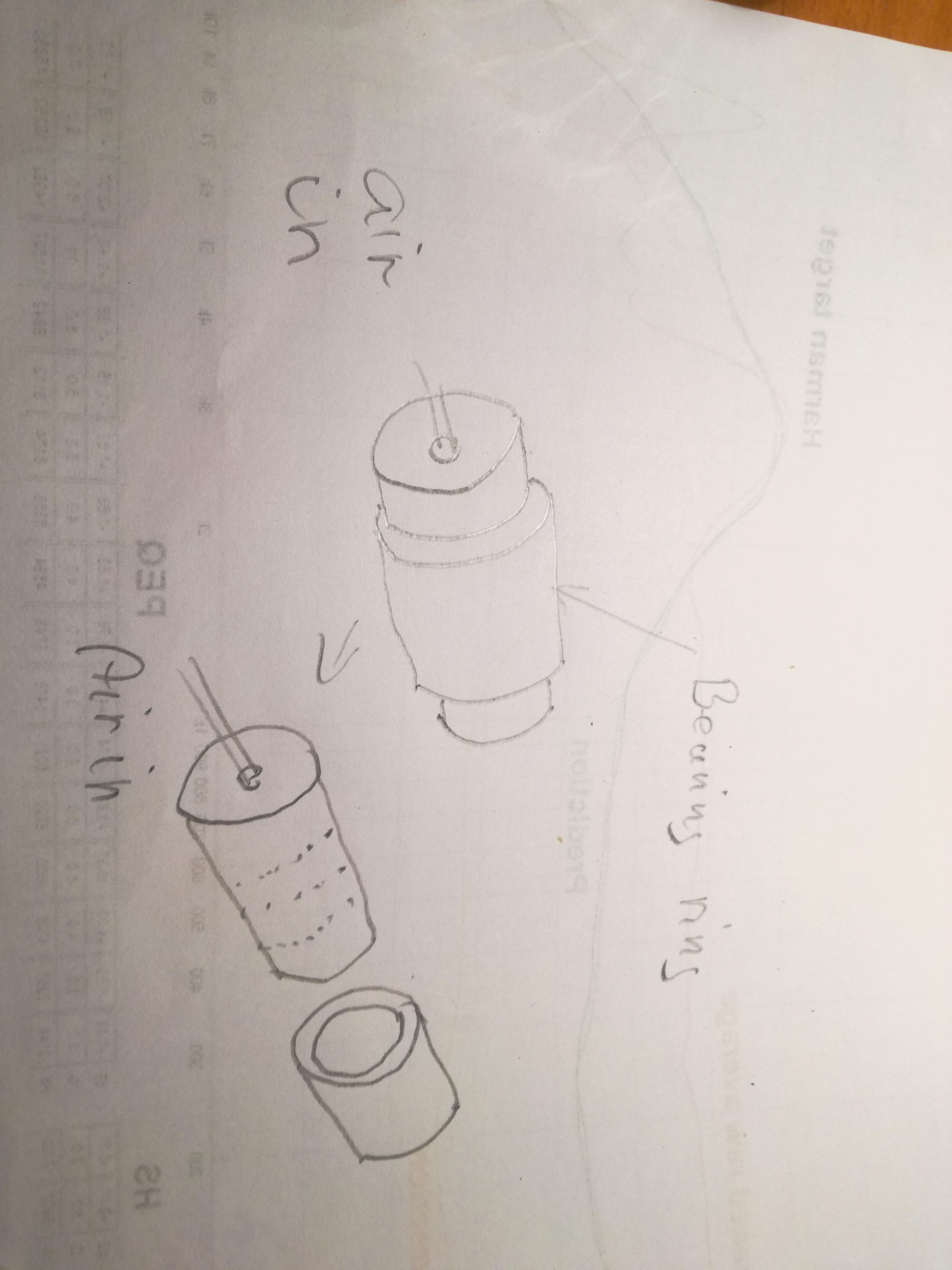

By the way , when it comes to air borne tonearms, I would, if I had the skills (or had a mechanical workshop with skilled people in ) do it like this.
The air bearing should be inverse , that is hollow axle with small holes and a solid bearing. The movement of the bearing should only be ,say , 10 mm so it is in fact a closed high pressure bearing. You then move this bearing across the record surface, if you want a short tone arm or alongside the platter if you want the center of the bearing horizontal with the stylus. All the mechanical items for making that movement (stepper motors linear bushings aso. ) and the electronics to manage it is easily obtainable these days with all the CNC , plotter and 3D printers made everywhere. This was not the case when the first air bearing and roller bearing emerged many moons ago.
This kinds of air bearing arm does exist. But it can't work with high air pressure. Higher air pressure means stiffer bearing.

As I see it it can work with the same pressure as your arm. It is not a Forsell type of bearing I am talking about. No air holes outside the bearing in my idea, therefore the restricted movement.This kinds of air bearing arm does exist. But it can't work with high air pressure. Higher air pressure means stiffer bearing.
Jim
Really, this is something new to me. Would you please let have the link so I can take a look?

What link?
I have attached a very quick an dirty drawing of the inverse air bearing. The ring never comes outside the area with the holes in the shaft.
