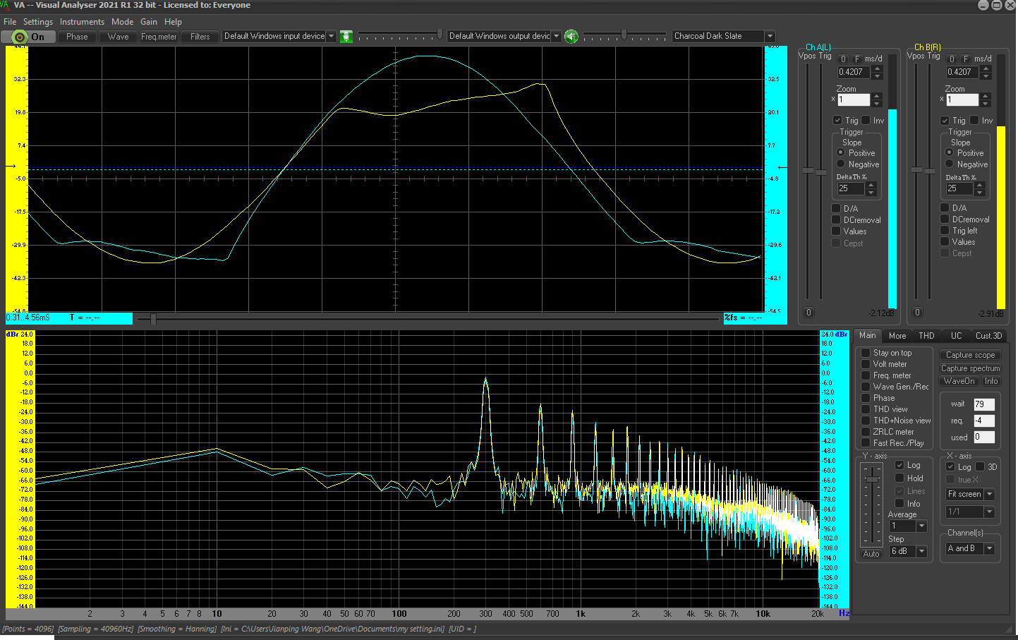

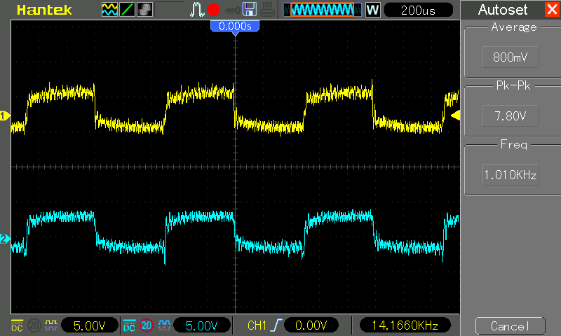

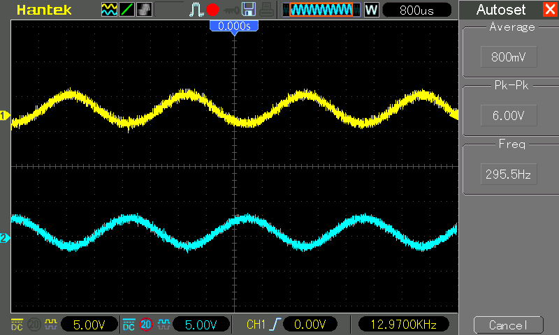

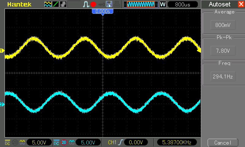

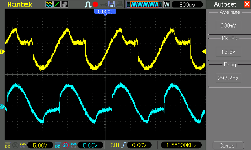

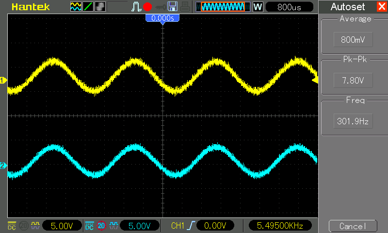

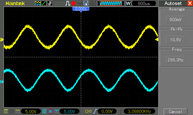

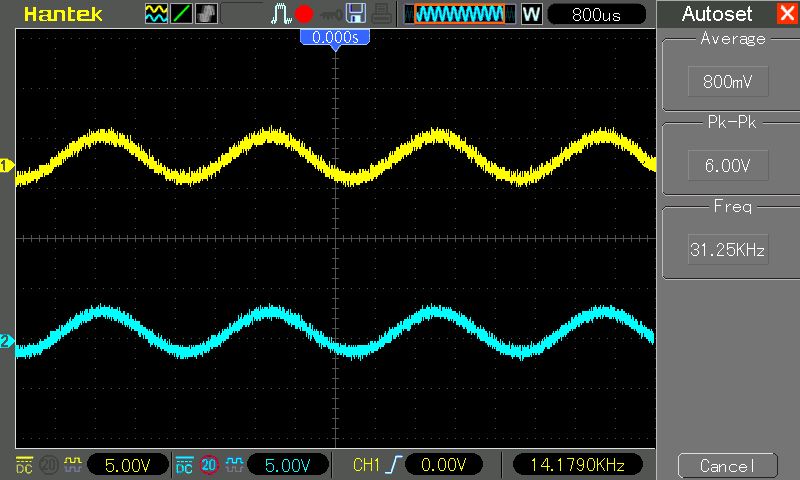

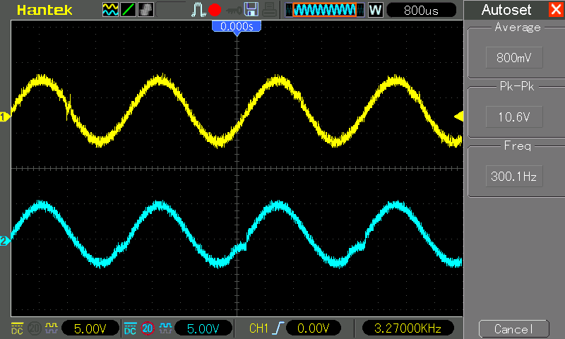

I tested the tracking ability of my 1" air-bearing arm today again. The tracks are from CBS Test Record because I realized that there are two groups of tracks. One group is lateral and another group is vertical. Here are the results. The vertical trackings seem all fine.
Square Wave
300 Hz lateral 6 dB
300 Hz Lateral 9 dB
300 Hz Lateral 12 dB
300 Hz Lateral 15 dB
300 Hz Vertical 6 dB
300 Hz Vertical 9 dB
300 Hz Vertical 12 dB
From the test results, the mistracking happens in lateral tracking. It is understandable. The results also indicate that at 15 dB, the arm tacks one channel correctly the meantimes mistracks the other channel.

I just tried VA with an RIAA phono and CBS test LP. The trace is somewhat smoother but almost identical to the test result without RIAA. So, it doesn't matter probably if you use an RIAA phono or a microphone preamp for these particular test tracks. This is a 300 Hz 15 dB signal with an RIAA phono. I think your HiFi Sound Test LP is cut with RIAA.

I am a bit lost in this area Jim, however i will take a look over the coming days, meanwhile if I discern correctly you have both channels input to VA and one (A, L) shows a quite close representation of the wave but the other is distorted, is that what i am seeing please, and as its the 15dB torture test that's not surprising but why the difference between the two?

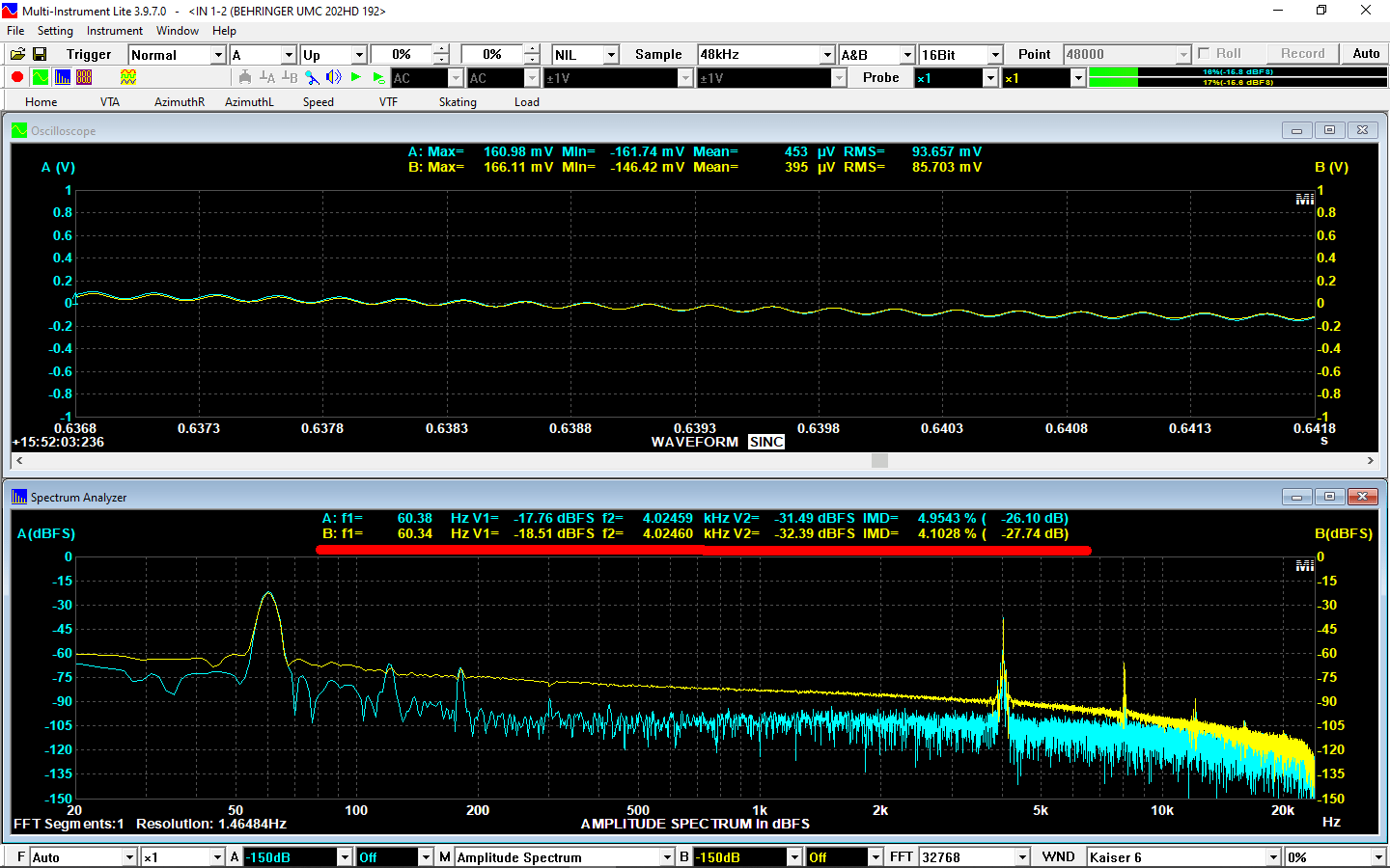

The track you used looks like an intermodulation distortion signal, IMD. It has 4 kHz and 400 Hz. Usually, you may use IMD to test VTA. The Ultimate Analogue Test LP has an IMD signal, 4 kHz and 60 Hz. It can be used for testing VTA. I have another piece of software, Multi-Instrument. Here is a screenshot. You can see that I configured the software to test all parameters of tonearm adjustments. They are red-underlined in the image.
For tracking tests here, the signal is actually a simple 300 Hz signal in the waveform at various levels. The high level of the signal is, the more difficult to trace it. If you have a 300 Hz signal, you may try it as well. However, you need to make sure of the level of that particular signal. Otherwise, it may not mean too much.
Here is an actual test for VTA. You can see f1 is 60 Hz and f2 is 4 kHz. IMD=4.95% for the left channel A and 4.10 for the right channel B.
Jim
Guys I wouldn't worry about the 15dB test track very few cartridges will track this. A Stanton 881s will track it but this is special cartridge.
Jim that 15dB plot looks to me like the stylus is riding up the groove wall as the carriage is flung back and forth. If the arm can track 9dB I'd call that good there is not much on an LP that exceeds this. My pivoting arm and EPC-205 will track the 12dB if I increase antiskate and VTF but I never run this much antiskate and VTF. The Stanton 881s will track 15dB @ 1g VTF with just an increase in antiskate.

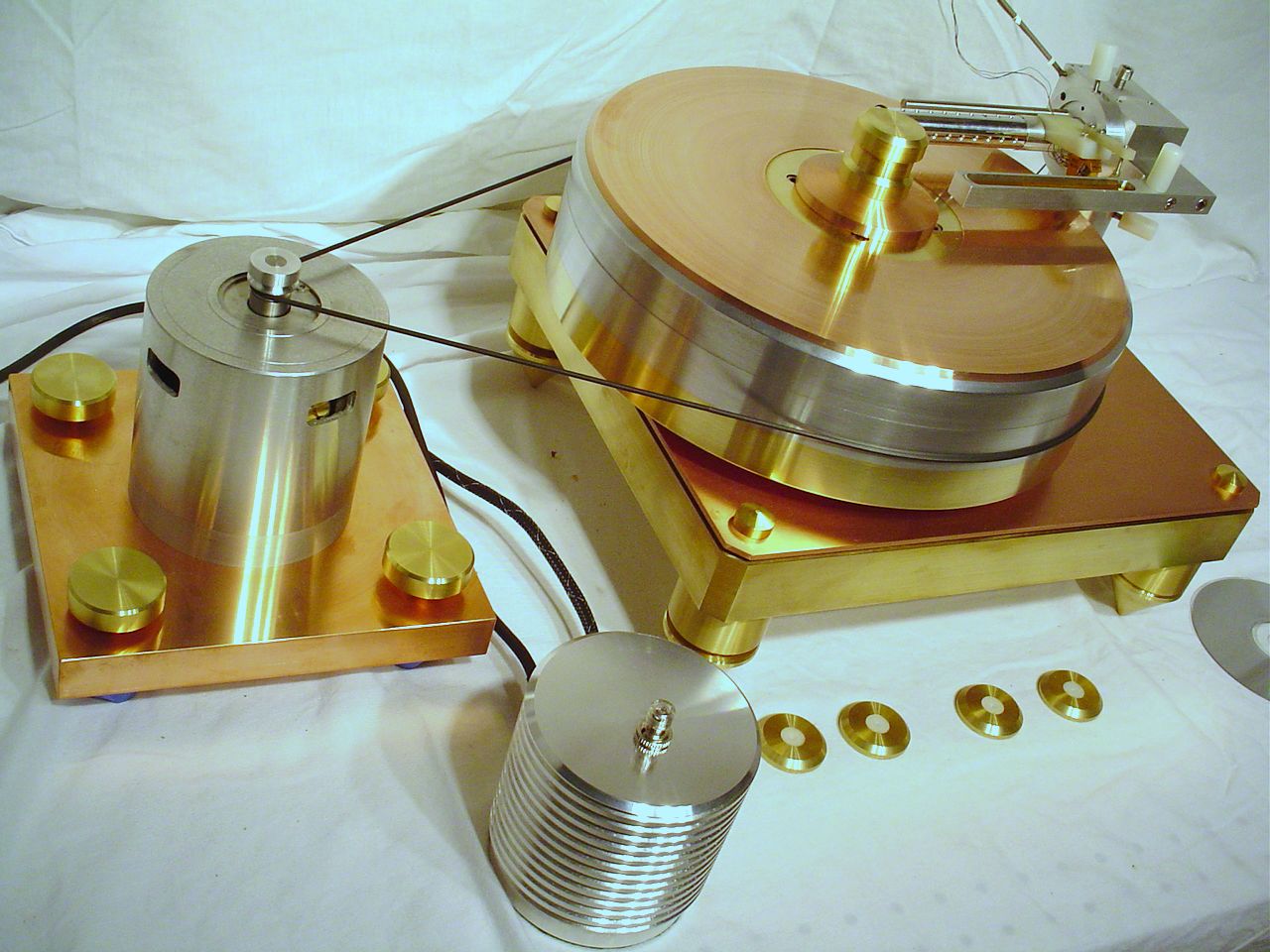

Tritium Turntable with Fluid damped Air bearing Tonearm. Arm weighs 40 grams, Table weighs 150lb.
How do you like your arm? What airpump system do you use for it?
The turntable, did you use microseiki parts and built a base around it?
