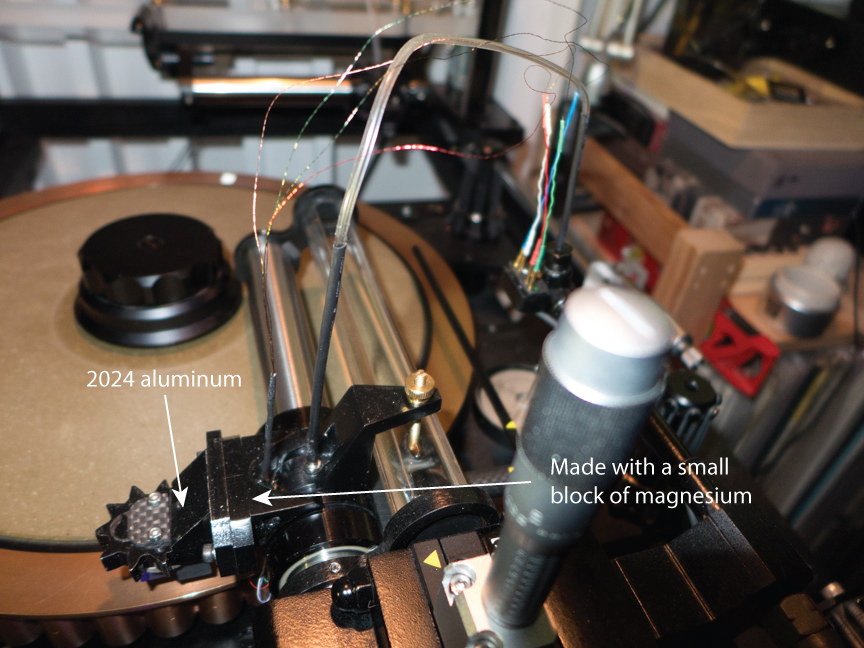

So you have just small piece of magnesium alloy interface between headshell and air bush? Interesting.
I am trying to go back to find some good picture of your assy,...
I will use powder coating on all alu alloy parts. It will add some additional damping.
Will use brass interface to connect headshell to carbon arm tube. What you think of brass interface parts in setup?

I don’t think brass is a good choice. Brass has higher density and may add unnecessary mass. One of reasons I like magnesium is it has less density than aluminium.

Though this interface would be so tiny and small ring i get your point about weight,...
but i still don't get how did you attach all this to air bushing 😕
As you saw from my sketch i will make alu clamp in which will press and secure air bush with a grub screw, then will press fit arm tube in clamp (and all other parts) 🙂

I must admit that it is not elegant solution at all 😱 but whatever drives your horses 😉
So what is the final weight of your assy?

It may not be, but it is a practical one. There were two considerations. 1, Mass. 1” bushing is 75 g already. The total mass of my arm is about 200g. 2, I wanted the center of pivot close to surface of record as much as possible.

Yeah, while it is so minimal in design it is pretty heavy😕

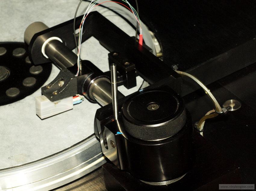

The most elegant solution to a problem is normally the simplest. Gluing the headshell directly to the bearing case is super simple. Not only does glue minimize mass and allow lower pivot point it also allowed Jim to minimize arm length. The bearing already has an aluminium case, I don't think it needs another.

I highly respect your excessive knowledge behind tonearm and moving stylus science. I am still reading your posts in awesome Colin thread about DIY linear tonearm and enjoying your meticulously written posts on subject and learning from you guys, and saying that i must admit that a lot of this stuff is still beyond me so to speak,...but,...
being engineer and machinist for 25 years in motor vessel sector (small boats and trans ocean one) i saw on numerous occasions glue of any kind (being epoxy,polyester,vinilester,methacrylate,cyanoacrylate) fail under certain load condition or fail with no load condition just because bad surface prep and with aging in time.
More of that i am avid rc model builder whole my life (RC gliders,planes, helicopters, boats, sailboats, cars,..name it, so i know when even best epoxy out there fail from any of reasons possible,...
Furthermore i thought initially that interface between cartridge and mass of the carriage (and air bush) must be firm and stiff to ground any resonances which may occur in grove tracking. Now i can see from Jim pics that it would be hard to press these two complex shape parts to achieve good bonding in between 🙁
Or maybe i am wrong completely and let stick glue everything. it is easier😕

Exactly, my goal was to make the arm as short as possible, too. Any extra structure will extend the length of the arm.
Actually, I was inspired by Versa Dynamics arm. They must use some of glue to attach the head shell on air bearing.
