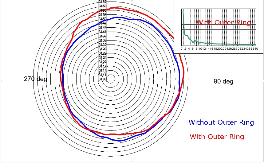

How are you improving speed stability with a lighter outer ring? Your originial was 7 lbs. and now 4 1/2 lbs
Maybe a rebalance and less belt slip with less rotational mass as an issue to be solved ?

Hello David,
In a different thread, luckythedog did a analysis of my table speed with and without 7 lbs outer ring. Please see attached image for the result of analysis.
You can see that the speed was not as stable as the speed without the outer ring. It is because the weight of outer ring caused this. In order to improve the stability of speed, in my opinions, the weight of outer ring needed to be reduced. I don’t have measurements for the new 4.5 lbs outer ring, but I think it will improve the stability of speed.
Jim

Are these graphs showing some off-centering of the test disc?
Yes. I used The Ultimate Analogue Test LP which is seriously eccentric. I tried to expand the center hole but realized that it involves too much work if I want to correct the eccentricity.
