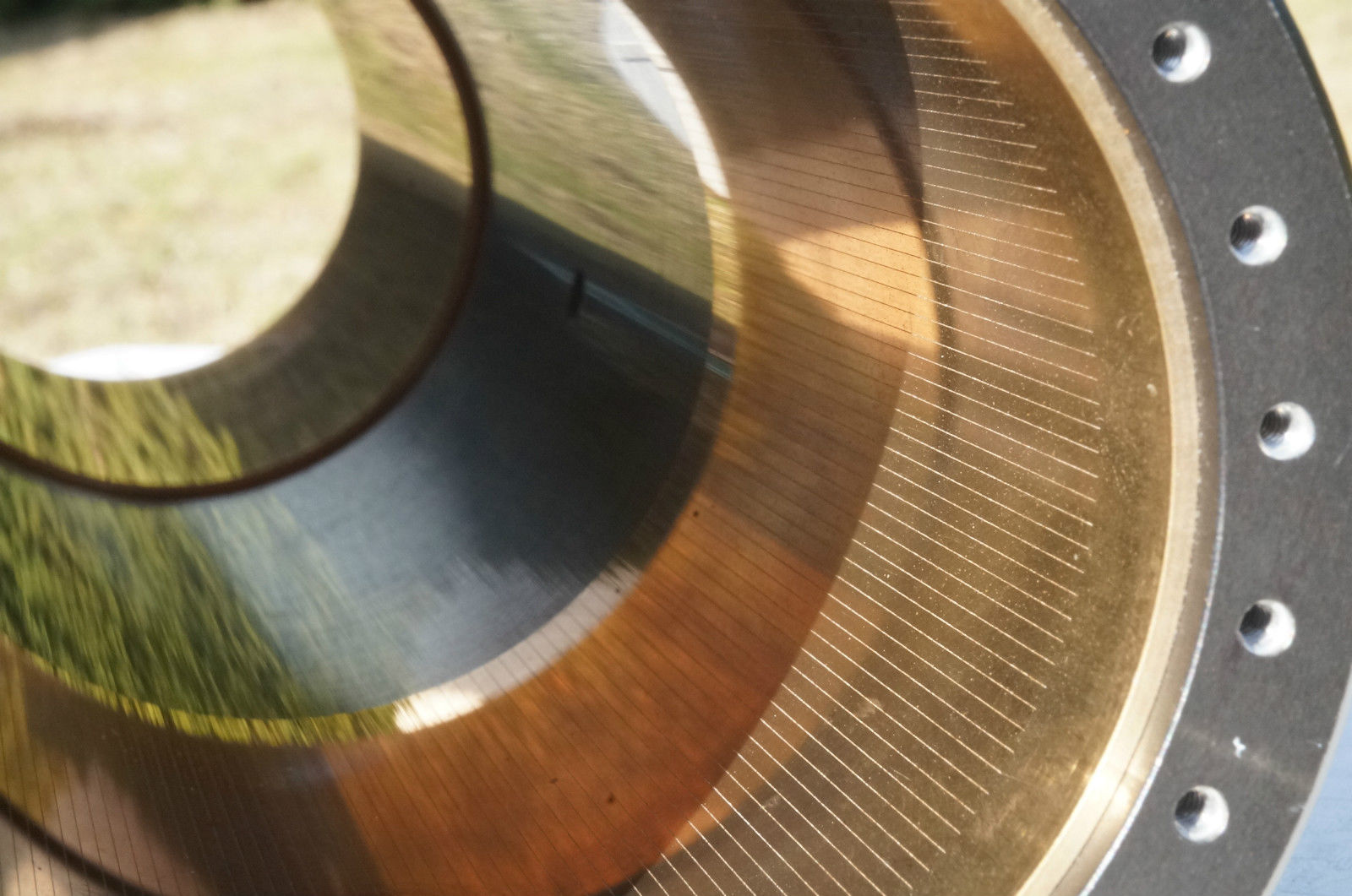

Kuzma uses 65 psi compressed air and Rockport uses 33 psi. As I said before, I am not air bearing expert and not sure what Micheal Fremer was talking about high frequency ringing. In my experience, the different air pressure will make significant difference sonically. Usually, high air pressure makes sound more dynamic and edgy while low pressure makes sound soft and smooth. I have tried different air pressures as low as 15 psi.

I think from what I have heard that rockport has a different design of airbrushing that allows it to run at lower pressure but yet to maintain the same high level of stiffness.
I am not an ME nor an airbearing expert so I tried to read some technical documentation around the net to try to get a little better understanding. Unfortunately there are no info on the Rockport design other than what I posted.

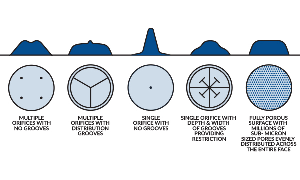

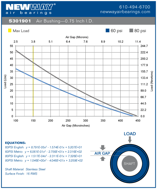

Smaller gap between bearing and shaft will maintain high level of stiffness at low air pressure. But custom made shaft with tight tolerance is difficult to get for DIY. Here is an image from New Way air bearing to illustrate the advantage of porous material over air channels.
I have tested different air pressures on my arms. The best air pressure is probably 40-50 psi. I have tried 70 psi but don't see the reason to run air pressure this high.
My Versa Dynamics and a big commercial air bearing of the same air distribution design principal.
A fingerprint on the shaft will give you an idea of how tight the tolerance is since it will stick in its presence.

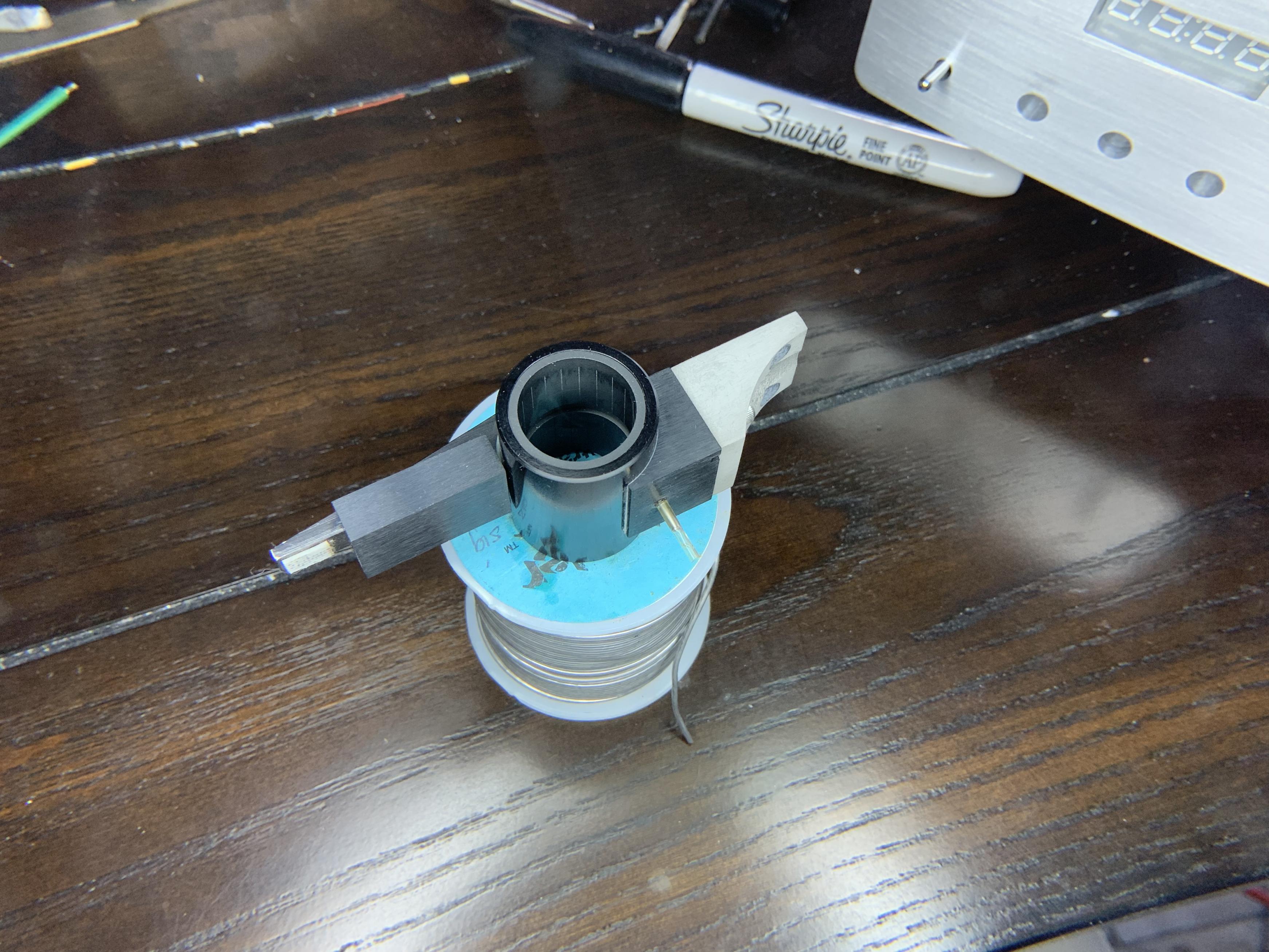

Hi David,View attachment 757712

Thanks for these very interesting photos! So, I think the air pressure will be high on both opening areas of the bearing. That makes sense. I don't know the construction of New Way air bearing. I would assume there is an air chamber behind the layer of porous material.
Jim

Bushing Inside Diameter (ID) 0.5008 in +.0002/-.0000
Recommended Shaft Outside Diameter (OD) 0.5000 in
Recommended Shaft Tolerance -.0002/-.0007 in
These are the recommended value for New Way air bushing. I assume you are going to use 1/2” air bushings. I personally won’t recommend to change the shaft tolerance. But if you want, you may reduce the gap between air bushing and shaft. So,
Shaft Outside Diameter (OD) 0.5004 in
Therefore, you reduce the air gap by half of New Way’s default.

Using two 1” air bushings is out of question due to the mass of shaft. For same kind of shaft as above but 1” OD, it will be 122 gams.
3/4” will be 90 grams. Let’s assume to use 3/4” air bushings. As long as you can control the total mass not over 150 grams, you will be ok although it is too heavy for your Goldfinger. Even though, it will play and sounds wonderful. However, you may have trouble to track some of high dynamic passage of music. The arm will track but sound may have distortion for some music passages, such broken sound. I can’t estimate cartridge/arm resonance frequency either since it is a long arm wand. You need to do some calacutions to foresee the resonance frequency.
In addition to what I said above, you need to know the total mass of EMT magnesium wand.
I don’t think carbon fiber can be used as shaft for air bushing. The arrow carbon fiber shaft I was talking about was for arm wand only.

If you want to build one as in the photo, I would suggest to use two 1/2” air bushings since you can control the total mass in a reasonable range. I did a rough calculation. This kind of arm needs a 15” or longer shaft. Assume the shaft is a hollow aluminum one with 1/16” wall, so the total mass for shaft will be 60 grams which is close to the mass of 1” air bushing. However, it will be difficult to achieve total mass 80 gram. Also you need to think about the possibility of grinding a shaft with 1/16” wall. It won’t be easy. You have to find a shop to see if the shop can do it.
Jim
