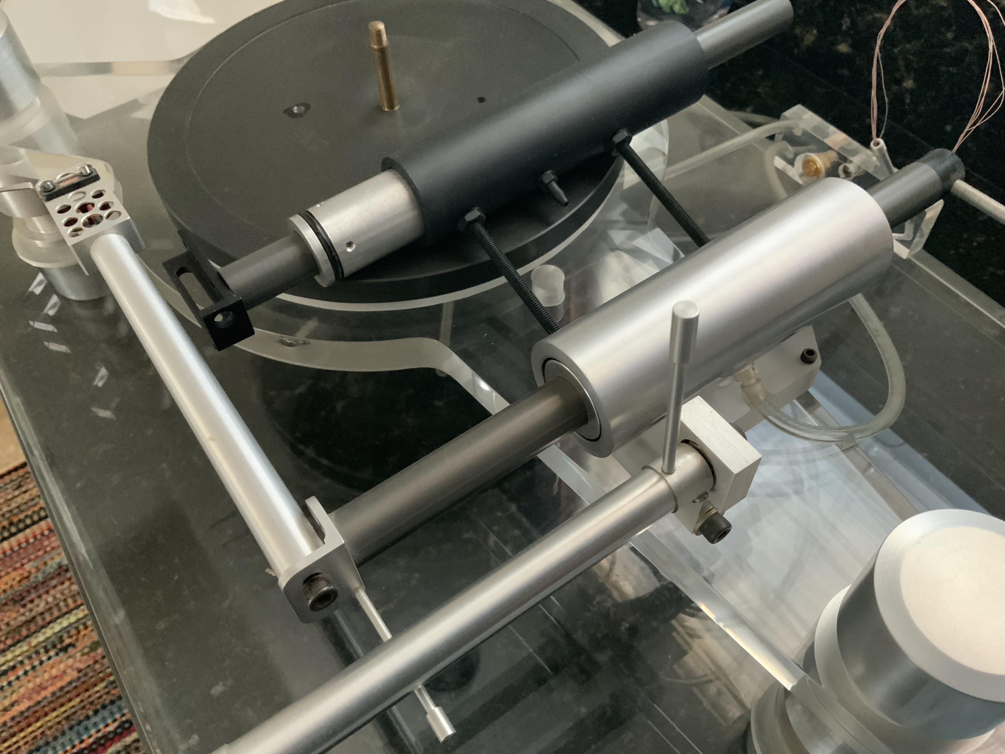

Now my question is which arrangement is technically preferable, the one used on
The proscenium tonearm or the one used by the Chinese guy at post #81?
If you want to make Walker Audio’s style, the length of shaft is at least 8”. It will greatly reduce the mass almost in half. You still need two 1/2” air bushings. I saw some people use just one air bushing for this kind of moving shaft arm. I am against to do so.
In theory and from construction aspect, I think the implementation by the Chinese guy is better than Walker audio kind. However, the Chinese guy’s implementation may make whole arm a lot of complicated.
Your main challenge, in my opinion, is how to get the shaft done no matter what kind of arm you are going to make.

#81
First, the horizontal mass is unnecessarily too high because of the wrong headed use of 2 bearings spaced apart.
The second issue is coefficient of expansion and the possiblility of a sticking air bearing at that distance based on dissimilar mounting materials and getting it adjusted and stable under all temperature differences.
A long arm shaft like that requires a centerless grind of perfect dimesions more so than a shorter version that moves less
I not saying it doesn’t work, it’s just impossible to get low moving mass this way.
And it would only work with ultra low compliance Mc,s , unless you want severely pumping woofers at warp frequency’s with other cartridges
Your hand drawing would be better but also more complex and again adjusting both would be a challenge and really over complicated. It looks like an ET BTW.
The early Maplenoll had 4 holes (8 total) near each side of the pressure tube it slides in.
The ET -2 has 5 holes of high tuberlance on each side, so 10 holes that in the end pressurize the whole tube length in combination
This allowed a shorter pressure tube and thus less length and horizontal mass unlike the longer Maplenoll design with less pressure holes and longer air bodies
We’re talking 3 psi for the ET-2 and Maplenoll to start working and only about 10 psi at their best sweet spot.
Walker just ups the pressure in the basic same design.
The only down side to the excellent New Way or Versa design is the mandatory high pressure/small surface area AND the air tube friction issue since it must move by the needle unlike the others that only deal with wires and low pressure.
They both have their quirks and features

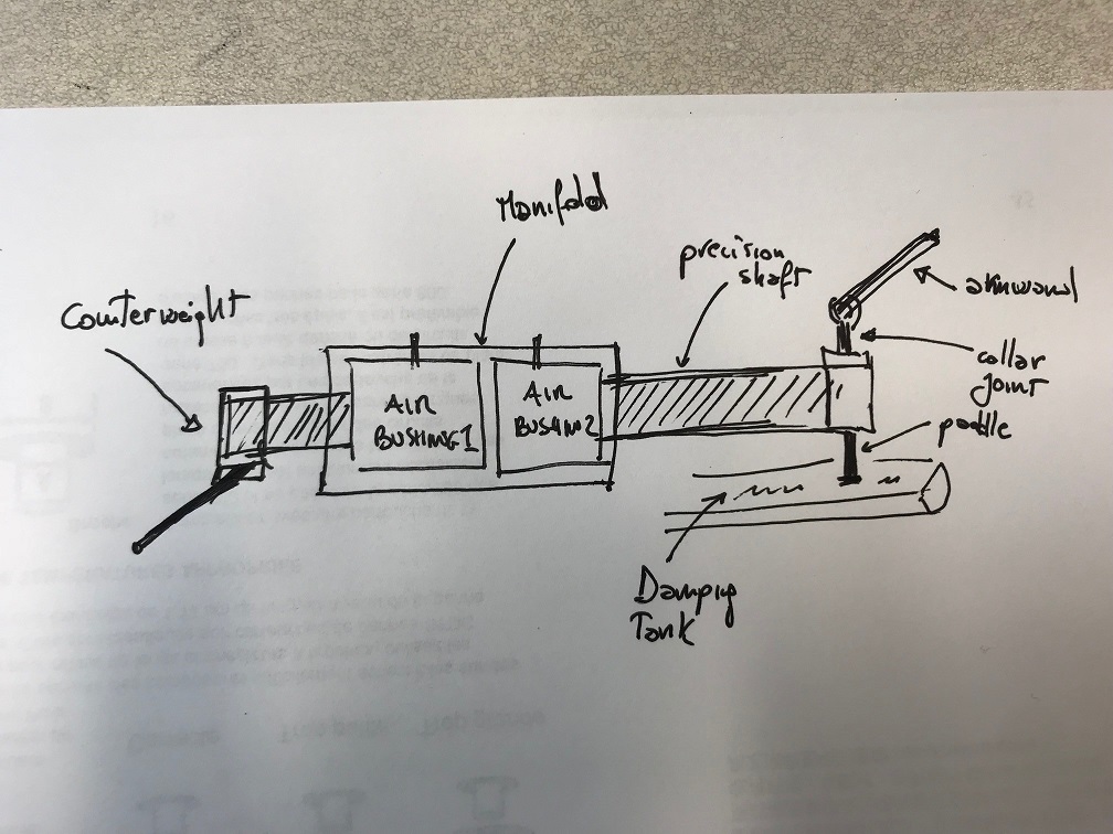

initial sketch for the concept
I can't comment too much since it is a rough sketch. But I need to point out that you need to leave some space between two air bushings. Compressed air may make noise if two bushings are too close to each other. My suggestion is 1". Leaving space between air bushings will restrain the movements of the shaft better.
Jim
Hi David,
I have never look inside of ET arm. Are there any air grooves in the air bearing? If there are no air grooves, high air pressure may cause shaft vibrations due to uneven distribution of air. A long custom made porous air bearing with air chamber in middle will be perfect.
Jim
Jim
No
What the arm tube slides in is a thicker tube held in with 2 - O rings
Near the ends of this tube are 5 holes that are threaded.
A small set screw (the kind that locks a volume knob for example) is run down into each hole and stops just before the sliding air tube.
It feels like a metric screw going down into an American thread pitch where it just stops with slight resistance
Each set screw has its male thread slightly rounded off so no sharp thread points
Allowing air to circulate down the thread gap for turbulence at the air gap junction point
Regards
David
Regards
David
Thanks for the photo, David!
I understand it now. I am wondering why they use set screws as air supply holes. Perhaps they didn't have the technology to drill very small holes on the internal wall at that time. So, I guess the set screws can be used to control air flow. I am also wondering if small holes may do a better job if each end has at least 8 holes around the internal tube. Another reason these arms can't use high pressure because the o rings may be able to hold high pressure.
Jim
Jim
Sorry you can see I am a completely newbie as I have almost no clue what I am looking at when you say set screws creating air turbolence.
First of all, to see if I understand correctly, I assume the gray/silver arm to be your latest or the one you are currently using, correct?
Is this built using ET air bearing shaft and bushing parts?
How heavy is the shaft? Have you measure it?
Is the air bushing you are using a custom design from ET or do you think it could be had?
Would it be equally good to use two new ways air bushing next to each other (with spacing as super is suggesting)?
In your latest design, the one with the armwand I assume, you have the counterweight on the same side as the armwand and not at the other end, am I correct?
I am still struggling finding a source for the hollow shaft.For some reasons, it much easier to acquire a precision solid steel shaft than hollow precision aluminum.
I was wondering, the Rockport arm has moving bushing design, but they run the pressure much lower than typical kuzma design and they declare to use a different type of airbushing, I have researched but can't find any clue that leads me to the type they are using.
Rockport is said to be the best tonearm in the market (at least for the linear arms). Do you have any idea what they could be using?
Also do you have any idea like super was suggesting, how it would be possible to get a longer airbushing with the air chamber in the middle similar to the one that ET uses?
Sorry for all these questions, like I said I am here to learn.
Jim
thank you for the tip, increasing the distance will also increase the length of the shat thus the weight. It's very, very hard to meet the requirement for the weight.

That is Maplenoll in a nutshell for you! I guess their finest tool was a wood ax. 😀😀😀
The level of soundquality, on the other hand , coming out of these (especially the Ariadne) was amazing. I was the importer of Maplenoll in Denmark for some years..
After having looked around it seems to be extremely complicated to find a stock hollow suitable shaft. It become even more complicated to find a specialty shop that will do one or two pieces and finally it's hard to reach the goal of 80-90gr total moving mass.
So after giving some more thoughts, for this project it is probably best to move forward with the implementation that super has done already on this thread.
Therefore, I will go for a 20mm air bushing from new way and I am looking around for high quality 20mm stainless steel shafts.
Fortunately, there are several options and manufacturers around for that.
OAV was originally suggested and makes very nice shafts. Also online it seems it is possible to get even better/smoother shafts.
For example I found this one that has a surface finish of 8RMS (OAV has 16RMS for example).
SM series Metric Linear Precision Shafting | Lintech
I will keep looking a little more. I wanted to double check with you since as I said I am newbie in the mechanical field and especially to interpret mechanical specifications.
Am I wrong or the specifications for the shaft here are extrmely good, or am I missing anything?
Thanks in advance for the help.
It seems to me it is a good find. Its tolerance is very good so the air gap will be even tighter. A tighter air gap means lower pressure with stiffer bearing. I am not sure about the surface. I would think it won't make too much difference. The price is good too. A 10" shaft is only $26.00. I would try it first. If it doesn't work, it is only $26.
