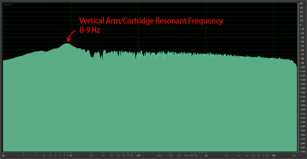

Personally, I don't worry about the Terminator's lateral resonance frequency. It will be around 4-5 Hz. However, its vertical resonance frequency may be problematic. Its arm has two additional pivots so its vertical resonance frequency is based upon its headshell, arm wand, and counterweight. The L-shape slide is not a part of its vertical effective mass. Its vertical resonance frequency can be very high. The vertical resonance frequency test in Hifi News Test LP has up-limit 15 Hz. If the arm doesn't reflect its resonance frequency while you are playing this track. Its resonance frequency will be higher than 15 Hz. If so, it is a design problem.
Another way to test resonance frequency is to use Track 3 Pink noise vertical, in The Ultimate Analogue Test LP. Please see the attachment. Play the track and record it in Adobe Audition. Then, open frequency analysis window. You will see the resonance frequency.
Jim
Jim

Yes that was clear. I am going to weight the slider tonight and post. When playing vinyls I can notice a left and right motion due to eccentricity of the disc itself, I am assuming this to be normal.
I am concerned however the vertical mass in this case is too light and pushes the resonance too high.
The linear air bearing will have damping path like super has implemented and Kuzma has followe it shortly after, which should take care of eccentricity issues hopefully.
Jim
That is a very good idea. I will play pink noise and feed t in to my spectrum analyzer to see where the resonance lays on.
I can only assume that to be the vertical resonance frequency.
I don’t have at the moment the ultimate analog lp test but I had presented it and should have shipped and arrive to me along with another couple of test records from Clearaudio early next week.
In alternative I can also install the Clearaudio Titanium V2 which is lower compliance and lower weight I assume and see what changes. I never installed it since I have the goldfinger so it’s still sealed in box.
I am itching to see if I can see any resonance using that.
