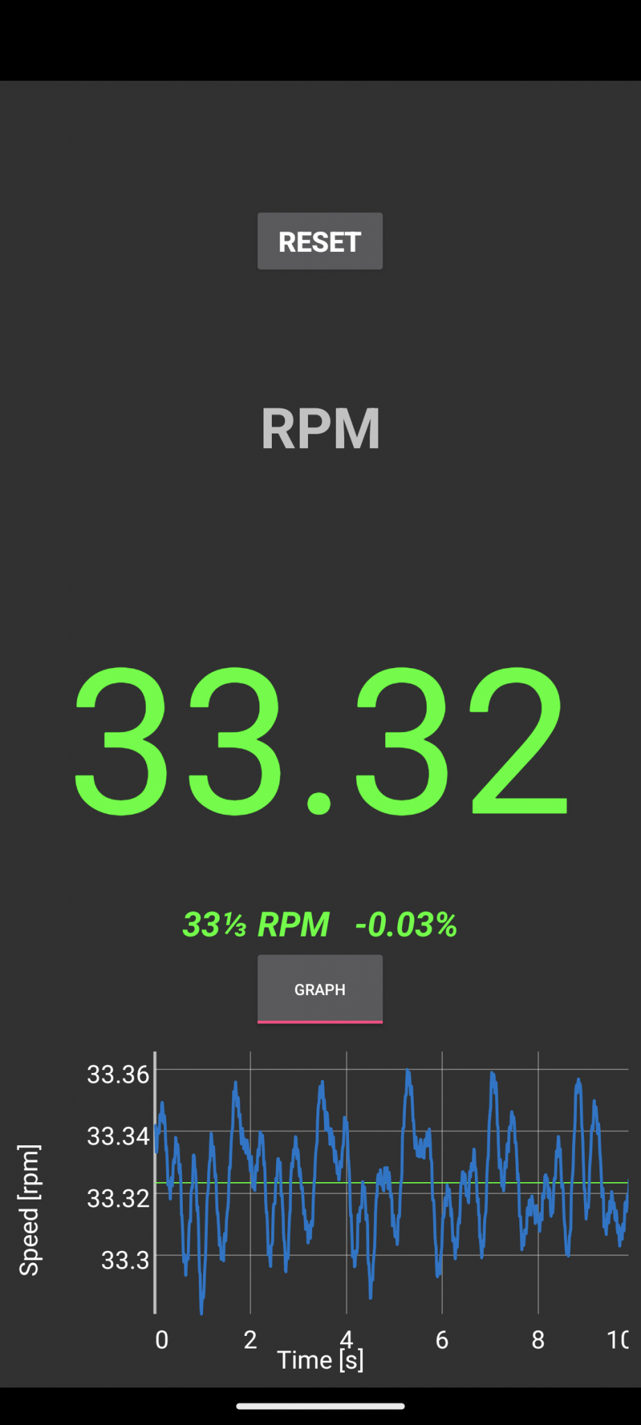

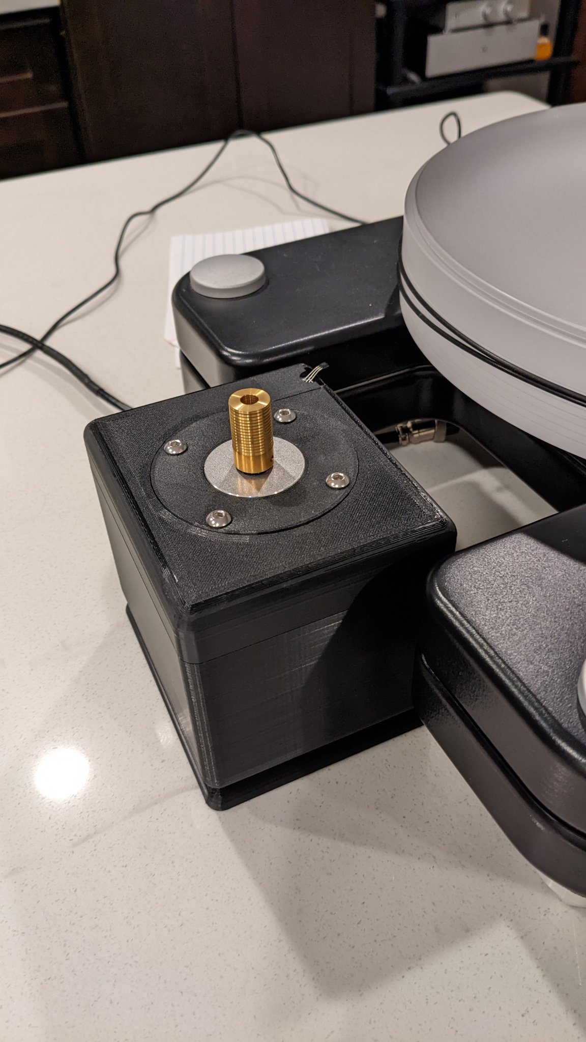

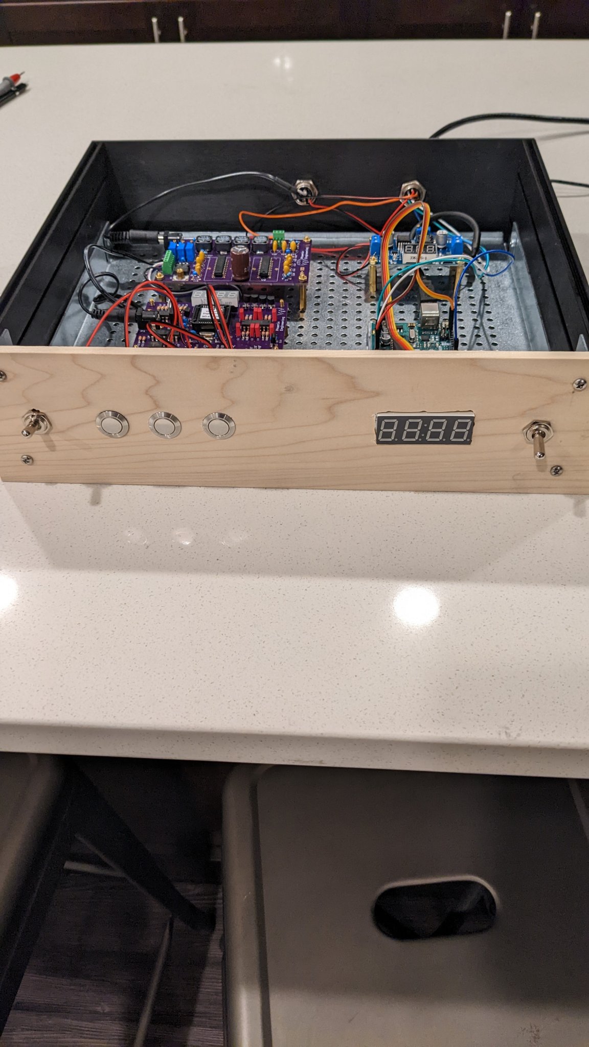

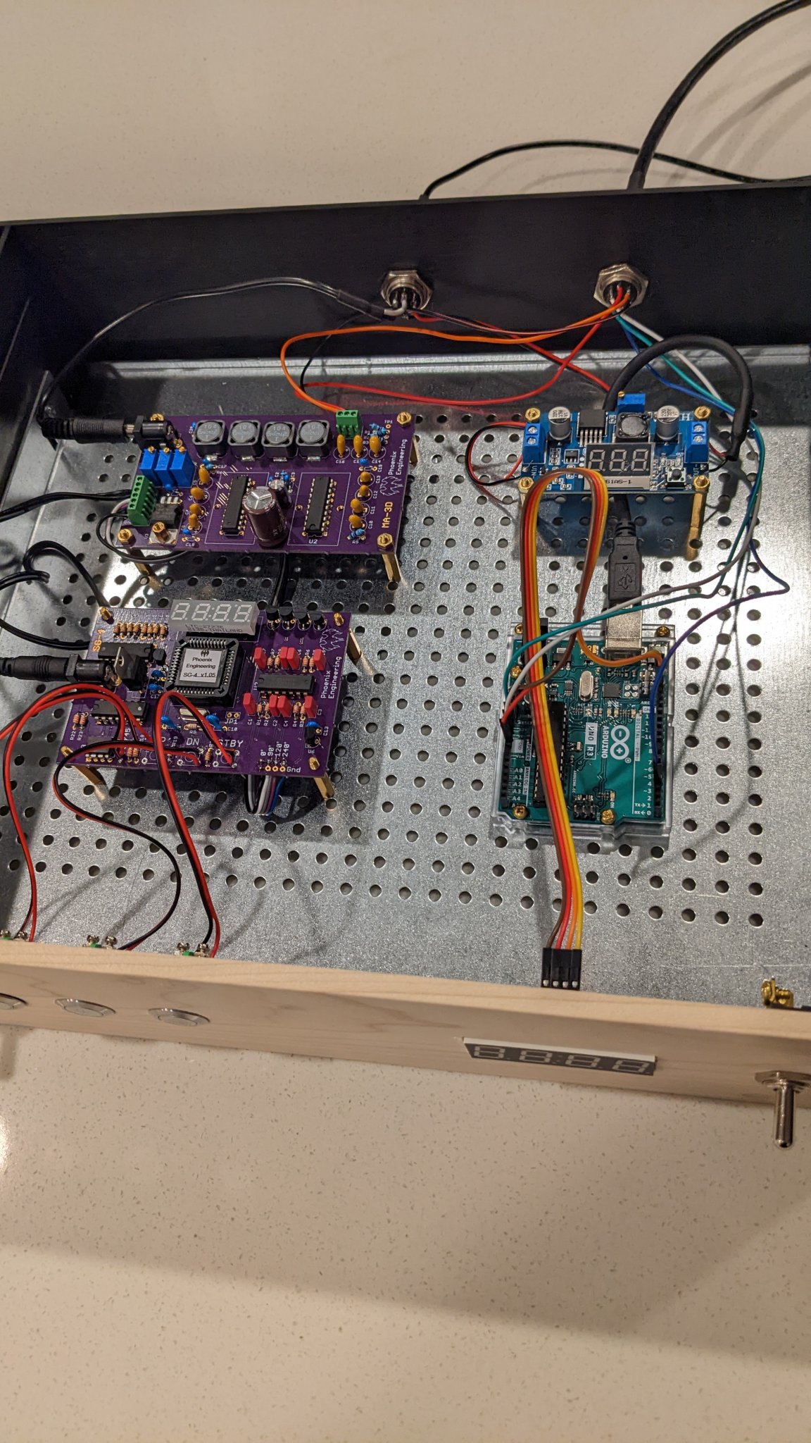

The first want to thank you for the communities help so far. I thought I'd show what I have so far as well as ask a couple questions. Forgive me if some of these are elementary.

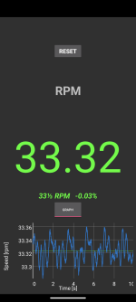

First being it looks like I am getting inconsistent speed throughout the rotation of the platter. Any thoughts on how best to adjust for this? Full screen the first image to see The RPM graph
Second being It is my understanding that the I²C interface only works for The two line 16 character LCD and will not work a seven segment display I²C backpack as I am using for the RPM display. If I want to use the same seven segment I will have to adjust the pin out
This is very much still in the works The face plate's going to get changed and I should probably add a fuse...

I solved the inconsistencies by cleaning the belt, platter rim, and pulley. nothing special, just some alcohol and wear gloves - apparently the oils on the hands count too. I also replaced the bearing ball and oil for the platter bearing in my system, yours may vary.
What your graph is showing is W & F and the motor controller cannot correct for this. If you are using a smart phone app to measure this by placing the phone on the platter, I would question the accuracy of phone app. An app that uses a 3150Hz test tone on a record will be more accurate. As member rif wrote, small amounts of W & F are usually a mechanical issue not an electrical one.
You cannot use a single display for both motor controller and tachometer readout. The SG4 I2C interface only works with 2x16 LCD displays and only those that use the PCF8574 or PCF8574A interface chip.
