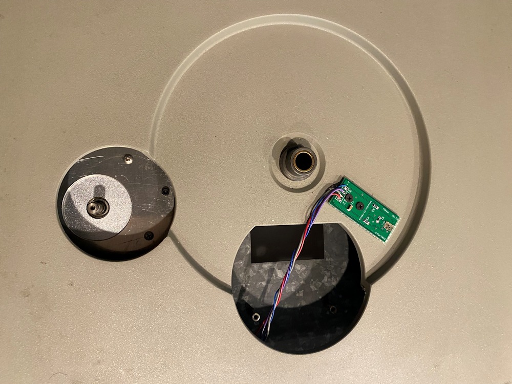

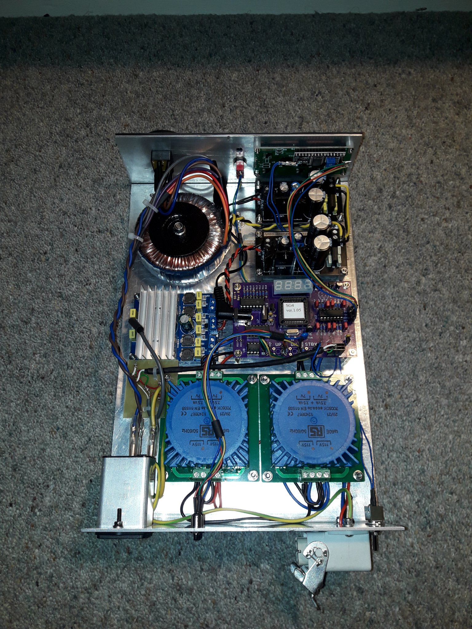

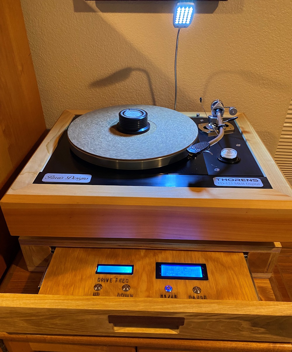

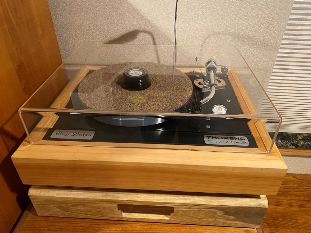

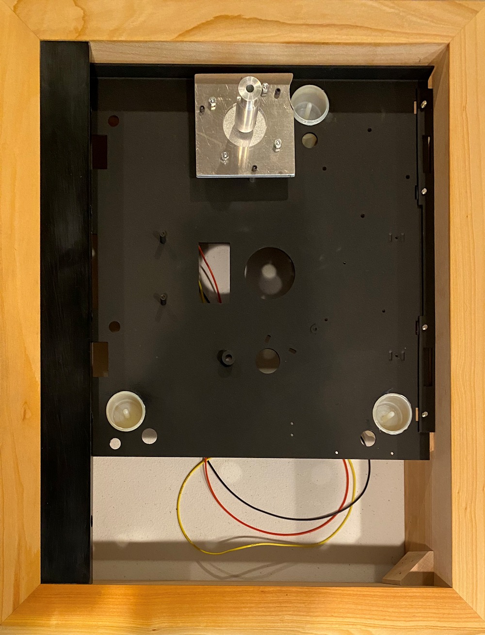

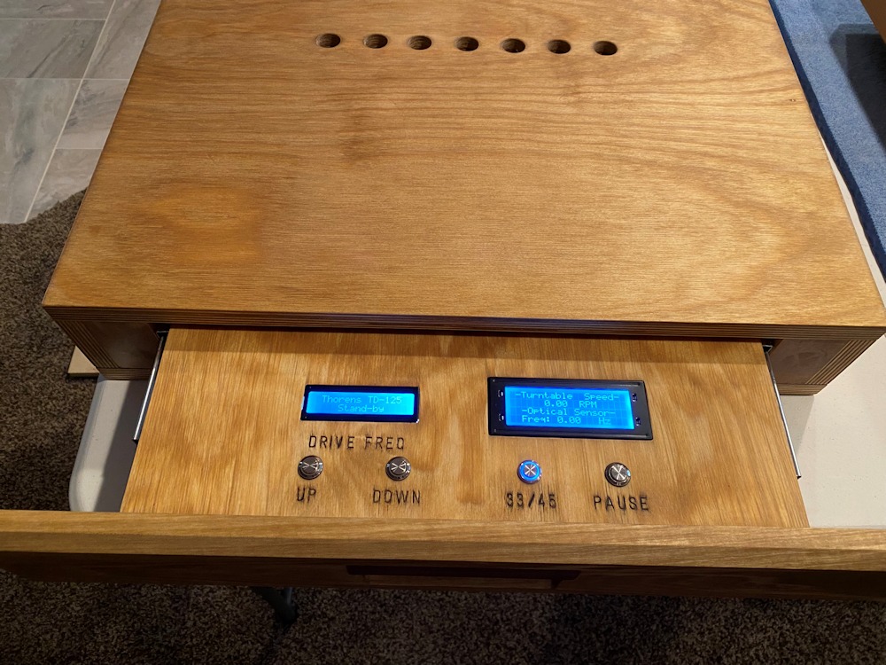

Thanks to Pyramid and the forum members for my inspiration and guidance to upgrade my TD125 MkII. I thought I would share my long journey. Started with stock Thorens TD125 MkII and removed motor, all control electronics, and optical systems. Replaced the motor with AA-BLWS-231S motor, along with SG-4 (v1.05) and MA-3D amplifier to drive the motor. You will see in the pictures that I put the turntable in a new plinth and built a separate box for all the electronics with a pull-out drawer to expose the control. I also designed an optical reflective sensor under the TD125 sub-platter, looking at the strobe pattern on the sub-platter. I then designed an Arduino based frequency measuring and display module to monitor and display the frequency of the signal coming from the optical sensor. If the turntable is turning at 33.33rpm then the signal from the optical sensor/stobe pattern will be 120Hz. The software integrates for 4 seconds then displays the frequency and the turntable rpm. All the electronics operate from a 30W-15V power supply. I also machined a new tonearm bronze mounting plate and Delrin tonearm board for the SME 3009 Series II Improved tonearm. The tonearm was completly rebuild and rewired by SME Tonearems in Toronto, Canada. You will also notice the labels which I had custom made. The first picture is the completed turntable.
This is the control electronics looking at the bottom of the control box.

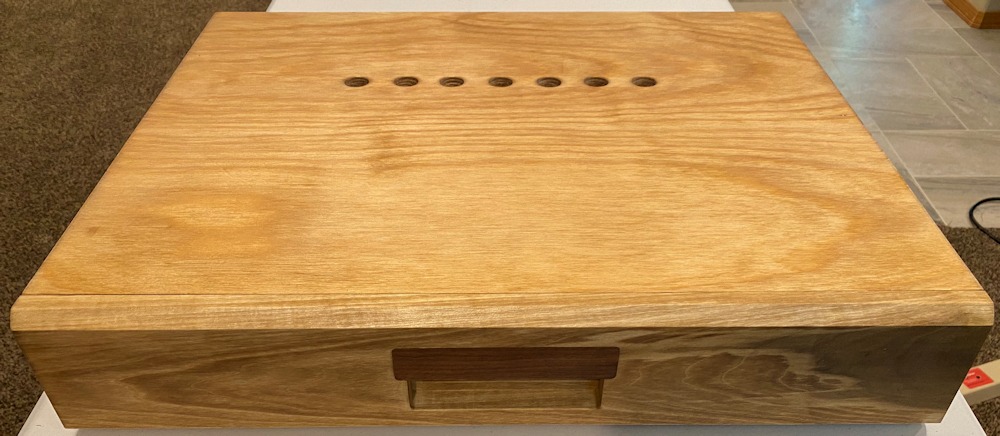

The control box from the top & front.
The view of the control buttons and displays with drawer opened.
The new plinth and the TD125 sub-chassis and the AA motor and new pulley.
The completed system operating.

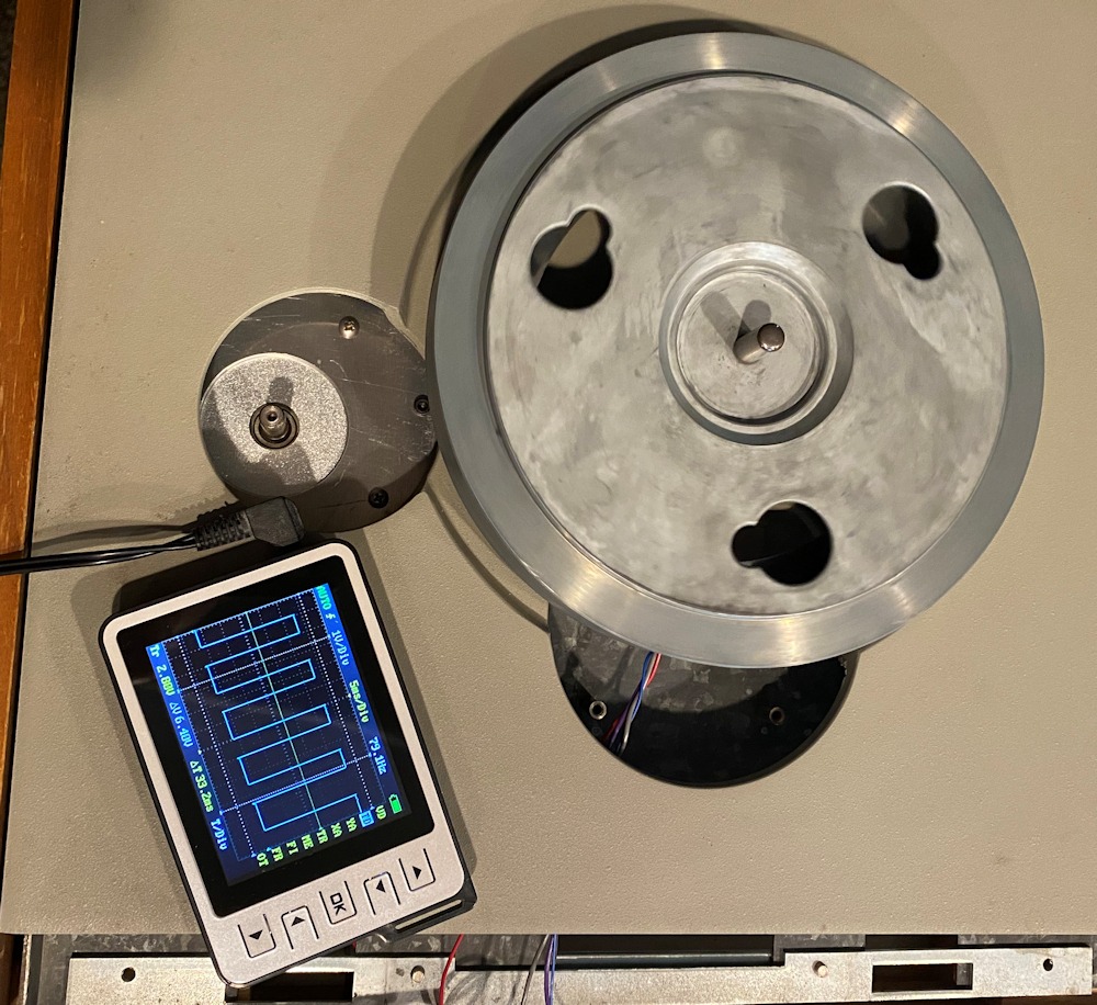

I inadvertenly omitted the picture of the optical sensor.
The sensor output displayed on minature o-scope.
