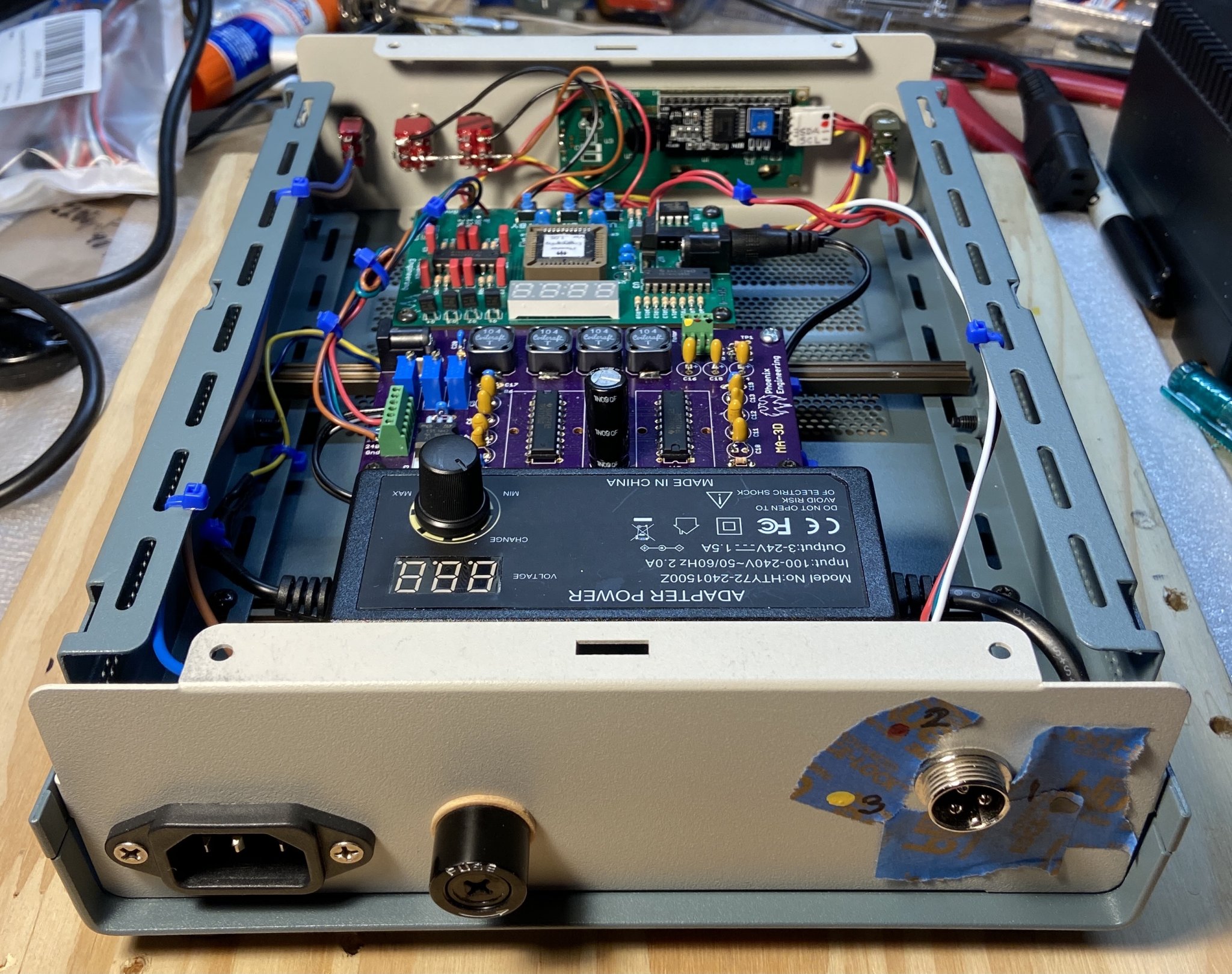

What exactly do you have wrt the SG4 and amplifier (pictures would help)?

When you say the speed is consistent using wall power, are you measuring the speed with the digital tach? If so, and the same tach shows speed variations with the SG4 driving the motor, then the voltage or frequency of the SG4 is varying or perhaps the voltage is too low to begin with (the Lenco uses an induction motor so it is sensitive to voltage as well as frequency). Do you have a way to measure the output voltage and/or frequency? The SG4 is crystal controlled, so the frequency is very stable and I suspect there is a voltage problem.
Can you post pics of the inside of the controller? I have no idea which amp or step up transformer arrangement you are using.
