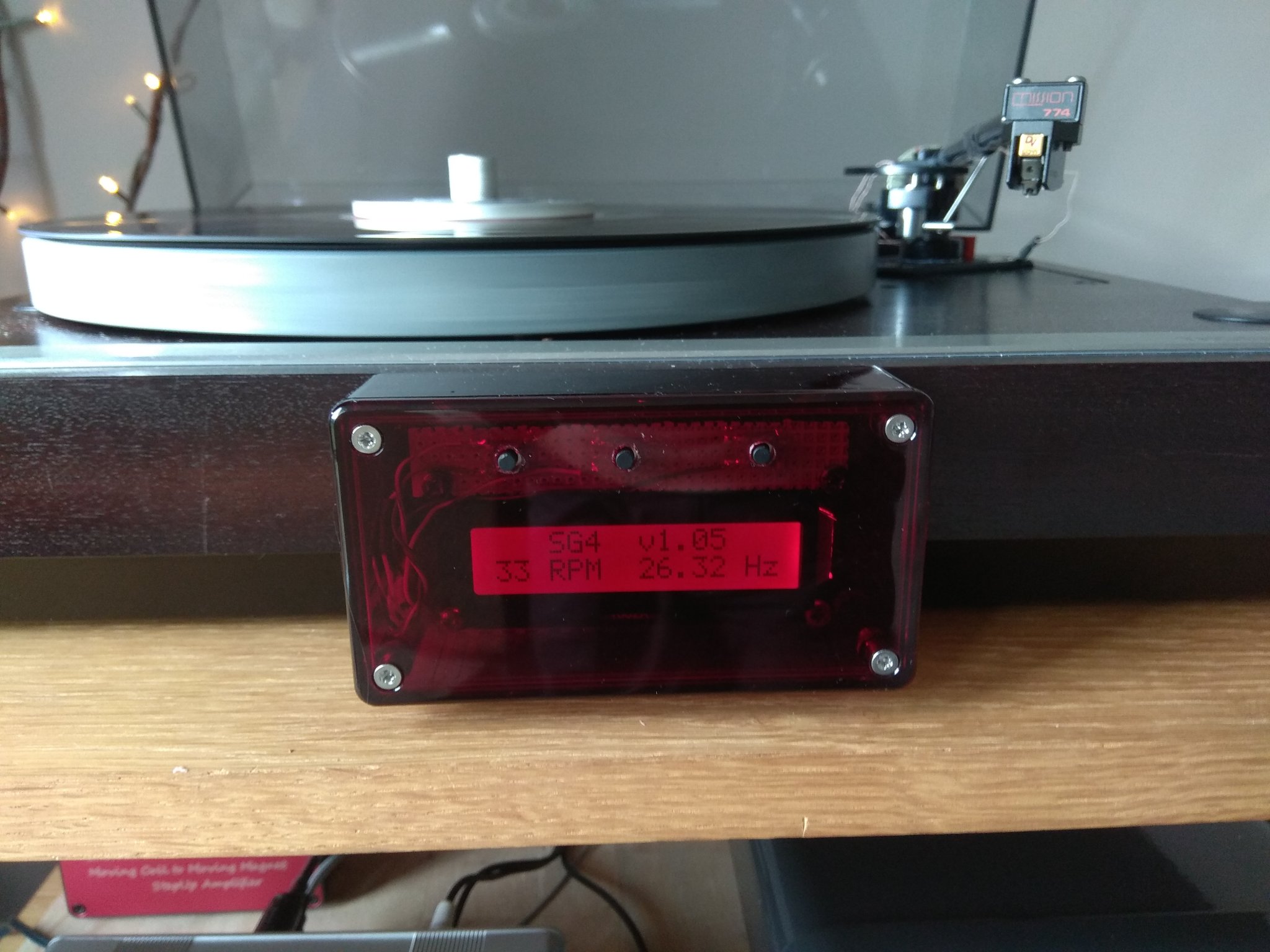

I just finished the version of the SG4 with OLED display. It is cool. I would like to combine the SG4 with an Arduino-based tachometer in the same case but with a single OLED display. It seem to me that data from the SG4 should be able to be fed to the Arduino and added to the OLED controlled by the Arduino. I would appreciate thoughts on whether or not this is feasible and suggestions for how to make it happen.
Here's a link to thread about the Arduino tachometer. It's lengthy and probably not necessary to read it in order to answer my question.

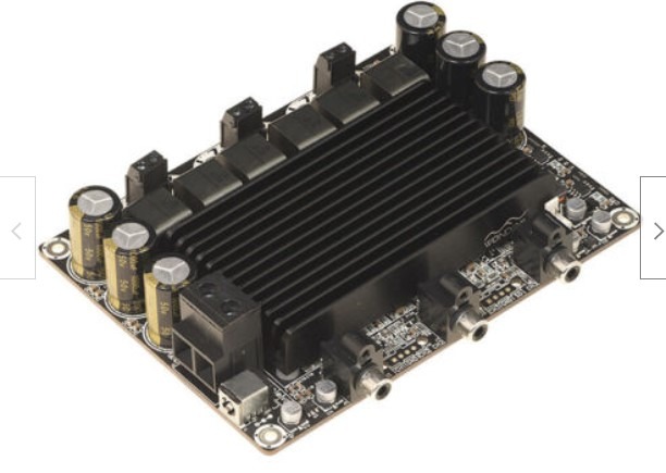

I recently rebuilt my SG4 setup, using 3 x 80VA transformers and a 'Wondon' 3 x 200W class D amplifier. Something I hadn't considered before is the heat at idle that an amp of this size emits. According to the spec sheet the amp is around 90% efficient, and has an idle usage of about 10W. Under normal load, with the large Papst motor the total output is about 45VA, under these conditions the heatsink runs at around 65*C, quite a bit hotter than I like.
There is a built-in 12V fan header, but when this cuts in it is quite noisy, not what I want 🙁 , so I ended up using an 80mm 12v fan fed by a 6V supply, which runs almost completely silently, and keeps the temp down to around 35*C.
The bottom line is that though it's a good idea to allow some headroom, it is quite easy to go overboard. 🙁

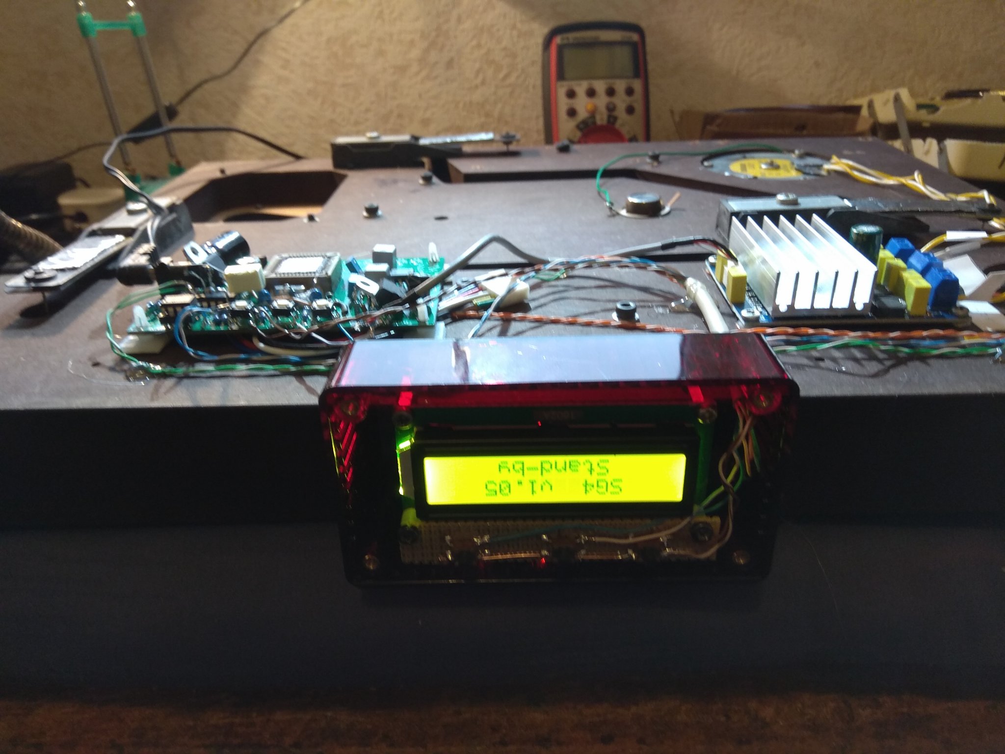

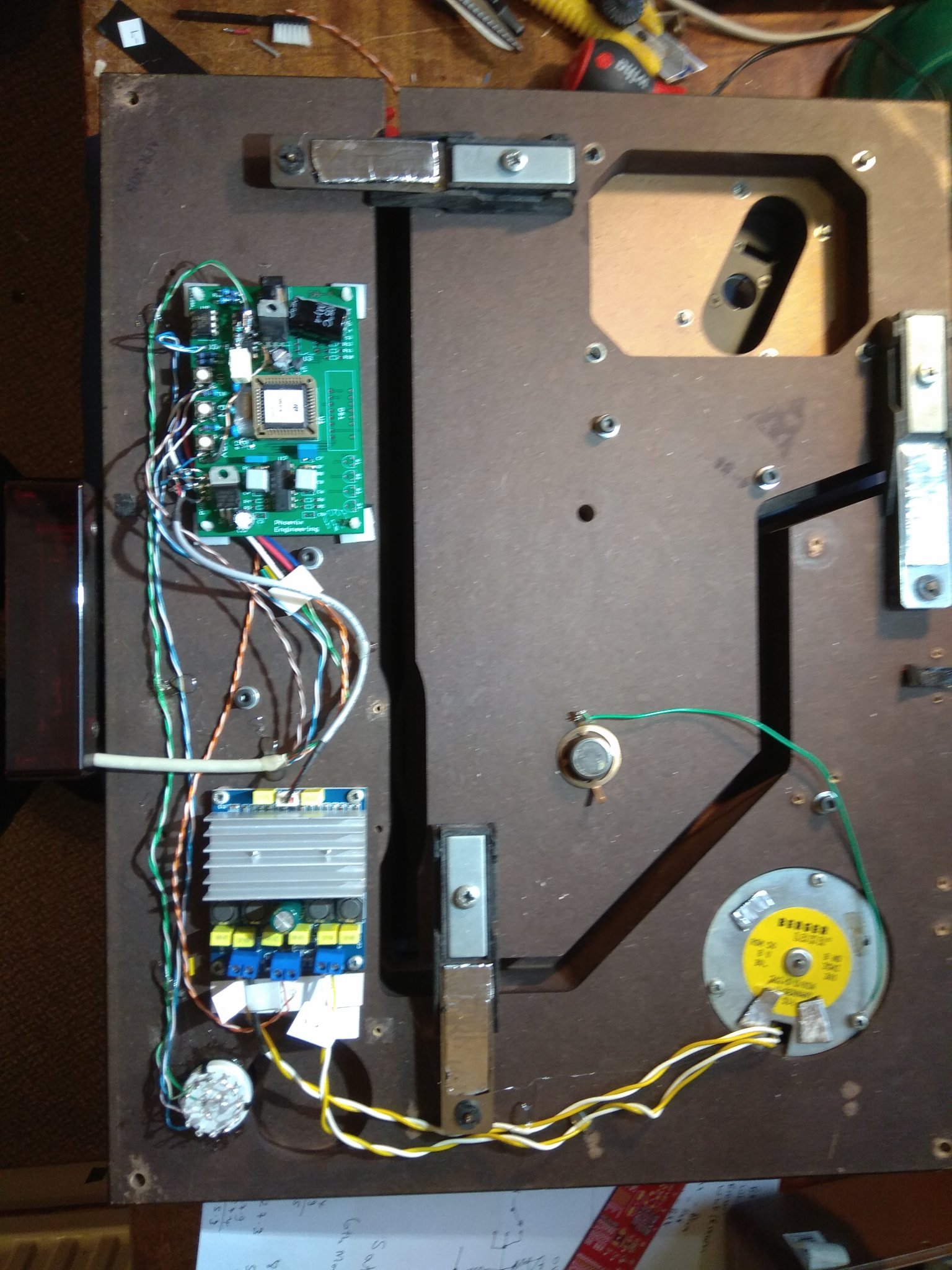

I have completed installation of SG4 into my Thorens TD321 and thought I would share this. It should be applicable to any of the TD300 series turntables. They use a low voltage motor so powering SG4 and the TDA7492 amplifier (ebay) from 12V DC is adequate, the amp drives the motor direct (no step up transformer needed). It was necessary to attenuate the SG4 output otherwise the TDA7492 clips the sine wave output. I set it at max output without clipping with SG4 level at 128, the motor still runs OK with SG4 level at 64 so scope to fine tune.
The TD300's uses a 3 way rotary switch to operate 33 - OFF - 45, some head scratching and I realized a rotary brake before make switch with all the ways paralleled might give the momentary switch action to start/stop the motor and another pole on the switch to 45. This works with help of the 2 spare inverter stages in the 74hc14 on the SG4 board. I'll post more info if anyone is interested. SG4 & TDA7492 amp were installed inside the turntable but the solid wood plinth did not allow the display to be inside as well so I put the display inside a clear plastic Hammond box which at moment is stuck on front of tunrtable with double sided foam table. It includes 3 buttons for setting up SG4.
Regards
Colin
