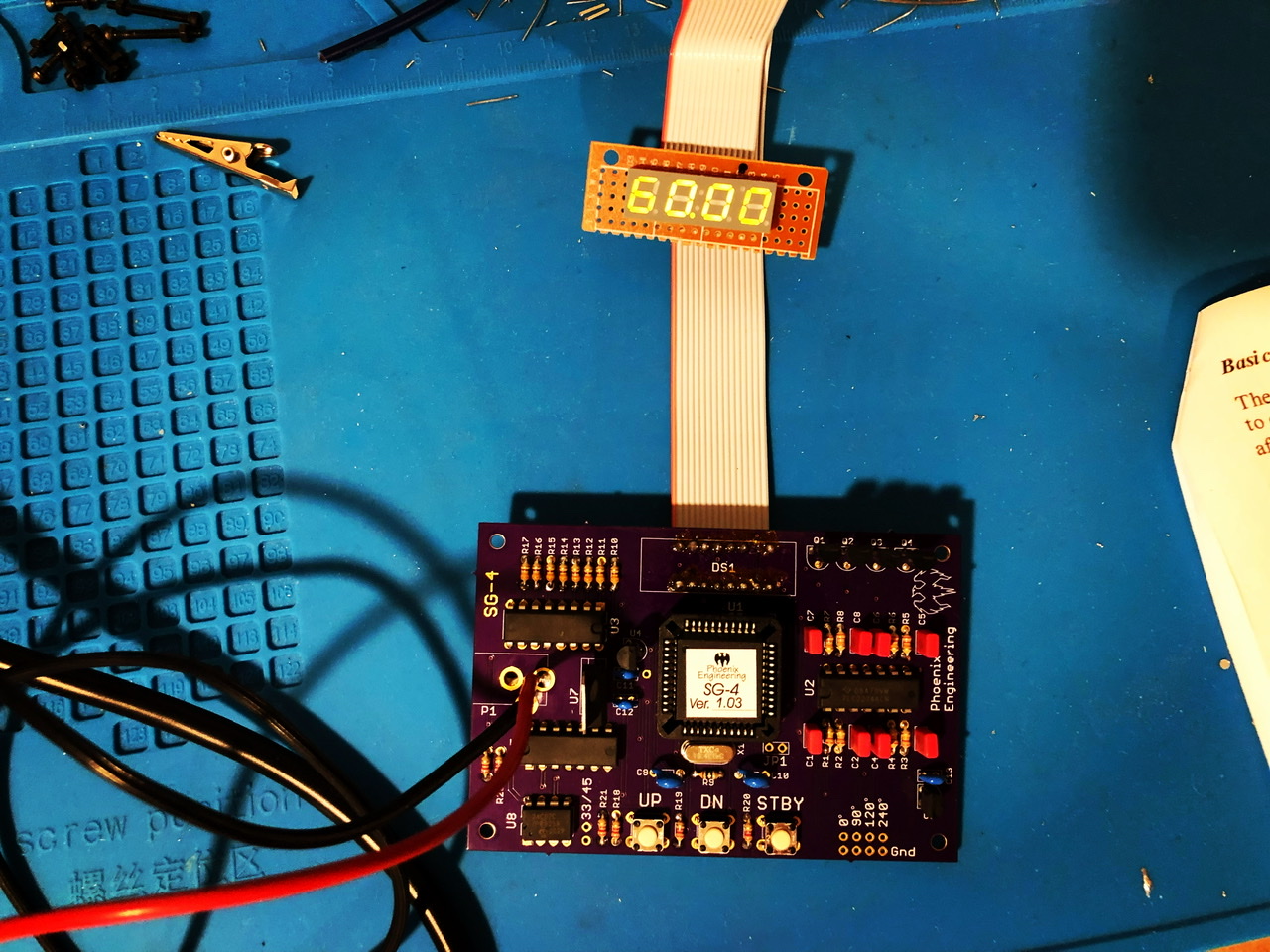

SG4 Complete!
Keeping this thread alive, I completed my SG4 and it powered up the first time today without issue.
Next step is to wire it up to the TDA7492 and 2 Amgis L01-6362 12V toroid transformers to power a 2 phase Hurst motor on my AR turntable.

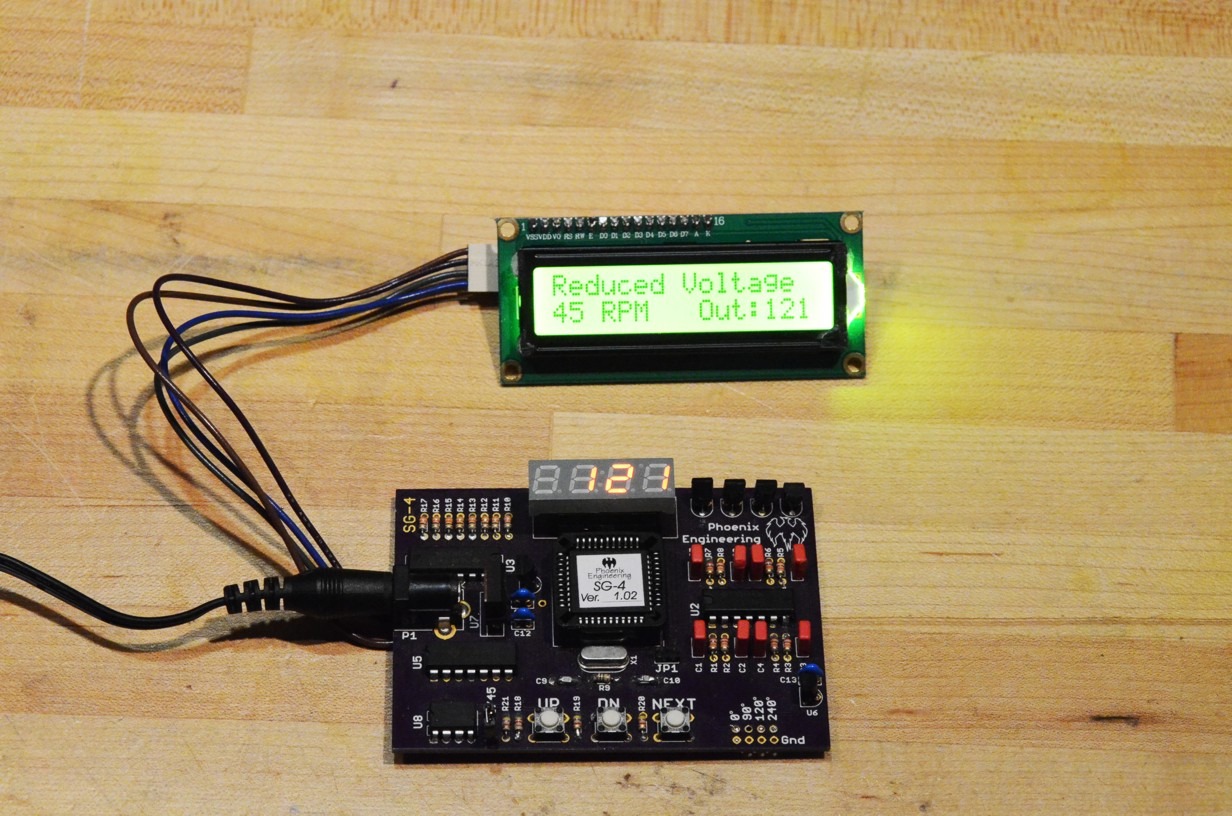

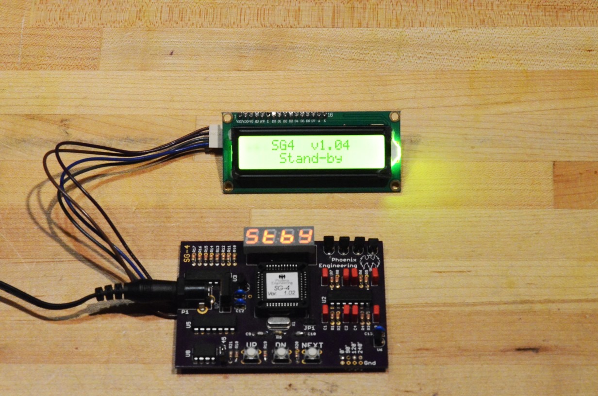

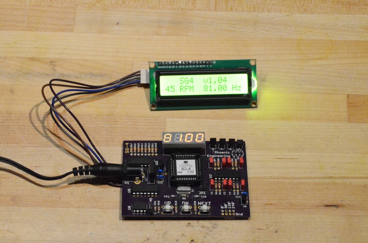

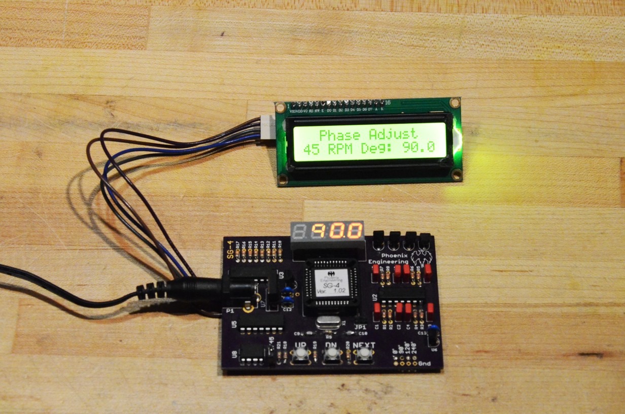

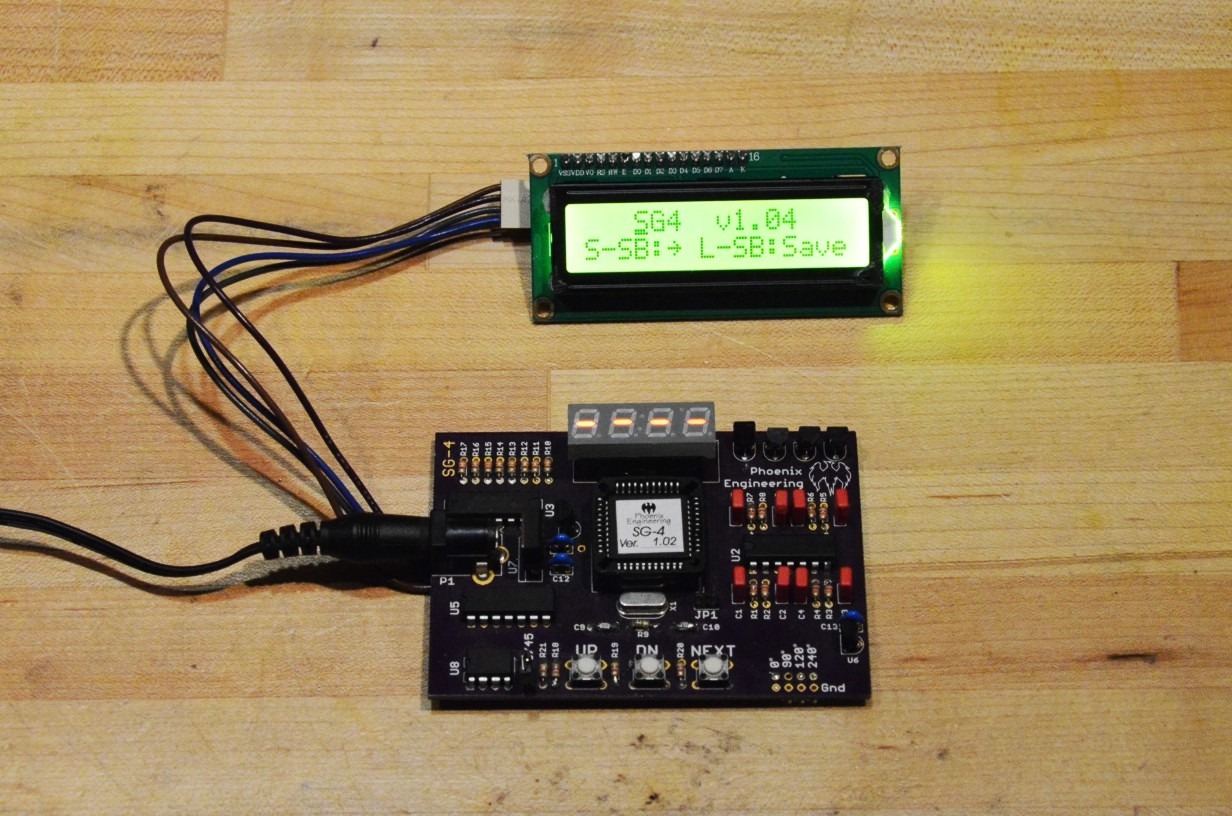

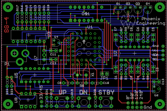

A number of people have inquired about using an LCD display with the SG-4 sinewave generator. I've updated the PCB and firmware to allow both LED and LCD displays concurrently. The link to Oshpark for the PCB has been updated in the O/P as well as a brief description. It is very difficult to add new attachments to the OP, so I will post those here and add a link to this post in the O/P.

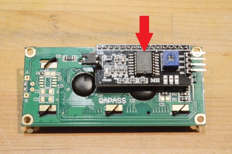

The SG-4 will now have 4 additional pins to interface with an I²C capable 2 line x 16 character LCD module. The LCD module should have an I²C interface attached that utilizes the PCF-8574A interface chip. There are 3 address pins (jumpers) on these PCBs that should all be open (all high) in order for the SG-4 to correctly address the chip. The modules have a 4 wire interface: Gnd, Vcc, SDA, and SCL; the Rev B SG-4 PCB now has these 4 output pins that can be directly wired to the LCD I²C interface PCB.
The LCD capability requires firmware version 1.04 which is also backward compatible with the original (Rev A) SG-4 PCBs. To add an LCD display to the previous version SG-4 PCB, make the 4 connections as shown in the attached PDF (SG4 I2C Interface.pdf).
Both displays can be run concurrently. If the LED display is not needed, U3, DS1, R10-R17 and Q1-Q4 can be left off the PCB. The functionality of the SG-4 remains exactly the same as version 1.03 firmware; version 1.04 adds only the LCD display routines.
The second line of the LCD displays the speed and frequency as well as "Stand-by". In reduced voltage and phase adjust modes, the second line of the LCD displays the speed and voltage or phase.
The top line of the LCD can display 16 characters of free form text; the default text is "SG-4 v1.04" but can be customized by the user to display any English characters the LCD is capable of including A-Z, a-z, space and all punctuation characters. Operation of the customization mode has been added to the assembly instructions (attached to this post). In order to initialize this message on a previous build (updating from firmware v1.03 to v1.04) you must do a factory default reset after installing the new firmware.

The only difference on the PCB is the addition of a 4 pin header for the LCD (Gerbers attached). It is relatively easy to wire a cable for the LCD directly to the original PCB if you want to retro-fit one (see SG4 I2C Interface.pdf in previous post).
Good news is, nothing is obsolete with those PCBs. The new firmware will work with the LED only display or an LCD display can be added with ease to the existing PCB, just hardwired to the appropriate pins. Seth and Ralph have the updated firmware so anything they ship at this point should be forward and backward compatible.
I just received a question that needs clarification: The I²C interface chip for the LCD display must be type PCF-8574A, not PCF-8574. The two chips work nearly the same but have different address schemes; only the PCF-8574A chip will work with the SG-4 firmware change.
The 'A' series chips will have addresses 038h-03fh; the non-series 'A' chips will have addresses 020h-027h on their instruction sheets.

Thanks to all the great notes on this and the other SG4 amp thread, and Pyramid’s excellent design, my SG4 is finally up and running! I notice that the frequency, as measured on my Oscope, dances around a little. I warmed up the SG4 for an hour to see if it stabilized, but I still saw the same little dance between 59.8hz and 60.2hz. The display on the SG4 holds steady at 60.00Hz. Is that normal?
I used the TDA-7492 Amp in my build.
