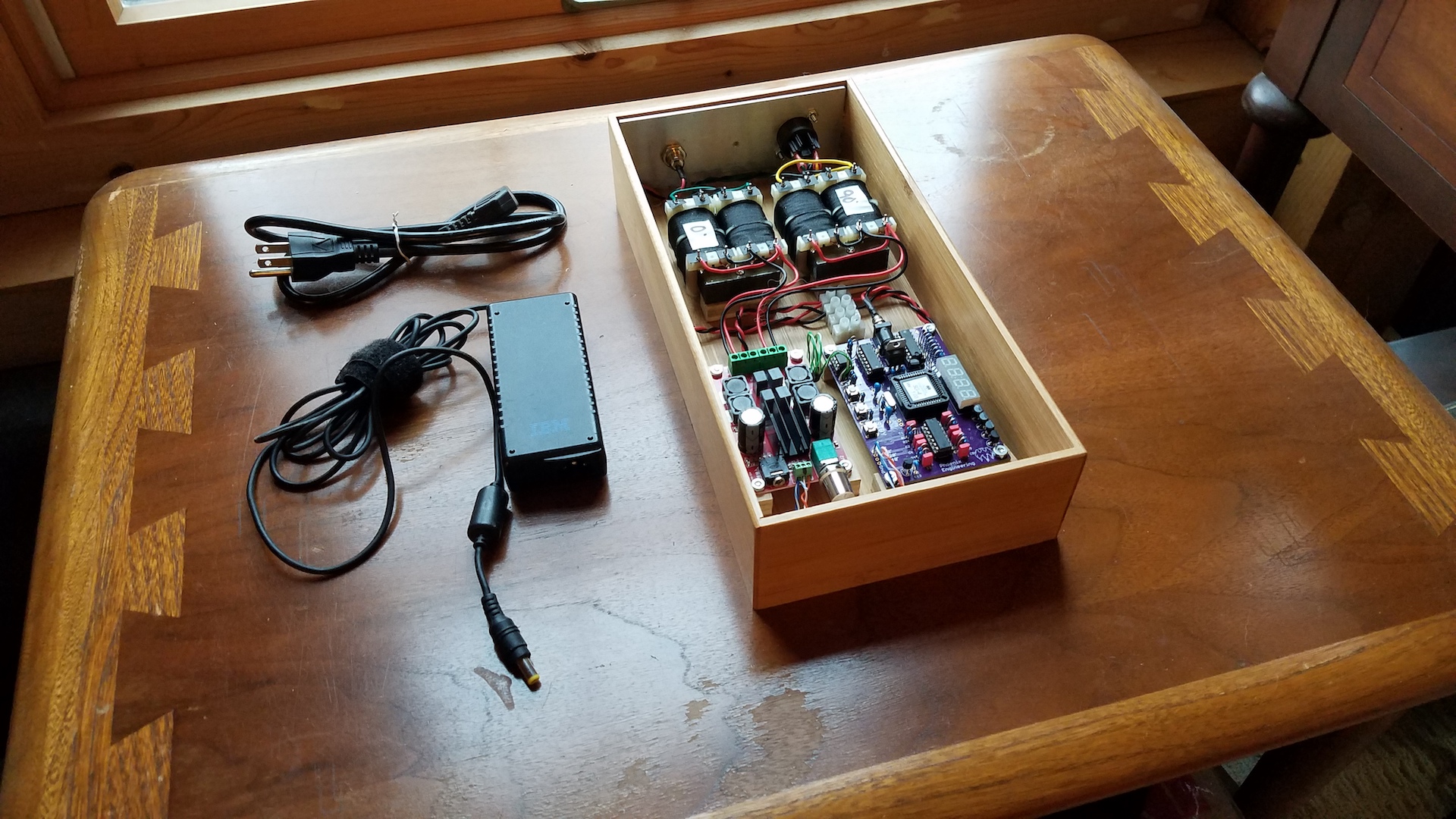

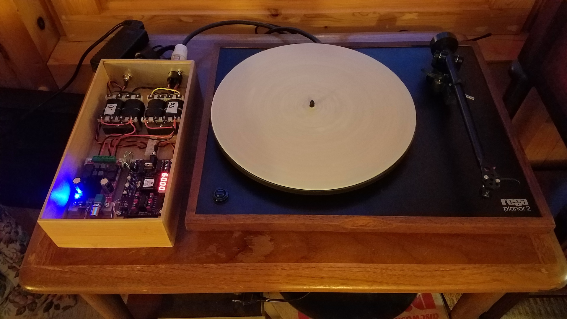

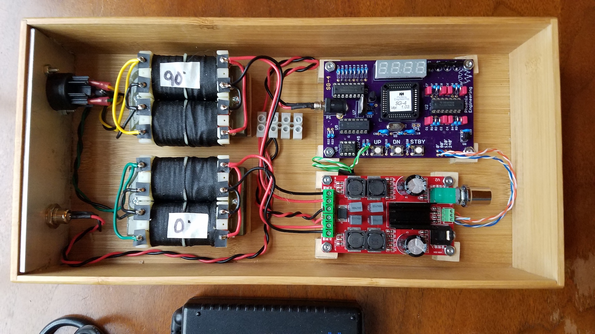

Controller build (almost) finished. Got pics!
I finished and tested the actual SG4 build a few months ago, but it was all just laid out on a piece of plywood and I was only using one channel b/c I hadn't rewired the turntable yet. Put my head down this week and got things mounted up properly.
The case is a simple 6x12 inch bamboo drawer organizer I got off Amazon. Amp is a 2x50W class-D that was on sale at Parts Express. Power is a 16V SMPS taken from an old IBM/Lenovo laptop.
My turntable is an early-80's vintage Rega Planar-2. Purchased from a seller in the UK, the original AC motor was configured for 220V/50Hz operation. I modded the unit to run on 120/60Hz. For this update I removed the internal resistor and cap and rewired the small circuit board for 2-phase operation. It looks stock except for the Neutrix connector on the end of the new power cord. Arm is an Origin Live modded RB250. Nothing fancy but a reasonably decent performer IMNSHO. 🙂
I had to intended to leave the power switch on the front of the deck functional but that didn't work out so well. In the turntable's original single-phase mode with a capacitor, the switch would cut the common power return line. As we all know new supply provides two out-of-phase power leads and the common return. Since the tails of the two coils are tied together before the on-off switch current can pass in on one power lead and return through the other lead. So with the switch off we have effectively wired the coils in series with second one reversed and put ~150VAC across the combination. While probably not enough to get things initially spinning, it is seemingly enough to keep the platter turning. The solution would be to replace the switch with a DPST that would cut the current to both tails separately.
I still have some work to do at this point. I have the rotary encoder board and am figuring out how I want to lay out the front panel. Sharp eyes also will notice the lack of a power switch, lack of an input fuse and the switch to select 45rpm operation is missing (but the leads are there!). Finally, the whole thing needs a cover.
But the fun thing about this hobby is that nothing is ever really finished, is it?
