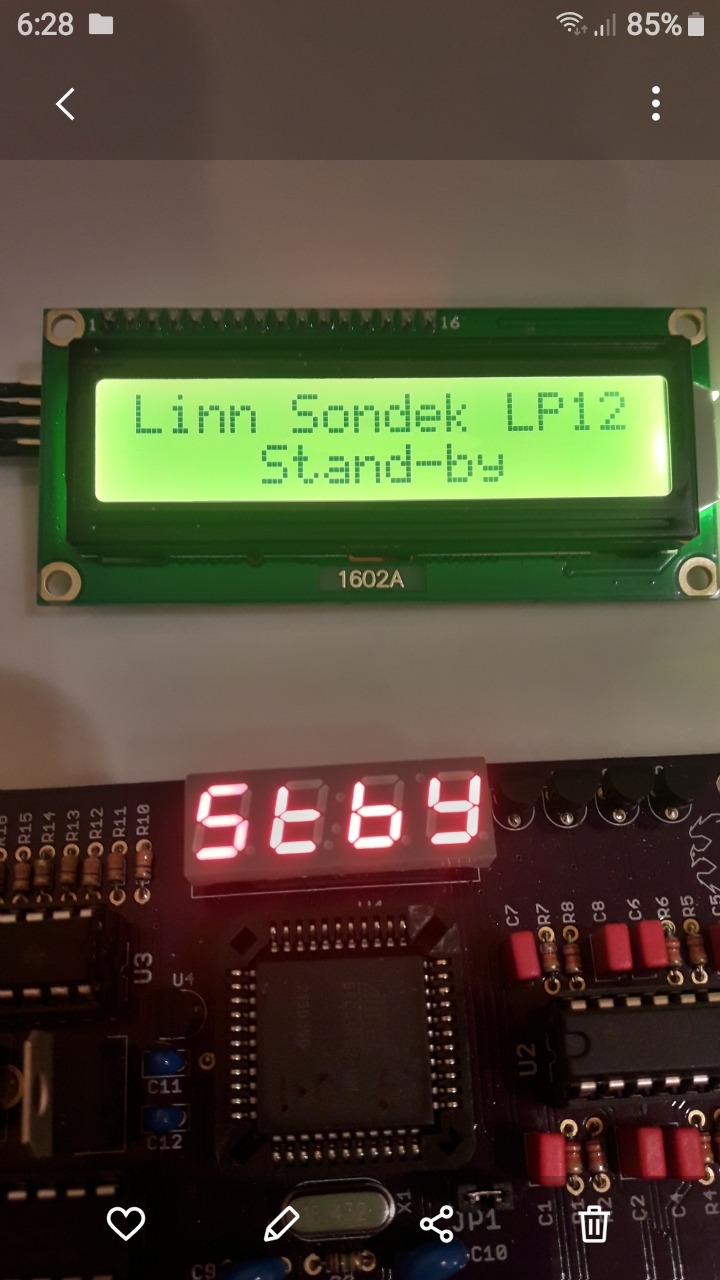

Just a note of thanks to all involved, I put mine together last night and it fired up without a glitch. My TT is still in pieces , so not able to test completely, but frequencies and output voltage looks great. Thank you ..dB

I now have stock of the latest version of the SG4 chip, this is version 1.05, and allows use of both the PCF-8574A and PCF-8574
versions of the LCD panels. If your display doesn't work correctly adding a jumper between TP1 and the adjacent capacitor should fix the problem.
Many thanks to Bill for continuing to support and update this excellent project!
