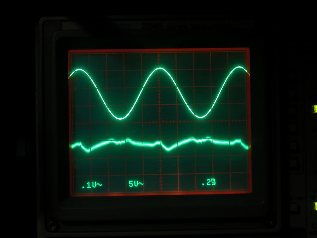

Regarding my Notch filter (2 posts above), with more careful dial adjustments, most of the fundamental is removed....
BEFORE: http://i5.photobucket.com/albums/y177/Midiot/DSCN2745.jpg
NOW:

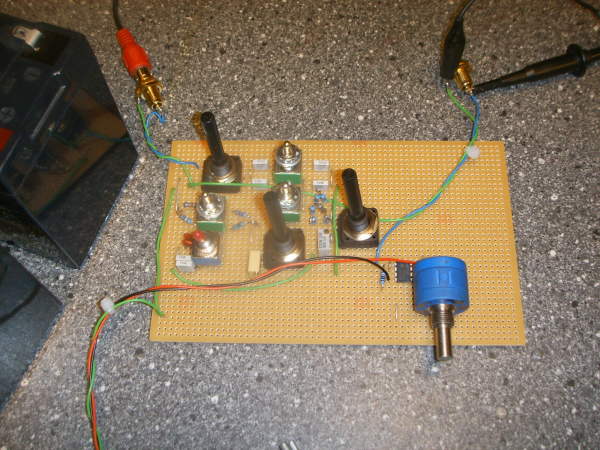

Hi, i have carefully read, and build the RodElliot #52 LINK Distortion analyzer, i will use it for meassuring distortion on some of my diy power/pre-amps. But there are few things i can't figure out.
I am totally, confused about howto use it, after reading it over, a couple of times (more), so therefore i was hoping someone here could help me.
I have made the notch filter, for the following freq. :
408Hz, 995Hz, 4,08KHz, 9,95KHz.
The supply i am using is 2x12v batteries, to give me Ref. / +12vdc / -12vdc.
the opamp i am using is LM833, which operates with +12 / -12vdc according datasheet.
all resistor's, caps are meassured for 1%.
I tried to apply 4v ~1KHz sine directly to the notchfilter, and some nice sine also come's out of the notch. I can regulate the sine/voltage-out etc... so i think the nottchfilter work's, i simply can't figure out howto use it :scratch1:

My Notch:
http://i5.photobucket.com/albums/y177/Midiot/DSCN2753.jpg
http://i5.photobucket.com/albums/y177/Midiot/DSCN2748.jpg
http://i5.photobucket.com/albums/y177/Midiot/DSCN2749.jpg
Rod Elliot's project is a good learning experience. I have a full dist meter, but this diy project was kinda fun for me, anyways.
The switches will "tune" the notch, the pots in Fig. 5, will fine-tune it.
So for the first step, you want to apply a signal freq that is NOT in the freq range of any combination of those switches (de-tune the notch). You don't want to notch (filter) anything for the first step.
Try this using your sig gen only (sine wave). You can insert your preamp (DUT) later, between the sig gen and filter, after you get the hang of it. So for now, you will be measuring the dist of your sig gen.
The first step is to apply a higher voltage freq at the INPUT, and get a lower voltage at the OUTPUT of Rod's filter.
How I do it, is measure the sig gen at it's output, and adjust it to say, @ 4v AC. Turn Q (50k output pot) all the way down.
Connect your sig gen (@4v) to the filter's INPUT. measure the AC volts at the filter's output. Adjust the input pot (10k) until the filter's OUTPUT reads 3v AC.... then don't touch that 10k pot, leave it alone for the duration of the test.
Disconnect the AC meter, and connect the filter's OUTPUT to your scope. You should see a 3v sine wave.
(you can add a splitter at the sig gen output to see "before/after"...one cable to the filter, other to your dual input scope.)
Move the Q pot to mid-way.
Now set the switches to your frequency you want to notch, and make sure your sig gen is set to that freq too. Use "Table 2" to see what position to set the switches.
If you are lucky, you'll see the sine wave reduced. But maybe not.
This is where the fine tuning happens....and this filter is ALL ABOUT the fine tuning!!
In a perfect "Twin-T" filter, all the resistors and caps are perfectly matched to each other in terms of ratio. Highly unlikely in our case. That's the pots' job now....to match up the resistors. The cap matching is what it is.
Caveat: it is EXTREMELY helpful to have a "fine tune" knob on your sig gen.....this helps you "find" the notch, and tune it as well.
I found that my notch filter's range was not what Rod's article stated....but it was close, up or down 5% or so. That is why the sig gen fine tune knob helps. You need to do a little (or a lot) of hunting for the notch. Turning the Q knob down will help you find the notch.
When you seem to have found the notch, it will still need more fine tuning. Raise the Q knob. Fiddle with the filter's pots to reduce the sine wave. Then the "fine tune" on your sig gen, then back and forth until you cannot get it any lower. You want the Q knob all the way up by the end of your fiddling.
Then use the equation in Rod's article, to find dist %.
This is not low enough:
This is better:
http://i5.photobucket.com/albums/y177/Midiot/DSCN2764.jpg

About 2 years later I finally got this working -- it had been sitting on the shelf next to my work station -- shown is the output from a Tektronix programmable SG505 -- the THD+N on the screen works out to be the same as that measured on my AP. When I measured the output from my AP the THD was -112dB. (Edit, it will get to -116dB momentarily).
The "package" from Texas Instruments includes an MMB0 motherboard with a TMS320 DSP processor -- and the software packaged with the unit allows this one screen only although you can change the type of FFT window and whether to use high speed or high accuracy. For $149 it ain't bad
