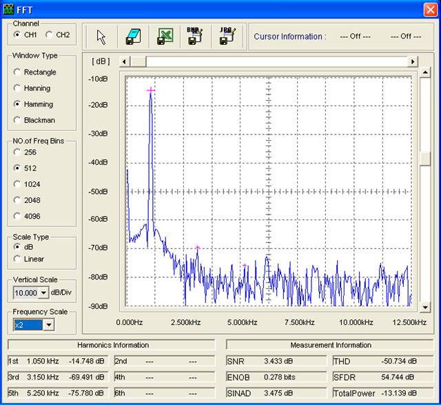

I'm just playing with a DSO-2150USB. I don't know that much about it yet, but it seems to be pretty good. For $200 ish - no complaints.
I have attached a capture of the output of my HP 339A in FFT mode. There is a lot of noise (could be from simply hooking things up in the open). I do notice a 100 MHz emission from it as well.
Anyway, I'm going to keep it. Money reasonably well spent I think.

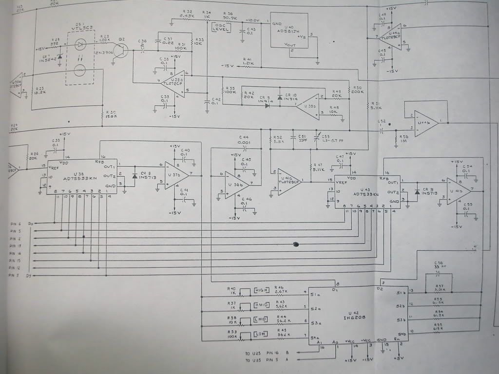

Here's the oscillator schematic....
http://i5.photobucket.com/albums/y177/Midiot/DSCN2734.jpg
http://i5.photobucket.com/albums/y177/Midiot/DSCN2741.jpg

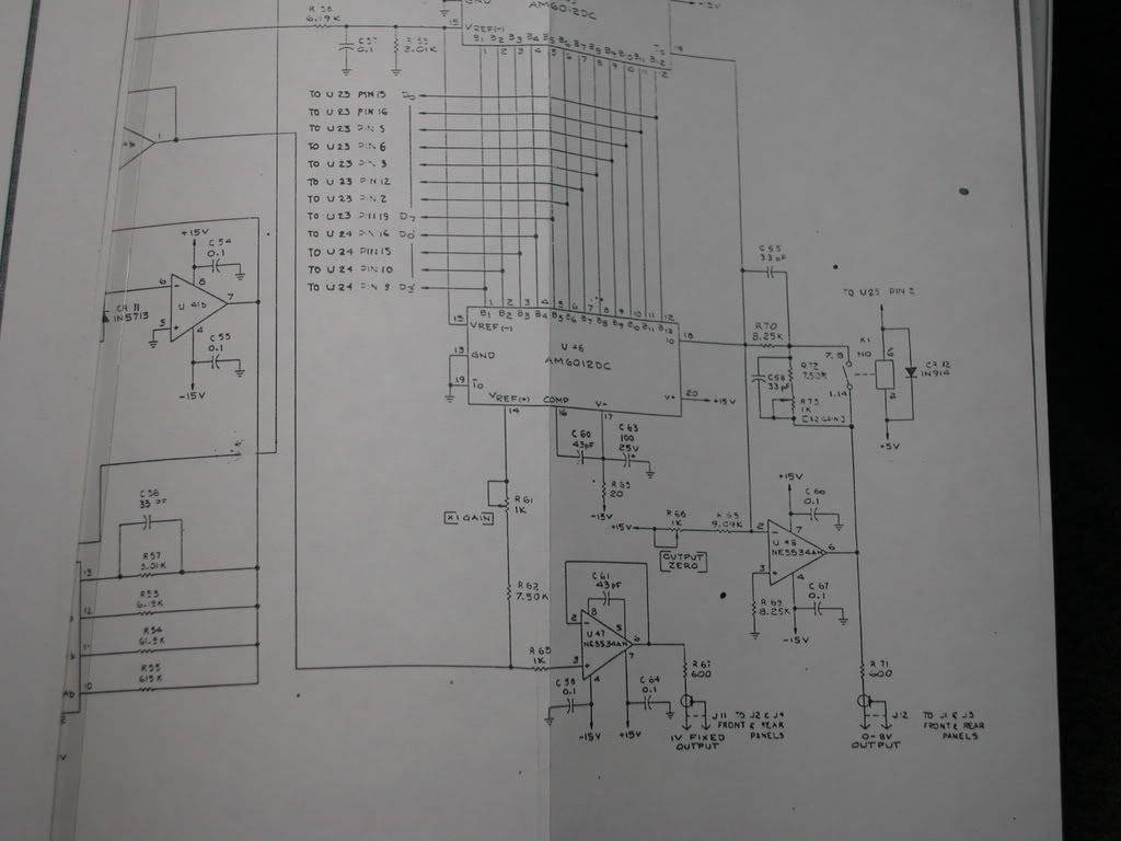

Here is the schematic for the output amp of the Boonton 1120
output amp board
Its good for 16V into 50 Ohms.
output amp board

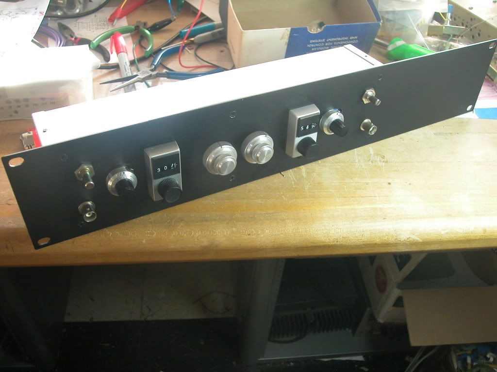

I've built a Notch Filter, from Rod Elliot's site.
It seems I can reasonably measure distortion with just this filter and am AC volt/millivolt meter.
...although I intend to use it to improve the dynamic range on my older Spectrum Analyzer.
Here (again) is a link to his project:
http://sound.westhost.com/project52.htm
Here is my cross post
from Rod's forum:
I thought I'd share this, for what it' worth.
=RR=
I've finished it.
It seems to be working.

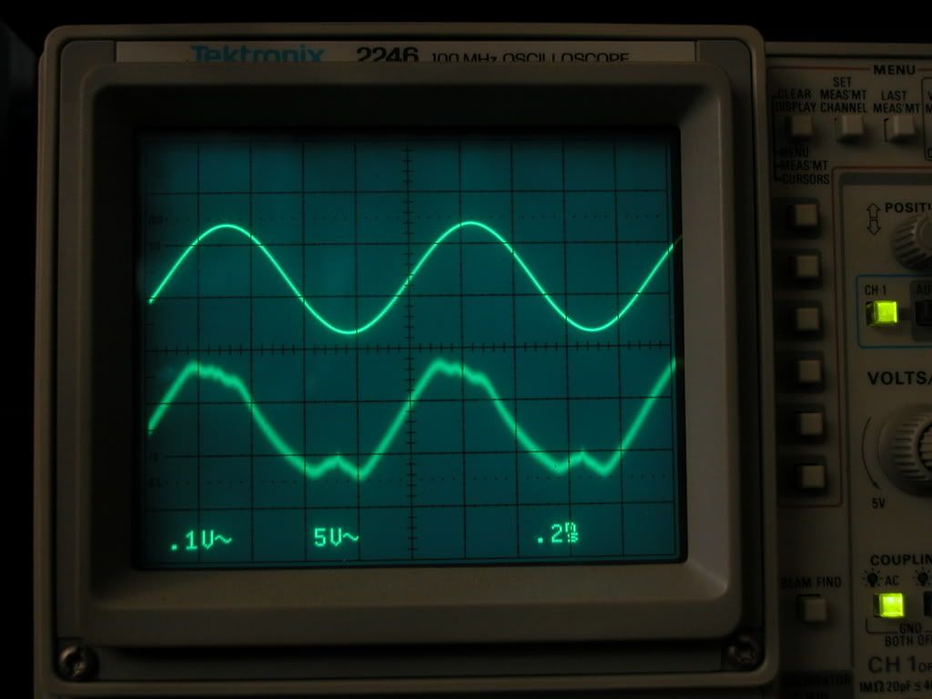

Can you look at this waveform, and confirm for me?
http://i5.photobucket.com/albums/y177/Midiot/DSCN2745.jpg
Frequency (around 1k) is directly from my function generator.
The upper waveform is the unfiltered signal...and the lower is the filtered output of that waveform, using Rod's Notch Filter (P52).
(note: the upper waveform is a 5v reading, the lower is a 0.1v reading.)
I believe my function generator (the source) is about 0.2% THD, according to the manual.
I'm still not to sure about the grounding. Right now, everything is grounded to the case......BNC IN/OUT jacks, pot ground tabs, and the PSU 0v. But nothing is grounded to earth. When rack-mounting this, to eliminate an earth-ground, I can use plactic screws and washers if it ever becomes an issue.
I found that using an analog AC millivolt meter at the output....allowed me to dial-in the lowest setting, then switch to the O'scope to view it.

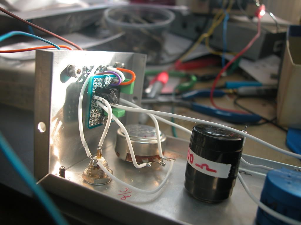

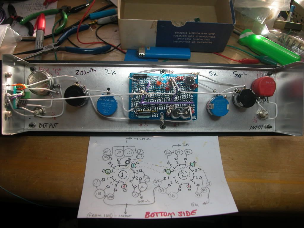

I used two 3-pole, 3 position rotary switches attached to a circuit board. This is like "air wiring" them, because they are point-to-point wired, and the board is just a means to support them.
I probably went overkill on the 10-turn pots. I don't think I needed 4 multiturns (2k & 200 ohm, 5k & 500 ohm)...I could have gotten away with 2 standard pots (2k, 5k) ant only two multiturn (200 ohm, 500 ohm). With 4 multiturns, the smaller ohm-ed pots don't do much.
The 10k input pot is a 1 watt wirewound, the 50k "Q" pot is a good carbon type, both single turn.
The dual opamp is an OPA2134PA.
Power supply is outside the case (not shown).
Here are some pics of the finished unit.
(I still need two knobs !!)
close-ups:
http://i5.photobucket.com/albums/y177/Midiot/DSCN2749.jpg
http://i5.photobucket.com/albums/y177/Midiot/DSCN2752.jpg
