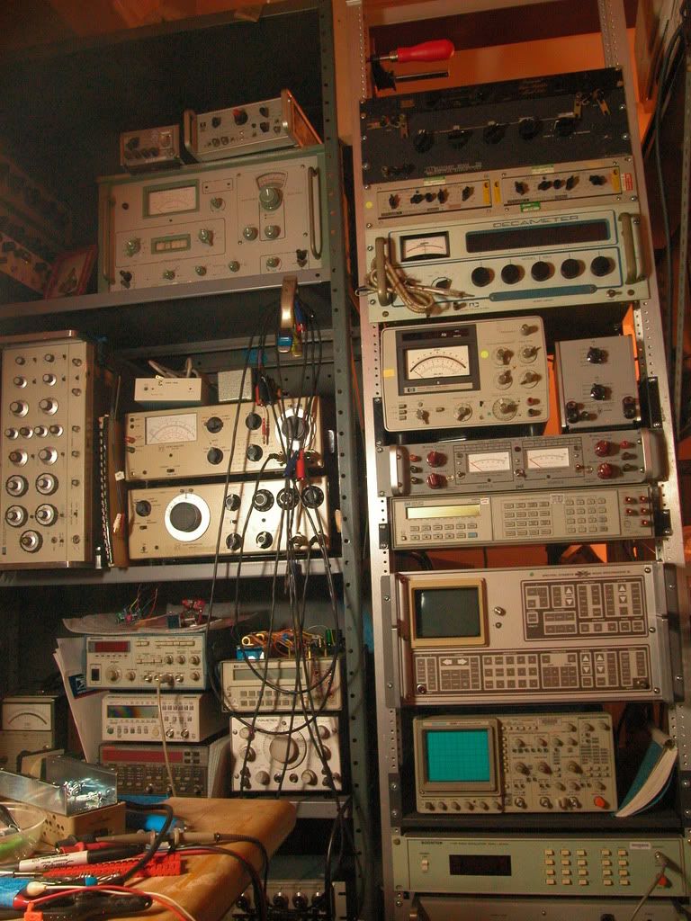

I am reviewing the 3581a manual....forgive my novice-ness....to "get" or "see" results from this unit (plot/graph), a digital storage scope or XY plotter is needed too ? I only have an analog scope.
I've been buying stuff lately (so I have a lot of manual reading to do)... these:
HP 3581a ($20)
Spectral Dynamics SD345 II ($600)
Spectral Dynamics SD375 II ($100)
Hrohn-Hite 3800 tracking filter ($100)
http://i5.photobucket.com/albums/y177/Midiot/DSCN2695.jpg
I think I paid too much for the $600 spectrum analyzer, because I just got it's bigger brother (SD375) for $100.....go figure ??
The SD3xx above looks like a good budget Ebay find....they pop up now and then. I made sure the buyer would guarantee it would not be DOA, serviceability might be difficult. Mine work great so far.

The audio analyzer removes the fundamental so you don't need the dynamic range and then the other stuff is easy to see.
Those FFT's have a substantial learning curve. They can do a lot but the controls are not simple. Do they have GPIB on them? They also are limited by the A to D stage which by modern sound card standards is pretty obsolete.

Its the 12 bit converter. State of the art when it was made and the most expensive component in the box, today you can get 8 on a single piece of silicon that sample at much higher frequencies.
However with the preconditioning of the distortion analyzer all the stuff of interest is well within 8 bits. It does have GPIB so you can write software to get it to measure and export lots of things if you want to.
You can use the 3581A without any external indicator, although an x-y chart recorder is nice. I owned a very nice one, and paid through the nose for it on eBay in 2000, sold it last year for well under half that amount. I never used it.
Use the meter readout, record the frequency and amplitude relative to the fundamental for all of the spurs.. Measure the noise floor between the spurs -iirc the 3581A can do that too. Then enter them in excel or a comparable open source spreadsheet (open office) and graph them. Not having tried this I can't attest to the ease of the approach relative to the effort involved, but the technique would not be too different from the way WE measured the THD of tubes like the 300B originally.

Note even with the 12bit analyzer you can notch out the fundamental externally, gain up the remaining distortion products and effectively window the available dynamic range to provide additional resolution. (Effectively pushing down the noise floor by the amount of the additional gain - note however that you still have a dynamic range "window" of only 70dB or so, referenced to FS - XdB.)
Any ideas for a very quiet notch filter ?
Either a pre-made product, or DIY ?
If I go looking at some older filter units, e.g. Krohn Hite, what would I look for ?
(I'm a bit filter dyslexic...can a notch be created by a high pass and low pass filter, ...but not quite overlapping ?)

I already have these:
Wavetek/Rockland Brickwall filter (yes, it does shift the phase)
http://www.tucker.com/images/images_spec/00004498.pdf
Krohn Hite 3800 tracking filter
http://www.tucker.com/images/images_spec/00002582.pdf

What do you want the notch filter for?
If you are chasing ultra low distortion you need a passive filter. There are simple twin-t filters that with fine tuning of the resistors can have very deep notches at a specific frequency. And you will spend a lot of time dialing them in. They are useful for optimizing the distortion of ultra low distortion oscillators and similar tasks but way cumbersome for regular measurements. Both Bruel & Kjaer and Daven made passive tunable filters that are OK (I have both but they are mostly curiosities).
The KH is a very interesting ultra-narrow band pass filter. It can be used to separate the harmonics in a low distortion source. It won't become a notch filter. The more conventional filters from KH can, but again not easily. Do you have a manual for it? (I have one also and no manual.)
