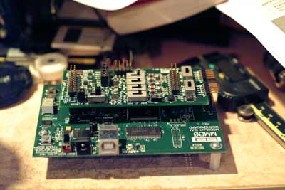

jackinnj: " ... TI just sent me the schematic for the MMB0 motherboard ..."
I just ordered the TI kit ( http://focus.ti.com/docs/toolsw/folders/print/ads1271evm-pdk.html )
... I'm surprised they don't include the MMB0 motherboard with it 😱
Now I guess I'll have to build it. 🙄

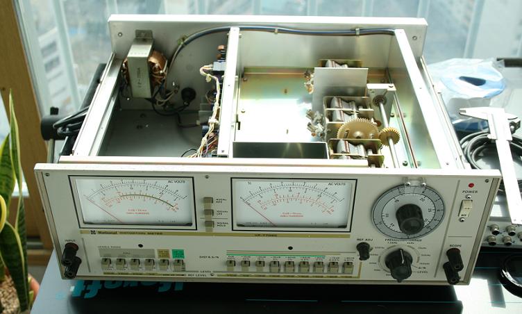

Bought this at about USD65 🙂
It's National distortion meter VP-7702C.
It's with a transformer of primary 110VAC 🙁
No user manual :bawling:
I don't know how to use this :bawling:
Wife doesn't understand this buying, and looking at me as mad :bawling:
I opened the cover to see any possibility for me to switch the primary from 110VAC to 220VAV . . .
Any tip . . . ?

From the Koreans: http://www.triode.co.kr/zbxe/?document_srl=59219 Nice internal pictures.
" Wife doesn't understand ...."
Mine either ... But I convinced Her that it was for my hobby that may someday turn into a vocation = a learning experience that I could never get from a school ...
" No user manual ..."
Well, just don't make any internal adjustments until you find out how and have a good reference source.
I will bet that you have to rewire the transformer to accomplish the 110 to 220 change over.
Get the transformer model numbers and do a web search ...
The simplest method is to get an external step down transformer 220v to 110v and connect the instrument to that. That way you will be sure that you don't need to touch the insides of the instrument and 'possibly' let Murphy in.😀
That would be catastrophic and give enough reason for your wife to throw it out !:hot:
