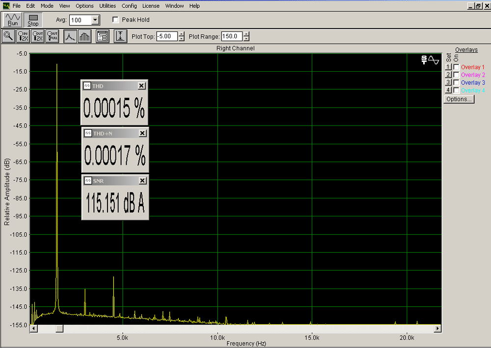

The SG505 will get down to 0.0004% THD+N% it's just not automated.
To see the residual you just connect a sound card analysis FFT program to the "Function Output" of the AA501 -- you could probably use software as inexpensive as Audacity for this. You can also see how well the fundamental is notched out, and what kind of birdies you're picking up...
My TM503 just came in yesterday, slipped in the SG505 and hooked it to my MAudio 192 card. Right off the bat, after optimizing the input level, it had about 0.00015% THD
You may be able to do better, but I'm happy for now

Nice, I presume you looked at the oscillator of the 505? And what do you get if you use a notch filter? Then you have really the distortion of the oscillator.

Pjotr said:Nice, I presume you looked at the oscillator of the 505? And what do you get if you use a notch filter? Then you have really the distortion of the oscillator.
Yes, the SG505 feeds the M-Audio Audiophile 192 via a short BNC cable.
http://www.m-audio.com/products/en_us/Audiophile192.html
I have not yet tried a notch. With a notch you eliminate the fundamental, but introduce the notch filter electronics - noise, etc. At this level, everything is important. Perhaps a passive notch would work. Then impedance matching is not to be ignored. Not sure the notched output from distortion analyzers would get THD much lower than 0.00015%, but only one way to know.
Ultimately, I think low level, low frequency non-harmonic noise in the M-Audio card is the limiting factor, at about -115 to -120dB. Another card may do better here, or perhaps using it in an outboard PCI card carrier (Magma) to get out of the PC backplane noise environment may also help. I'll post the plot referenced in my above post later.
" ... or perhaps using it in an outboard PCI card carrier (Magma) to get out of the PC backplane noise environment may also help. ..."
No question about that!
Or maybe M-Audio's pure external devices = they do have better specs than the plugin cards, right outta the box. 😉

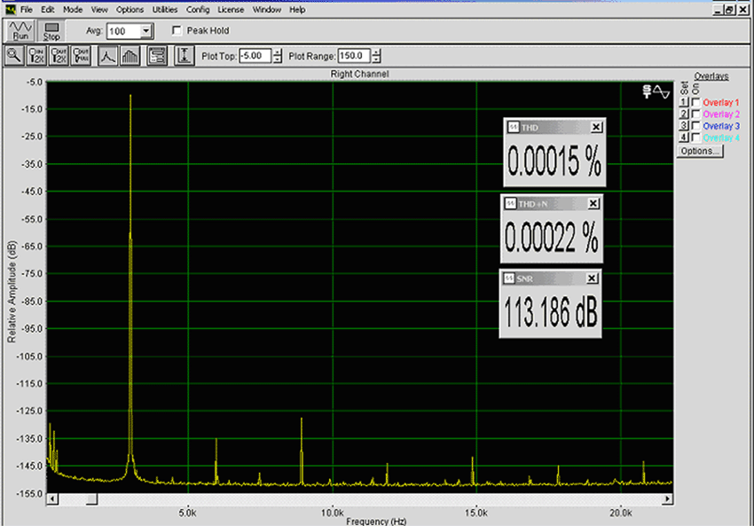

Ehh, have a look at the plot I posted at post #261. That is a PCI card straight inside the PC!
Anyway USB/FW devices are also powered from the noisy PC psu, unless you use an external powered hub. But the ones I tried (E-MU, M-Audio Transit and M-Audio Duo) didn’t perform any better even powered external.

Maybe you meant another one, or I'm missing it? Not the one in your link, the 192 easily beats it according to their specs. Look in the line input only, as we are using an external source.

Have a look at Bob’s results. My PCI card gives comparable results --> spurs well below –140 dB and that with the soundcard itself used as generator.
Being of the old school is not a bad thing (maybe my school is even older 😀 ) but that is no excuse to believe in general statements that doesn’t hold in practice.
