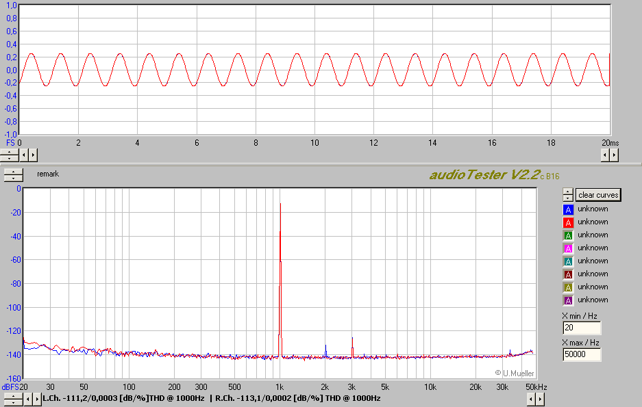

Attached a screen shot of my M-audio Audiphile 192 card in loop through (line out connected to line in) measured with Audiotester. Audiotester will cost you €35.
But I personally prefer ARTA for most of the work. Both programs have their advantages.

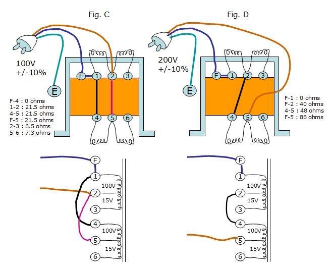

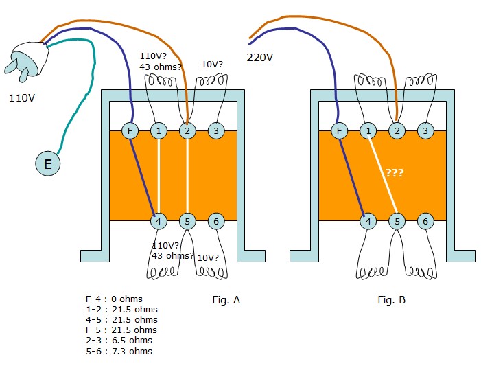

I really would like to modify the power supply from 110VAC to 220VAC for my new VP-7702C.
Fig, A is as wired for 110VAC (factory setting). The primary coils are assumed and drawn based on the resistance measurement with my DMM.
Fig. B is a guesswork based on Fig. A. Could I find the 220VAC setting by measuring resistances between the connection nodes?
Any advice?

For safety (of the equipment), I will disconnect the secondary wires . . . until I'm 100% sure . . .
" ... For safety (of the equipment), I will disconnect the secondary wires . . . until I'm 100% sure . . . "
Good show! 😀
Good show! 😀
anatech said:
... and use some current limiting in case you get the phases reversed on one winding.
Yeah, I should . . .
Anyhow, I believe that my Fig. A and B in post #263 are wrong.
I have changed Fig. A to Fig. C and Fig. B to Fig. D.

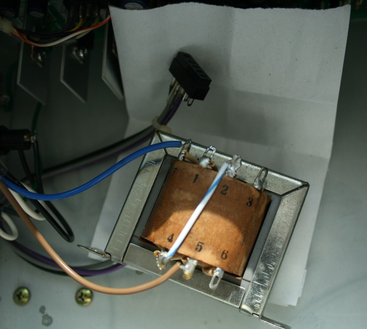

From the original VP-7702C, I can see only the blue, brown, black and pink wires in Fig. C. The resistance values are as measured, and the coils are drawn as assumed.
My plan is as shown in Fig. D. The resistance values are as measured. And, I have sent this copy to a Korean diyer who has made the voltage conversion from 110 to 220V with the same equipment, and I have just got his confirmation that Fig. D would work.
So, I'm gonna go ahead as in Fig. D . . .
Am I too fearless . . . ?

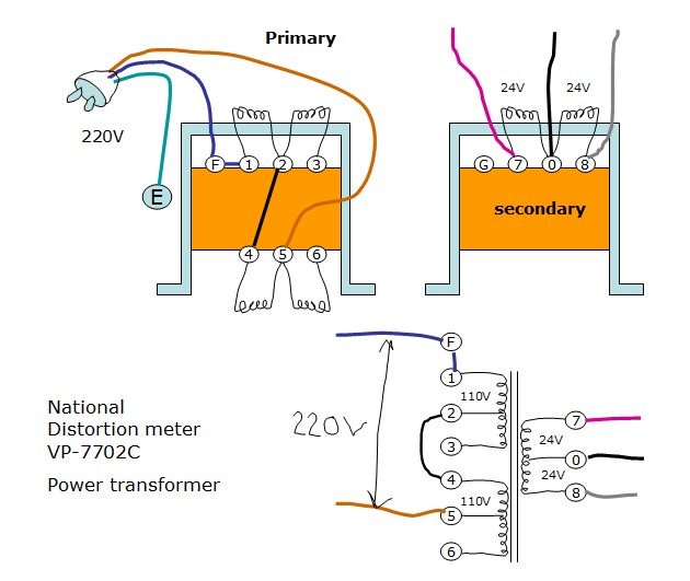

It seems that I've been lucky in the voltage setting to 220VAC.
I've changed the wire arrangement as shown for 220VAC.
All work! And, I measure secondary voltages of 24-0-24 VAC.
If someone buy VP-7702C, he or she could refer to this info about the power transformer.
