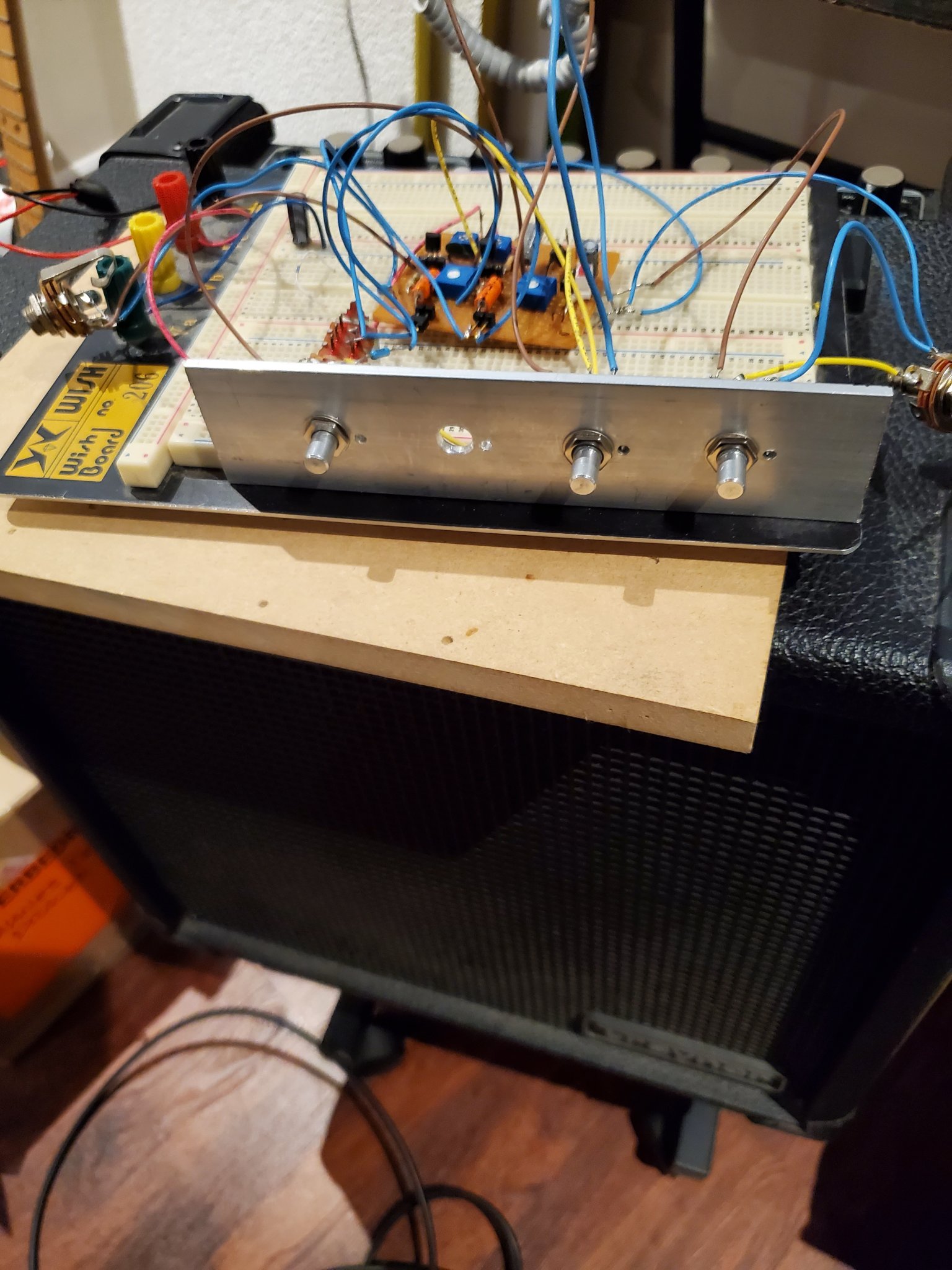

I'm developing doubts that that single stage with pre- and post- EQ is going to be sufficient to get quite what I'm looking for. But I'm going to (Real Soon Now (tm) - in my usual lazy way) build a second clipping board (it's two wires and a little hot glue to swap it out) with 20db of non-linearity

What I do know is that Si diode (0.7V) to 4.7 V (ish - can't recall exact value) chain is not enough.
This was the output of the Mark I board at the sweet spot, but it kicked in too late and then hard clipped quickly (at about 5v )
2021-12-p15r_mods2-jpg.1009884
Didn't sound as good as a single-12AX7-into-6L6 amp. That's got a master volume and just the preamp alone sounds better. Back to the drawing board!
(I've just got to find the original sketch to remember the resistor values - or tear it out and check)
Use Schottky diodes (germaniums may work as well but are less obtainable) to get more "distortion points" over the +/-15V range, and/or use higher voltage op-amps (5532/5534) for a little bit extra dynamic range, or just use higher voltage discrete transistors. I may be doing this myself. I already have ideas in LTspice.
I will be using Shottkys for the first step on the next attempt. The voltage rails, op amp, Rout (1k) and Rload (c.80K) are fixed as the clipper board replaces the back-to-back red LEDs in a Vox Pathfinder 15R. It makes audible testing easy as I've added a DPDT centre-off switch to toggle between diodes, nothing and the clipper board. See this thread

Would you consider adding another asymmetric waveshaping stage, in addition to your new diode/resistance board you are planning? Having a look at the schem for the Vox amp, if I am correct there's a R7 on IC1B which is 470 K Ohm, I'd suggest just connecting a single Si diode across that and check the output of stage. With the series resistance of 100K or so in the NFB, there should be a gentle squish on half the wave cycle. It is similar to my JFet with Soft Limiting shunt feedback. It may be very subtle but I hear a difference comparing with/without the diode in the feedback loop. It should only add a low % of H2 harmonic..warming up the sound.. Cheers!
OK, I'm going to have to try that. Fun bit is I've already done the "gain mod" so I need to think about interactions that arise.
(for those at home, that's the pot in this schematic, which is not there in the stock amp.)
Yes that extra gain pot may affect the response as it's in parallel with the NFB when Q1 is turned off, thus lowering the overall gain. When Q1 is on you probably won't see much, if any 1/2 cycle soft limiting as R8 is much lower resistance than the R6+R7 leg. On my JFET shunt limiter I made the resistance across the diode variable, which would be on this circuit equivalent to the R7. Varying that R affects both the overall stage gain and amount of 1/2 cycle squish. I am trying to figure out how to impart some dynamic bias shift on this particular op amp stage, it's a bit difficult because you'd have to do some changes on the input configuration. I have some ideas but haven't built up and tested the circuit to prove it out yet.
