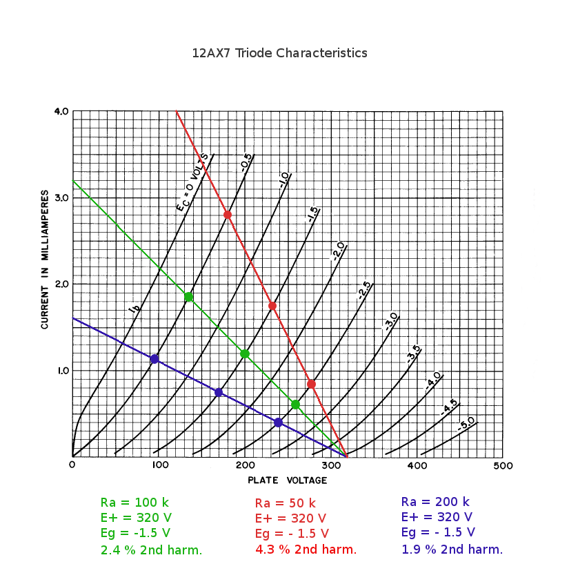

I have a lot of catching up to do but this graph may be of more use.Before we all go too far down the road of creating increasingly complex BJTs together, to create increasingly complex circuits that have rather tightly curved nonlinear transfer functions, I thought that it might be helpful to remind ourselves what the transfer function of the most commonly used preamp tube actually looks like.
The attached image is taken from the datasheet for a 12AX7, and shows the curves for one of the two vacuum triodes it contains.
Note how very subtle the curvature is. This is what we need to reproduce if we want a solid state guitar amplifier to be capable of sounds similar to a valve one.
Tightly curved transfer functions shift abruptly from "too clean" to "too dirty", and that's the problem with all these BJT-based circuits. Everything we can do with diodes iand BJTs s hamstrung by the fact that diodes have such a sharp curvature to their transfer function.
-Gnobuddy
Umm, does that mean for guitar, you want the signal down in the curvy part, vs the straight part?but this graph may be of more use.
That happens in a starved triode preamp, such as in Real Tube distortion pedals, fed meager 9V to 12V rails; now in a normal preamp, you drive it hard so it reaches clipping; top peak will be flattened when it reaches +B ; bottom one will be rounded and never actually reach ground.
Part of "tube sound".
Designers play with that and choose idle bias so when swinging hard it reaches top first, bottom first, different degrees of symmetry or asymmetry, etc.
It´s a complex interactive situation, full of nuances, and those thinking "just throwing a tube in the recipe" is enough, should think again.

So, you're going up and down that whole load line, the one at 250V, clipping at each end? Then you could reduce the bias / drive signal combination and at the same time reduce the plate voltage to have the signal ride anywhere on the family of curves in between 250 and 110V. If you compensated for the drive reduction at the output also simultaneously, then you'd have a clean to let's call it "enriched" curve control, via the more continuous bend in the tube curve.you drive it hard so it reaches clipping; top peak will be flattened when it reaches +B ; bottom one will be rounded and never actually reach ground.
It would be cool to have a single knob change the operating point of the tube, while keeping the stage's gain the same
Yes, that´s the "normal" way in Rock/Metal amplifiers smashing plates against rails.So, you're going up and down that whole load line, the one at 250V, clipping at each end?

Yes, but the continuous bend happens at lower voltages, say around 60V or so, swinging some 20V higher or lower.Then you could reduce the bias / drive signal combination and at the same time reduce the plate voltage to have the signal ride anywhere on the family of curves in between 250 and 110V. If you compensated for the drive reduction at the output also simultaneously, then you'd have a clean to let's call it "enriched" curve control, via the more continuous bend in the tube curve.
At high voltages (110 to 250V) curves are quite linear.
