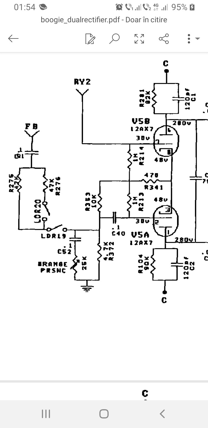

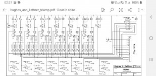

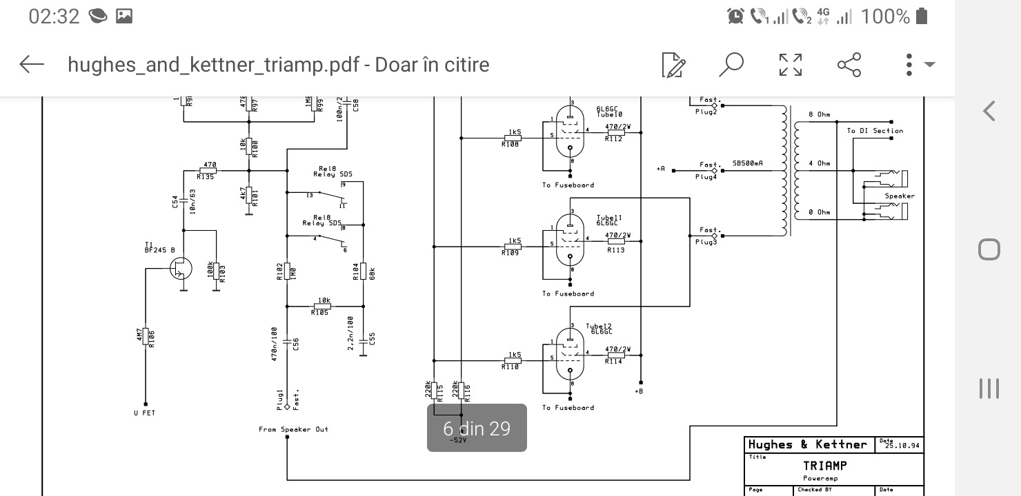

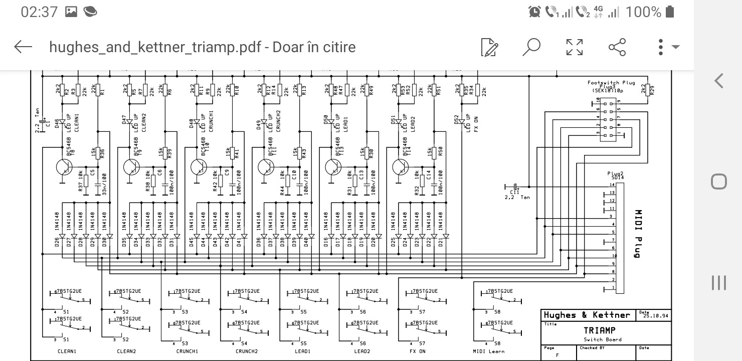

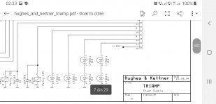

Same with Huges & Kettner Triamp soldano clone where only Clean, crunch 1 and crunch 2 is engaging the feedback relay: follow pin 6

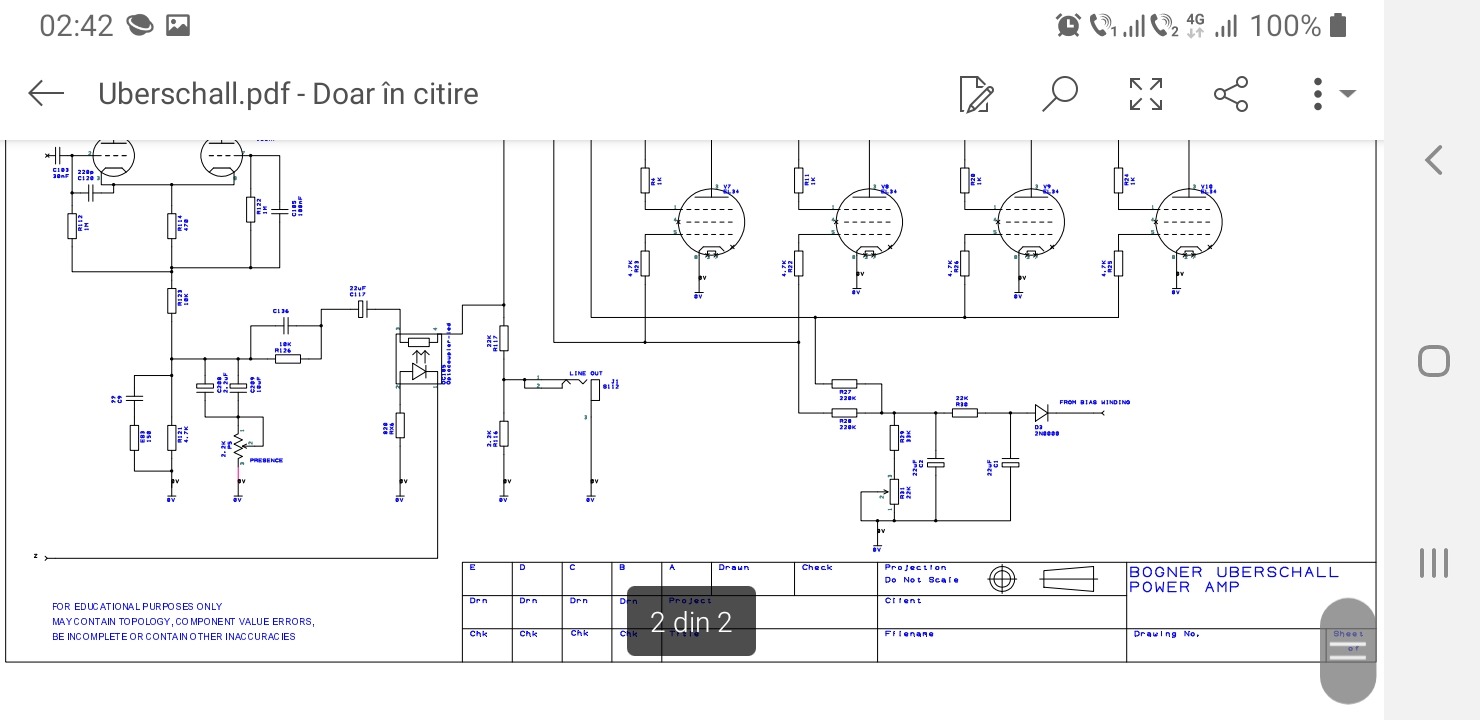

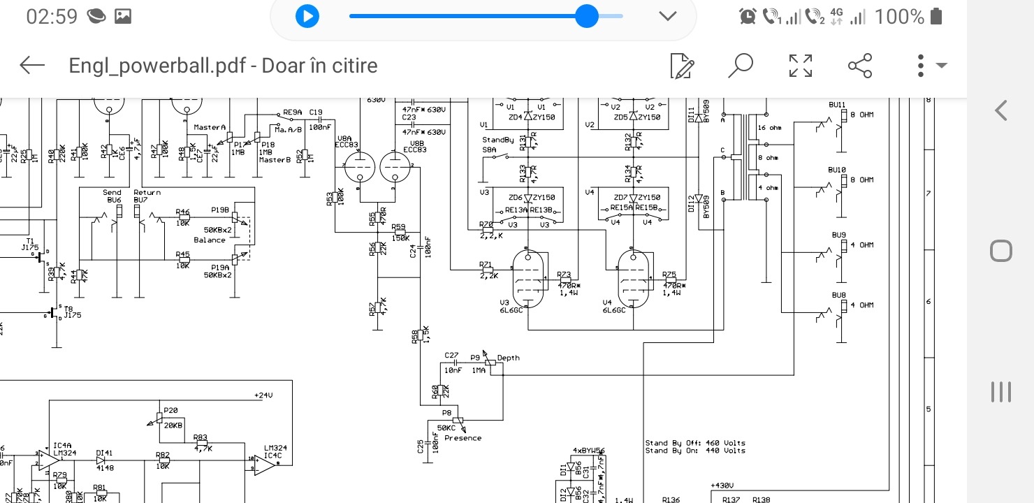

Similar feedback controll in Engl Powerball...You just reminded me what was that made the most sought for agressive drives in all these amps designed specifically for the kind of rock coined by John Petrucci...I never came to clone Engl, Diezel and Bogner as the schematics at the time(2007...2008) were hard to reverse engineer or find in a clear print, but I cloned almost all the famous amps and tones ...and the variety of tones obtained without feedback were very sought for by the dream theater guitar fans...
Well, there's still good 2/3ths of them that are closed loop modes. Closed loop are also classic Marshalls like JTM45, 1959, 1987, 2204/2204, Silver Jubilee as well as Soldano, 5150, Dumble, Trainwreck, Jim Kelley, Mark series Mesa amps, etc.
Most Mesa open loop modes are really after weaker damping factors and resulting interaction with speaker impedance, not so much power amp overdrive characteristics. They have the distortion rather well covered in the preamp section.
I still firmly see majority of tube power amps as closed loop circuits and that extremely few tube-based preamp distortions try to emulate tube power amp distortion.

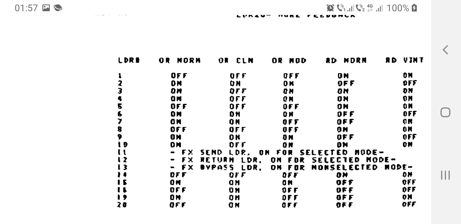

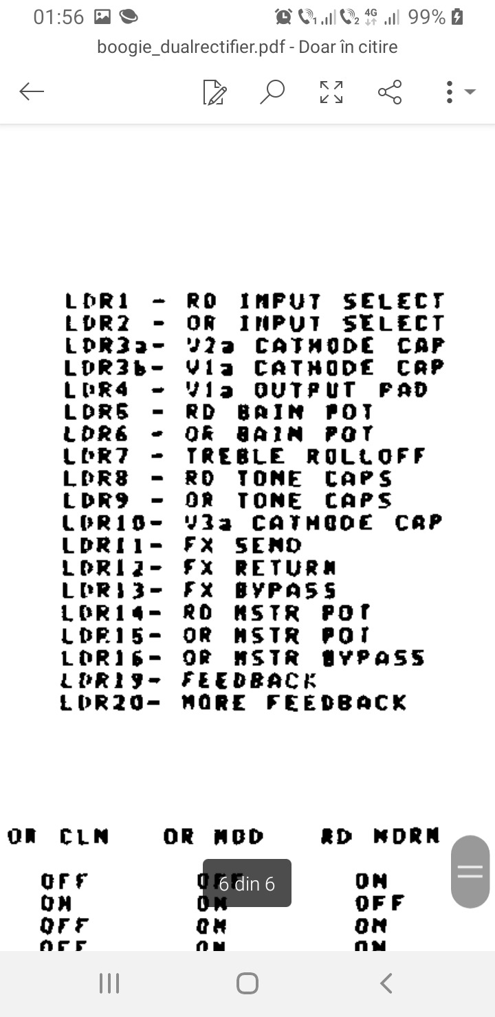

It's not just the weaker damping which honestly is not that important in a guitar cabinet, it is also shaping frequency response removing higher frequencies, thus higher order harmonics too in the most agressive lead drive mods where you'd normally have too many high order harmonics. Mesa preamps like Triaxis are uding an internal 5 band eq to taylor it.They also moved that 5 band EQ inside Petrucci's signature headamps.
As long as you find the same no-feedback mod in all the orange and/or red lead channels of the most brutal amps, that is not by chance...
Negative feedback will actually reduce treble because low damping interacting with voice coil inductance results to quite a bit of treble boost. Higher damping, provided by negative feedback, levels the response to reactive speaker load. Thus with NFB there is less bass and treble boost at frequencies at which the (reactive) load impedance is high.
Red and Orange channels of the old Mesa Dual Rec series are BOTH very high gain channels and have nearly identical signal paths and gain ratios as far as "gain staging" goes. The amp is effectively a SLO clone with extra feature of turning the stiff Soldano-like mode (Orange) "spongier" by removing the feedback and optionally using a sagggier supply (Red); the latter pretty stupid feature for a master volume amp that primarily gets is distortion from the pre, the former more sensible since it gives a huge bass pump at resonant frequency and added brightness and aggressivity.
There is slight difference in tonestacks of the two modes and the Red mode has a preamp-based "cut" -type presence control because the one in NFB loop is disabled.

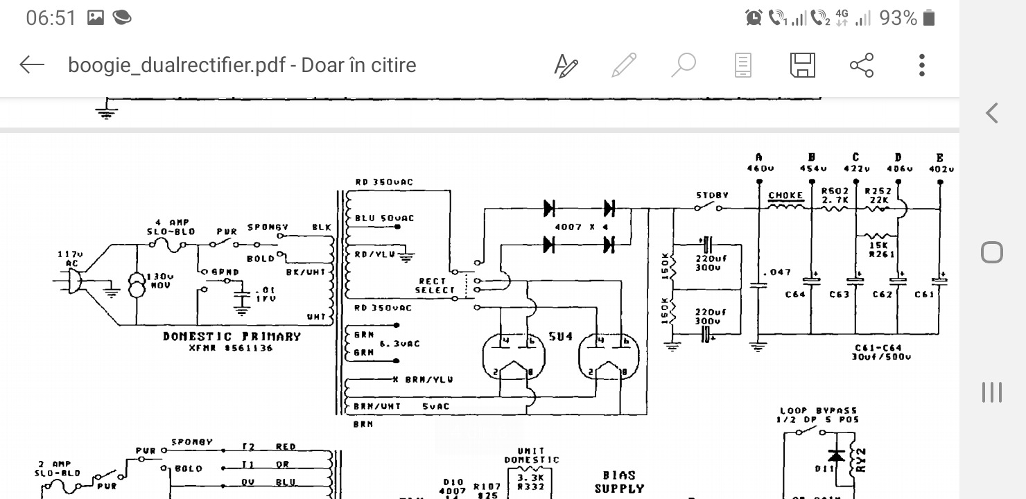

You know where the "dual rectifier " name comes in Mesa amps, don't you?I remember that you complained about DF in tube guitar amps without feedback...Yes, but we have been conditioned with such statements and nice drawings of supposed tube soft clipping.
Well, it's obvious. What is less obvious is what tube rectifiers have to do with damping factor or with feedback loops (or lack of them) of the power amp section? Care to enlighten?
IME, at best a tube rectifier might introduce a bit more power supply voltage sag under heavy current draw, but that means one would have to first "load" them, which is a rare occurence in high power master volume amp devised to amplify the preamp signal cleanly with ample headroom.
I can understand the open loop mode, as it is a different EQ option for the "stiffer" distortion mode ripped off after Soldano and hot rodded Marshall 2203 in general. But it's just a different option, not the "best" and certainly not representative of what is "norm" for tube guitar amps.
Say, if Soldano was after this "soft clipping" and "open loop" operation then why did they devise a super high gain preamp with abrupt clipping characteristics that they amplify with high power, high headroom fairly transparent power amp "stiffened" by negative feedback and diode rectified power supply with ample filtering... just doesn't make sense. ;-)
Why did Silver Jubilee do essentially the same thing, not to mention why does it suppress preamp tube distortion with feedback loops and actually employ semiconductor diodes for clipping? Just doesn't make sense.
Or maybe it does. Maybe we don't always want super spongy tube amps with super soft clipping. Maybe not all amps need to be like AC30, maybe some amps are perfectly good when they are entirely different. Maybe these "tube tone" or "tube circuit" concepts are too vague to be filed under generalisations.
It seems to me that you had no contact with a mesa engineering type of guitar player.I did.In fact with two very good players using the same type of distortions that mesa does.
I only know that they preffered the no feedback arrangement by far considering it more "dynamic" or "ballsy".
The tubes rectifiers do make a difference and that sag is more pronounced in any of the tube rectifier connections where all voltages are lower and the tubes are in current mode with a fixed bias in the final stage.You can make yourself a clearer opinion on this just by listening to the difference.As you can see, the guy expresses the completely reversed expectations upon the output power in the Spongy vs Bold setting where actually the power should be higher in the Spongy mod and that's because the higher harmonic content in the Bold variation is actually giving the opposite feeling.
I personally preffer the Tube rectifier sound by far which is "Bold" er than any solid state rectifier setting...
