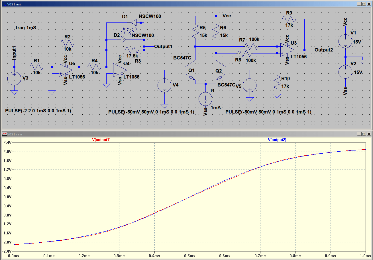

Take a look at the attached screenshot. I've added an LTP, for comparison with the LED op-amp clipper.
Comments:
1) I switched to JFET-input op-amps, to eliminate any errors due to input bias current.
2) The linear ramp to the diode clipper rises from -2V to +2V, as before.
3) The linear voltage ramp to the LTP is differential (V5 is inverted compared to V4).
4) Because the LTP is hypersensitive to voltage, I had to reduce the amplitude of the ramp voltage - it ramps from (-100mV) to (+100mV).
Twenty times smaller than the input voltage to the op-amp diode clipper.
5) I tweaked R9/R10 (gain of the differential amplifier) so that the output voltage from the LTP swings through the same voltage range as the output voltage from the diode clipper, i.e. from roughly (-2.1V) to roughly +2.1V. In other words, I divided down the LTP output voltage to match the characteristics of the LEDs in the other circuit.
6) Finally, I tweaked R3 (the op-amp feedback resistor in parallel with the LEDs) to match the output of the two circuits as close as possible. As I've mentioned a few times, this resistor sets the slope of the transfer function in the crossover region (where neither LED is conducting significantly.)
And the result? See for yourself!
The two transfer functions are virtually identical.
To summarize: a BJT LTP produces a tanh() transfer function. So does a properly adjusted op-amp diode clipper.

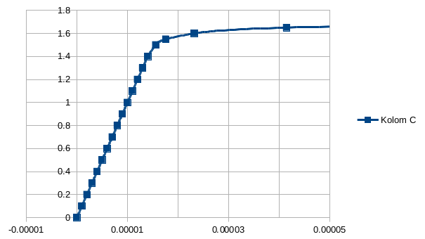

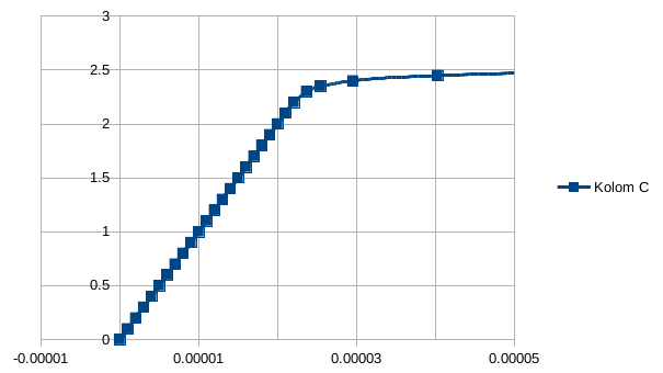

As there might be a difference in behaviour between a red and a white LED, I've repeated my experiment with a white LED of unknown type, also salvaged from a bicycle light found on the street. Due to the higher forward voltage, I had to put my meter in its 20 V range, in which its resolution is 10 mV. That's a bit rough for a diode transfer, so the plots are not as nice as for the red LED.
Voltage-to-current characteristic of the LED:
The orange curve is 45 uA at 2.5 V, a decade per 110 mV (emission coefficient just over 1.9).
The reverse current at 2.9 V was immeasurable with my set-up (< 100 pA).
Resulting current-to-voltage transfer for a white LED with 100 kohm in parallel, calculated using 45 uA at 2.5 V, a decade per 110 mV for the LED:
Your mistake is that you're not considering the feedback resistor in parallel to the diodes. The current through that resistor alters (lowers) the slope of the transfer function in the region where neither LED is conducting much.
Somehow you must have missed this part of post #170: "Using the IF = 25 uA * 10(VF - 1.65 V)/0.093 V model, I then calculated the current versus voltage characteristic of a LED with 100 kohm in parallel with it."
This is why you don't get the abrupt vertical step in the middle that you're predicting, but rather, a linear slope that fades smoothly into a curve at both ends.
What abrupt vertical step? There is a 100 kohm linear slope that flattens off. Vertical: voltage, horizontal: current through the LED plus the current through its 100 kohm parallel resistor.

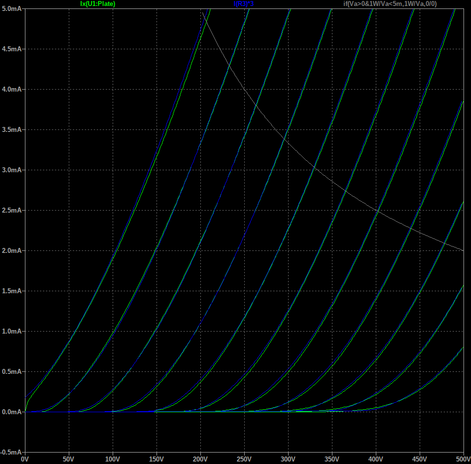

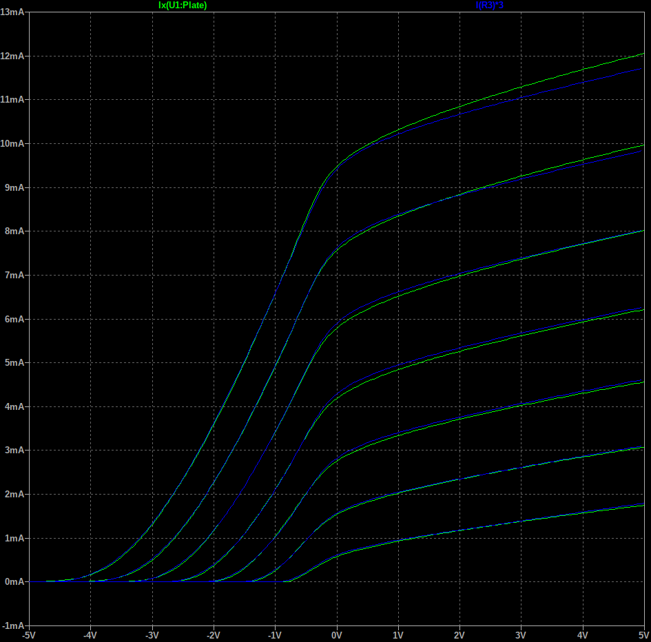

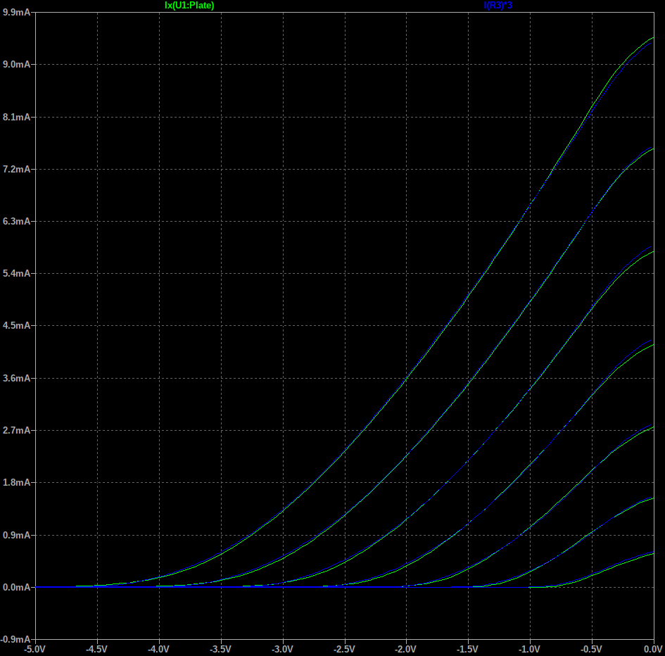

I certainly don't agree. Attached are some plots of a triode emulator circuit I've been playing with compared to an accurate 12AX7 model. It's fully discrete and uses only BJTs and diodes to create the nonlinearities. First plot is the anode characteristics (Va=0V-500V; Vg1=-5V-0V, 0.5V step; Rs=1mΩ). Second and third are the transfer characteristics (Va=50V-350V, 50V step; Rs=33k).Tightly curved transfer functions shift abruptly from "too clean" to "too dirty", and that's the problem with all these BJT-based circuits. Everything we can do with diodes iand BJTs s hamstrung by the fact that diodes have such a sharp curvature to their transfer function.
That doesn't confirm that the LED model is accurate. In fact, it would seem to suggest the opposite. Every measured V-I curve I've seen for LEDs (including @MarcelvdG's recent measurements) shows a sharper knee than a typical small-signal Si diode when scaled to account for the difference in forward voltage. Try the QTLP690C model and see if you can get the same curves.To investigate concerns that the SPICE model of the LED might be faulty, I swapped the LEDs for plain-Jane 1N914s in the op-amp/diode clipper.
I'm sure you will be even sorrier to hear that I wanted to delete that message, but was just too late. It's a technically interesting thread, so I'm back and I'll try to respond a bit more like a Vulcan.Sorry to hear it. This thread has been a bit frustrating for both of us.
-Gnobuddy
Suppose you have two types of diodes with equal emission factors, but very different forward voltages at a given current. Both follow IF = Is (exp(VF/(nkT/q) - 1), but with very different values of Is.
Two of the same type in antiparallel with a resistor across them will then conduct a current
I = Is (10V/Vdec + 10-V/Vdec) + V/R
with Vdec = ln(10) nkT/q being the voltage for a decade of current increase.
When Vdec is 100 mV and the difference between the forward voltages at a given current is 1 V, you can theoretically still get the same shape out of the network, but you need a 101 V/100 mV = 10 000 000 000 times larger resistor and smaller current for the diode type with the high forward voltage, because its Is is that factor smaller. The signal voltage will then be the same as for the diode with the small forward voltage, but the noise will be higher, the resistances will be unpractically large and crystal defects will have a much larger impact.
of course, which makes practically no difference.It should be
I = Is (10V/Vdec + 10-V/Vdec - 2) + V/R
