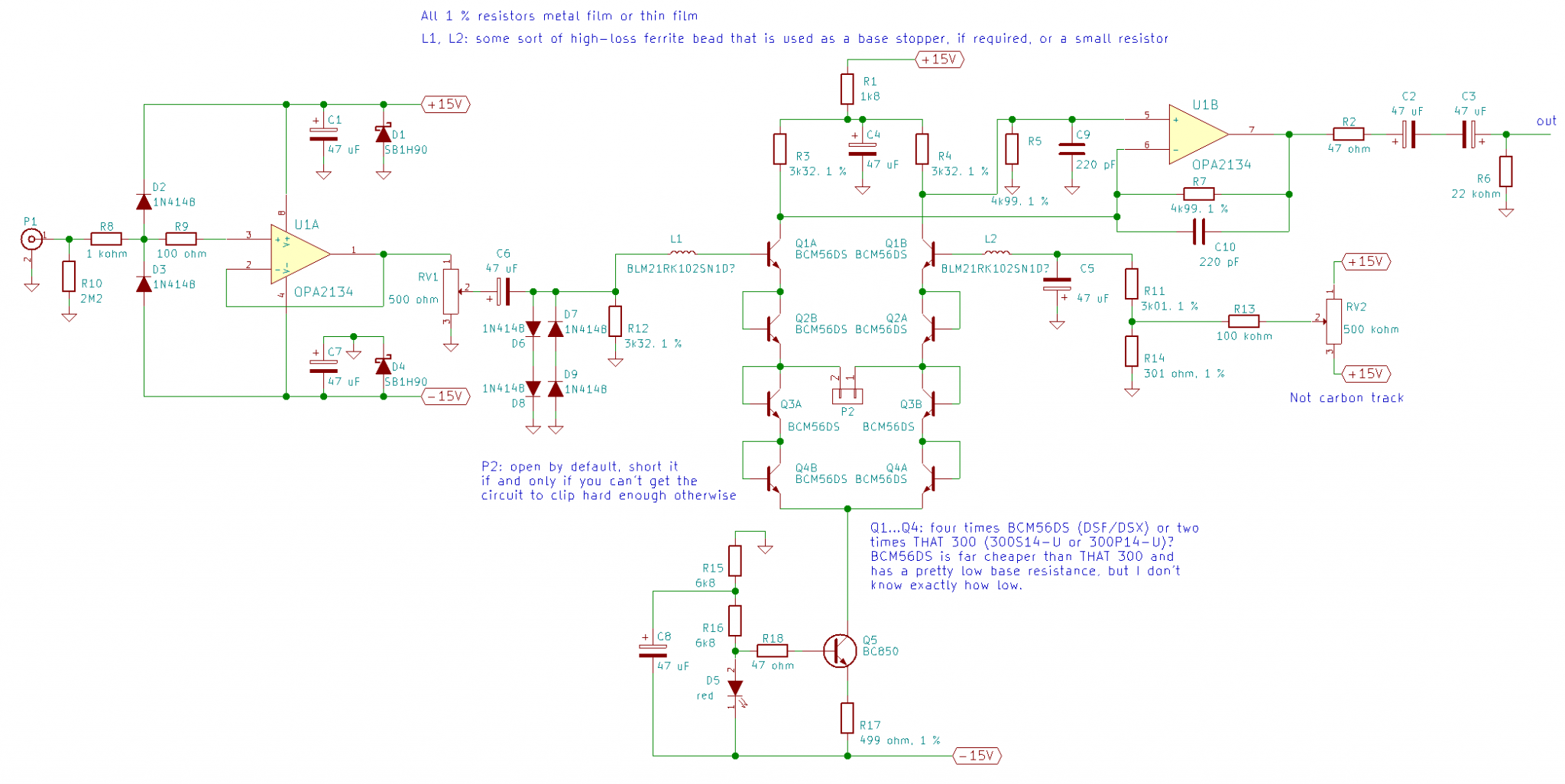

When using a differential pair (with or without stacked diode-connected transistors in the emitter leads) as soft clipper, it could be useful to have an offset adjustment knob. Put it in the centre and you get pure odd-order distortion, turn it to the left or right and you add even terms as well.

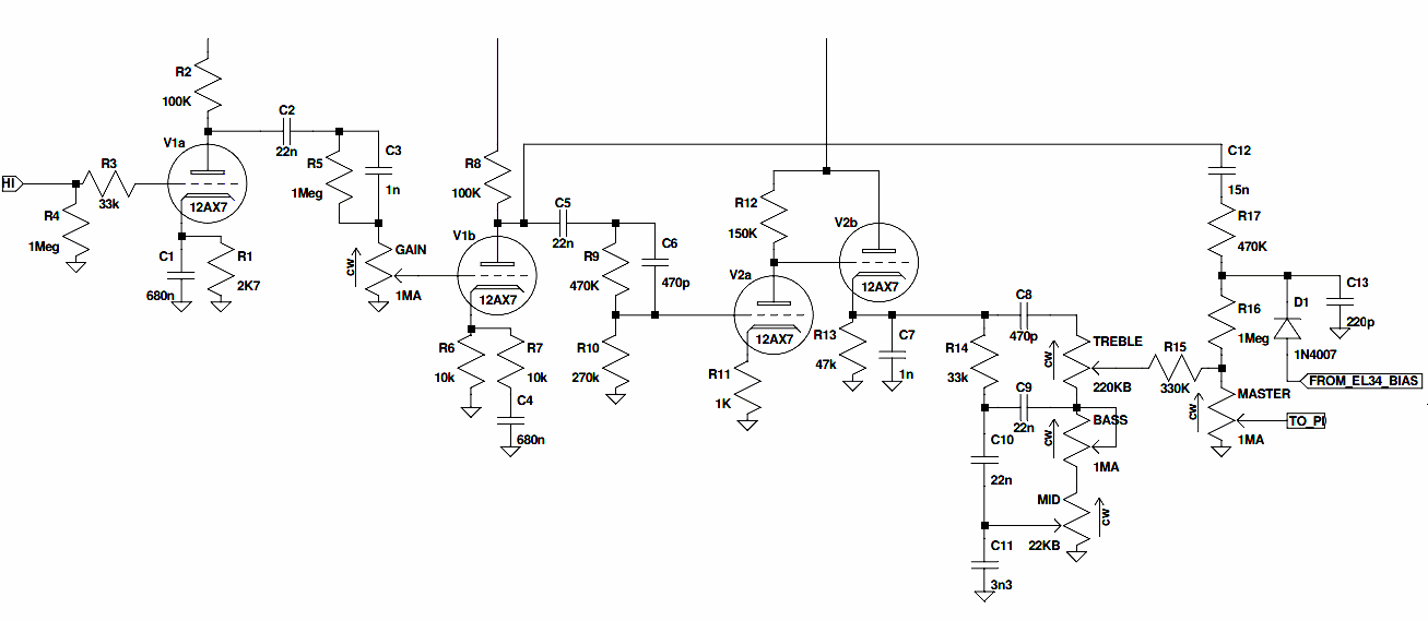

I've never even seen a "real" Plexi, but I built the preamp section of one a couple of years ago, and had exactly the experience you describe. No touch sensitivity, but something more like a fuzz-box: an abrupt threshold above which heavy distortion kicks in abruptly.
When you look at the "cold clipper" stage, which, in effect, is biased to operate virtually in class B (more rectifier than amplifier), the reason for the distortion characteristic becomes evident.
Well, in a "Plexi" (type # 1987 and 1959) with no master volume, the power section (PI+outputs) clips first and in this case the power stage has really a lot of global feedback, more than most other output stages seen in tube amps... which creates the nasty onset and character of the distortion, quite similar to a HiFi transistor amp.
The cold clipper stage can hardly driven into clipping with those amps... and at that point, the last gain stage + CF is already clipping.

FWIW, below is my mod to the 2203/4 master volume Marshalls.
One main part is the increased load on the CF which does away with a distortion mechanism that is often overlooked, the CF starving of current, leaving the 100k the only load to pull charge away from the tone stack capacitors. At some point the cathode can't follow the grid anymore in the downward swing, creating the typical saw-toothy distortion of that stage... with, again, a very sharp onset. Interesting tidbit: over time, those 100k carbon film CF load tend to increase, I've seen more than 150kOhms in one of my amps (from '81) which make the effect even stronger, setting in earlier. Remove this effect and you get a very gradual transition into overdrive.
The other important aspect is the added-in inverted signal from the cold clipper, not passing through the tone stack. This is (partly) subtractive overlay, basically have these characteristic:
  • When 3rd stage+CF is just about to saturate, the subtraction (of mostly fundamental) is only very subtle as the gain is still high in that stage.
  • When it is more heavily distorting, more of the cold-stage signal (which still is pretty clean at that point) gets subtracted in relative terms, exposing the higher harmonics and IMD products a bit more, giving progressively more aggressive/sharper overdrive.
  • When the cold clipper runs into clipping finally, this adds even more subtractive signal in terms of harmonics, but the total subtracted signal gets lower again in relative terms as the level cannot increase much.
Tone stack settings affect the mixing and the final distortion characteristic big time.
Several component values have been changed, and a few have been added, to dial in best performance for my needs, shifting the gain structure somewhat. The touch-sensitivity and aggressiveness of the modded amp is very special. For lack of a better word, it has an over-unity distortion characteristic, the more you dig in the more aggresively it distorts, even at maximum gain the inital attack and following first decay phase of a note is rendered clearly, very different from that benign standard high gain amp metal sound. And it never really cleans up fully, some nice sounding subtle "thickening" distortion and quite a bit of percvieved compression is always in place (unless using the low-gain input, that is).

I dug out my perfboard preamp with 3 Fets, it's been a long while since I built it. It has two JFET stages followed by a MOSFET. I originally placed the MOSFET in the first position but it was too noisy. This was similar to Runoffgrooves Peppermill circuit. Placed last in the chain though, and biased "cold" the preamp response was much better. It now had the right amount of bite at about the level of guitar signal one would expect. I think a couple of refinements could improve the response. Putting a direct coupled Jfet source follower at the Mosfet output, and soft limiting the second Jfet stage. A tone stack wouldn't hurt either! This was just an experiment, but it was one that showed some promise.

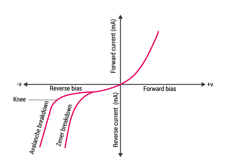

I did exactly that with my (solid state) bass top a couple of years ago - using 3.3V zeners.
I do however use more than just two zeners to allow for a higher signal level.
I started out with higher voltage zeners 10V and got a rather sharply clipped signal and instead decided for the multiple low-voltage zeners, which provides a very rounded, soft clipping.
A side note: This particular difference in zener diode behaviour (probably due to "avalance" vs. "zener") is not very well described. At least I could not find any available articles describing this and my old university books did not contain any hints either.

...low-voltage zeners, which provides a very rounded, soft clipping.
A big "Thank you!" to both jjasniew and to you, Martin!
I did not know this, and I think it's very interesting and exciting information in this context.
Decades ago, I learned from many electronics textbooks that Zener diodes have a very sharp knee. I've been operating on that (mis)understanding ever since.
Because of that, I never even considered using Zener diodes in an NFB loop to provide softer clipping. I believed the opposite, that they could only create even harder clipping than normal silicon diodes, because of the supposedly sharper knee.
I read jjiasniew's comment earlier today, and it led me to Google Zener diode transfer characteristics earlier today. Among other hits, I found this: https://byjus.com/physics/difference-between-zener-breakdown-and-avalanche-breakdown/
That page reminded me that not all Zener diodes use the same breakdown mechanism. I wondered if Zener breakdown might produce a softer knee than avalanche breakdown. But the graph in that article (attached to this post) didn't support that idea, so I dismissed it.
So thank you again for your post. Without your input, I still wouldn't have understood that low-voltage Zener diodes have a softer knee.
Same here. I started teaching myself electronics as a child, age still in single digits, and I've read countless electronics books since then, ranging from simple books aimed at hobbyists, to advanced textbooks for engineering students. But I don't think I've ever come across this information. (Or if I did, it was so long ago that I'd completely forgotten it.)
Very interesting, and it opens up some new avenues for experimentation!
-Gnobuddy

OK. I meant something like this, assuming a clean +/- 15 V supply is available. It obviously needs changes if it has to work on a single -9 V or +9 V supply. Neither tried nor tested, so I'm sure there are things that would require tweaking.
  • tanh.pdf
Reactions: 1 users

I woke up this morning and realized I had forgotten to protect the transistors against base-emitter avalanching, see below or the attachment for a corrected schematic. I also added two 220 pF capacitors to limit the bandwidth of the op-amp stage (filter off some ultrasonics), although those are not strictly needed.
  • tanh.pdf
