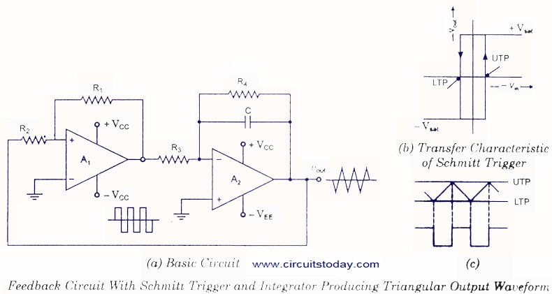

For example, there is a common type of oscillator that uses a Schmitt trigger connected to an integrator. It produces square and triangle waves. See the attached image.
I can explain the operation of that circuit to you very simply, without math: imagine a squirrel on a see-saw. The squirrel follows the algorithm "Always run uphill".
So the squirrel runs uphill until her weight tips down that end of the see-saw, then she turns around and runs the other way, until the other end of the see-saw drops, and so on, forever...
The height of the squirrel, plotted against time, is the triangle-wave.
The height of either see-saw end, plotted against time, is the square wave output.
Isn't that much easier to understand than I = C dV/dt, and therefore V = 1/C (time integral of V)? 😀
Of course there's a point at which the concept is too complex for words and pictures, and only equations will do. We don't usually reach that point on these forums, though.

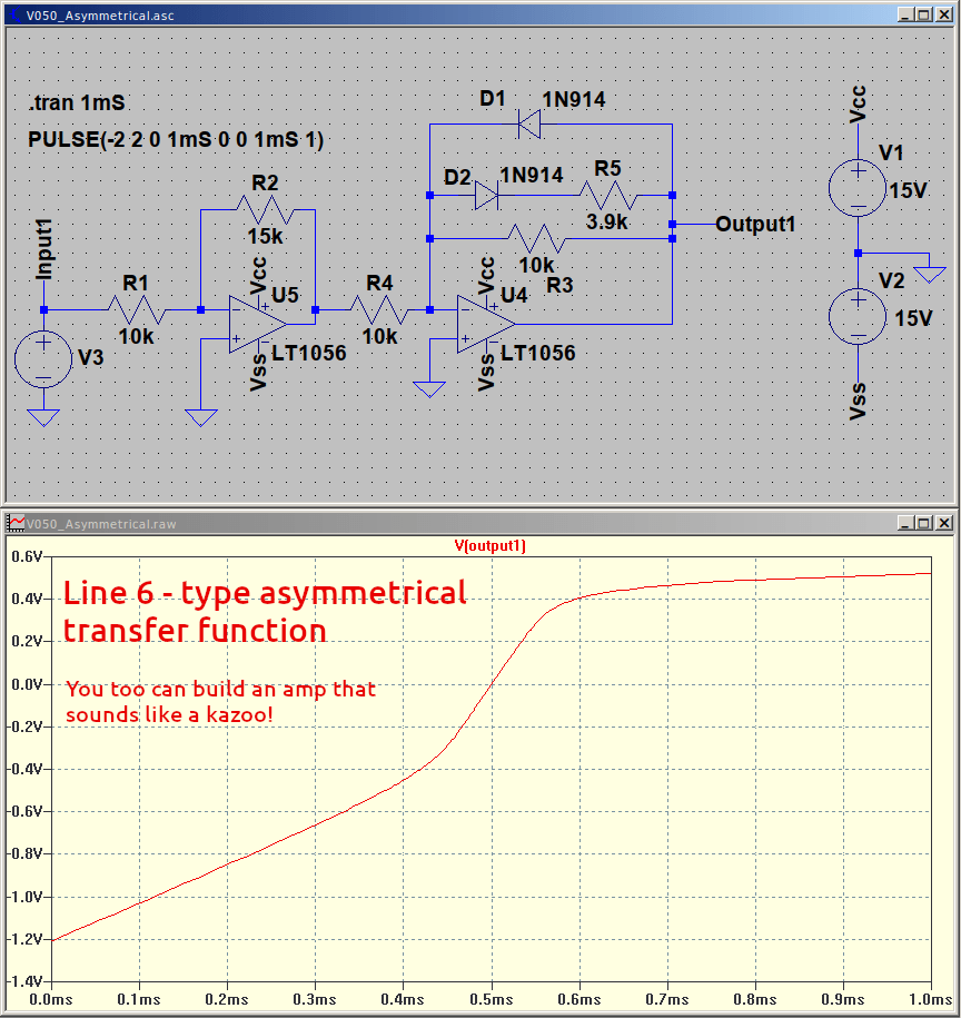

Here's one way to reproduce an asymmetrical transfer function (like the early Line 6 one referenced in Shanx' link), using a simple diode clipper. Just add one more resistor, in series with one of the two diodes.
Imagine that. You can build a nasty-sounding guitar amp using DSP, or much more simply, using an op-amp and a couple of diodes.
Unless, of course, you happen to love the sound of a kazoo, in which case the amp will sound lovely to your ears.

By the way, i've read it would be recommended to have a series resistor with every diode cause op-amps aren't really that good at driving 30...60 ohms dynamic impedances.
That is quite true if you wire the diodes in parallel with the output of an op-amp (like the Proco Rat approach). You need a resistor in series to limit maximum current, and to be kind to the op-amp.
However, in the type of diode clipper shown in my post above, the output current of the op-amp is set by the input current and input resistor - not by the load on the output! In fact, the output current will not change, whether you put 1 ohm, 10 ohms, or 1000 ohms in series with it. **
So it's quite safe to use "naked" diodes with no series resistances in this particular circuit. Both the diodes and the op-amp will be safe and happy.
** within limits, of course. It works as long as the output doesn't clip.

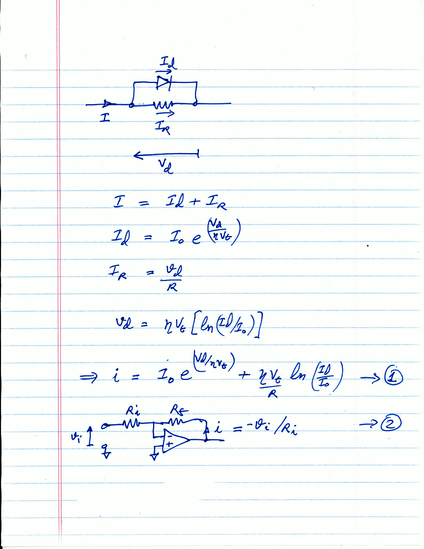

Since they are being fed by a current source, apply Kirchoff's current law, and you get nonlinear equations to solve. The voltage across the diode is the logarithm of the current through it (with the usual scaling factors you know about).
I don't usually post equations because I'm not sure how many people on the forum are actually helped by seeing them. However, in this case, it's the only way to communicate what I'm thinking.
I did try to explain to you in words why diodes with a large forward voltage lead to rather abrupt clipping unless their emission factor is unusually high, see post #158, https://www.diyaudio.com/community/...id-state-e-guitar-preamps.391513/post-7221294 I then tried it by measurements combined with numerical calculations (posts #170 https://www.diyaudio.com/community/...id-state-e-guitar-preamps.391513/post-7223393 and #184, https://www.diyaudio.com/community/...id-state-e-guitar-preamps.391513/post-7224324 ). After all that, I resorted to equations.
In the attached image of a quick scribble from my notepad, to find the voltage across the diodes, you have to substitute i from equation (2) into equation (1), and then solve equation (1). (Trying to type equations into this forum is too tedious for me.)
Equation (1) is a nonlinear equation. Note that both the diode voltage, and the diode current, are both embedded in it. and off the top of my head, I can't think of a way to solve it analytically.
However, it can be solved numerically because we know the (exponential) relationship between Vd and Id.
LTSpice does exactly this, and does it very well.
The voltage as a function of the current is probably a transcendental equation that has no analytical solution, but fortunately, if you just want to get an idea of the shape of the function (or compare the shapes for circuits with different diode types), you can as well calculate the current as a function of the voltage and swap the x and y variables.

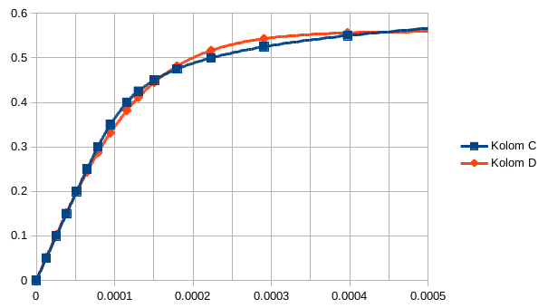

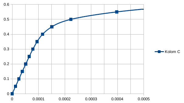

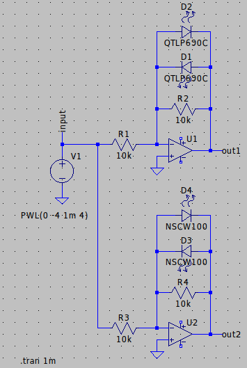

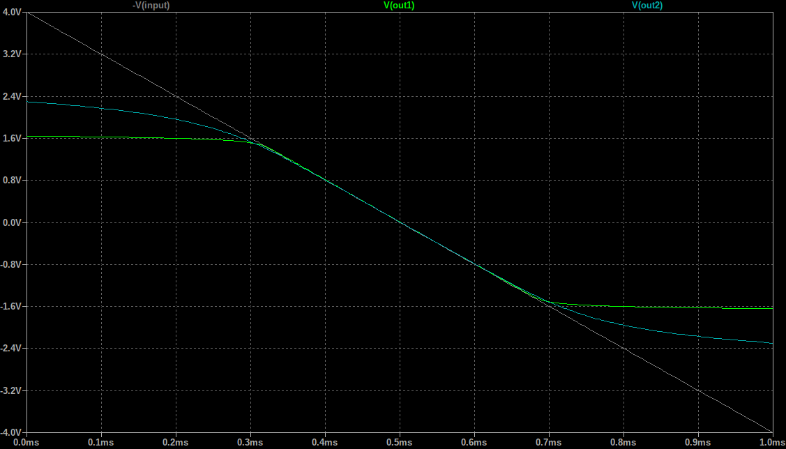

That's precisely what I calculated in post #199, https://www.diyaudio.com/community/...id-state-e-guitar-preamps.391513/post-7224759 . You can in theory always get the same curve no matter what the forward voltage at a given current is, but the shunt resistance that you need quickly gets out of hand (increases exponentially) if the emission factor is of the order of what I measured for my LEDs.
The 1N914 you used for your simulation in post #186, https://www.diyaudio.com/community/...id-state-e-guitar-preamps.391513/post-7224355 , is a pretty good choice, at least the ones from OnSemi are. Looking at figure 3 of their datasheet, their emission factor is almost 2 and their forward voltage pretty low. Using the same type of calculation as for my LEDs, I get this curve for the parallel connection of a 1N914 and 3.9 kohm:
Comparing it to 0.56 tanh(7200 I):
The tanh looks different, but I can't possibly say it looks better. At first it deviates more from a straight line than the 1N914 diode clipper, but then it clips harder.
A comparative test using the same resistor values.
Edit:
Here are the model statements, found in LTSpice's standard.dio:
.model QTLP690C D(Is=1e-22 Rs=6 N=1.5 Cjo=50p Xti=100 Iave=160m Vpk=5 mfg=Fairchild type=LED) .model NSCW100 D(Is=16.88n Rs=8.163 N=9.626 Cjo=42p Xti=200 Iave=30m Vpk=5 mfg=Nichia type=LED)

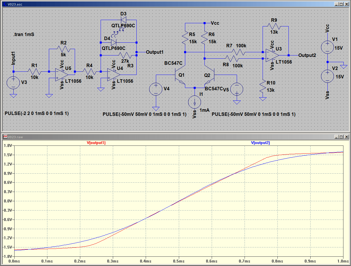

Attached are some plots of a triode emulator circuit I've been playing with compared to an accurate 12AX7 model. It's fully discrete and uses only BJTs and diodes to create the nonlinearities. First plot is the anode characteristics (Va=0V-500V; Vg1=-5V-0V, 0.5V step; Rs=1mΩ). Second and third are the transfer characteristics (Va=50V-350V, 50V step; Rs=33k).
Do you use translinear circuits? More generally, does anyone use translinear circuits for guitar amplifiers? You can make just about any non-linear function involving rational powers with translinear circuits (power of 3/2, for example, as in Child's law). The dynamic range is not great, but can be > 90 dB(A) when you do your best.
LTSpice thinks the QTLP690C produces sharper corners to the transfer function (screenshot attached).
Not a particularly good approximation to a tanh(), as Marcel has been saying.
But I don't want to lose sight of the forest for the trees. IMO, getting too focused on the exact shape of these curves takes away our attention from a much more important point: We already know that neither the LTP nor the diode clipper sounds good in a solid-state guitar amplifier.
This is why I said earlier that this is a wild-goose chase. Circuits like these have been used for decades, in literally thousands of different products. Some use Ge diodes, some Si diodes, some LEDs, some mixtures of different types of diodes. Some are set up to clip symmetrically, some asymmetrically.
All of them sound less-bad than letting a TL072 output clip against the supply rails. But, in spite of all the variations, none of them sound good by themselves. None of them sound like a tube amp, either.
By itself, these diode clipper effects pedals (also used in many solid-state guitar amps too) sound nasty.
If you feed the output of a diode-clipper into a good tube amp, and add reverb and delay to smooth out the harsh sound, the resulting sound can be very musically usable.
I can't help but think that this rather like the recipe for making tofu curry taste like beef curry: throw 5 grams of tofu into a large pot full of beef curry. 🙂
To me, the tube-like curves bmc0 posted are considerably more interesting than any sort of diode clipper. If signal levels and impedances of bcm0's circuits are in the right range, and the circuit block needed to create that curve is not too complex, those curves look very interesting. (Remember we need to simulate 4 - 5 tube stages feeding each other in cascade to replicate the behaviour of real tube guitar amplifiers.)
The input sensitivity is the same as a typical 12AX7 stage. Input impedance is high and it has accurate 'grid' current when driven to clipping. The bad news is that Ra is 1/10th of a 12AX7 and the voltage gain is very limited (about 2 rather than about 60 for a 12AX7), so it definitely can't be used as a 'drop-in' replacement to emulate every stage of a tube preamp.
My goal with that circuit was to see if I could design a fairly accurate triode-like input stage using BJTs and diodes that works with ±15V supplies.
