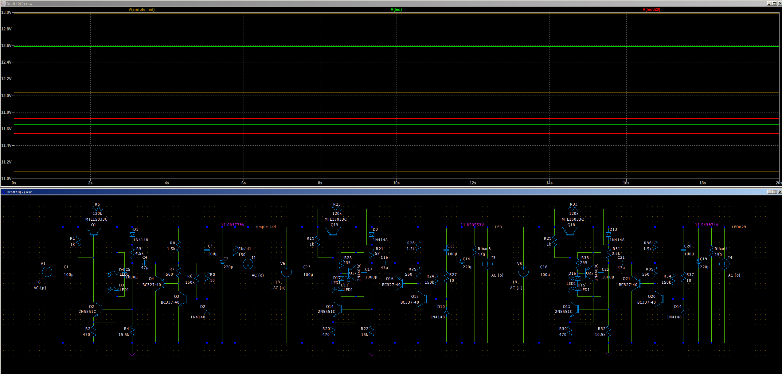

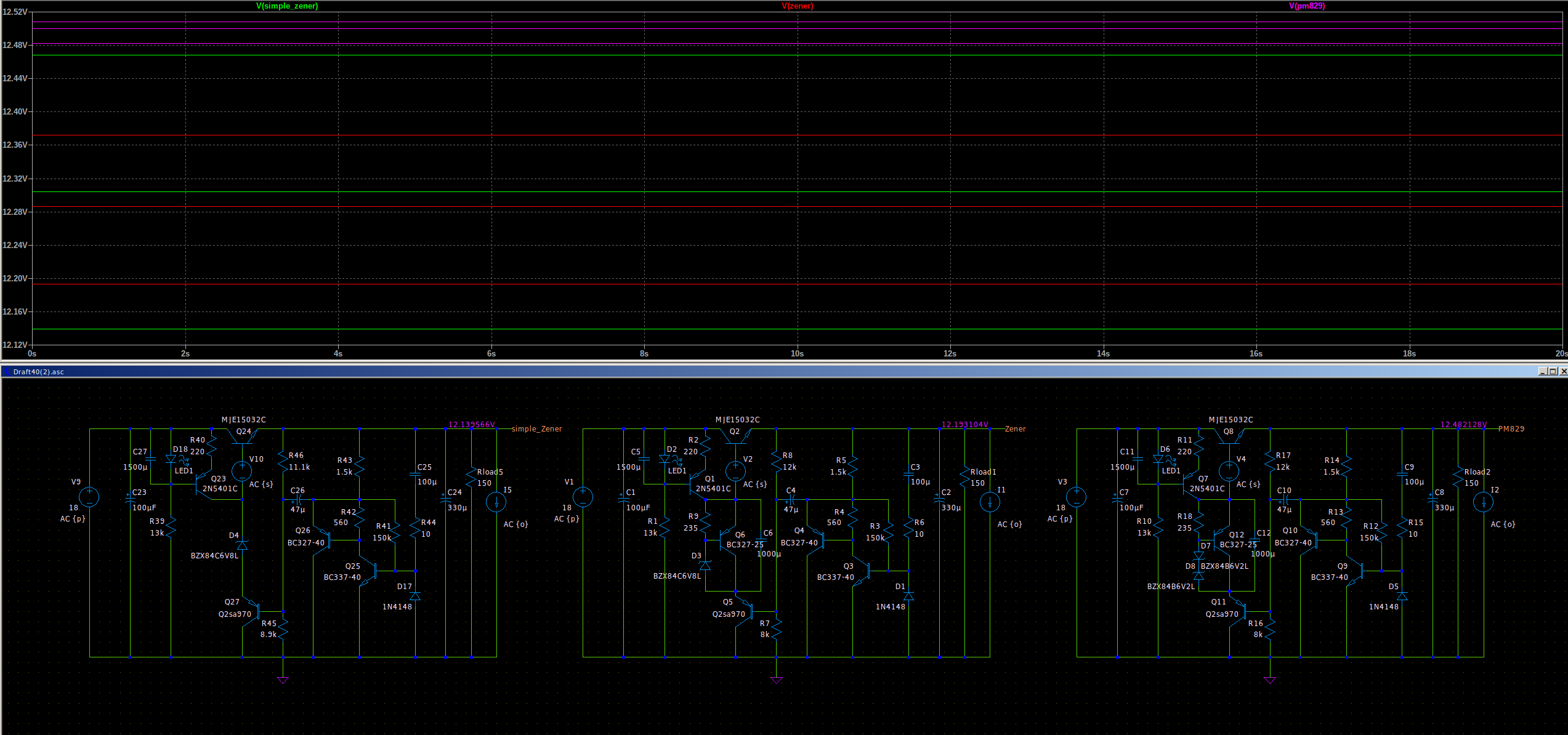

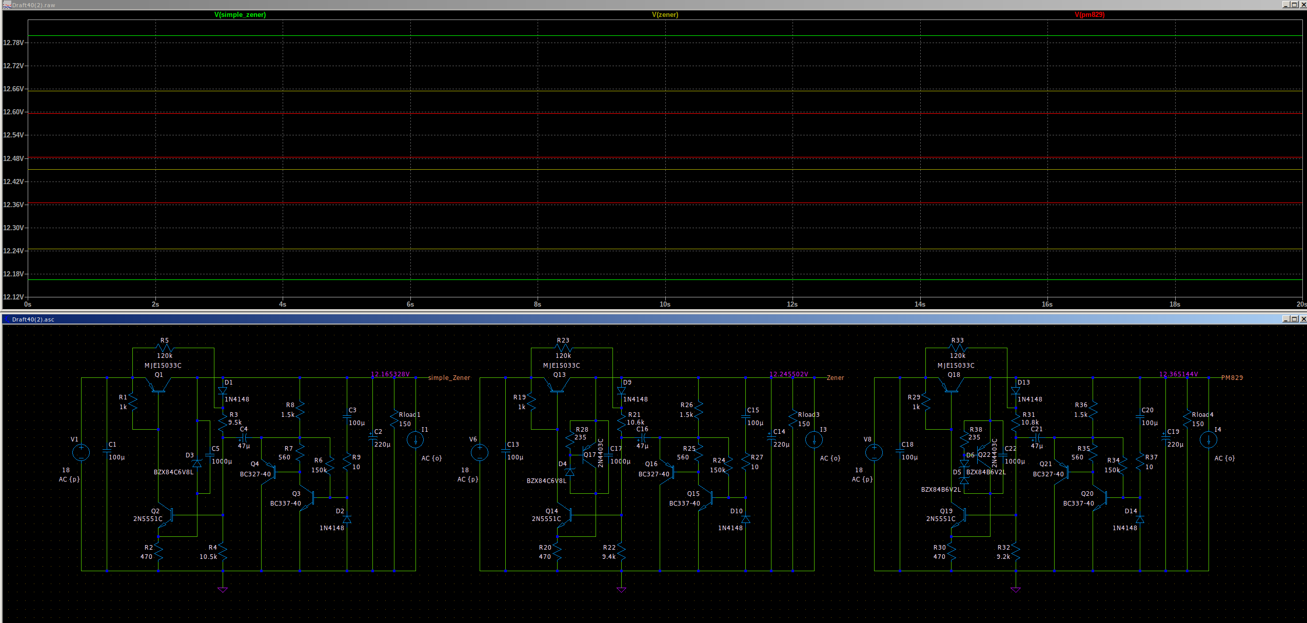

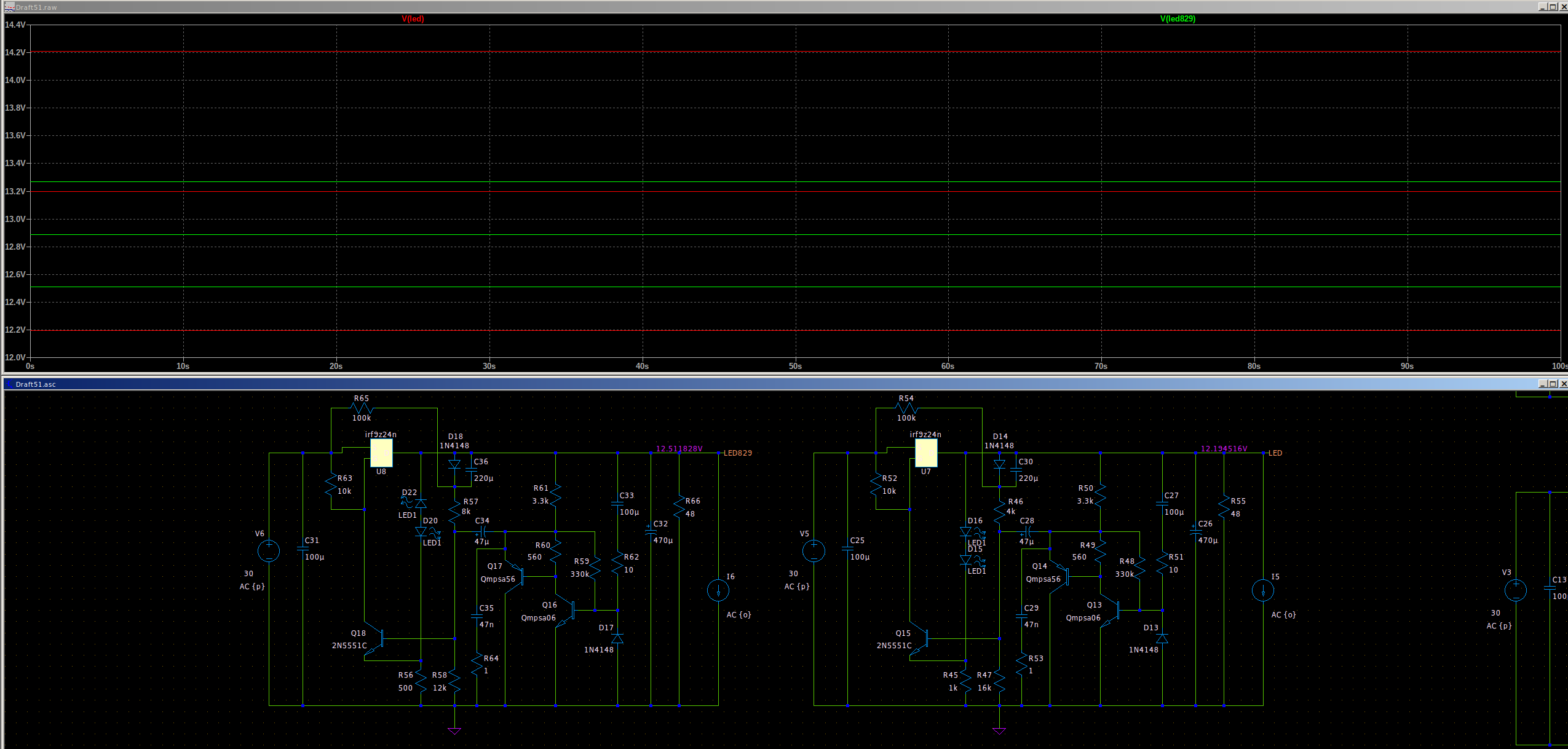

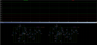

Interesting. The PM829 arrangement does have better tempco than just a simple Zener. But not quite as good as a LM329.
An even better tempco seems to be a LM329 + 6.2V Zener in the PM829 arrangement.
I put all versions in the attached photo. A bit harder to follow but you can see the LM329+6.2V Zener has a better tempco by far vs all the other arrangements.
I will try it with the BJT versions as well, but should work out the same I presume.
Even more interesting is that it seems that you could do the same with LEDs. Tempco is better and you also raise Vref voltage to 6V with two red LEDs, vs the around 3.5V with them normally connected in series. This can also be retrofitted to the existing boards I made, you just rotate the top LED.

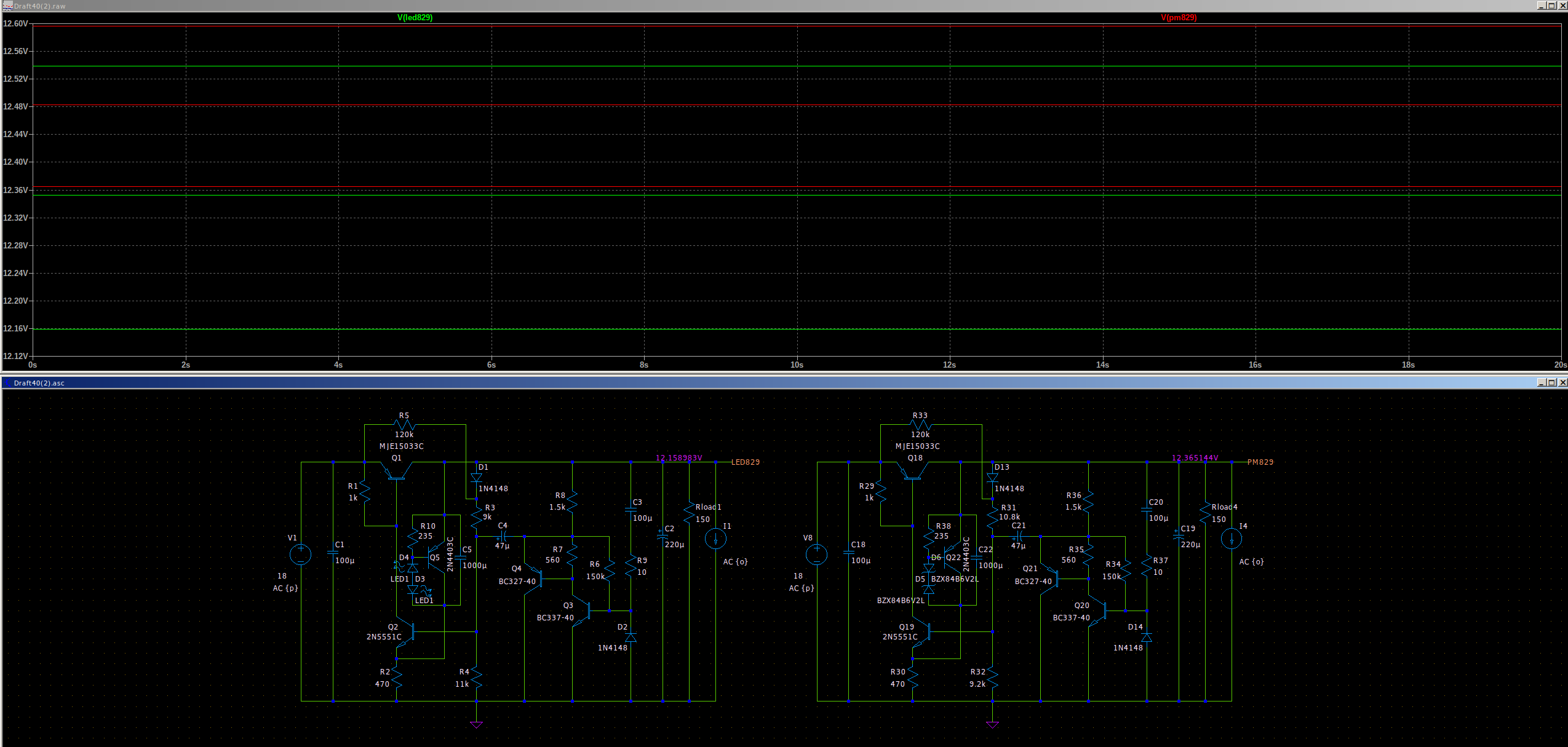

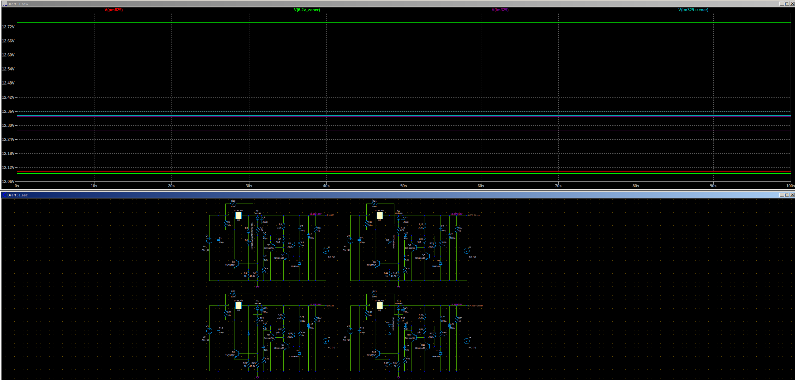

I tried for the positive feedback circuit with the BJT pass transistor.

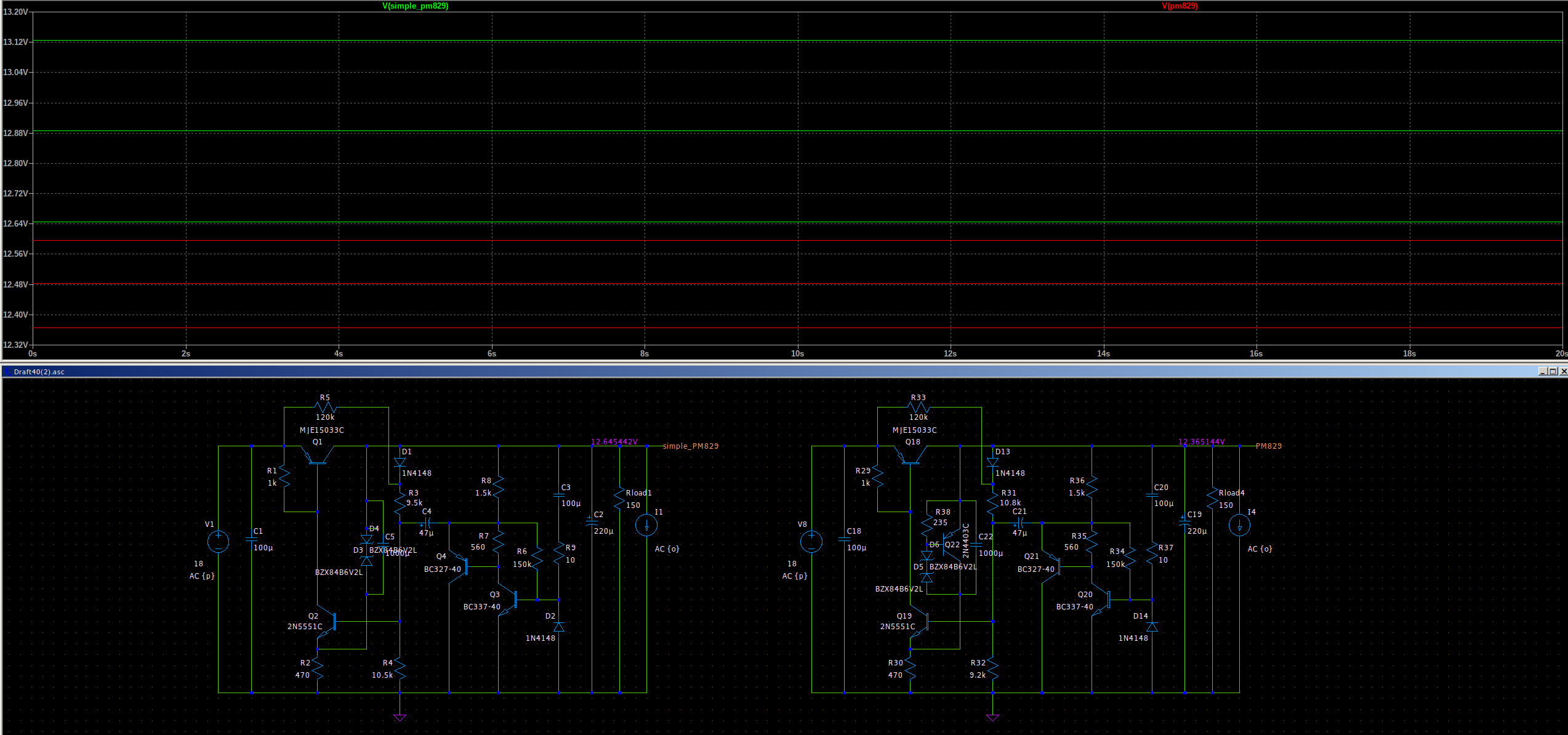

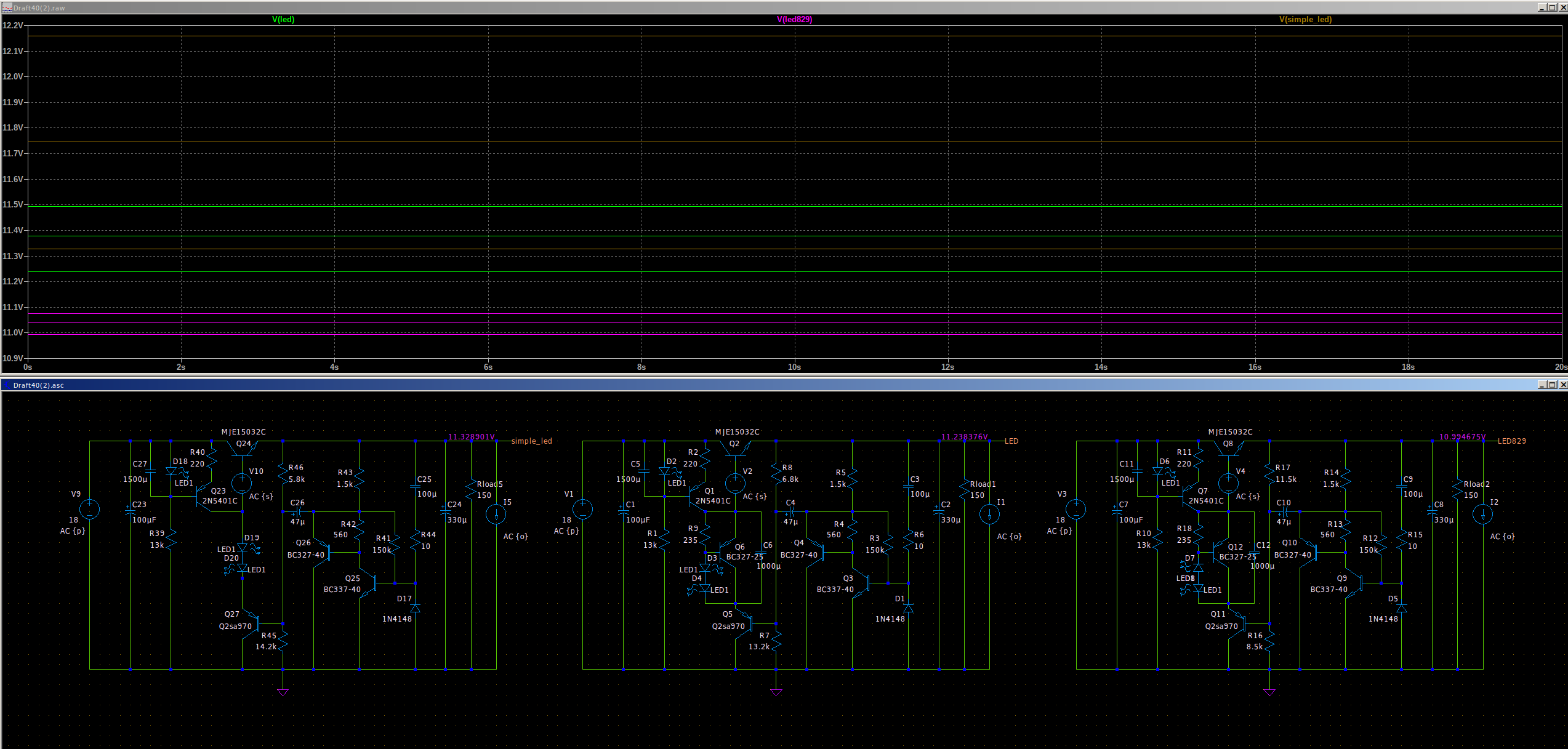

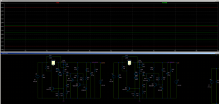

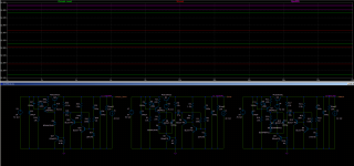

Attached photos:
1. simple LED block vs GLED block vs GLED(829?) block.
As can be seen the 829 arrangement in the GLED block offers really good tempco with just LEDs.
2. same thing but with Zeners. Again, the PM829 arrangement inside the GLED block offers really good tempco.
3. comparison between PM829 and PM829 inside GLED.
4. comparison between LED829 inside GLED and PM829 inside GLED. (Mr. Jung sorry for butchering your circuit names).

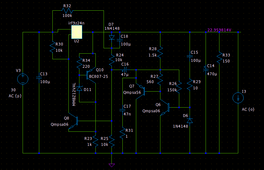

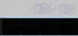

First of all thanx a lot for all your efforts here.
2nd i get the voltages I want now, very nice.

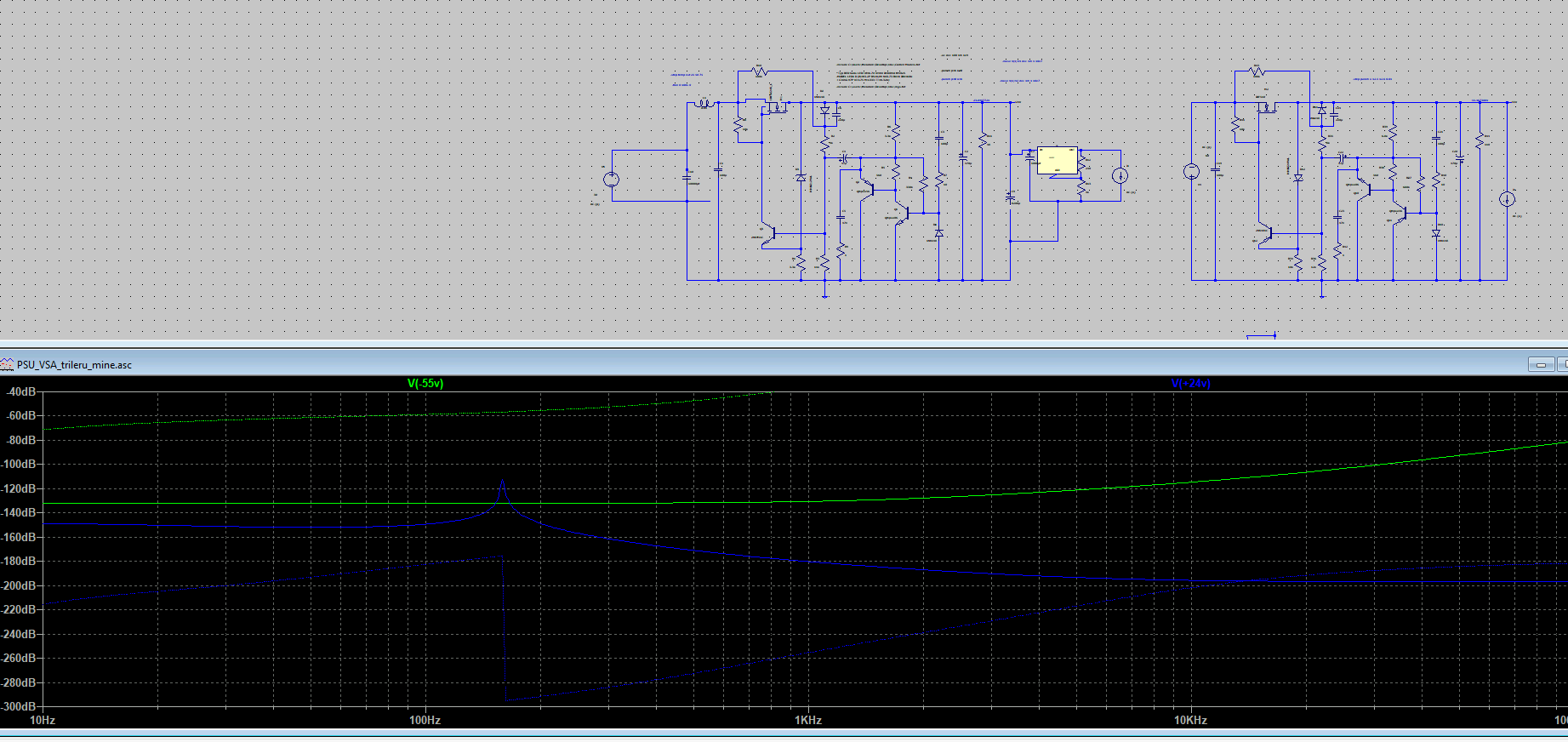

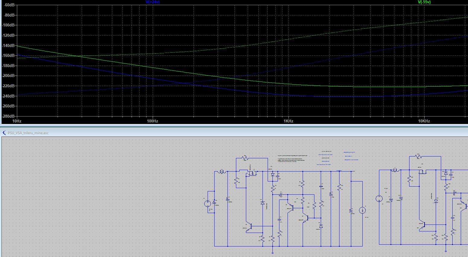

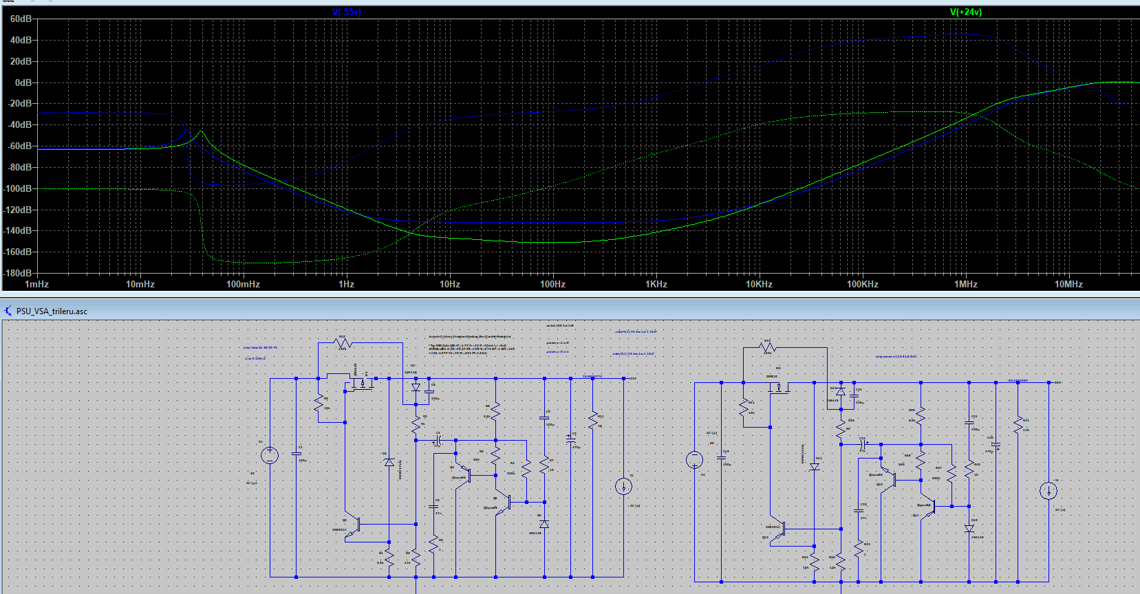

I meant better transistors to produce lower noise. Anyway are my curves in my simulation ok? I mean at 10KHz seems to go up, I am not sure how much dbs are achievable.
At 2MHz you still have about 20dB of PSRR. But add your secondary resistance to the voltage source in the sim. The HF PSRR will be higher in reality.

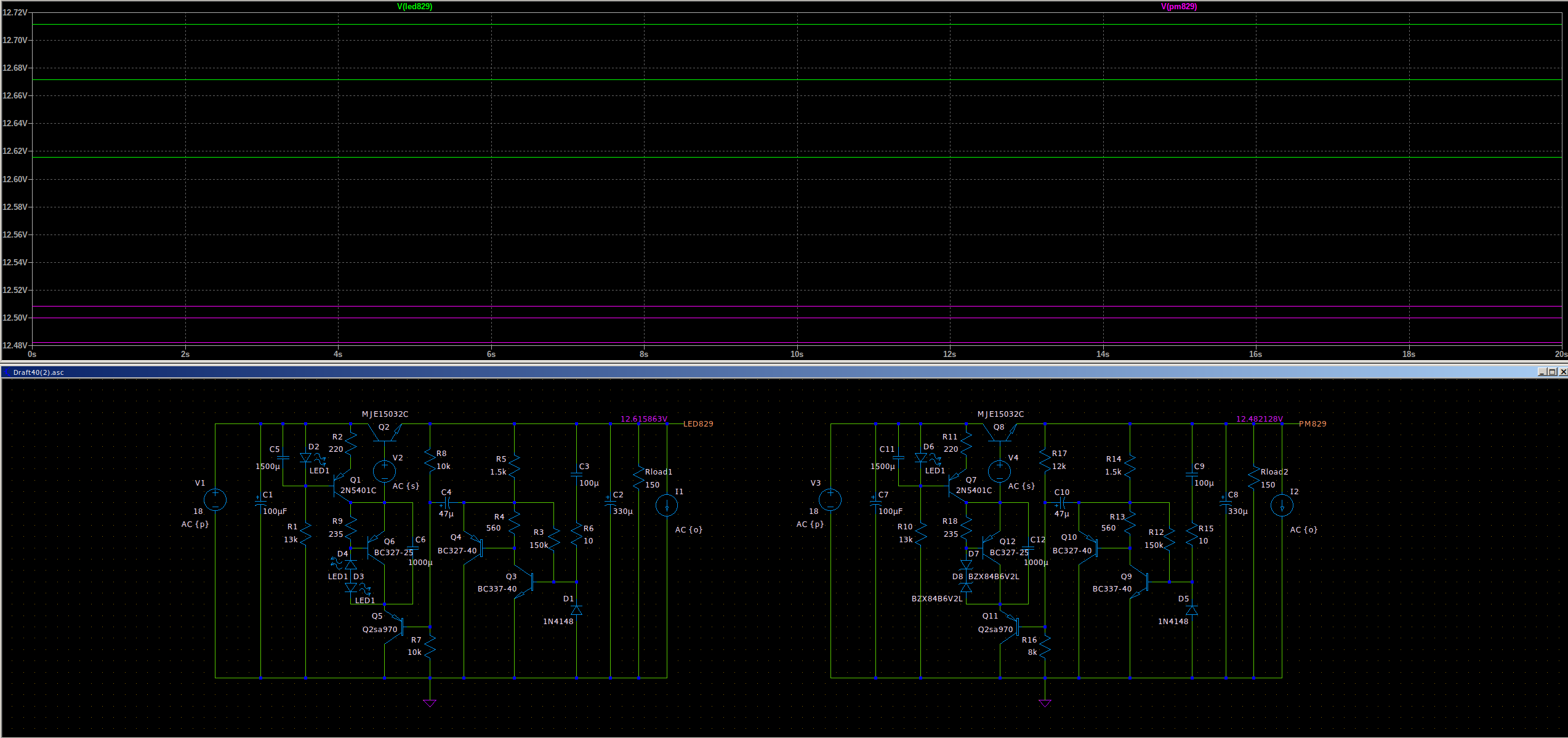

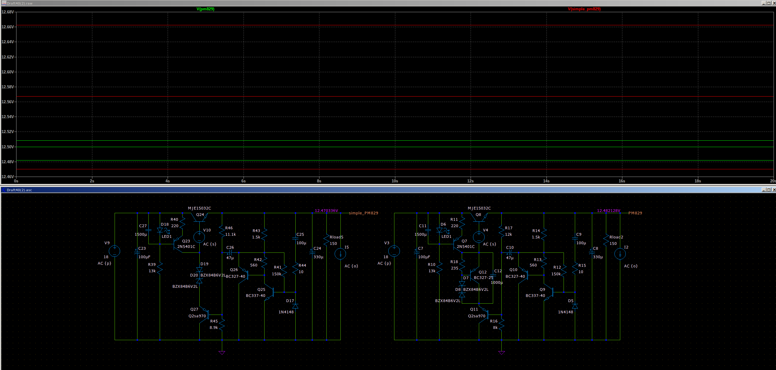

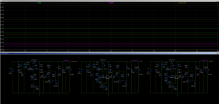

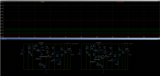

I ran the simulations for the negative feedback circuit. The same trend is noticed but the GLED block does not help to the extent it does in the positive feedback circuit.
Photos are in the same order as the previous post.
I added a CLC in front, because it does great work in my high power rails, I mean I have built it and it really helps. It adds a very interesting feature, seems to reduce noise in high frequency, If I read this correctly . I also added an LM317 in the end to be able to adjust voltage.
I will also add the AC transformer and rect diodes in front to get a full simulation.

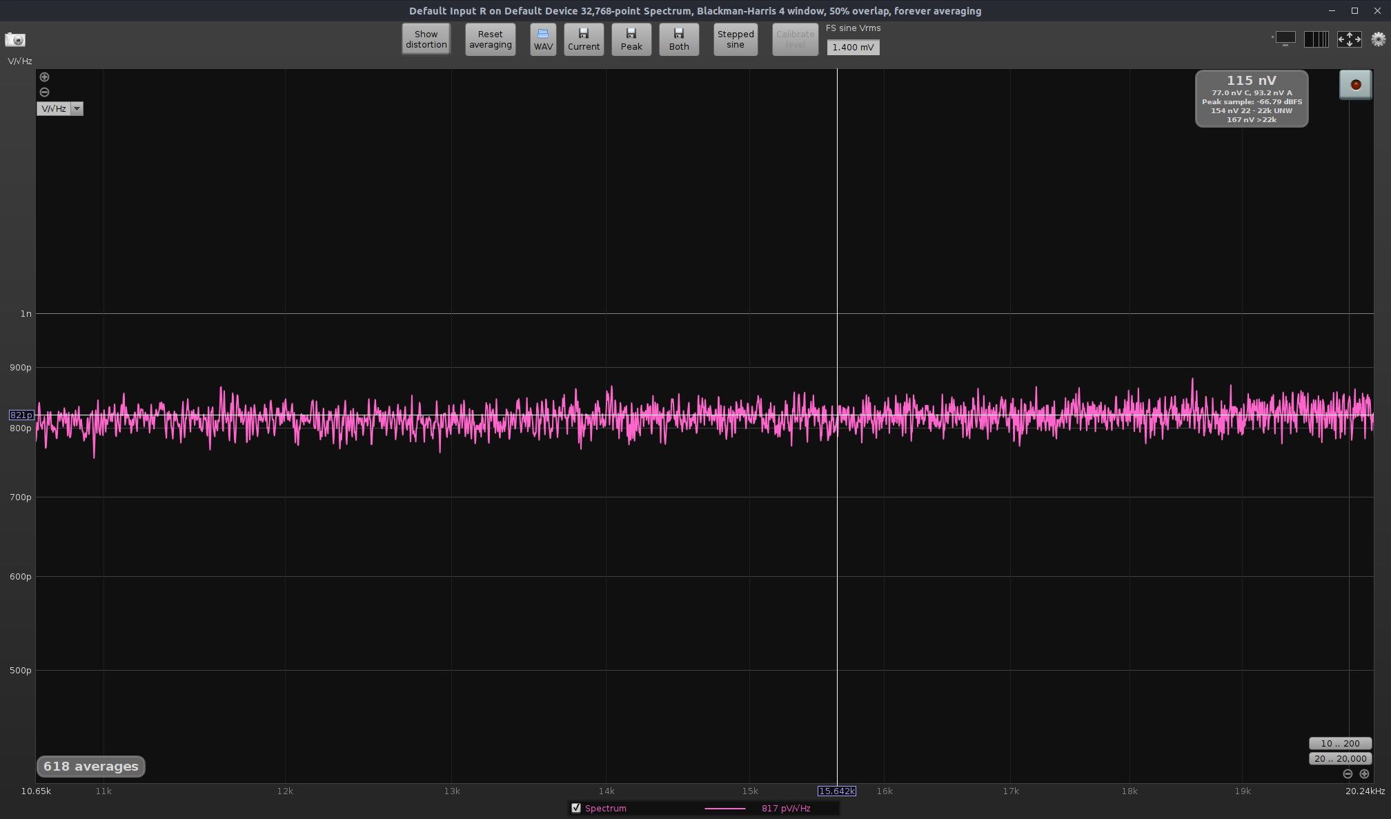

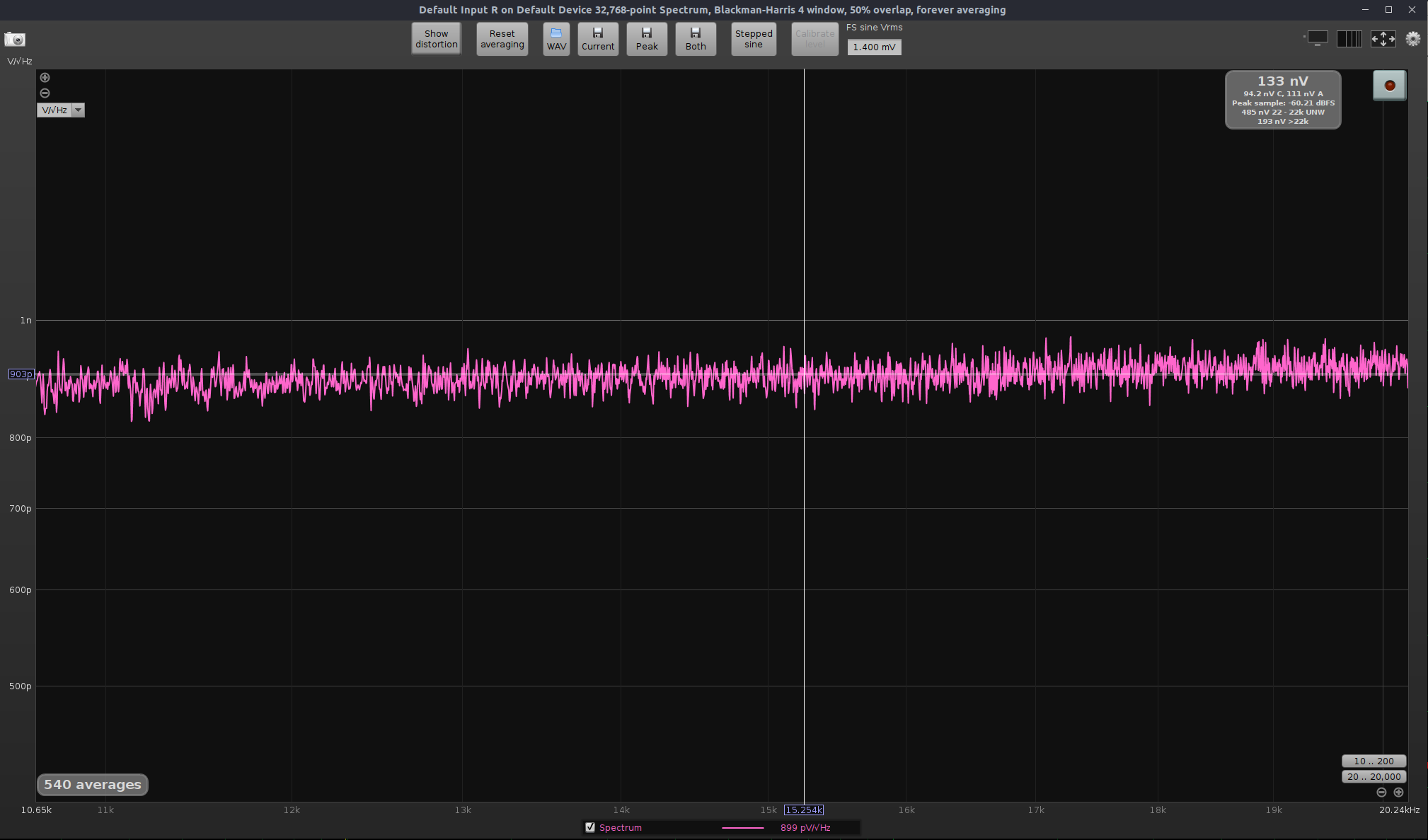

I measured the MOSFET version with the GLED block for Vref, with two red LEDs.

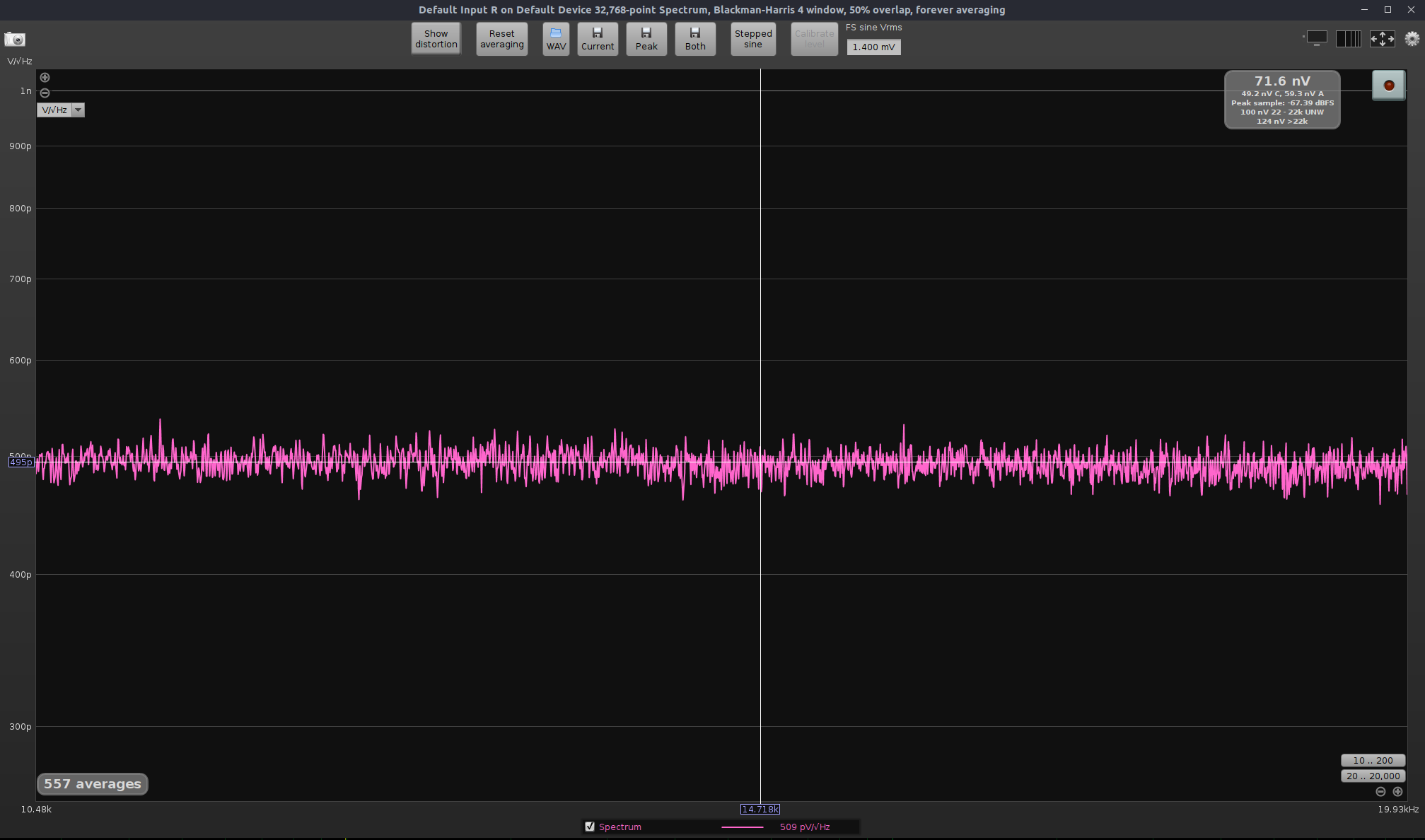

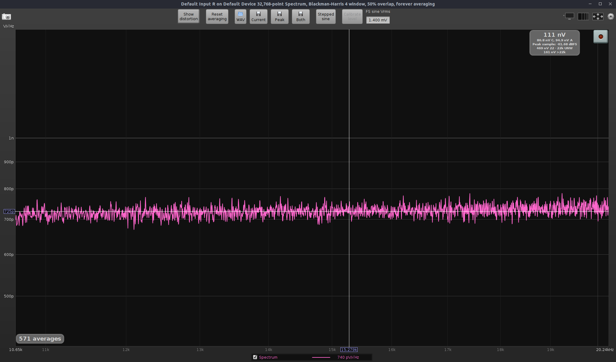

I measured denoiser with ZTX851, denoiser with MPSA06 and dienoiser with ZTX851 and MPSA56.
My calibration value changed as I discovered a software gain control that was offset from some time ago, and I reset it and recalibrated the value in both ARTA and REW. Previous values remained the same, PSRR of the MOSFET supply and also the LNA noise. Just wanted to explain why my calibration value is different now in the screenshots.
Shorted LNA measured 495pV/sqrtHz. Subtracting from the measurements the noise comes out like this:
Denoiser with MPSA06 - 750pV/sqrtHz
Dienoiser with ZTX851/MPSA56 - 650pV/sqrtHz
Denoiser with ZTX851 - 530pV/sqrtHz
Denoiser PSRR is the same with either MPSA06 or ZTX851.
So if you're looking for the lowest noise the denoiser with ZTX851 seems like the way to go, but you have "only" around 130dB of PSRR with just the denoiser.
Attached photos are the measurements in the presented order, and the last picture is my shorted LNA input.

Is the performance I see on the simulation true? Seems exotic. What exactly are the resistors i can change to change voltage? Are they more than one?
You can use a 20K pot instead of R24/R25. If Vref is around half of the output voltage the two resistors would have a similar value.

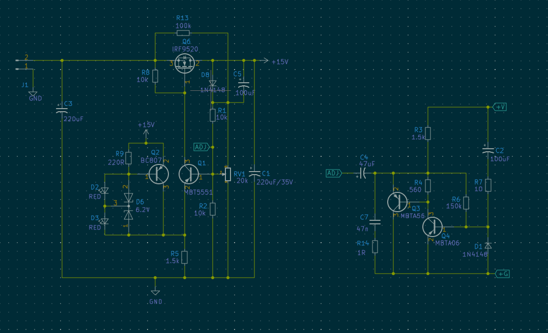

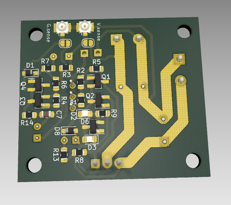

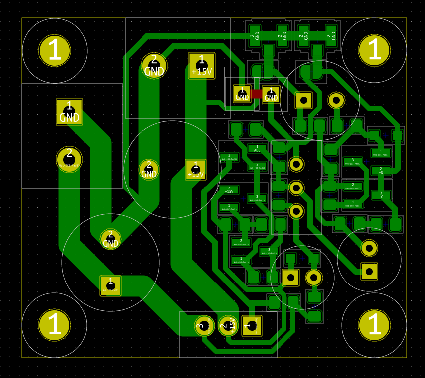

I updated the MOSFET pcb design to include the GLED block for better tempco, also added the option for two 0805 LEDs and also a SOT23 Zener footprint for either a single Zener setup, either the PM829 setup with two Zeners (part number DZ23C6V2 should work in this position).
If you wish to omit the GLED block then don't install Q2 and install a 0R resistor instead of R9.
If you install the LEDs then omit D6. If you want a simple Zener in SOT23 package then you need to install a 0R resistor instead of D2 (and omit D3).
If the PM829 block works the same for positive and negative voltage output then you just need to rotate the other polarized parts on the pcb for negative voltage output (and swap all transistors with their complementary). If the PM829 diodes have to be rotated for negative voltage output then there's SOT23 packages with the diodes rotated inside (common anode).
