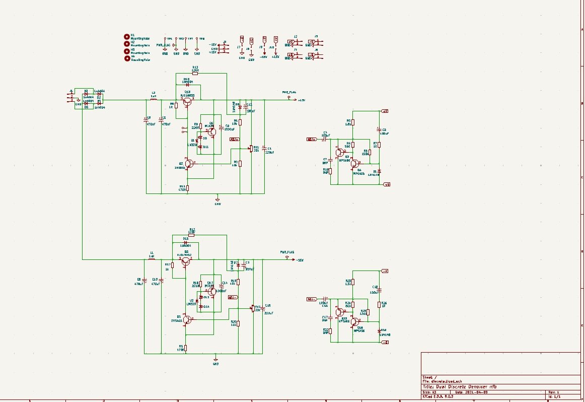

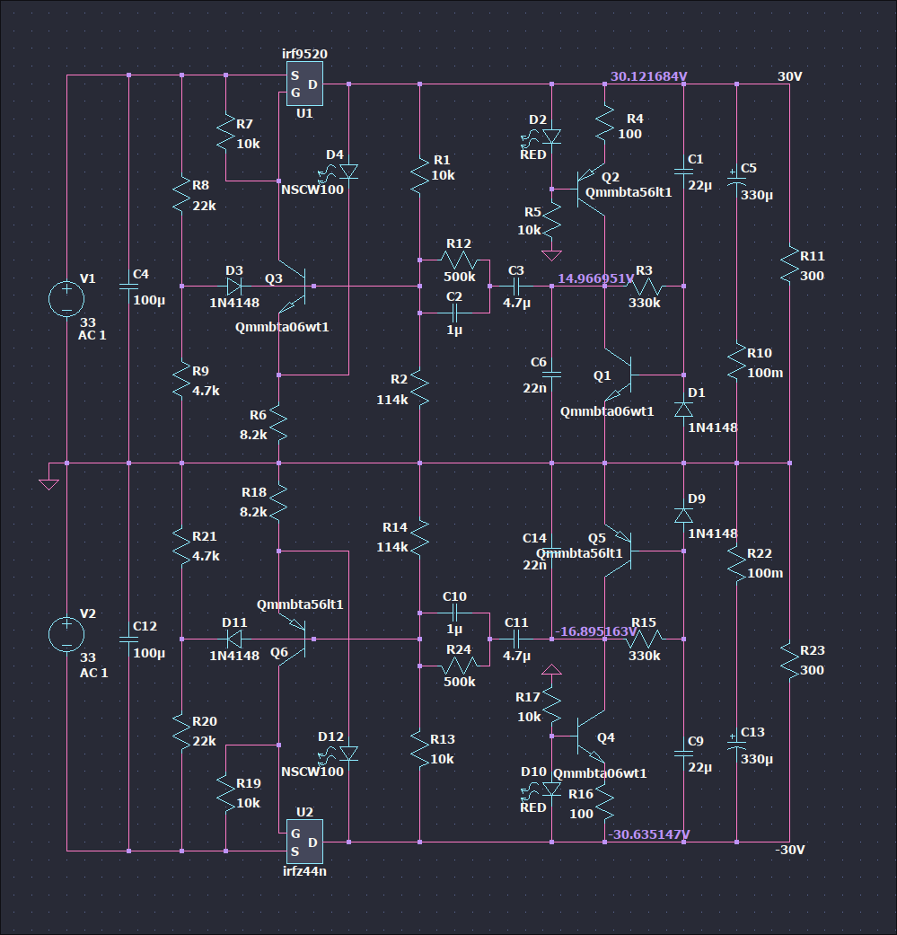

Hello Trileru thank you for sharing I accidentally found your post because I also happened to be looking for a supply regulator scheme for Wayne's BA2018 scheme. Because I have modified the scheme and layout, I will just change the name according to the version I made, because it is no longer original from Mr Wayne. I need a supply of around 15-25V. You can check the thread about my post here https://www.diyaudio.com/community/...waynes-ba-2018-linestage.423279/#post-7915193
Don't think I posted higher Vout values so here's a 30Vout version. Didn't test more than 15Vout so can't say anything about tempco or regulation. I'll try to test 30Vout at some point, and post the results. If 15Vout is too low for you and you want 20-25V I'll post an update.
If I use this schematic and create my own PCB layout design, I see AC voltage so I don't need to use a diode bridge, right? So I need to use an AC transformer to connect to the scheme?Don't think I posted higher Vout values so here's a 30Vout version. Didn't test more than 15Vout so can't say anything about tempco or regulation. I'll try to test 30Vout at some point, and post the results. If 15Vout is too low for you and you want 20-25V I'll post an update.
And if I use 22V AC voltage from a transformer will the scheme still work properly?
For 24Vout you can follow the 30Vout version I posted earlier and maybe drop R6/R18 to 6.8K and adjust Vout with R2/R14.
A 22VAC transformer should work for 24Vout. You need AC to DC bridge, maybe check the AC input PCB designs from post #209 and see how I did it.
If you design your own supply PCB I can't guarantee the performance from the measurements I made.
I recommend using the latest version of the circuit, example values in post #204. Just use a blue LED for D19/D23. All parts should be fine for 13Vout just adjust R18/R19.
