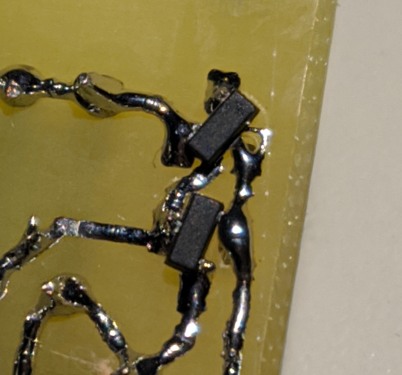

I'll try to measure this as I'm curious. The TO-92 footprints I used should allow for SOT-23 mounting on them. Not ideal but it should work. I remember I chose that particular TO-92 footprint as it allowed for SOT-23 to also be installed on them.

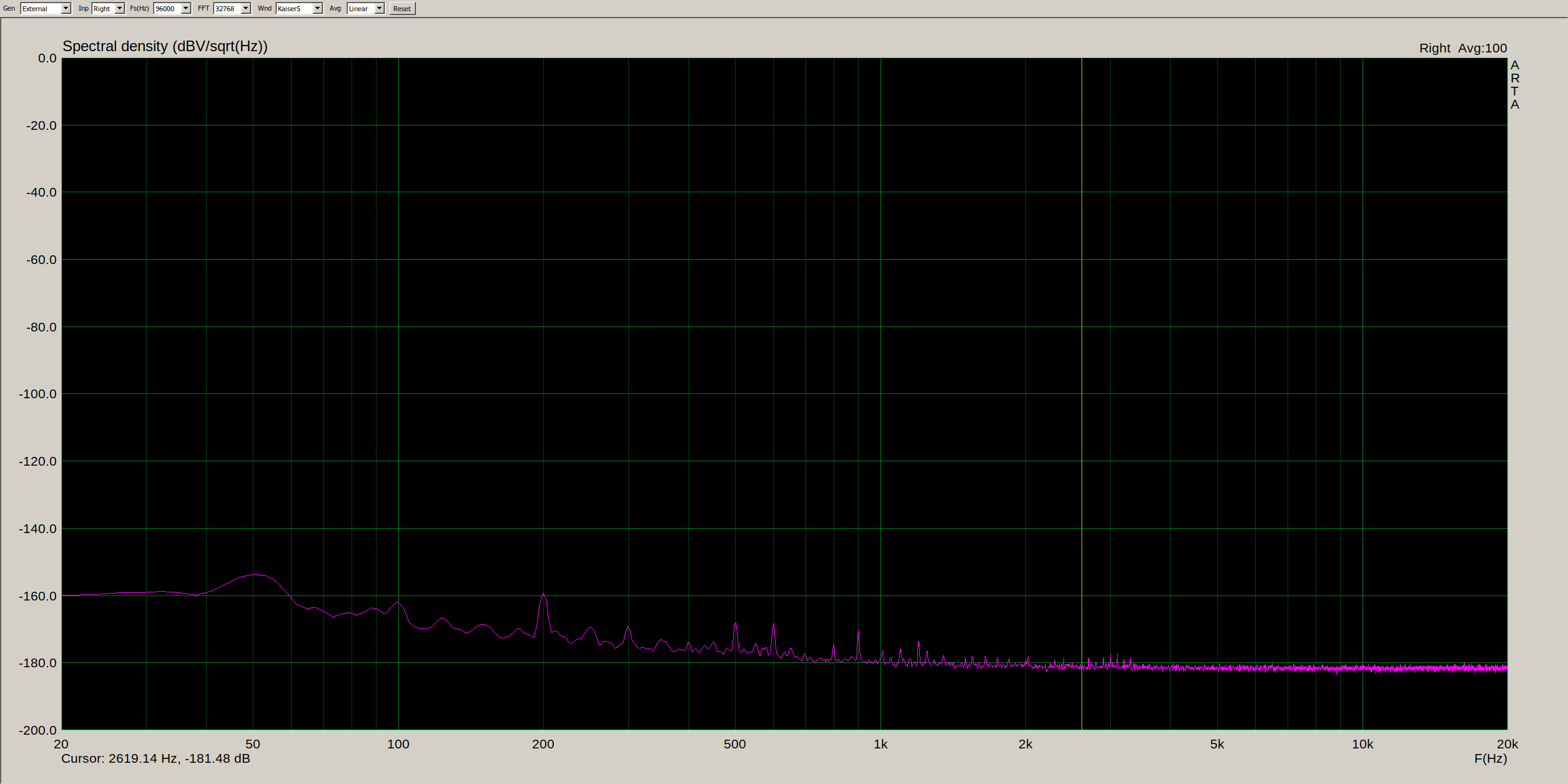

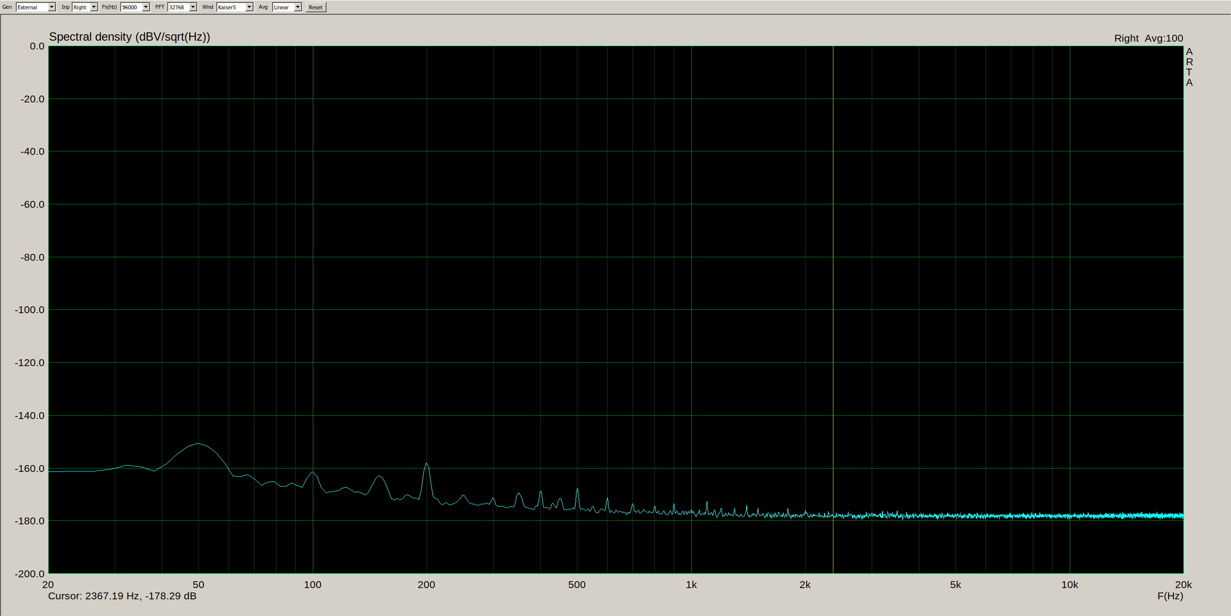

I measured the board with the BC3x7 pair and it came out at around -178.3dBV which means 1.21nV/sqrtHz. I then measured with the BC8x7 pair and it came out at -181.5dBV which means 0.84nV/sqrtHz.
So using the BC8x7 pair results in an even lower noise floor. I made a photo of how I installed them on the BC3x7 footprints on the backside of the PCB. The top one is the BC807 and the bottom one is the BC817.

First photo is measurement of noisefloor with BC3x7.
Second photo is measurement of noisefloor with BC8x7.
Third photo is how I installed the BC8x7 on the BC3x7 footprints.

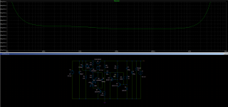

So apparently, opposed to LM317+denoiser, these discrete circuits have a really low noise with just the denoiser. So basically to switch from the dienoiser circuit to the denoiser one you just have to short the 560R resistor thus taking the second dienoiser transistor out of the circuit.

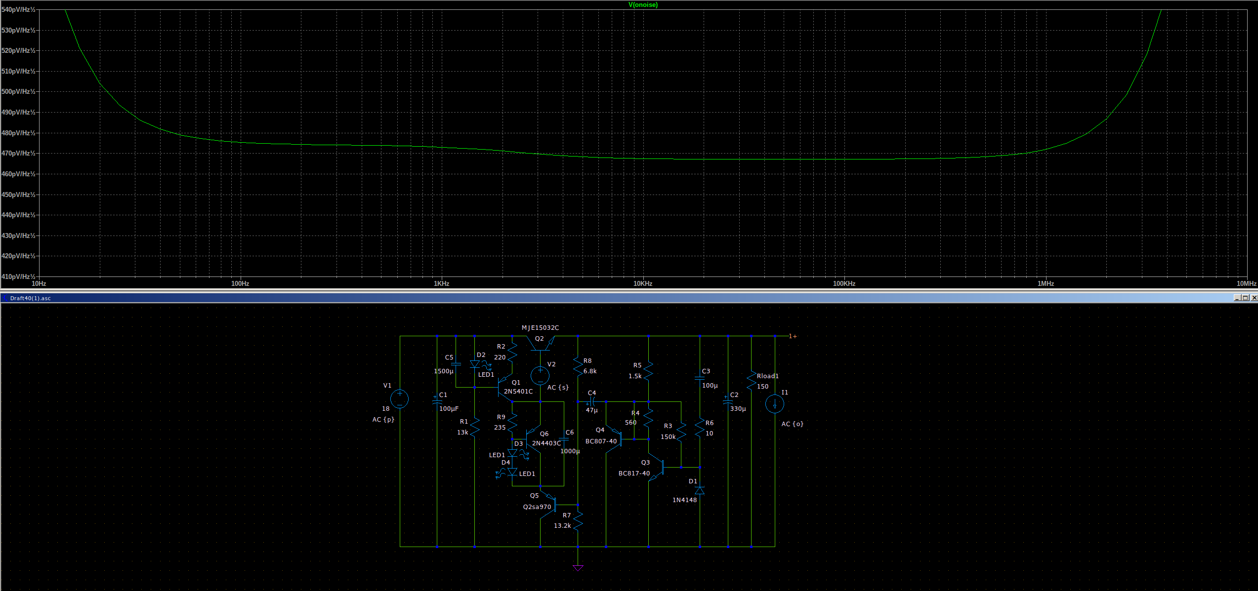

Playing with the sim it seems that with either BC817 or ZTX851 you'd get the noisefloor at around 0.42 to 0.47nV/sqrtHz.

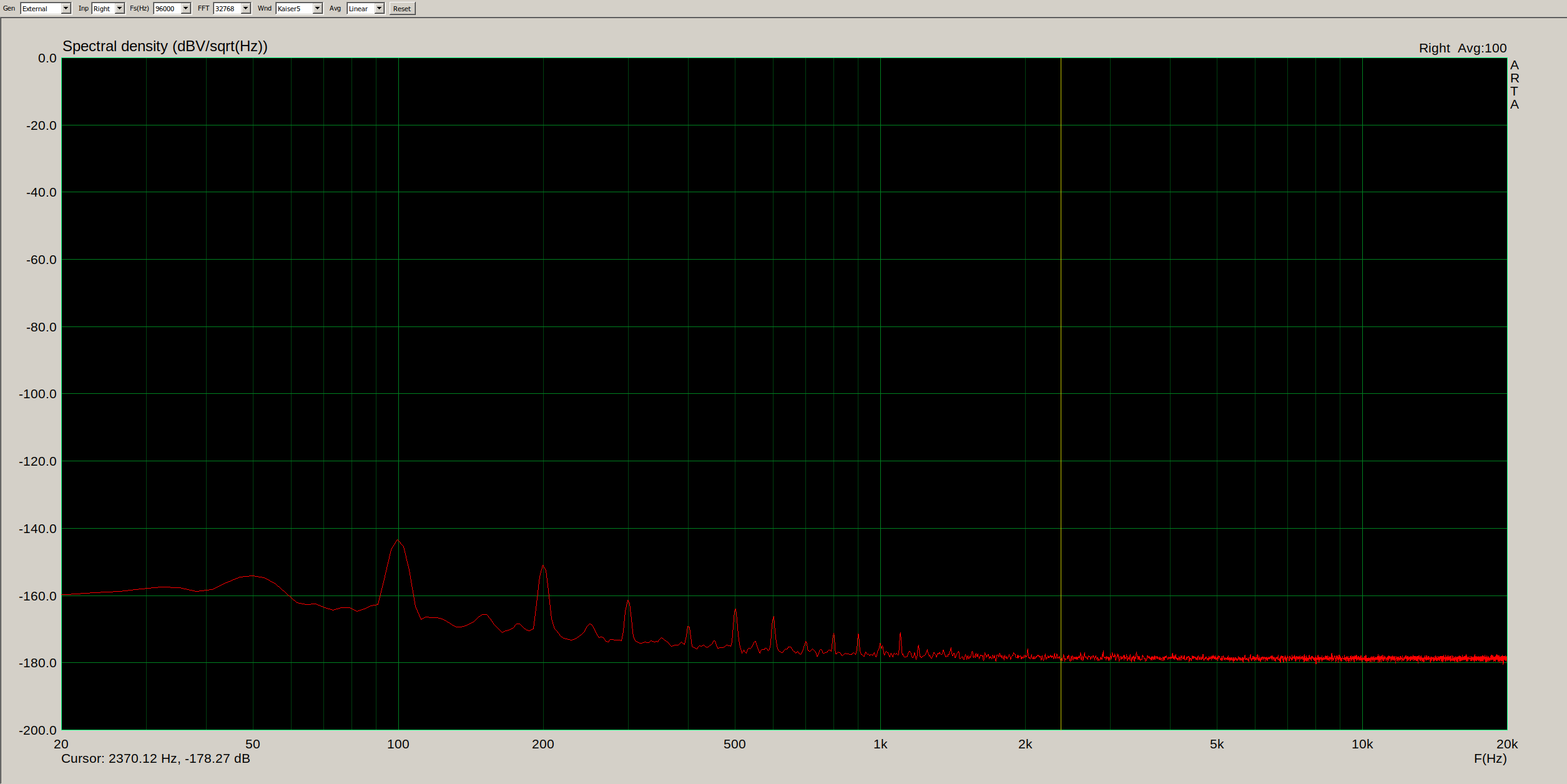

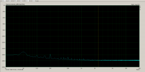

I did measure with just the denoiser and the noise is a touch lower than with the dienoiser. It measured at -182.13dBV which means 0.78nV/sqrtHz as opposed to the 0.84nV/sqrtHz of the dienoiser. But I had the pcb on the desk, with no shielding.
So if you'd like this even lower noisefloor, you could sacrifice some PSRR and output impedance performance and go with denoiser, and you could compensate for PSRR with the capacitance multiplier.
The output impedance for the first circuit changes from around 0.4mOhm with dienoiser to around 3mOhms with just the denoiser circuit, from LTSpice sim.
First picture is noisefloor with denoiser circuit simulated in LTSpice, second picture is the measured noisefloor with the denoiser circuit instead of the dienoiser one (and BC817).
edit: The negative versions don't benefit this much from switching to BC8x7, but the negative versions with ZTX951 do go to around 0.45nV/sqrtHz with denoiser in LTSpice sim.

Yeah I just measured the noise of different BJTs in the circuit and mine powers up between 3-5 seconds or so each time.
Seems like a good alternative to BC337/BC327 is the 2N4401/2N4403 pair. Almost as good as the BC817/BC807 one.
For denoiser only:
BC337: 1.17nV/sqrtHz (around 3-4kHz).
BC817: 0.7nV/sqrtHz
2N4401: 0.76nV/sqrtHz
MPSA06: 0.7nV/sqrtHz
For dienoiser:
BC3x7: 1.2nV/sqrtHz
BC8x7: 0.8nV/sqrtHz
2N440x: 0.84nV/sqrtHz
MPSAx6 : 0.78nV/sqrtHz
I suggest you use the MPSA06/MPSA56 combo for denoiser BJTs. They seem to increase the PSRR, at least for the first circuit, closer to the predicted 156dB from LTSpice. For the positive feedback version I measured 152.6dB PSRR with MPSAx6. BC8x7 measured 146dB.
Denoiser PSRR was around 125dB for both.
Noise density measurement showed the same noise for both types, around 956pV/√Hz for the dienoiser and around 840pV/√Hz for the denoiser version. So all previously posted noise values should be in reality around 150pV/√Hz higher.
