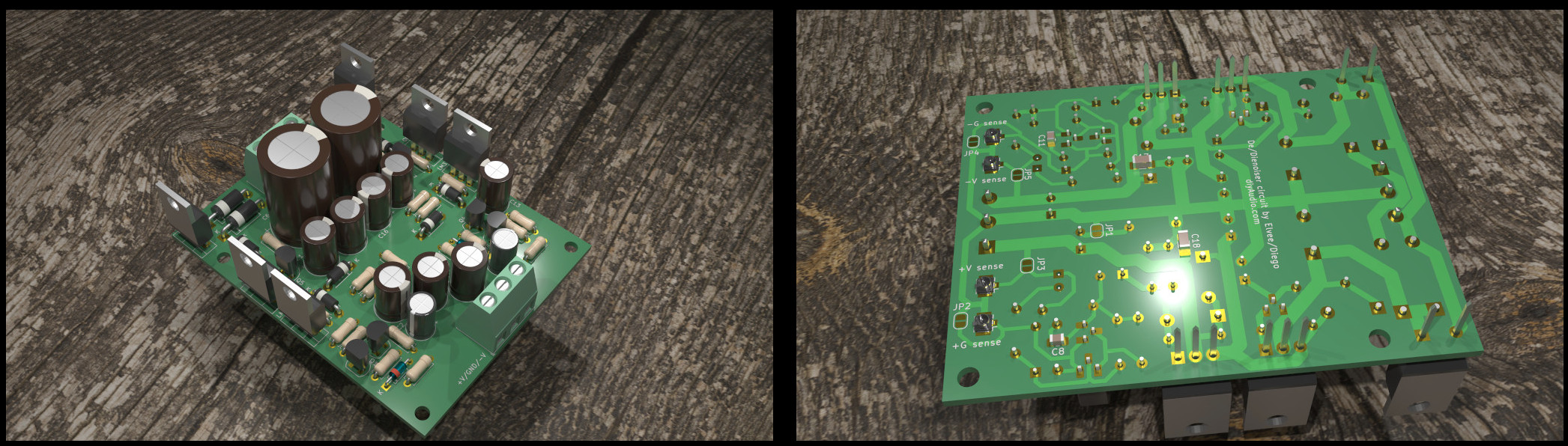

The dual version I did for LM3x7+dienoiser has the option to use a single secondary transformer for both rails, in which case you'd use TO220 diodes. You can also use it with a center tapped transformer with normal diodes.
I attached a photo of it, and the latest version for it can be found here:

Any suggestions are welcomed for the dual board. Including heatsink type/preference as I usually make them so that you mount the heatsink on the sides of the PCB for cm transistor/regulator transistor/to220 diodes. Or slapping all to220 to the bottom of a metal case.
But adding heatsinks on the PCB itself is going to enlarge the board.

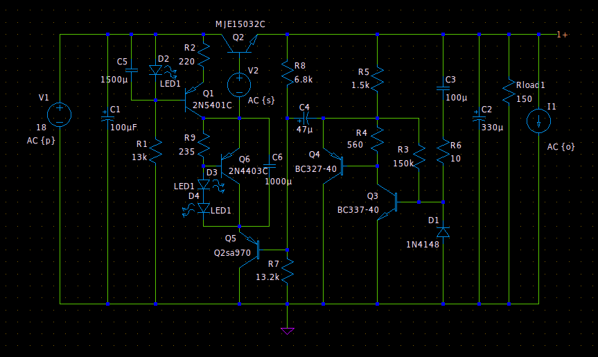

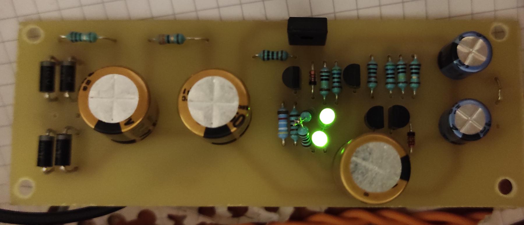

I made one of your suggested circuits. You made if for 30V and I adapted to 40Vout.
I can tell you it is working stable. I ran my phono with it and it sounds great.
Can you review it and tell your opinion? It isn't the newest version, but I had to start somewhere

That looks good, congratulations!
Yeah I forgot to mention that these supplies are all slow-start.
One thing to mention is that I wouldn't use LEDs for such a high voltage. I mean looks like you could, but at this point I'd use a Zener to up Vref. Maybe 15V zener.
Also maybe lower R17 to around 6.8k and R15 to 680k. You'd have almost 6mA for the denoiser current. With 10k you have 3.9mA or so. You could also parallel Q11 C-E with a 1200uF cap for more performance.
Let me simulate your conditions and see if there's other improvement in values. R14 might be too high and you risk your supply not starting up also.

Please simulate, but I think that you are wasting a lot of mA in heat only my goal was to have stable supply with minimum current consumption.

Will try positive feedback version too, I have PCB on my table.

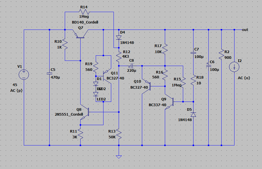

Edit:
With R11 8K2 LTSpice shows good results, but PSU doesn't start. Maybe if I lower R14 and go up with R11 to 8K2 it would work? With R11 3K and R14 1Meg it starts OK!
I think R14 value depends on R12, R12 is lowish as you use LEDs which makes for a low Vref, so in turn R13 ratio to R12 is high. If you use a Zener for Vref and increase R12 then 1Meg might be too high. I'd use a 330K for R14 just to be sure the supply starts.
Also 15s seems like a lot. I usually see the LEDs light up in 5 seconds max.

I don't have green LEDs sim models. What Vdrop do they have?
Also for the positive feedback version when you make the PCB there's an important node that needs a clean ground, it's the GND point of R1 in the attached photo. I lost some dB in PSRR at first iterations because that grounding point was not optimal. Check my designs to see how I did it.
edit: Q5 should be BC560 max gain version.
