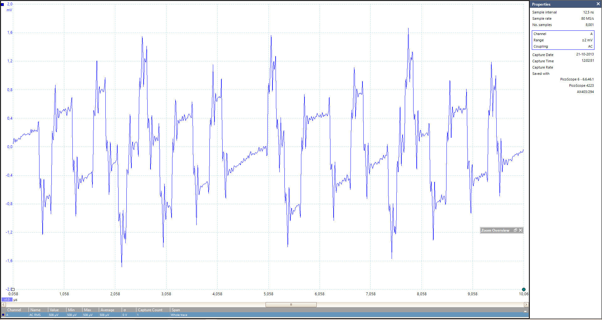

The output of PCM1794
Graph 3 is visible best.
Peaks with amplitude 1ma and time 2ns.
And this should be integrated accurately.
This overloads each integral audio operating amplifier.
Interesting images and useful to look at.
However I'm highly suspicious for two reasons:
1) The output impedance of your I/V is in series with the current from the Dac, causing a larger voltage excursion.
2) To measure 2nsec spikes you have to connect your gear in a very controlled way.

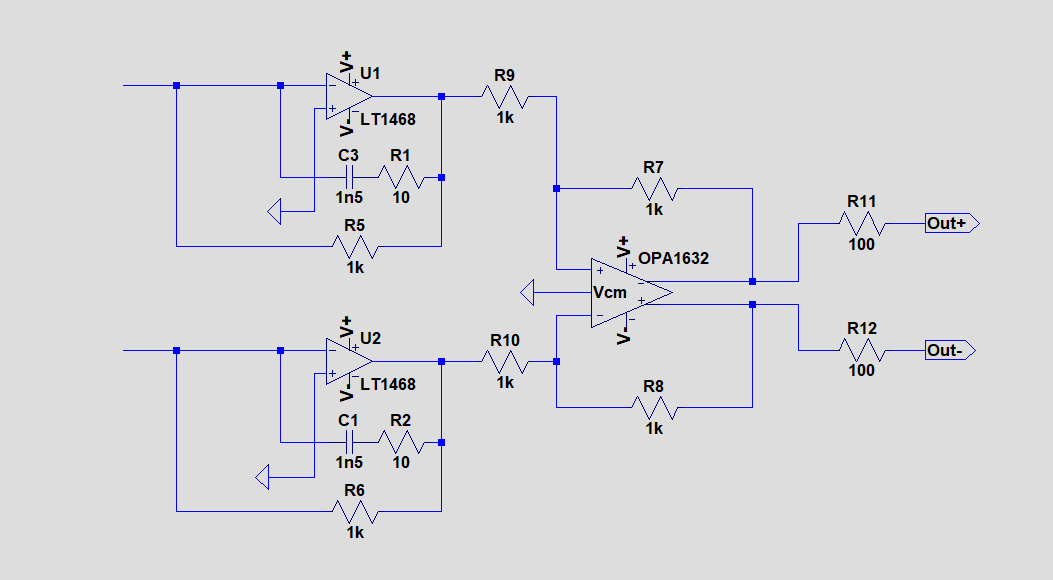

In the first image below you see the recording from the same PCM17xx Dac after I/V, connected from Out+ with coax to 50 Ohm HP461A input, in combination with my scope having a rise time of 12.5 nsec.
The I-V converter is shown in the second image, being the Bel Canto 3.5 Dac.
The 10R is probably inserted in series with the cap for stability reasons.
The 100R out+ going to the HP's 50R input, in combination with the HP's 100x gain results in a gain of 33. for which the vertical scale was corrected.
Signal used was dithered silence.
Closer inspection shows nothing in the low nsec.
The large 1.6mV excursions would suggest 1.6mA peaks, but because of the 10R in series with the 1.5nF cap this reduces to 160uA, still without taking Zout of the LT1468 into account.
So it is probably even below 100uA.
Conclusion is that our images don't match.
Hans

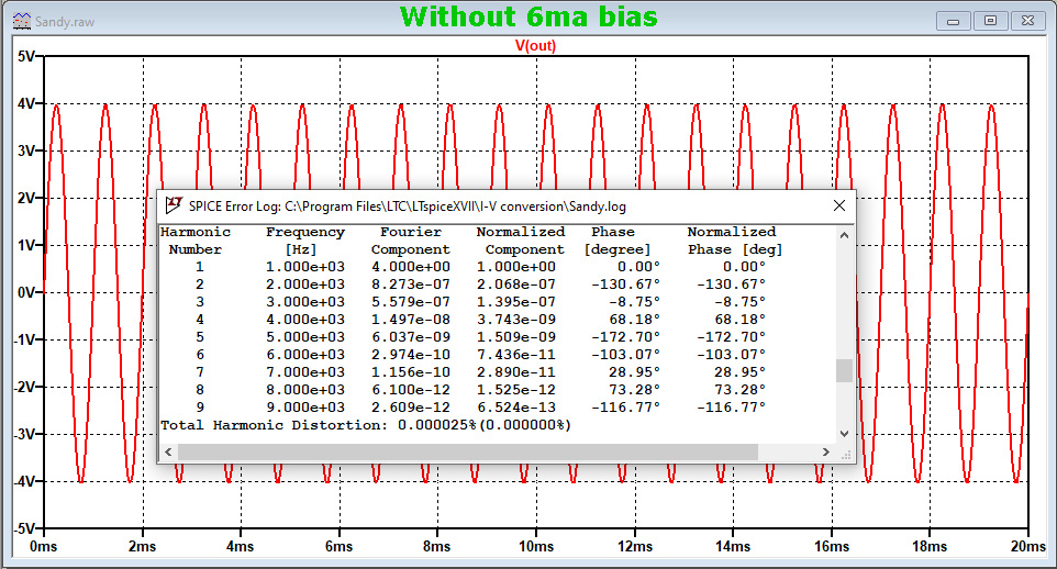

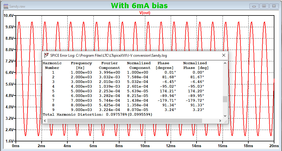

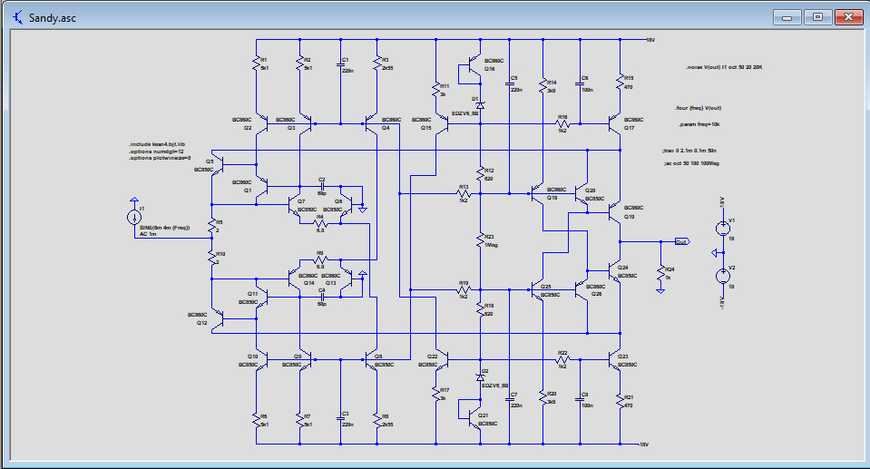

Sandy,
Out of curiousity I simmed your I-V converter from posting #85, see first image.
Then I offered a 1Khz current as from the PCM179x, being +/-4mA on top of a 6mA bias, see second image,
With 0.097%THD, the converter felt unhappy, so I reduced the output voltage by replacing 1K by 500R.
THD went down to 0.000 296, but still far from your specs.
When removing the 6mA bias but keeping the +/-4mA, distortion went down to 0.000 025%, see third image.
Using the +/-2mA from your posting #85, I finally got your 0.000 006%.
So it seems that the presented figures are from simulations with perfectly matched transistors and without bias.
Real life figures are always higher.
There was no difference in THD between 1Khz and 10Khz, which is good.
But it seems that you still have to fiddle a bit on the circuit diagram to cope with bias currents.
Hans

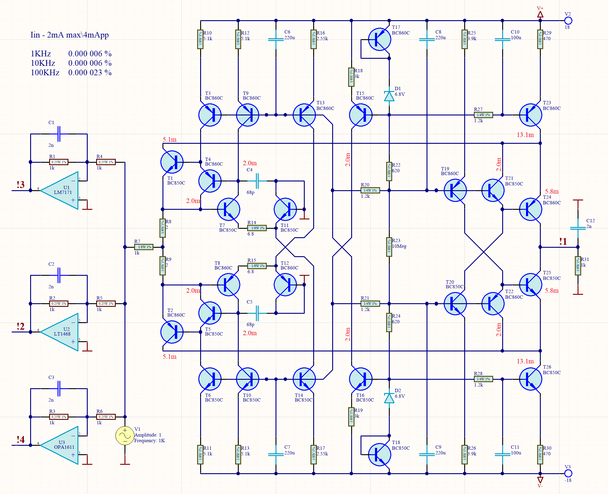

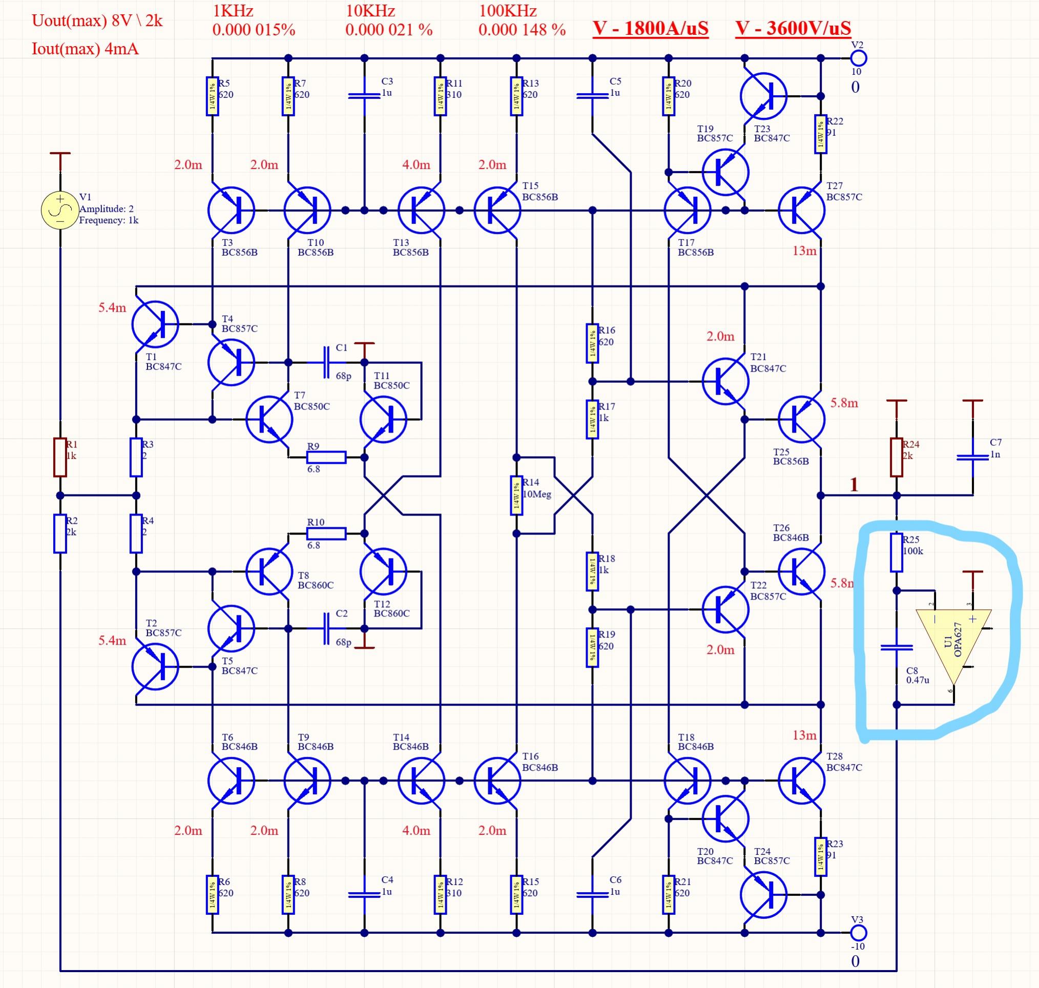

Hans,
What you do are elementary mistakes.
This converter can not have the DC current input.
View # 1 DC at the inlet is removed from U2 (OPA627)
In the simulation you do not have to supply DC current and does not have the operational amplifier.
This scheme is designed for +/- 2MA (4mApp)
If it will be used for +/- 4MA (8MApp) need IC through the transistors to double.

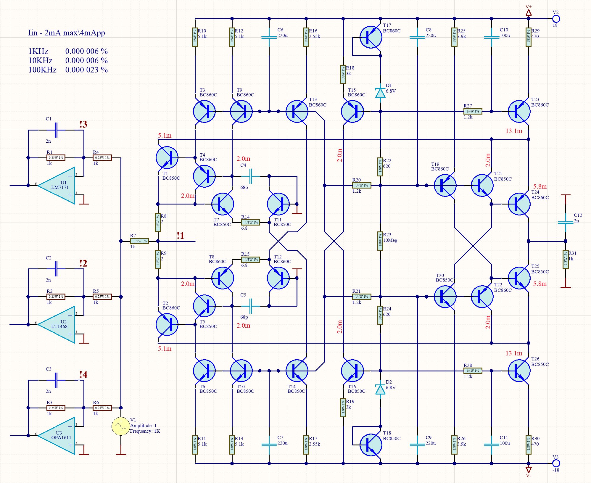

Hans,
These converters I was made by friends on my idea.
And for fear, they put such operating amplifiers.
The requirement for this amplifier is good to filter the sound, TL071 is sufficient.
And here I show you only the idea, not the finished finished project.
Who has some knowledge in the field of electronics understands what it is about.
For those who don't understand, I apologize.
But this is not the place to study electronics.

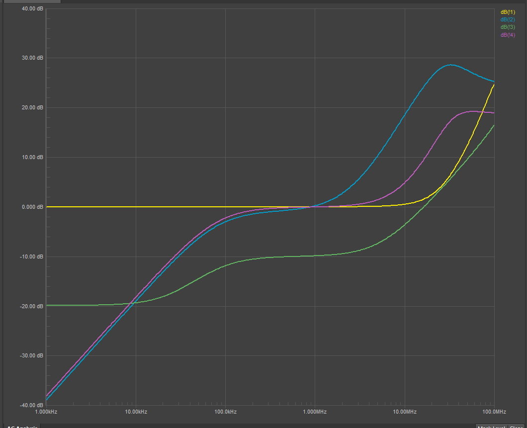

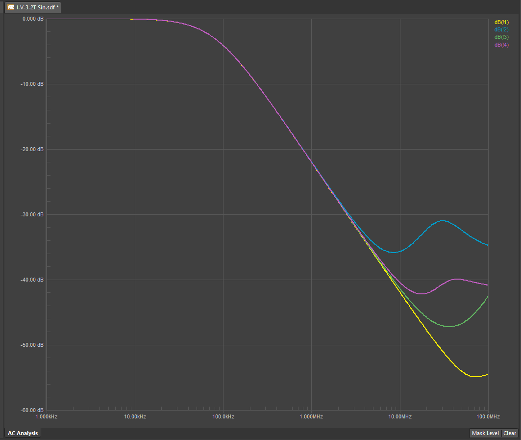

Here is the frequency response.
This is important because you have to integrate the high frequencies into the DAC output and they are > 10 MHz
And the input impedance in dB 0dB=1Ω
The best is the fastest operational amplifier.
But the noise of such amplifiers is very large for sound frequencies.
