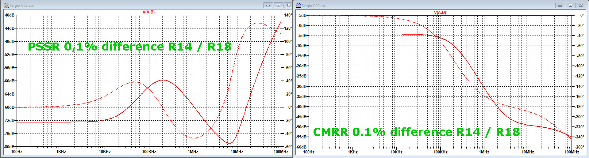

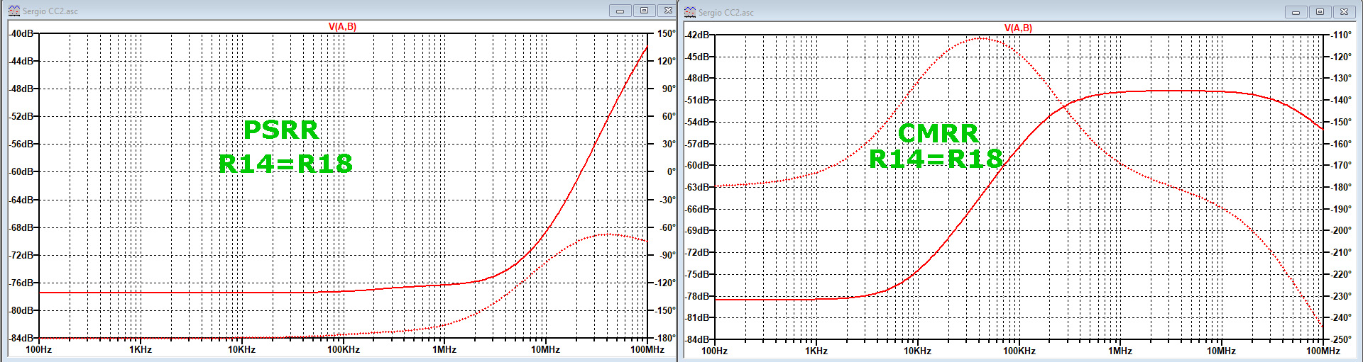

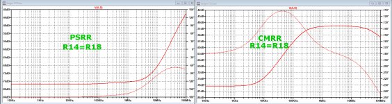

This is what LTSpice shows for PSRR and CMRR, measured at the output of the OPA1632.
Both channels are influenced the same way by power fluctuations potentially leading to a cancellation.
Even when giving both inputs a slightly different bias, nothing changes to the PSRR.
But the components having a high sensitivity for PSRR on the +15V side are the collector resistances R14 and R18. These should be within 0,01%
Negative supply PSRR is the same as the positive, but does not react on differences between R14 and R18.
CMRR is even more sensitve for the match between R14 and R18, so one of both should have a small pot included for tuning the CMRR at it's best value.
Automatically PSRR will then likely also be optimally tuned.
In the images below first the PSSR and CMRR in the optimal way, and the second image when R14 & R18 are 0.1% apart.
Any reason to distrust these figures ?

Adding current sources to V+ will obviously improve the PSRR and CMRR, but then the complexity increases to the point where a good dual op amp will be more economical (including board real estate) and without the matching pitfalls of a discrete implementation. I don’t see what this discrete implementation could do better than an OPA1612 and an OPA1632 (or, even better, a THS4551, if 5Vpp output is enough) if one needs level shifting.
P.S. I’m afraid thermal drift will also not be great. Dual transistors would be ideal, but probably still not enough. Ideally, the output drift should not exceed the DAC LSB, which is around 1uV. Not that it would be anywhere audible, but for an apple to apple discrete to op amp comparison it is worth considering.

Thx Syn08,
I have given this current conveyor design a fair try after my initial optimism.
It was a nice exercise, but especially the potentially very bad CMRR that worries me even more in this case then the PSRR, can't be reduced easily because common mode signals are amplified at open loop gain.
Only very cumbersome tuning of resistors can get this under control to some degree, but temp will detune this very easily.
I-V converters shown in this forum are mostly regarded as having to amplify only one Dac channel, but for Dac's with differential outputs, CMRR becomes all at the sudden very important making the choice between a current conveyors and fast opamps quite easy.
And of course PSRR with opamps is the least of your problems.
So I'm back to where I was originally.

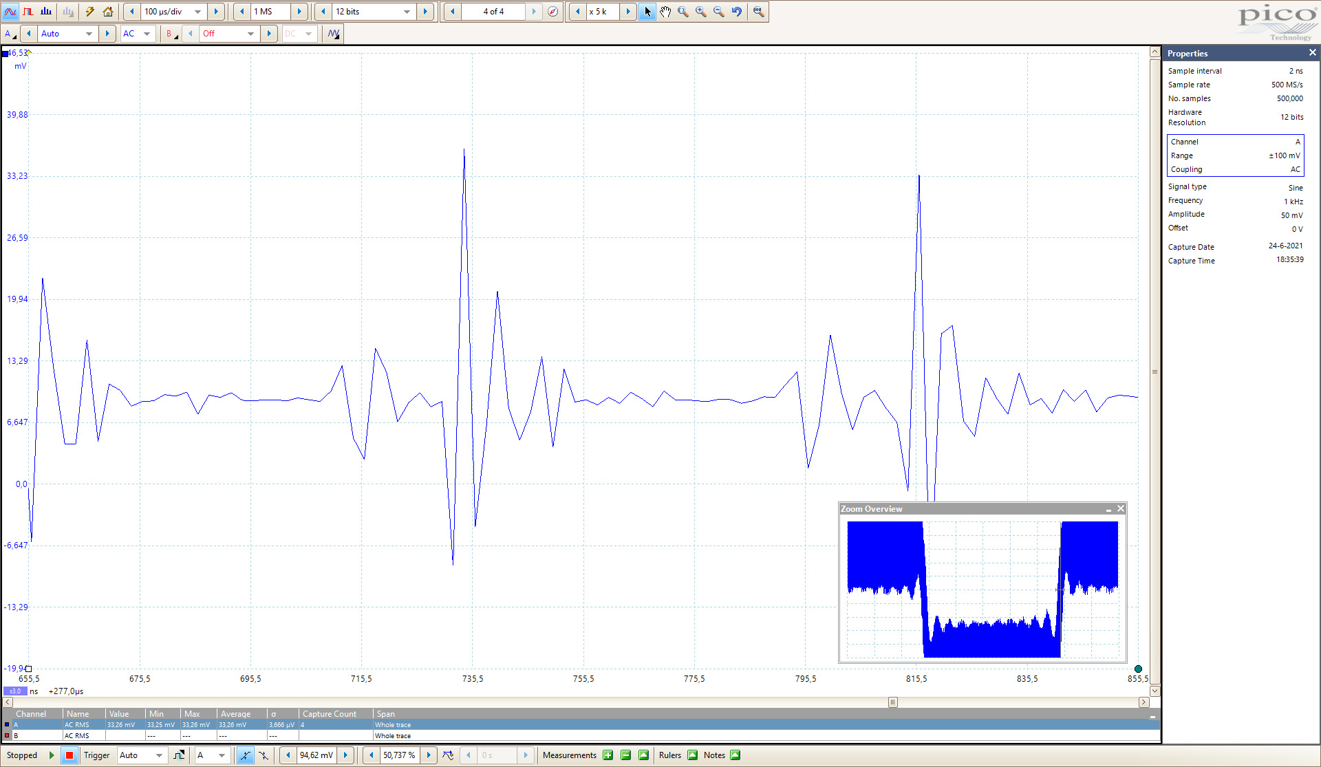

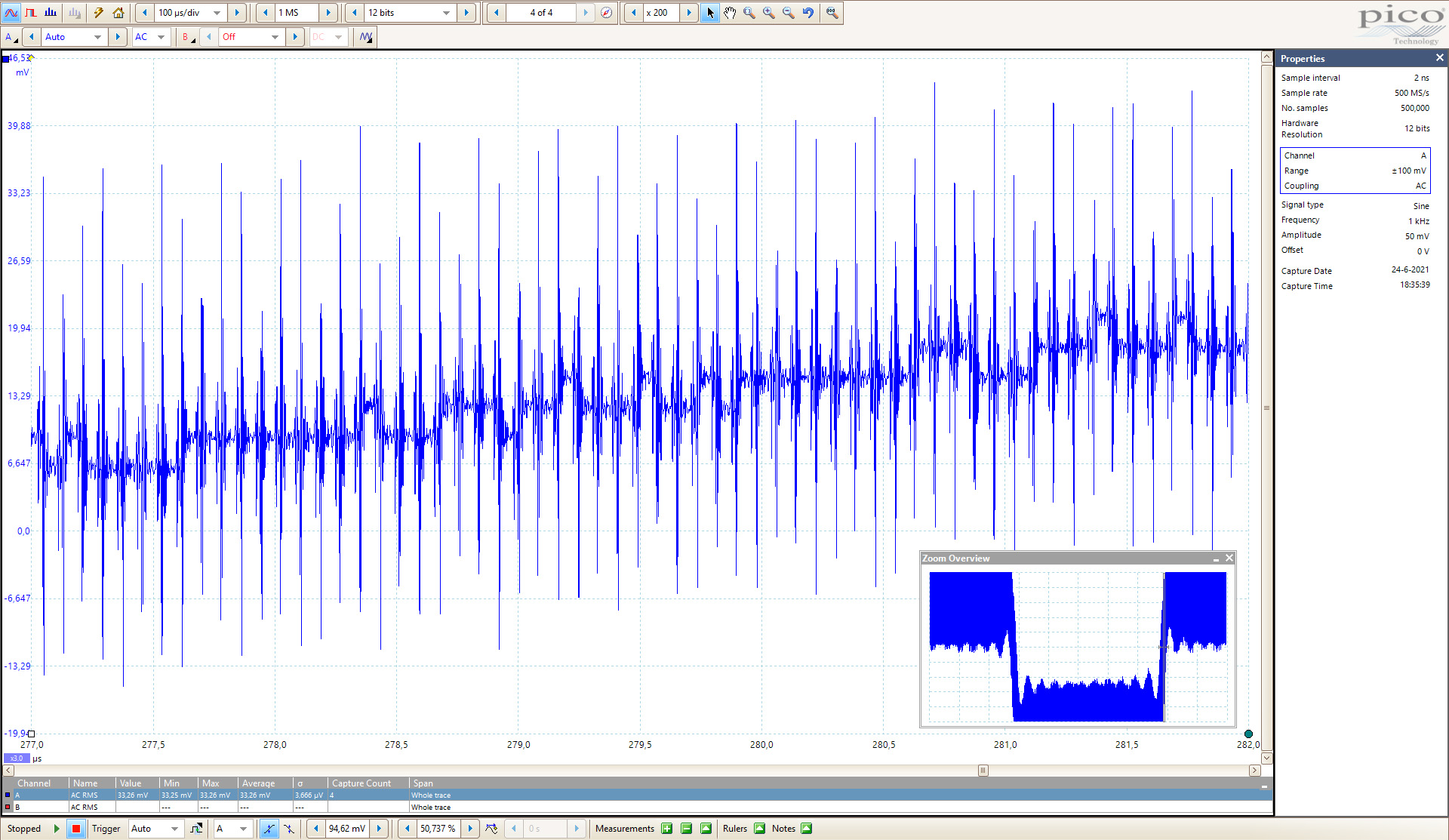

I had second thoughts about the undocumented image of the Dac output signal that Sandy showed, giving transients of 1nsec.
Discrete I-V converter
Some people have to learn the hard way, well that's me.
On my multilayer PCB with carefully separated digital and analog ground planes, I terminated both PCM1792 outputs with very low induction 50R current sense resistors.
To this resistor I connected a 50R coax, terminated with a 50R feed through resistor on my scope, sampling at 2nsec intervals.
So in effect the Dac was terminated with 25R.
I offered a digital 1Khz -12dBFs square wave and measured the output of the Dac in the middle of the upgoing slope.
Image 1 below shows the recording over a 15usec period, giving a good impression of the nature of the signal generated by the Dac.
The second image shows a further magnified timescale to 20nsec/div.
There are transients of 2nsec to be seen, so my scope is not fast enough to capture this signal more accurately.
But pulses are obviously and indeed in the low nsec range.
The ca 40mV transients correspond to almost +/ -1mA peaks from the Dac.
Important question now to answer is, what requirement does this pose on the I-V converter.
A converter at this frequency will likely have the same sort of 25R Zin, so it's input will see 40mV voltage excursions that it can't follow.
Can this possibly do any harm, I don't think.
To my feeling a fast opamp like the LT1468 or the OPA1612, already standard equiped with proper input overloads protection should be able to cope with these pulses.
Anybody doesn't agree ? I welcome any kind of comment.

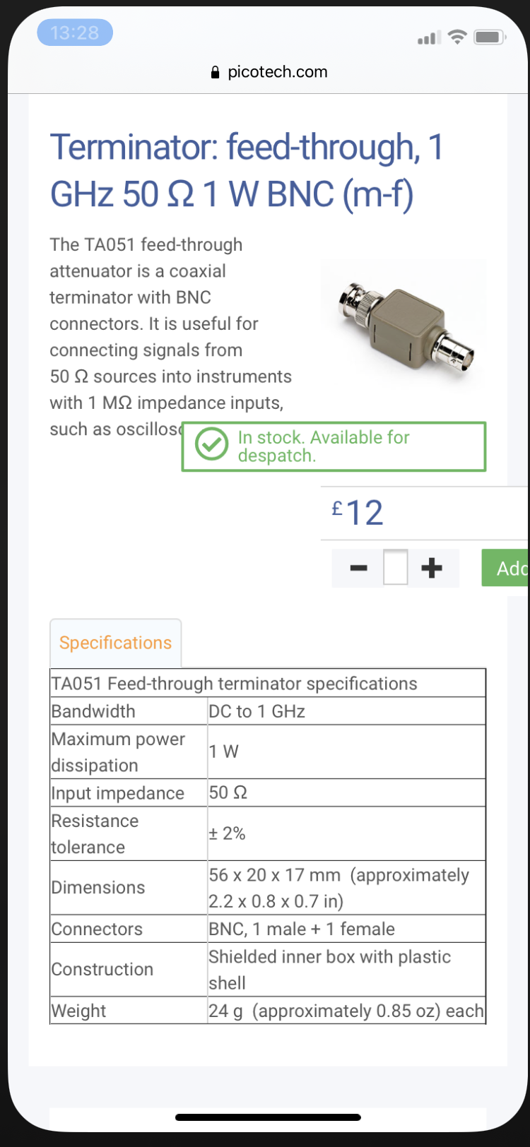

What probe are you using for these measurements? Do you have an <1pF probe to reliable see those spikes? I’ve seen way too many scope/probe artifacts, and what an improper probe can do to a signal, to trust such short (2nS) events having much to do with the truth. Think of a 10pF probe as added to an allegedly carefully matched coax...
I agree that such a measurement can be quite tricky, that’s why I didn’t use a probe.
Connected at less than 5mm distance to the 50R low induction resistor over the Dac’s output I mounted a coax socket.
A 1 meter RG58C/U 50R coax cable from here entered a DC to 1Ghz 50R feed-through termininator at the scope’s 1Meg//8pF input.
Do you see any way to improve this, I’m open for suggestions.
