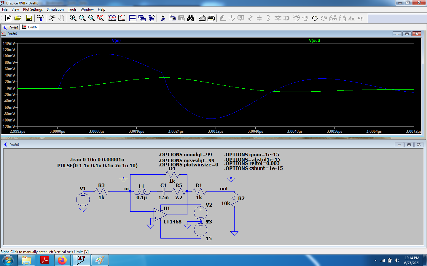

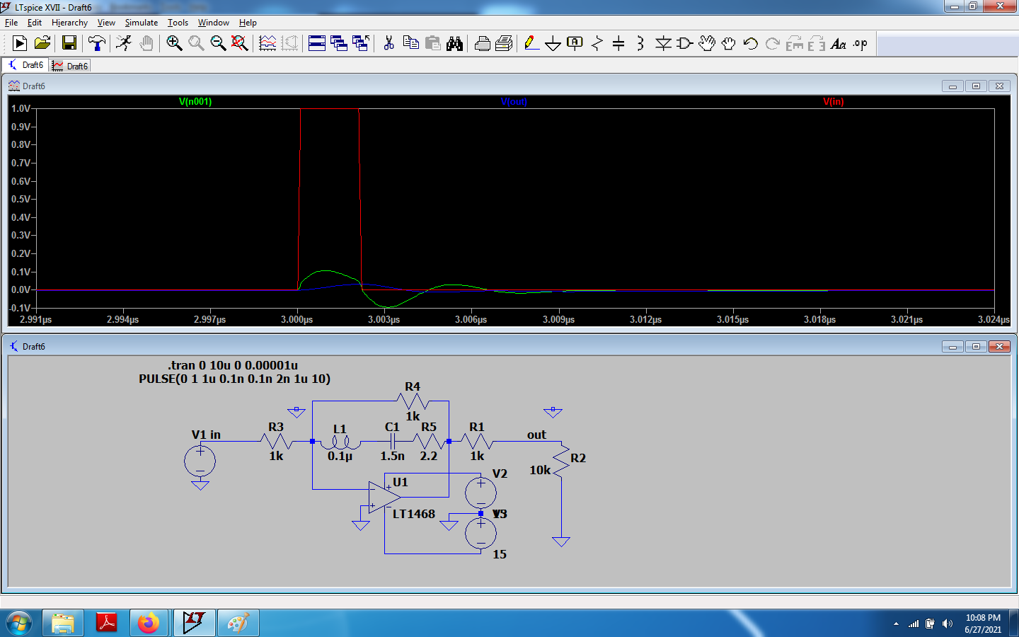

I just show Hans what to try to measure with this simulation.

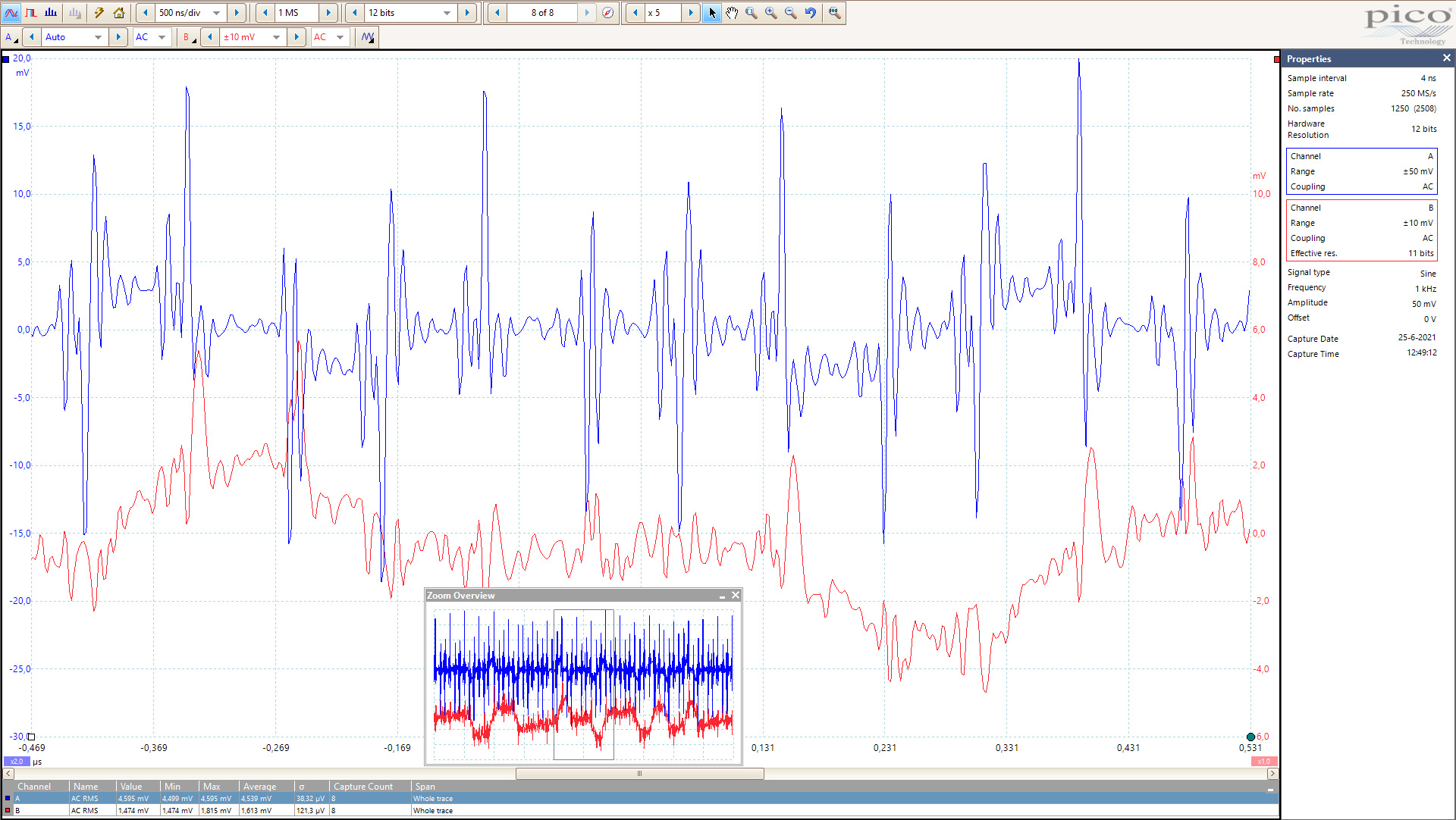

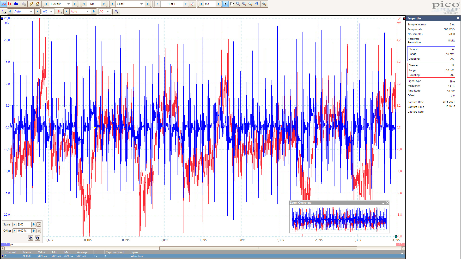

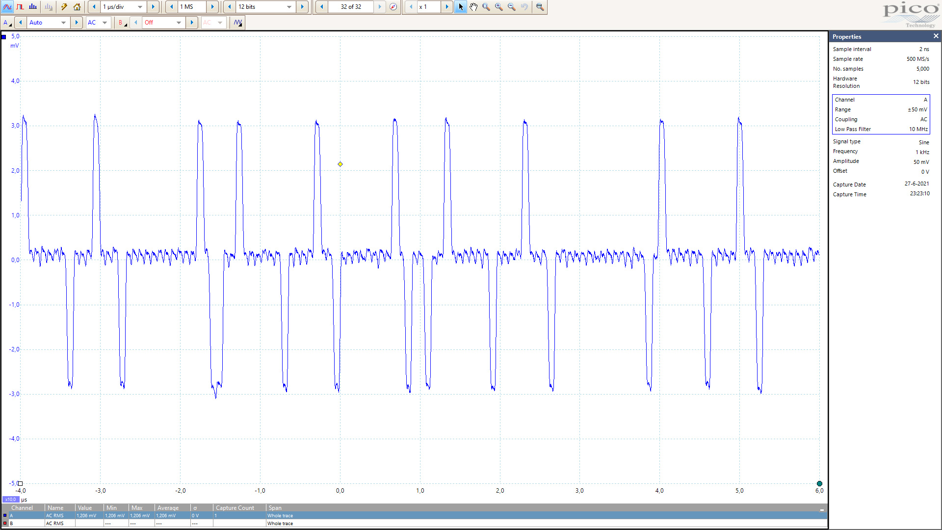

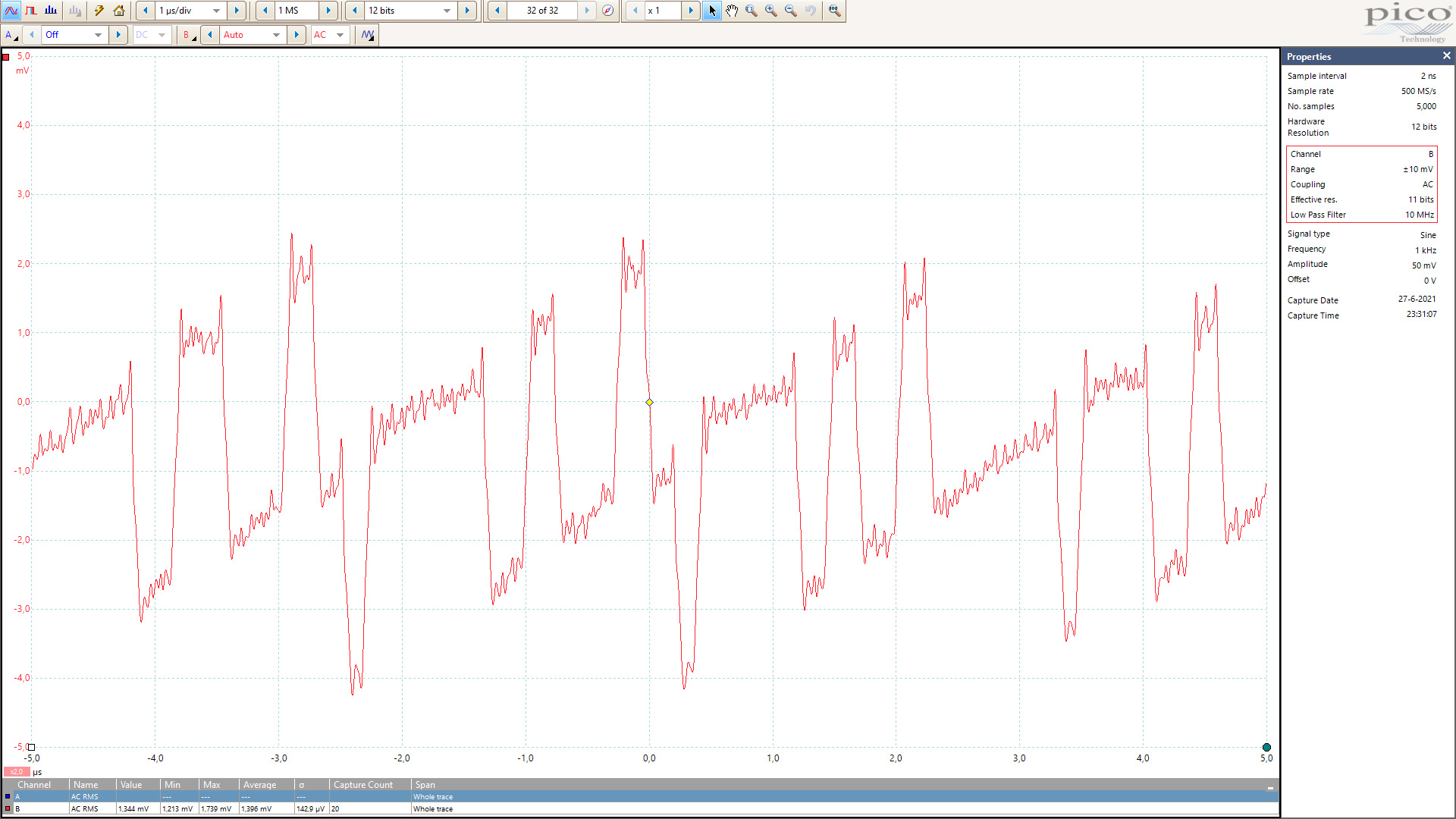

Just as some additional measurement information to what I showed earlier with both channels unfiltered, see third image, I filtered the channels @ 10Mhz, and displayed it on a 1usec/div, makes things easier to follow.
Mind the different vertical scales compared to image 3.
Unfortunately I cannot display both channels at the same time with the filters switched on, so here they are displayed in two separate images, again current output in 25R in blue and output of the LT1468 via the OPA1632 in red.
The current pulses are 82nsec wide as before, but now filtered from all the spikes around it.
The voltage output reacts on those pulses in the way as shown.

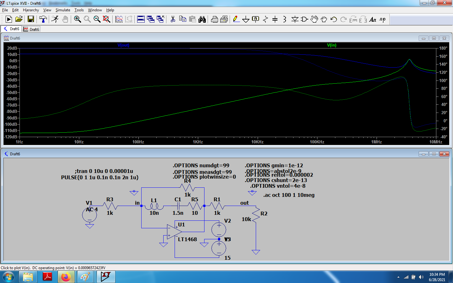

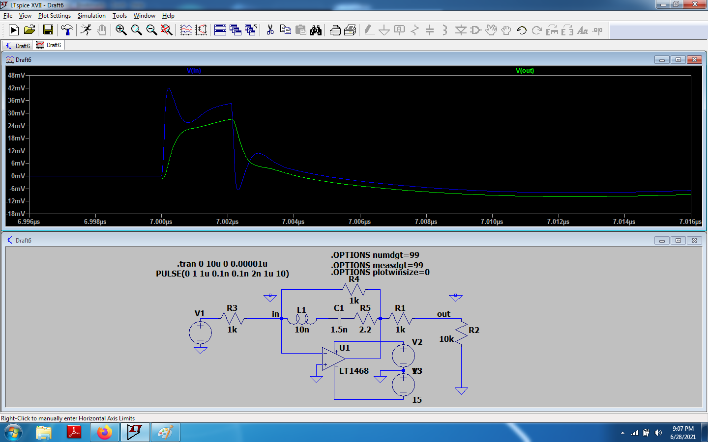

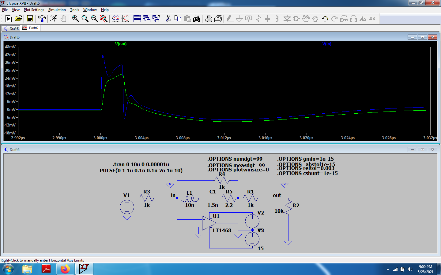

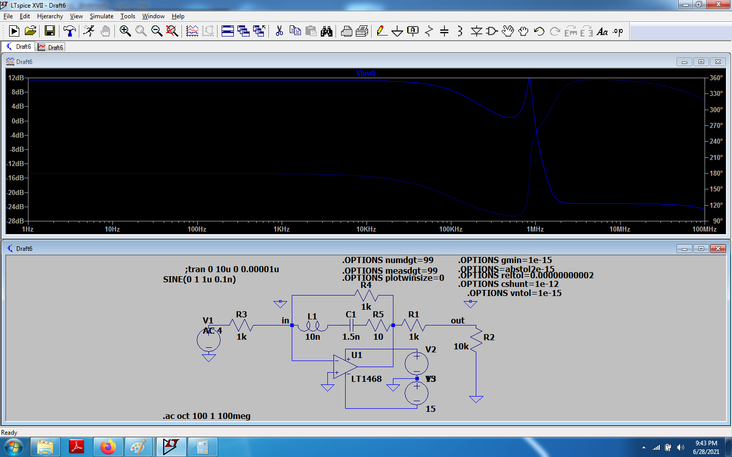

Untill you get to make peace with yourself, you can see that Hans measurements show less noise than my simulations where i tried to reduce all the reactances and inductances to your friend's standards which seem to be highly unrealistic ...

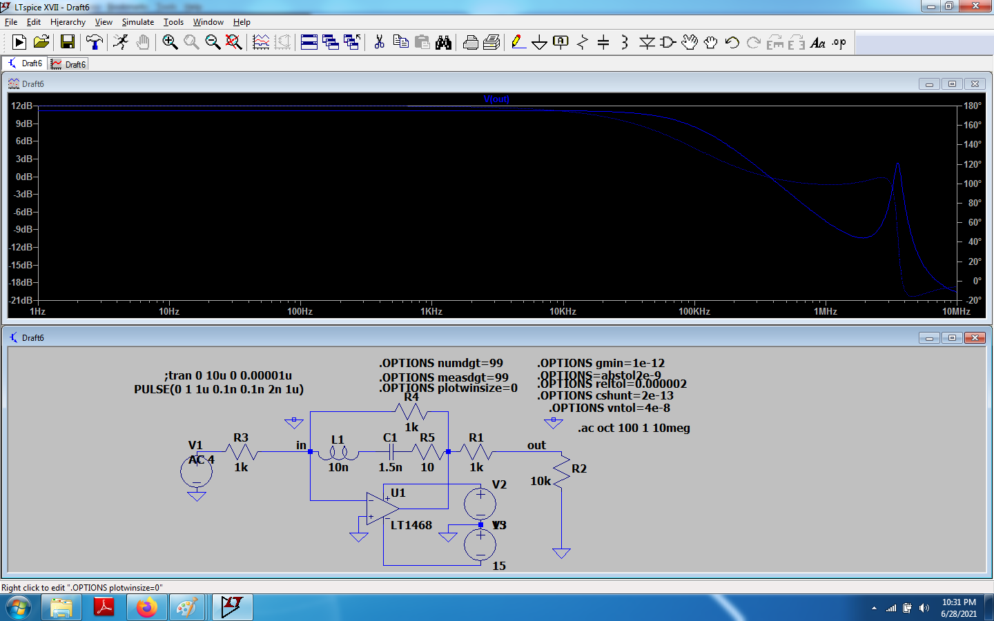

@Dreamth,
Thx for taking the trouble to simulate things.
However, unfortunately the simulations with the LT1486 do not come close to what's measured.
The other thing to mention is that the Wima FKP cap has a series inductance of ca. 10nH, much lower as what you used in your model.
Hans

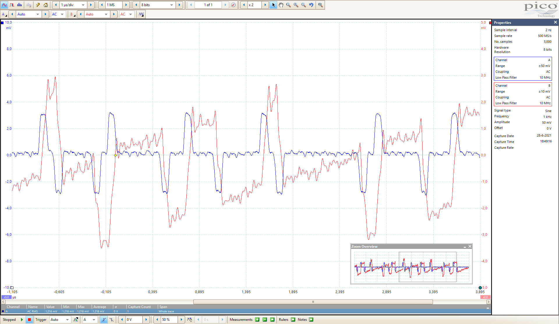

I finally managed to get the Dac output current and the I-V converter output in one image with both signals LP filtered at 10Mhz.
This makes it perfectly clear how the I-V converter reacts to current input pulses.
Hans
Care to explain? I have to admit I don't understand what you are showing here. Other than a loose correlation between the two signals (one appears to be loosely related to the derivative of the other). What is to be learned from these measurements?
Account Closed
Joined 2010

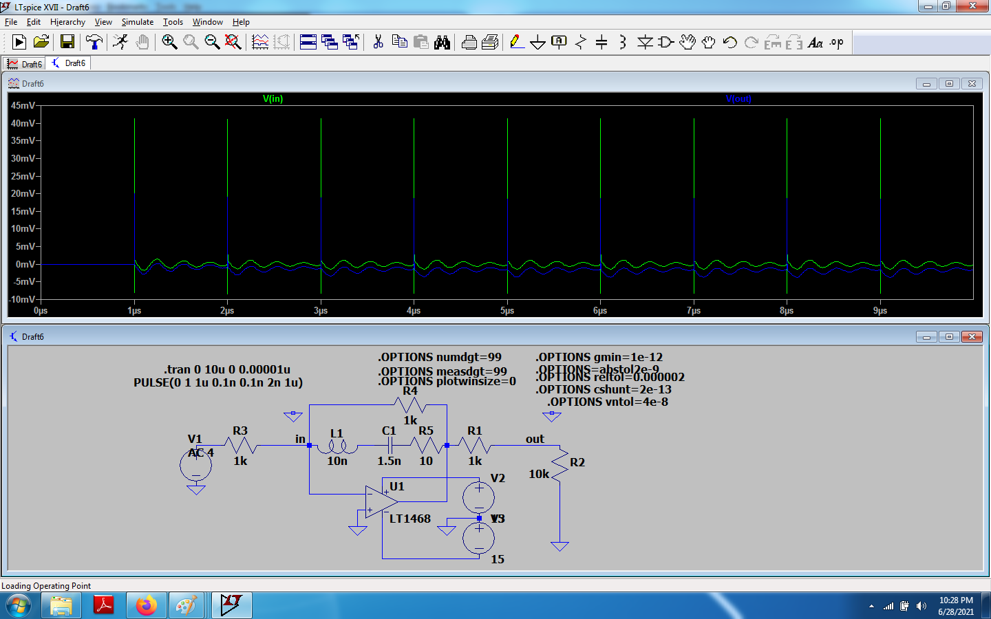

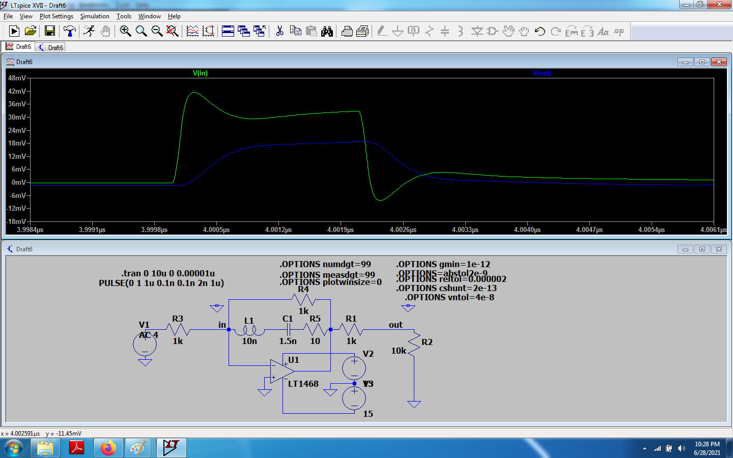

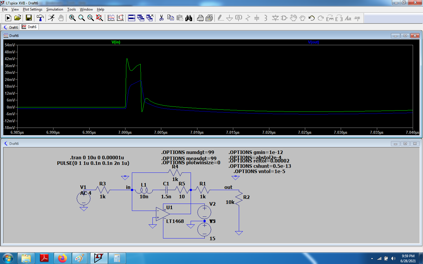

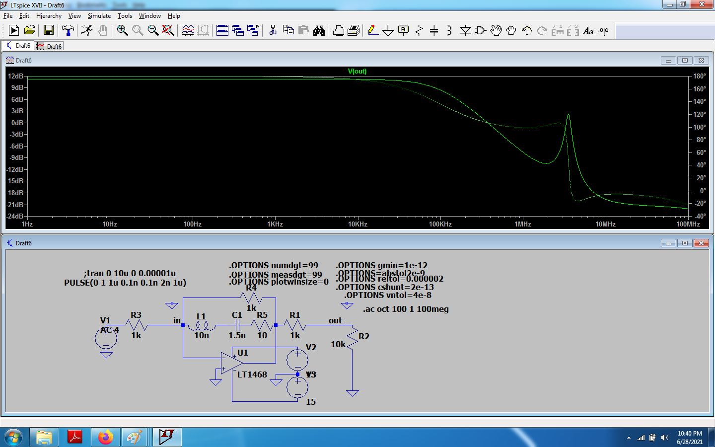

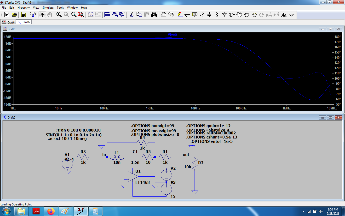

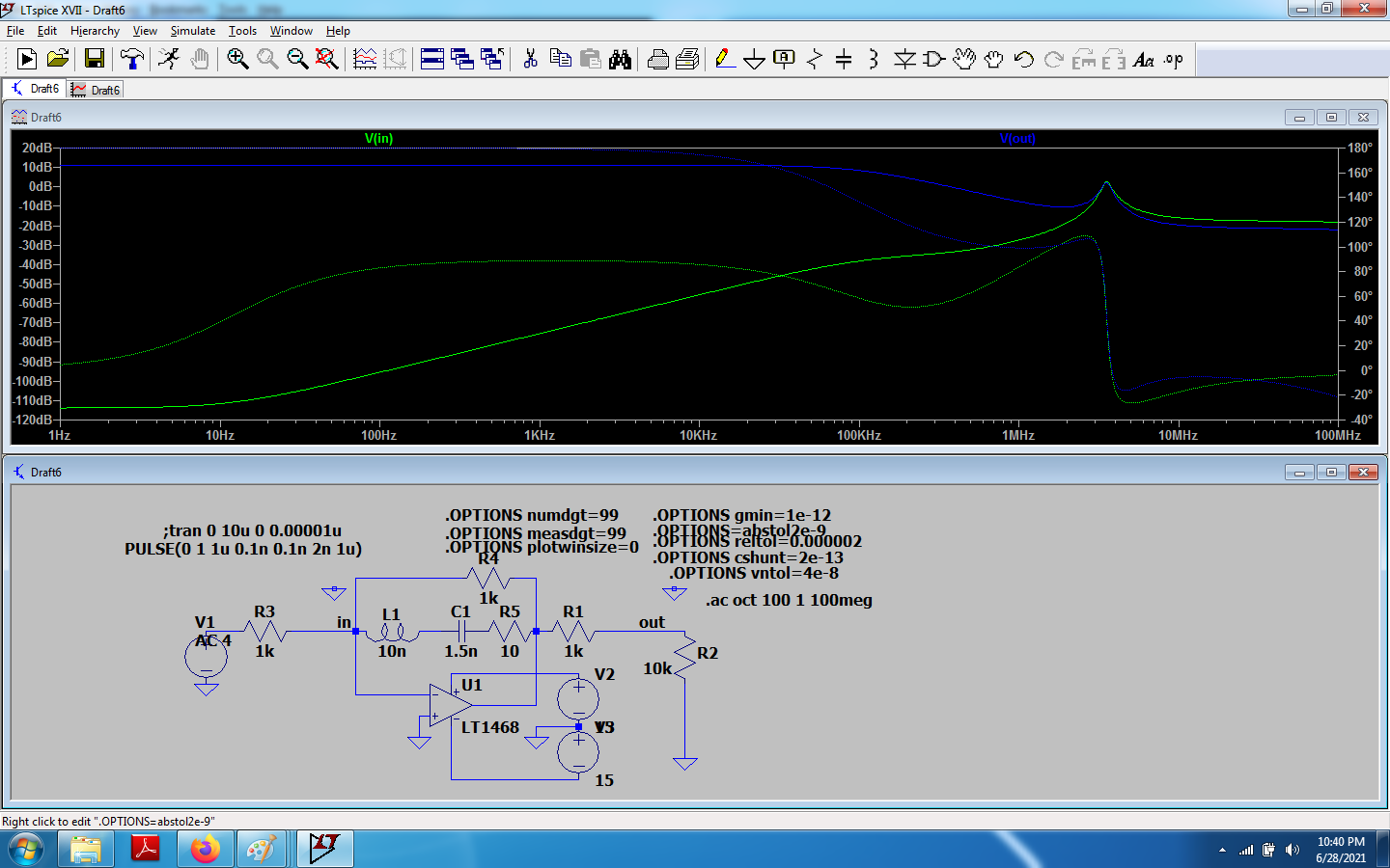

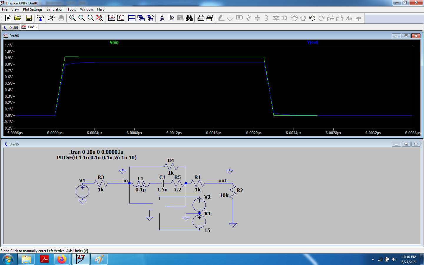

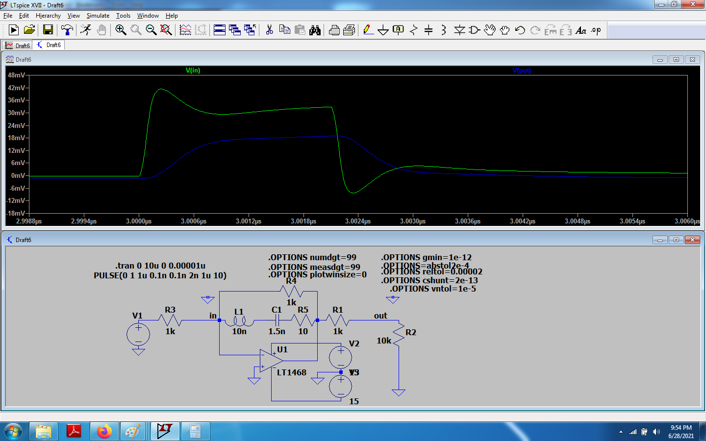

the input is a virtual ground input, the scale is 1/5 so it's still ok if measured as a voltage. i used 10nH now as Hans said...yet the reactance per wima datashheet should be about 10 ohms in total including the 2.2 ohm .It doesn't make much difference though if it's 10 ohm or 2 ohms.In Hans photo it looks like the signal area is the same on the input as on the output, but the output is on a 5 times smaller scale.In simulations I get roughly the same input and output area on the same scale, so measurements are still better than simulations if i get it right...red is the absolute input before voltage to current transformation, blue is the vrtual ground input of i/v, green the i/v output.

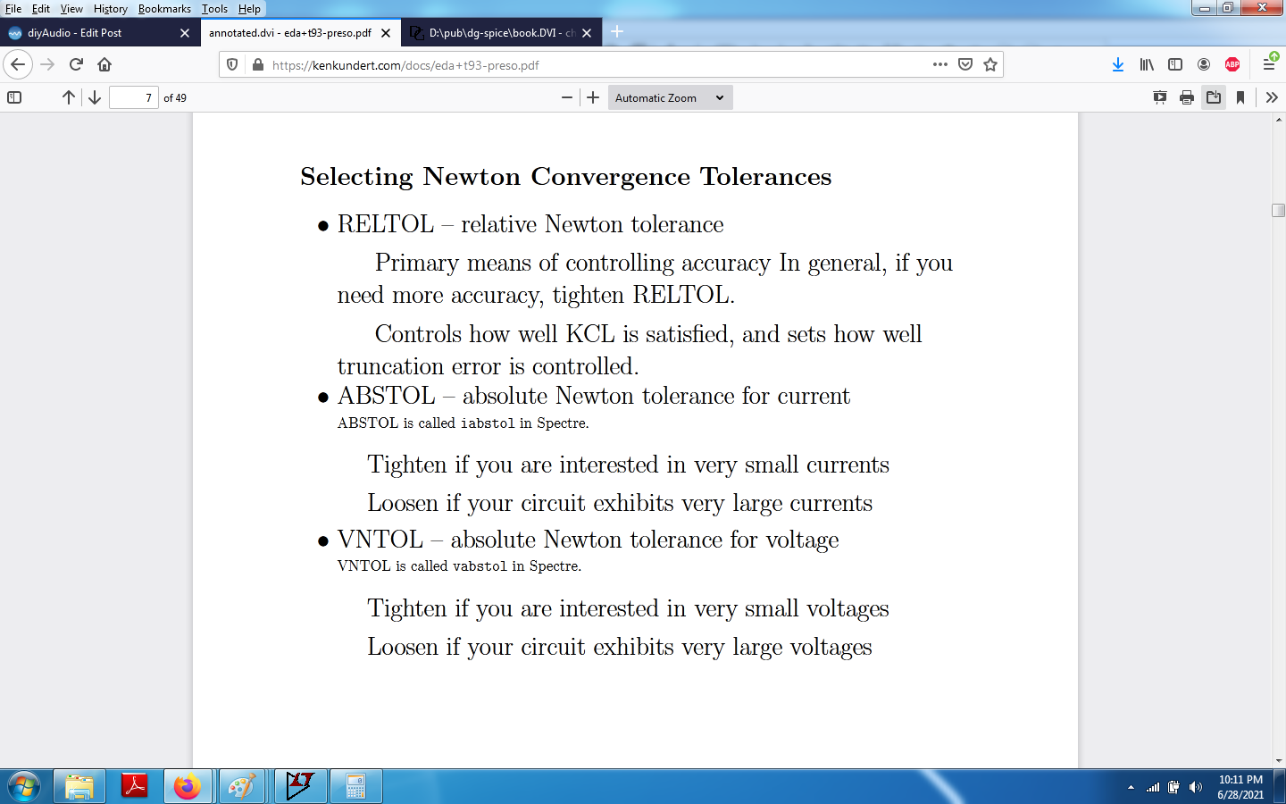

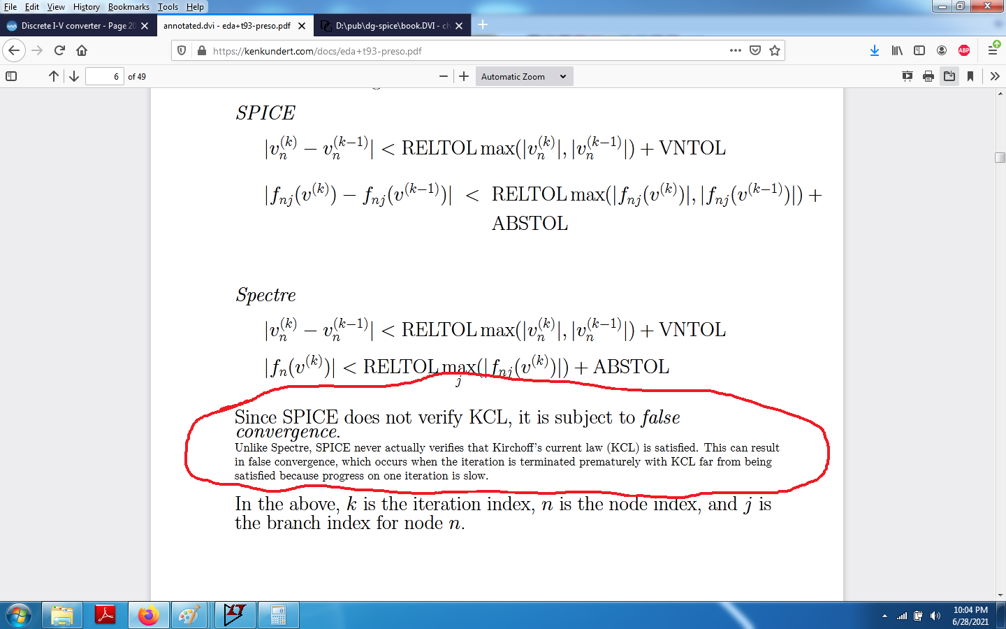

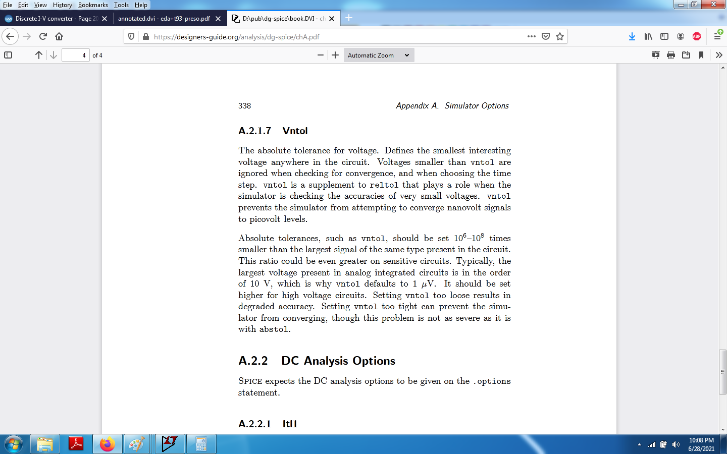

To get simillar results i need 10 pf stray capacitance everywhere which gets it peaking at 1megHz, but i'm not really confident with convergence rules manipulations to get the right result in case the model is a little bit closer to reality than expected.

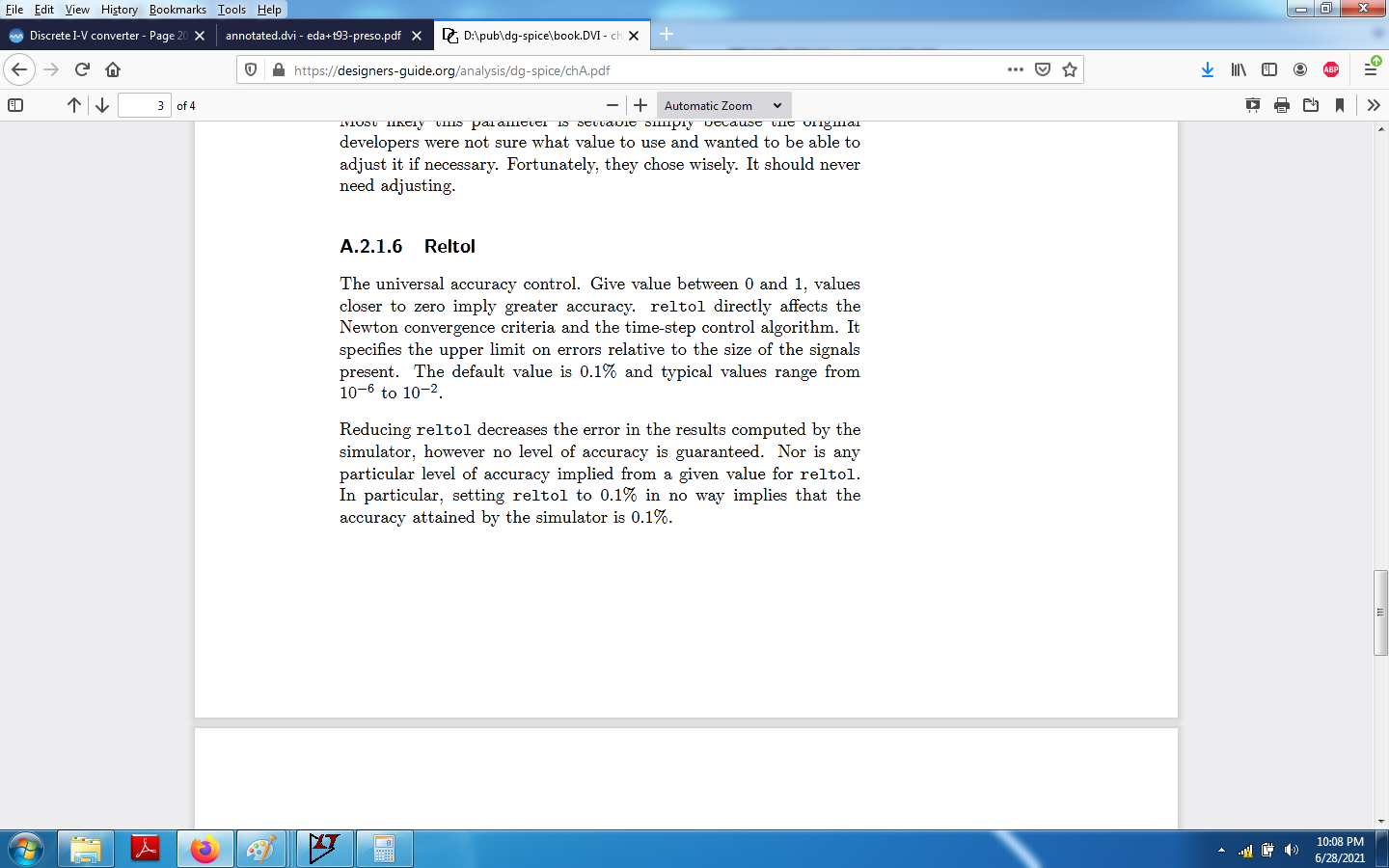

It means you can occasionally get unphysical nonsense out of simulators, and that SPICE is a bit more susceptical to that than Spectre. In particular, it may find solutions where the currents flowing into and out of a node don't add up to zero. I know from experience that it's very well possible to get crap out of Spectre as well, though.

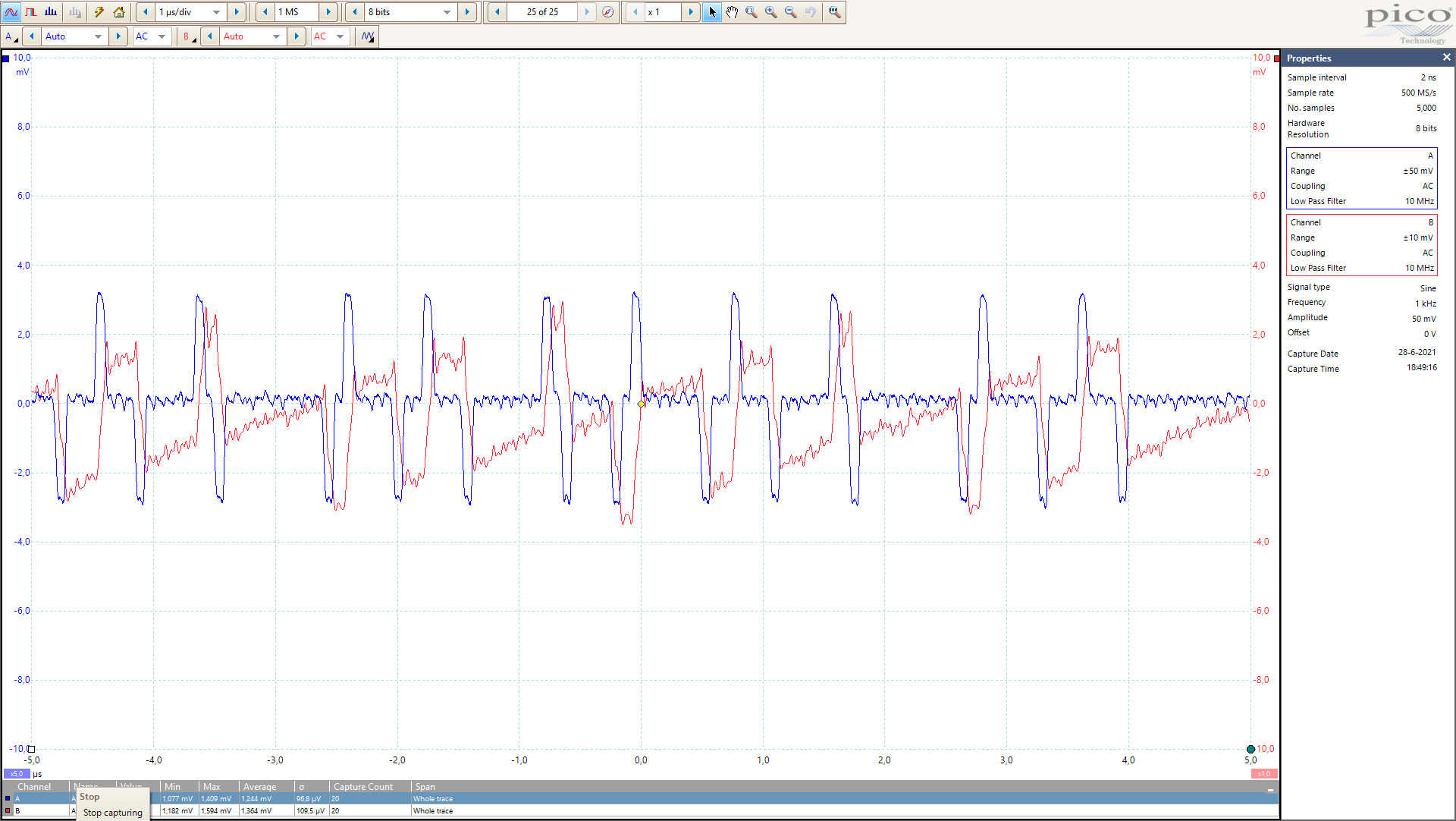

Yes of course. Three reasons for measuring at all:
1) To find out what signal is generated from the Dac
2) From this information get some insight at how the Dac is functioning
3) Getting some confidence whether a LT1468 or similar fast voltage feedback amp can handle this signal without input overload.
We have to go back to this posting how the measuring set-up looked like.
Discrete I-V converter
Already shown here was in blue the current output and the output of the V-I converter in red as measured on an upgoing square wave ramp.
Further to this, I also looked at both signals with the Dac in idling position.
Since it is rather difficult to see what's really happening with all those spikes polluting the signal, I applied a 10Mhz LP filter on both signals.
See both images below, unfiltered and filtered.
What became clear is that the Dac, although specified as 192Khz, switches it's output current 64 times as fast at 81.38 nsec intervals and that transients while switching are in the very low nano seconds.
Question 1) and 2) are answered, but 3) still open.
Hans

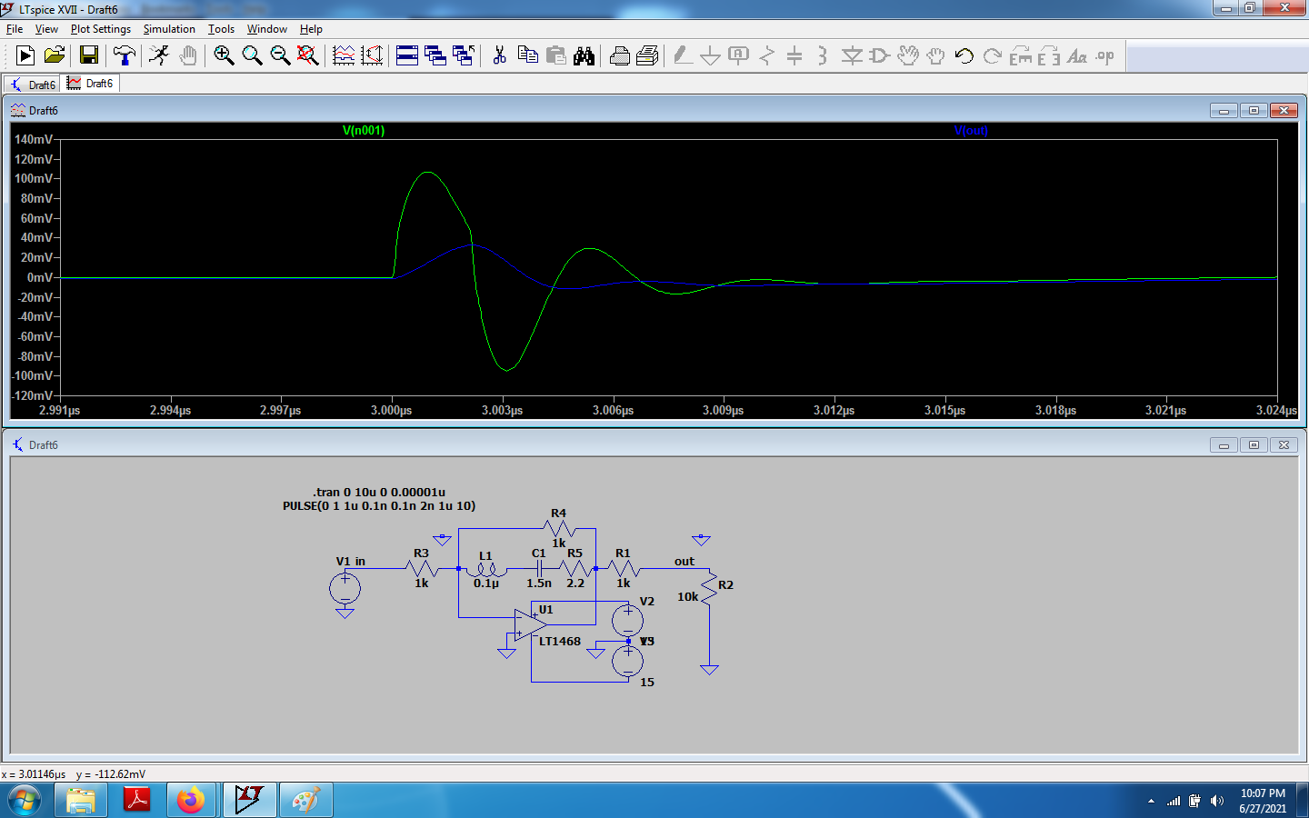

further attempts to beat the box can make you not even be able to see the ellephant in the room, but the light is off and you can only smell it...in the last picture green is the input virtual ground pin and blue is the output in sine form with 2pf stray capacitance.

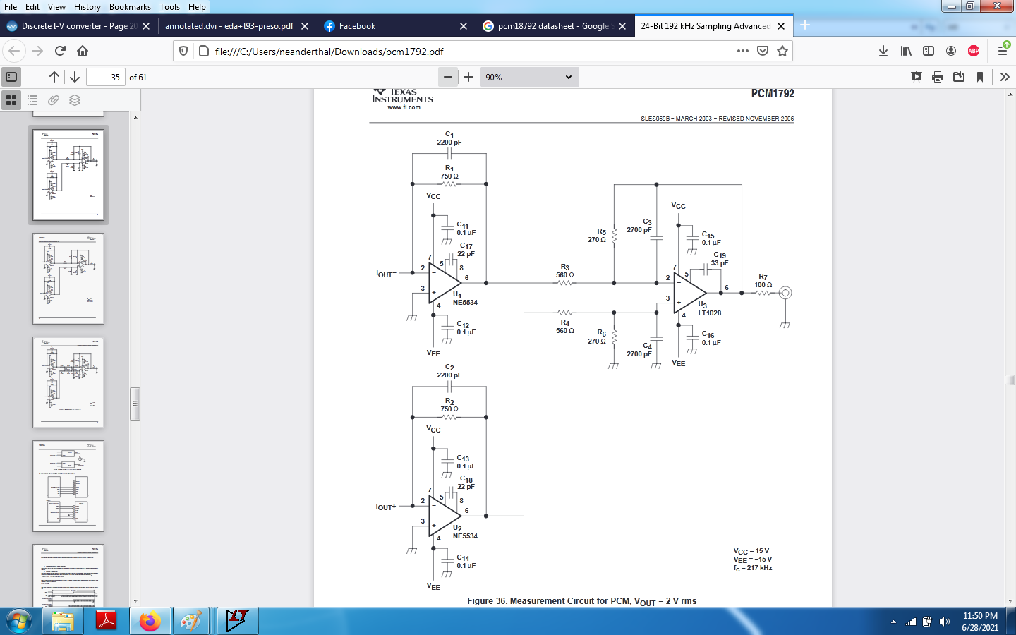

did you apply the 20khz differential LPF filter like in the pcm1792 data with their lt1028 or similar op-amp too?
Well this means that simulations aren't necesarilly as good as the component models are...that's a bit dissapointing, but maybe that is why real measurements and intuition are still the way to go for final adjustments, yet i'm not ready to discard simulations as most of them are still very close to reality.

It's in the original datasheet, page 35, 36 : https://www.ti.com/lit/ds/sles105b/sles105b.pdf?ts=1624897234700&ref_url=https%253A%252F%252Fwww.google.com%252F
I started to have some more respect for the original datasheet of components after i was made aware of Neve's RNHP sounding very well for one of the best musician's ears i know in person , the guy who finally tuned the Empyrean Meze Audio 3000 euro headphones(at least in Romania he's a well known musician), when seeing that Neve used TPA6120 and ne5534 as in the original datasheet of TPA6120 with a very small twist which wasn't detrimental to the bare idea depicted in the datasheet while most of diy community is always leaning towards the best op-amps on the market thinking that Rupert Neve must be just an old guy...

So this is the idle output current and the idle output voltage after the I/V.
What DAC is this? What you see at 82nS could be an oversampling effect, although x64 would be unusual, x128 would be more common (24.576MHz). Are you sure there is no parasitic coupling with the MCLK? Those pulses look like a differentiated clock signal...
