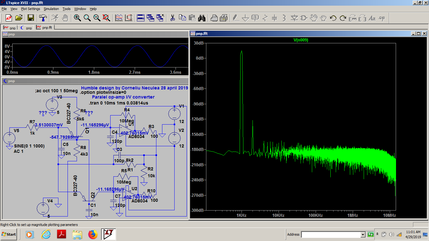

Well this means that simulations aren't necesarilly as good as the component models are...that's a bit dissapointing, but maybe that is why real measurements and intuition are still the way to go for final adjustments, yet i'm not ready to discard simulations as most of them are still very close to reality.
When a simulator finds an unphysical solution that doesn't even get close to meeting Kirchhoff's current law, you usually get such complete nonsense out that you see immediately that there's something wrong. It just may take a while to figure out it's not the circuit but the simulator that's at fault.
@MarcelvdG
I'm just trying to learn some more about simulators when i get the time and occasion.I still find them fantastically useful.A friend of mine tried to improve the SNR of an old germanium based phono preamp a month ago, asked me for a sim and i had to sim it with silicon cause i didn't have any germanium model. When replacing the first two transistors in the circuit that had a gain with silicon , i found that changing the original emiter resistors from 4k7 and 3k3 to 3k3 and 3k , the cliping behavior improved by 1v on the upper half of the rail and although i wasn't sure it would work in his circuit because he was going to change only the first trz with silicon, leaving the other two germanium ones in place, the guy made me really happy when he said that the simulation results improved both noise and clipping behavior in such a clear way that the 3 transistor phono preamp was as clean and neutral as it could possibly be a phono preamp.
I still couldn't prove in a simulator that phono preamps with bipolar transistor inputs are usually imune to input saturation due to dust, but i and this friend found it true in about 5 different phono preamps of the 70's that exhibit cleaner sound than more modern j-fet ones we own and tried.You know my views on that subject anyway...There's only one j-fet preamp i was told it doesn't exhibit any input saturation or clipping, but that's out of reach for my poibilities both to buy or build.
If you should want to tweak parameters until you have something that behaves as a germanium transistor: germanium has a much lower bandgap voltage EG than silicon, about 0.6 V instead of about 1.1 V if I remember well, and the junction saturation current IS is much higher (like 1000 000 times or so). I guess ISE and ISC are also higher.
Interesting! Never thought of trying fabricating a tranistor model.I'm not sure i'm that good to be honest.

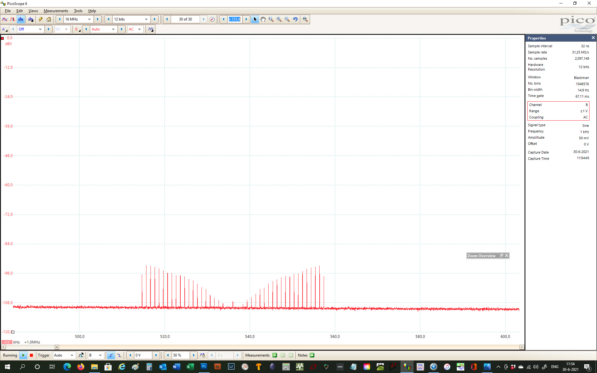

One interesting piece of information I still wanted to share is in the image below.
Already shown in previous images is the fact that the PCM1792 updates the analog output at intervals of 1/(64*192Khz) = 81.38nsec.
In my Bel Canto Dac, all incoming signal is up-sampled to 192Khz.
However when offering the Dac a 44.1/16 multitone test, the first image pair is not found around 192Khz but at 1.536Mhz or 8 times as high.
The second and third image pairs are found at multiples of 1.536Mhz.
I wonder what this means when the PCM1792 is instructed to go in NOS mode.
I suspect that the image pairs are not at multiples of Fs.
If so, can this still be regarded as a NOS Dac in the usual meaning ?
Anyhow, this Dac is a complex machine.
Hans

See figure 7 and pages 15 and 19 of https://www.ti.com/lit/ds/symlink/pcm1792a.pdf Apparently the PCM1792A has an internal eight times oversampling filter that can be bypassed. The sigma-delta modulators run at a higher clock frequency than the output sample rate of the digital filter, as corresponds with your measurements.
It's never really NOS because the sigma-delta necessarily runs at a much higher frequency than the incoming sample rate, but by bypassing the digital filter, you can get staircase-like waveforms out of it, with lots of ultrasonic quantization noise on top of it because of the sigma-delta modulation.

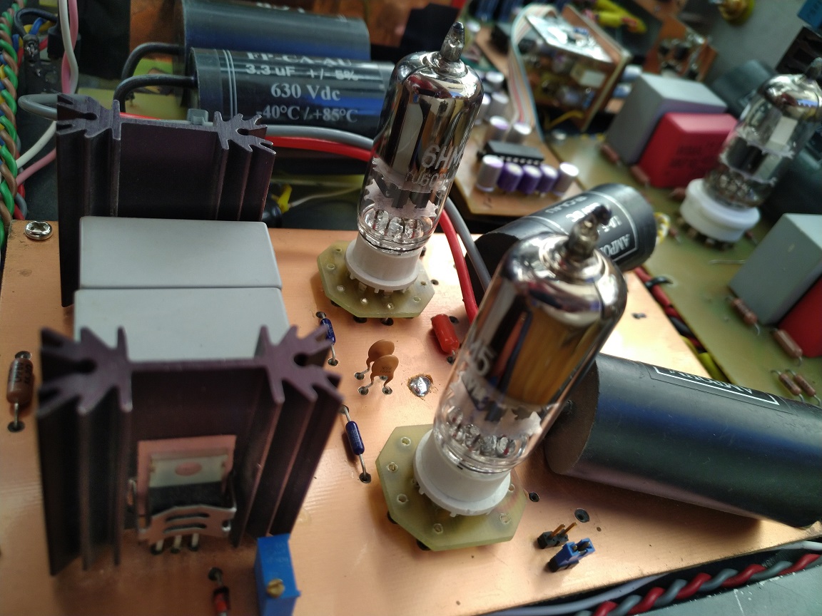

To go a little in the opposite direction, the picture shows my I / V stage and output buffer. 6HM5 is in the grounded grid. The signal ie current from PCM1702 comes to the cathode of the tube.
A long time ago I left discrete and op amp I / V conversion and I replaced it with tubes. I tried everything, even the AD811, but the sound of the tube was much better for me.
However now I am working on a new DAC with TDA1547 where I will have to use discrete or op amp I / V conversion if I intend to use only current outputs, I also have two PCM1794 on hold which in mono mode does not have a suitable tube that could do I / V conversion in a grounded conection.
So I'll go back to discrete or op amp I / V conversion again.
