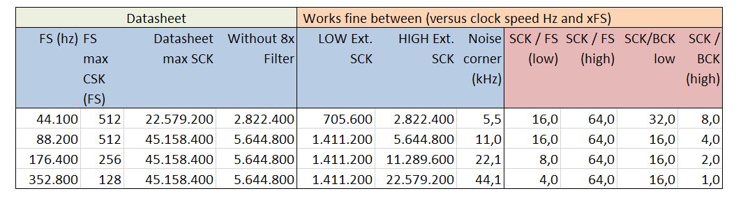

I measured this some time ago with "no digital filter" mode and I2S input running at several FS frequencies and matched an external clock signal to SCK pin till the sound was actually ok (can be done for testing, works fine - not for listening as it drifts away at some point and starts clicking)
below is the result - it was kind of interesting to see that the DAC chip / modulator also works when the SCK system clock is BELOW the bit clock BCK 😱
also there is a maximum. after that the modulator is not working for that FS. Actually this the BCK...
Of course the corner of the noise curve (flat below going up after that) is clearly in the audio band when playing
I only did this to get a better understanding of the internal working of the PCM chip

in no digital filter mode you can go higher as long as you keep BCK=SCK
I play without any problems up to 384kHz tracks. see also my post below

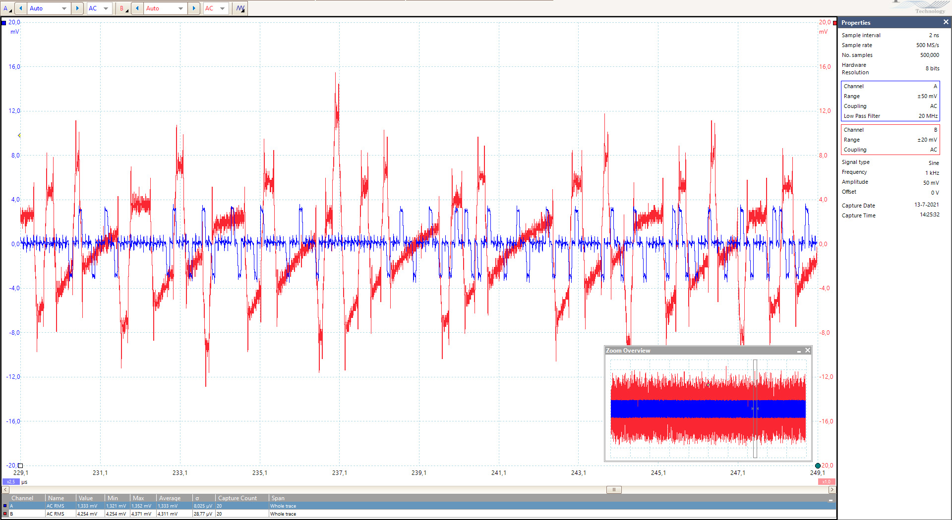

Here is the effect of using 0.1% resistors and 1% caps on all the critical places.
In blue the signal on the 25R resistor attached to Iout+ of the L channel and in red the SE output of the R channel after I/V conversion with LT1468 and 1K//1nF feedback, both I/V sides turned into a SE signal with a OPA1632.
Difference in gain between L and R is 1K/25=40.
While the signals are not synchronised because not from the same channel, the 81.38nsec slots from the Dac are well visible, in this case filtered at 30Mhz to remove the 2nsec transients for better visibility.
And the non filtered response at the SE output shows that only some peaking is visible when the output value has to change , but the 2nsec transients every 81.38nsec are effectively suppressed by the CMRR of the OPA1632 and the well matched I/V converters.
Hans
