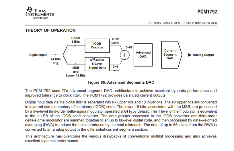

Interesting Hans, this equals to 12,288 MHz- like masterclock for 48kHz FS. did you measure this value of 81 ns playing indeed 48kHz track. Did it change when playing other FS tracks ?
No, the 81.38 nsec did never change in my case, but this has everything to do with the fact that my Bel Canto Dac is programmed to convert all incoming content to 192Khz.
Hans
Hans
Ok got it. If FS =192 then bck is 12,288 MHz. So is bck causing this then ?
System clock offered to my PCM1792 is 24.576 Mhz.
The sigma delta modulator is working at halve this frequency which has no direct relation with the bck.
Hans

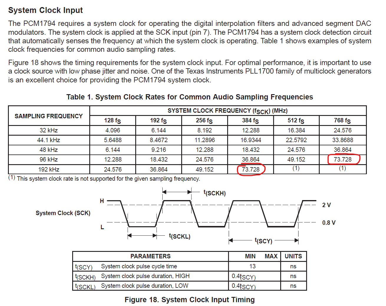

In order for an operational amplifier to filter out one frequency, its FT must be at least 10 times greater in order to have at least 10 times Ku at this frequency.
Sandy,
I don’t get what you want to say with the shown table, but my system clock is with 128Fs at 24.576 Mhz, the SDM outputs it’s current at halve this frequency and the LT1468 that I use has a BW 8 times as high.
Could you still answer my question how and where the recording was made with the 2nsec 1mA current output pulses that you showed.
Hans

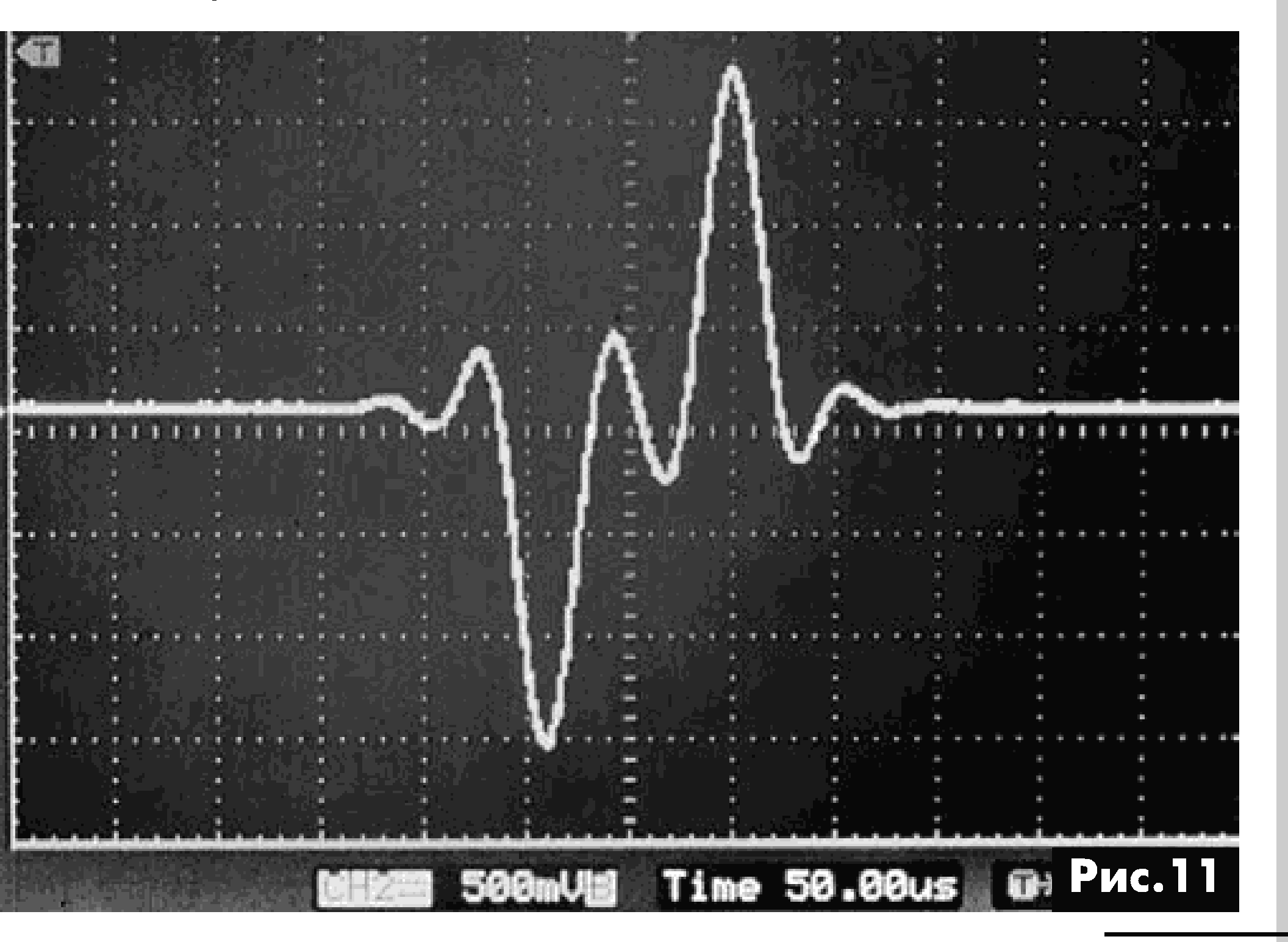

I have translated the document from Valery Sergeev.
1) He is using the same definition as Petr_2009 that all graphical change in waveform is called distortion.
Pre and post ringing makes the shape of a dirac pulse different, but it is caused by removing the supersonics by sinc filtering and has nothing to do with distortion in the electronic sense.
A perfect linear filtering process does not cause distortion as is defined in Audio.
2) He compares a multibit 1704 NOS Dac with a 1794 SDM Dac in NOS setting that does however up-sample to 8Fs for the highest 6 bits and SDM for the lower bits at 64Fs, resulting in incomparable results that cannot be used to prove the superiority of a R-2R Dac the way he tried.
3) to produce image 16 & 17 he must have had access to a professional 4Gs/sec scope, but his measurement set-up and the tools he used are not mentioned.
Out of the blue he mentions that
4) "It must be assumed that any asynchronous resampling to a higher frequency will significantly distort the waveform.
5) "Multibit PCM1704 is the only commercially available honest audio Dac."
6) "We can safely recommend the PCM1794 with the exception for Ultra Hi-Fi"
Hans

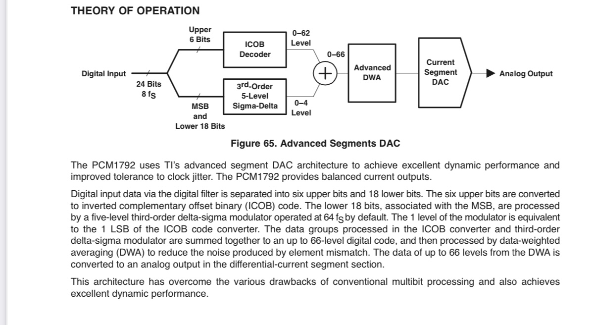

I can be more concrete after having examined the PCM179X in greater detail.
The 81.38nsec was based on the following:
Up-sampling in my case was to Fs=192Khz.
From thereon the signal is further up-sampled to 8Fs and fed to a 6 bit Dac, converting these 6 MSB's.
The lower bits are going into a 5 level SDM operating at 64Fs and added to the upper 6 bit results.
Output in that case is at every 1/(192KHz*64)= 81.38nsec.
Now take a setting without using the up-sample filter, like as a sort of NOS Dac.
Output is now every 1/(44.1Khz*64)=0.35usec.
See second image below how two dirac pulses with opposite polarity and one period rest in between are processed by the PCM179X Dac.
This image was produced by Valery Sergeev.
Note that the staircase steps that you see are not caused by the Dac, but by the 8 bit scope resolution.
First image pair in this setting will now be at 8Fs or 352.8Khz instead of 44.1Khz for a Multibit NOS Dac. So from 22.05KHz to 330.75Khz there is no content assuming adequate suppression by the 8Fs up-sampler.
It also shows that circumventing the internal up-sample filter, does not really turn the PCM179X into a NOS Dac, because the 8Fs upsampler stays always in action.
