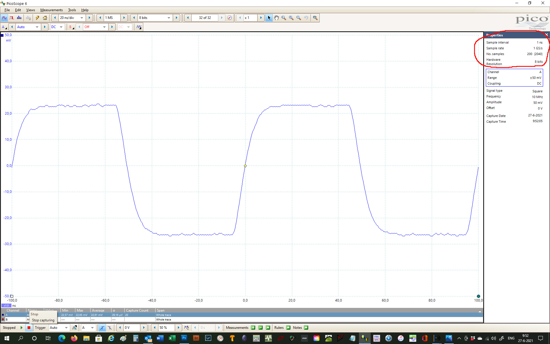

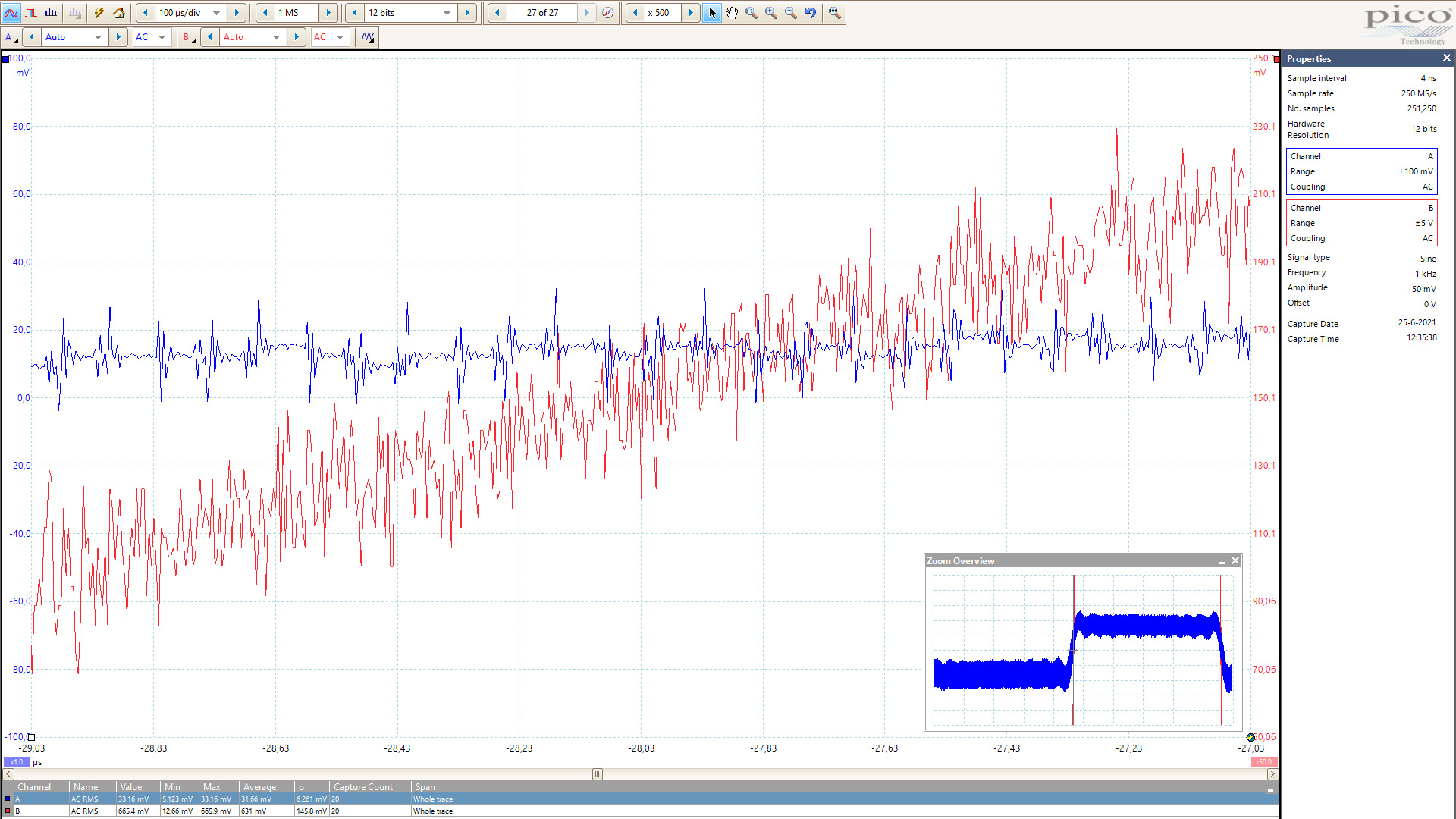

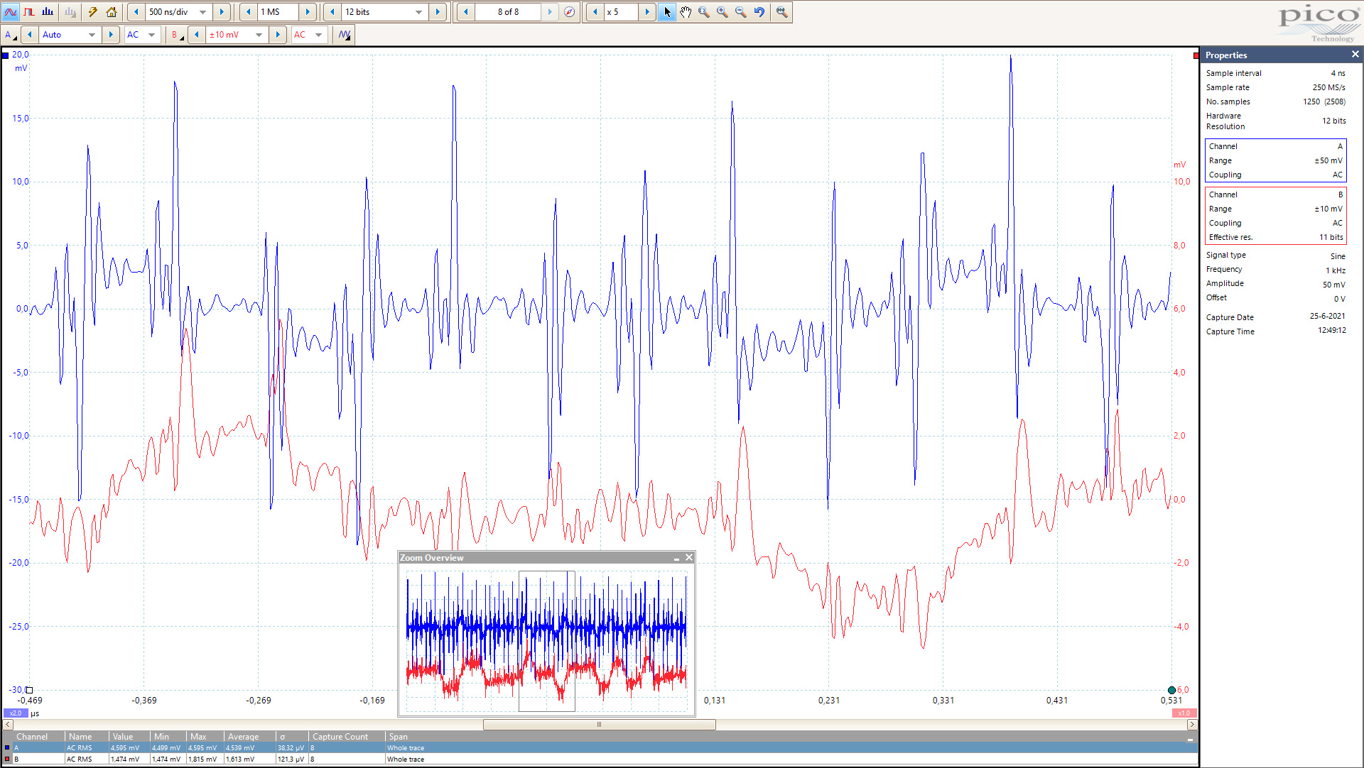

It’s a 5244, 200Mhz, 1.75 nsec risetime, 1Gs/sec 8bits and 0.5Gs/sec 12 bits scope.
I saw no differences in the amplitude or pulse width of the ca 20mV pulses 82nsec apart when sampling at 1Gs/sec@8bits or 0.5Gb/sec@12bits.
I also offered a square wave with a 10nsec risetime wave to check the scopes behaviour. This looked absolutely pristine using the same coax and 50R terminator, no overshoot and no artefacts at this same high sampling rate.

To support my previous posting, here are the recordings of a square wave with a rise time of 9nsec, recorded over the same coax cable and 50R feed-through terminator at resp 1Gs/sec @ 8Bits and 0.5Gs/sec @ 12 bits.
As mentioned, no anomalies and a pristine waveform IMO.
Triggering cannot be much of a problem since my scope stores N recordings with or without triggering, enabling to inspect the frozen recording in all peace.

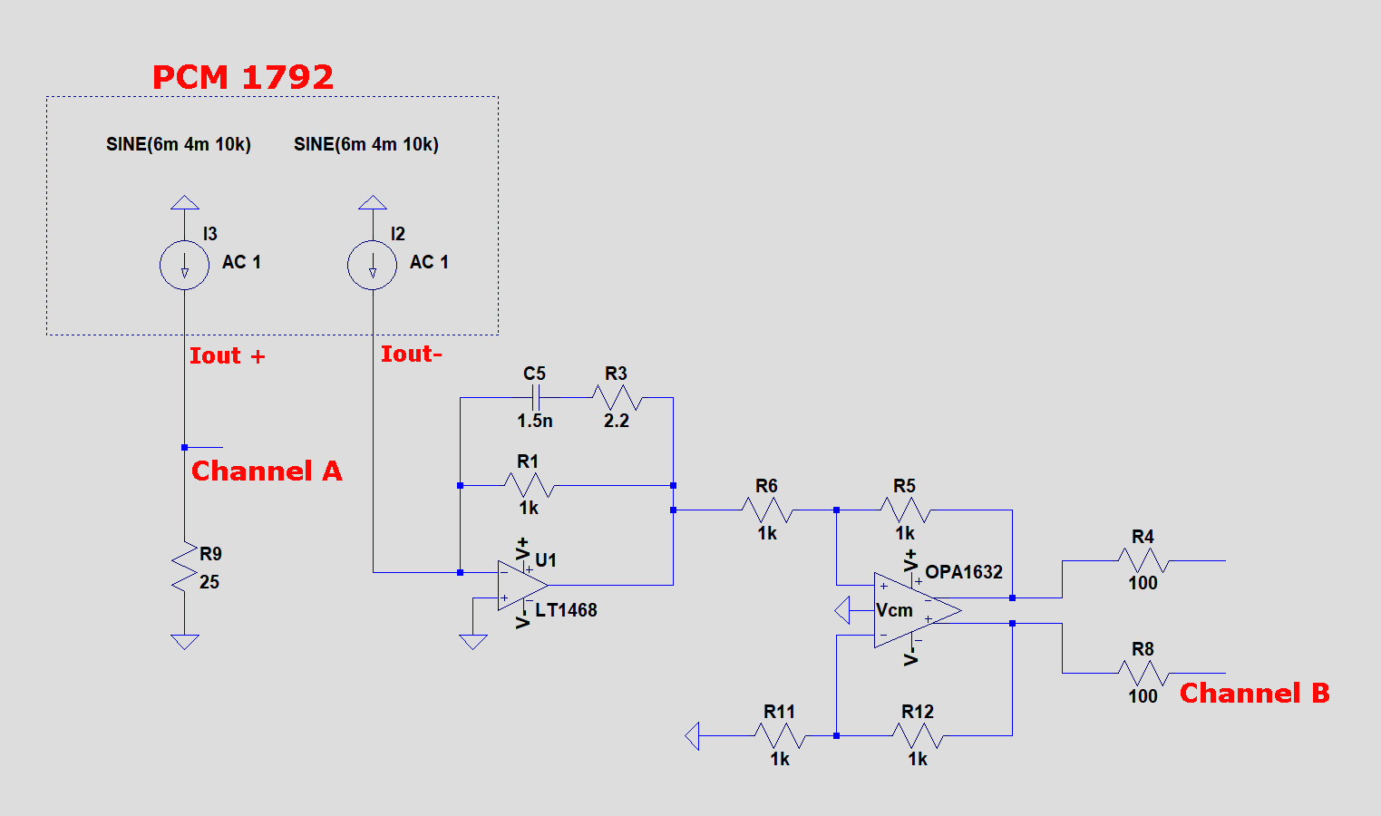

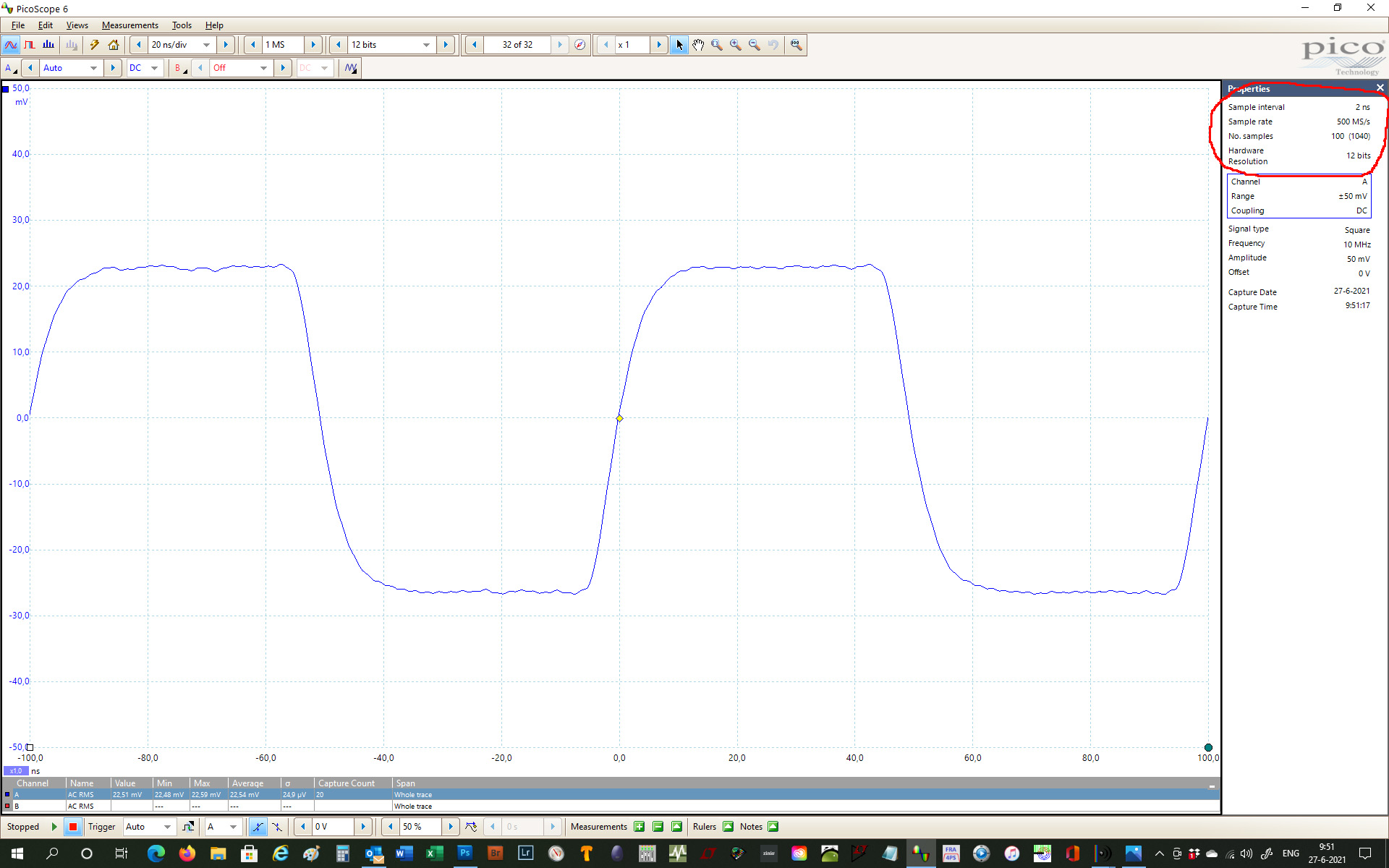

But maybe even more important, the main reason for this exercise was to find out whether the input of a LT1468 voltage feedback amp can get overloaded by those 1mA@2nsec transients from the Dac ?
When looking at the upgoing ramp of a -12dBFs square wave, where successive steps are almost the largest possible ones in audio, wouldn't it lead to something like a "dead" time where the voltage amp has to recover ?
But when looking at the recordings on a 200nsec/div & 20mV/div scale, no such effect is visible, see third image with in blue the voltage from the Dac over 25R and in red the voltage output from the voltage feedback amp, see image nr. 4.
Could the conclusion be drawn in that case that no such amp overload is taking place ?

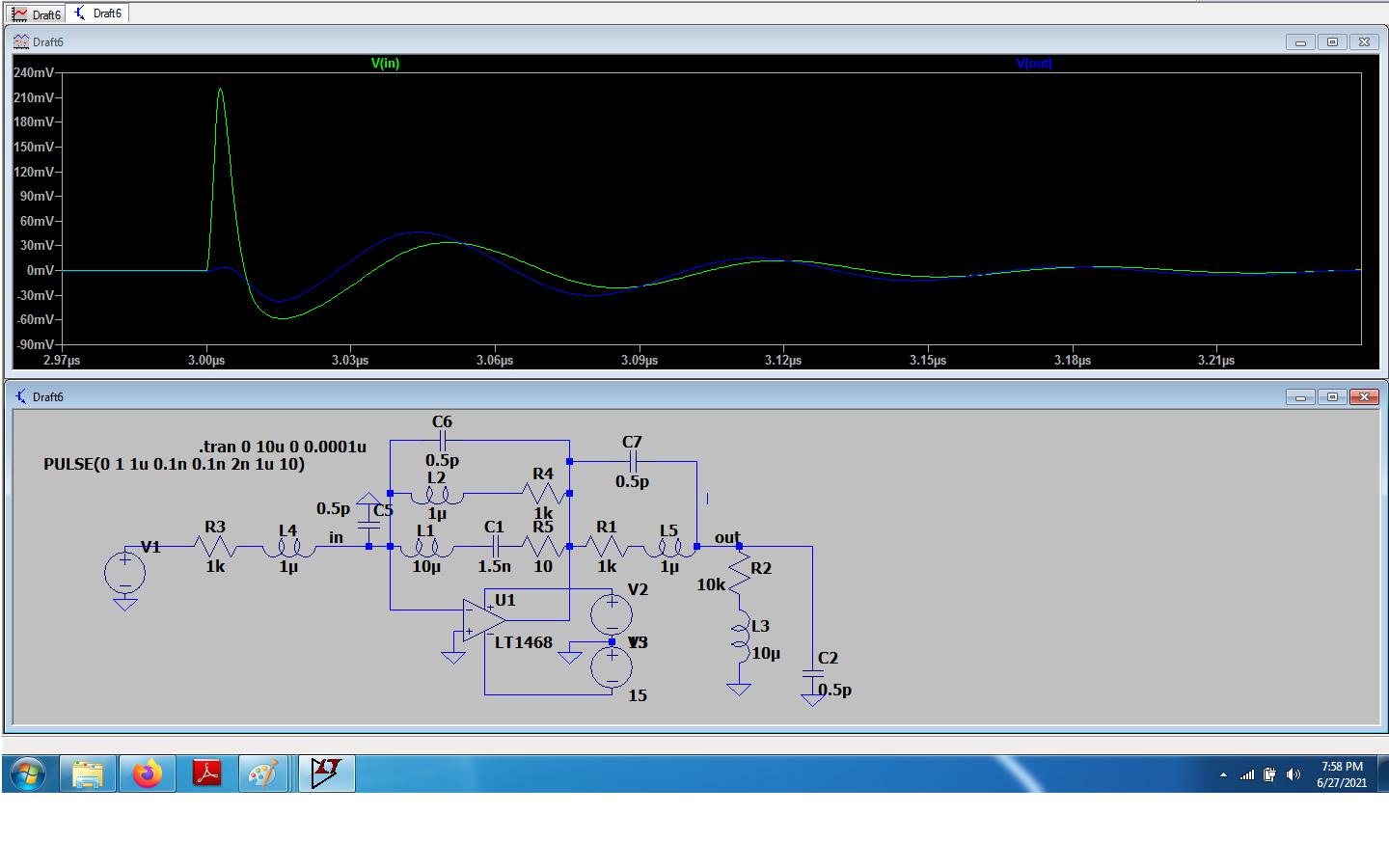

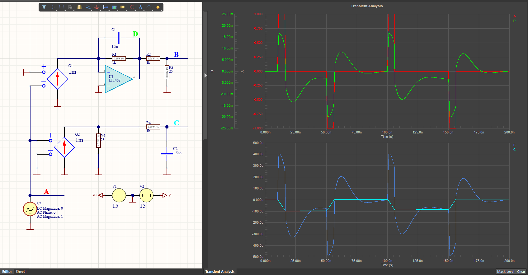

It's in the grey area, isn't it? The op-amp has a bipolar differential pair input stage, so any error signal >> 2 kT/q ~= 52 mV will drive it into slew rate limiting, any error signal << 2 kT/q will be handled more or less linearly and your 25 mV..40 mV error signal peaks are somewhere in between.
Yes, the circuity diagram is the grey area, image 4 if that is what you are pointing to.
But, we only can see in image 3 that the Dac produces peaks of +/-15 mV at that point, translating into +/-0.6mA, so let's say peaks can be +/- 1mA to stay of the safe side.
What is unknown is the LT1468's Zin, so no idea how this translates into an input voltage and LTSpice is not of any help in this case.
With Zin=2R for these spikes, it would still result in less then the 52mV that you mention, but who knows ?
Putting a probe at the amp's input will probably result in very unreliable results,
so the only thing I could think of was looking if any recovery time from overload was visible at the output, but I don't see that.

Right, I thought the blue trace of picture 3 showed the error voltage, but it's the voltage across 25 ohm.
The graph at the bottom right of page 7 of the datasheet shows that the output impedance with full feedback varies from 10 ohm at 8 MHz to about 40 ohm above 40 MHz, see https://www.analog.com/media/en/technical-documentation/data-sheets/1468fb.pdf , so the order of magnitude of the peaks should be the same.
Actually that's a bit of a circular reasoning, because the output impedance only applies under small-signal conditions and the question was whether the signal is small...

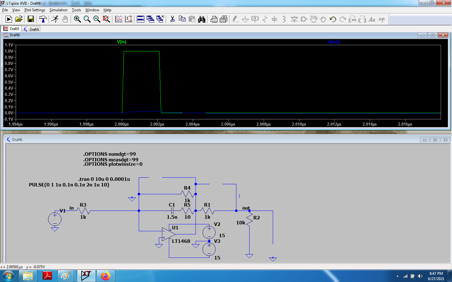

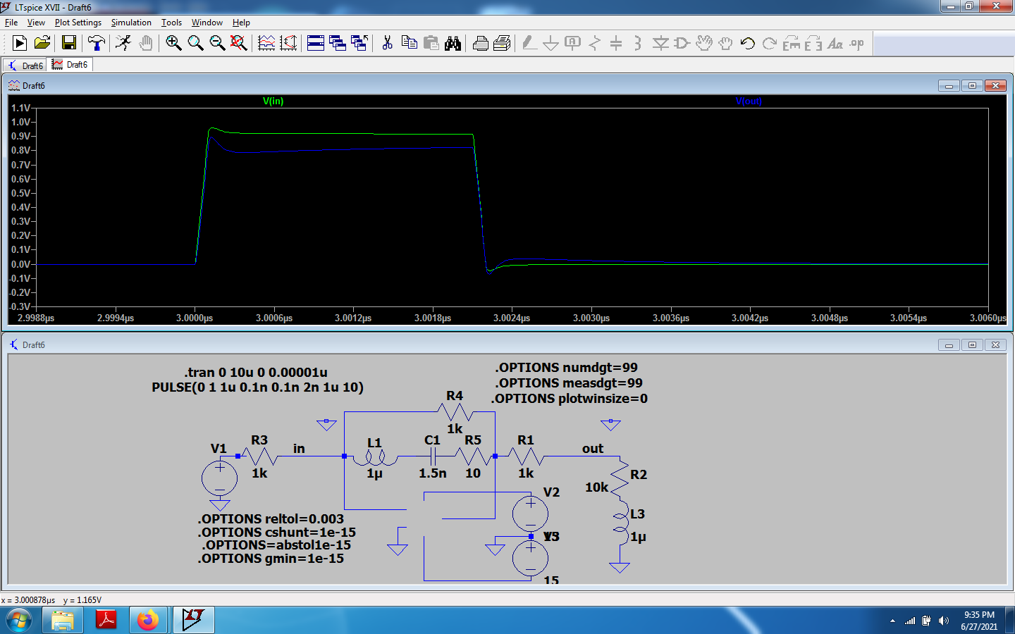

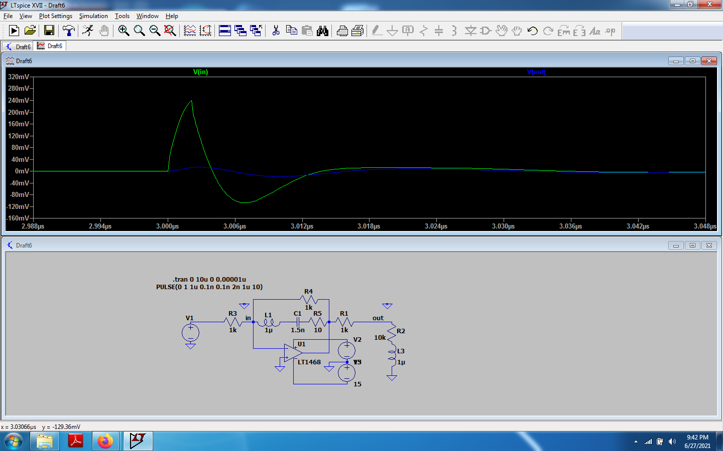

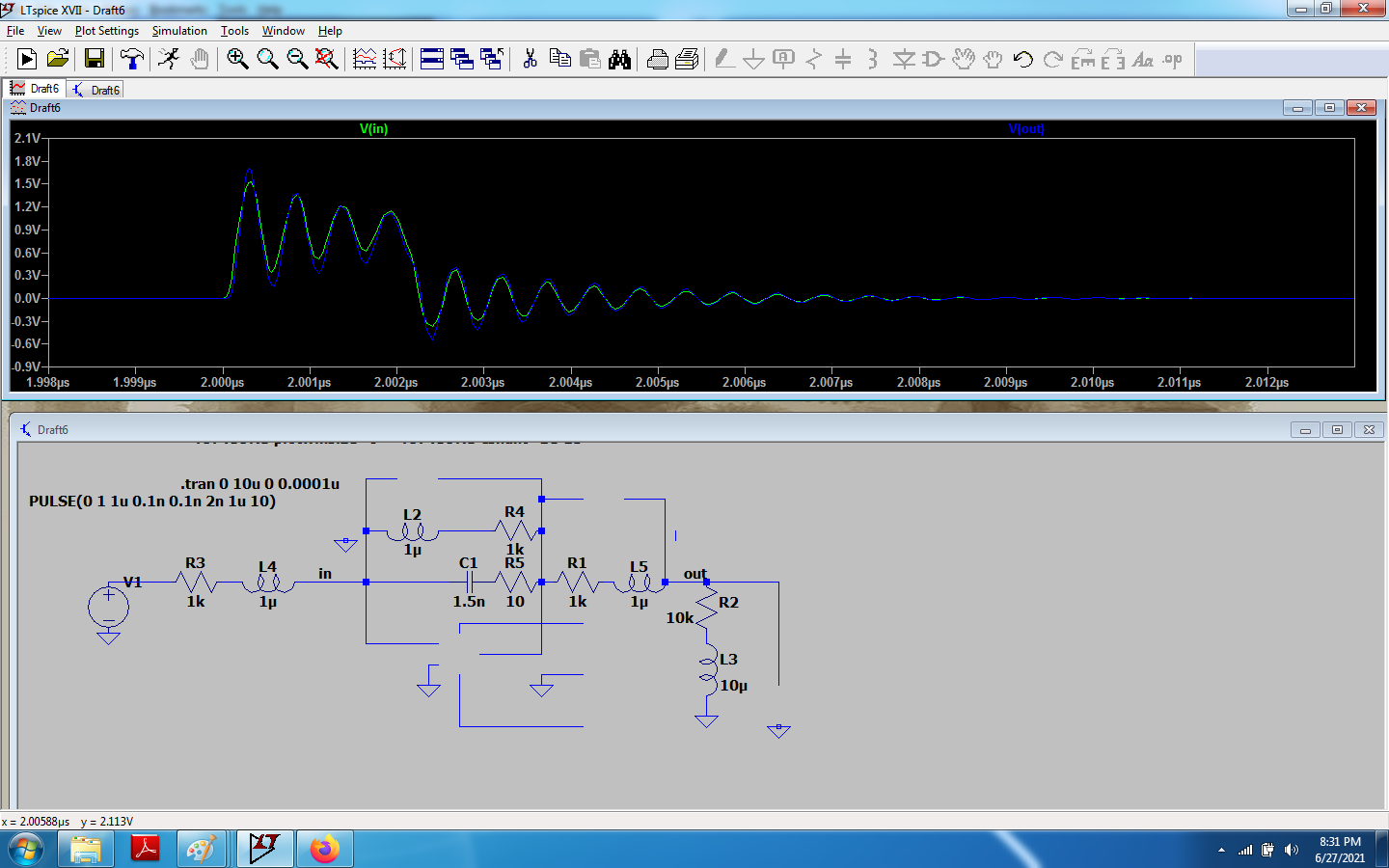

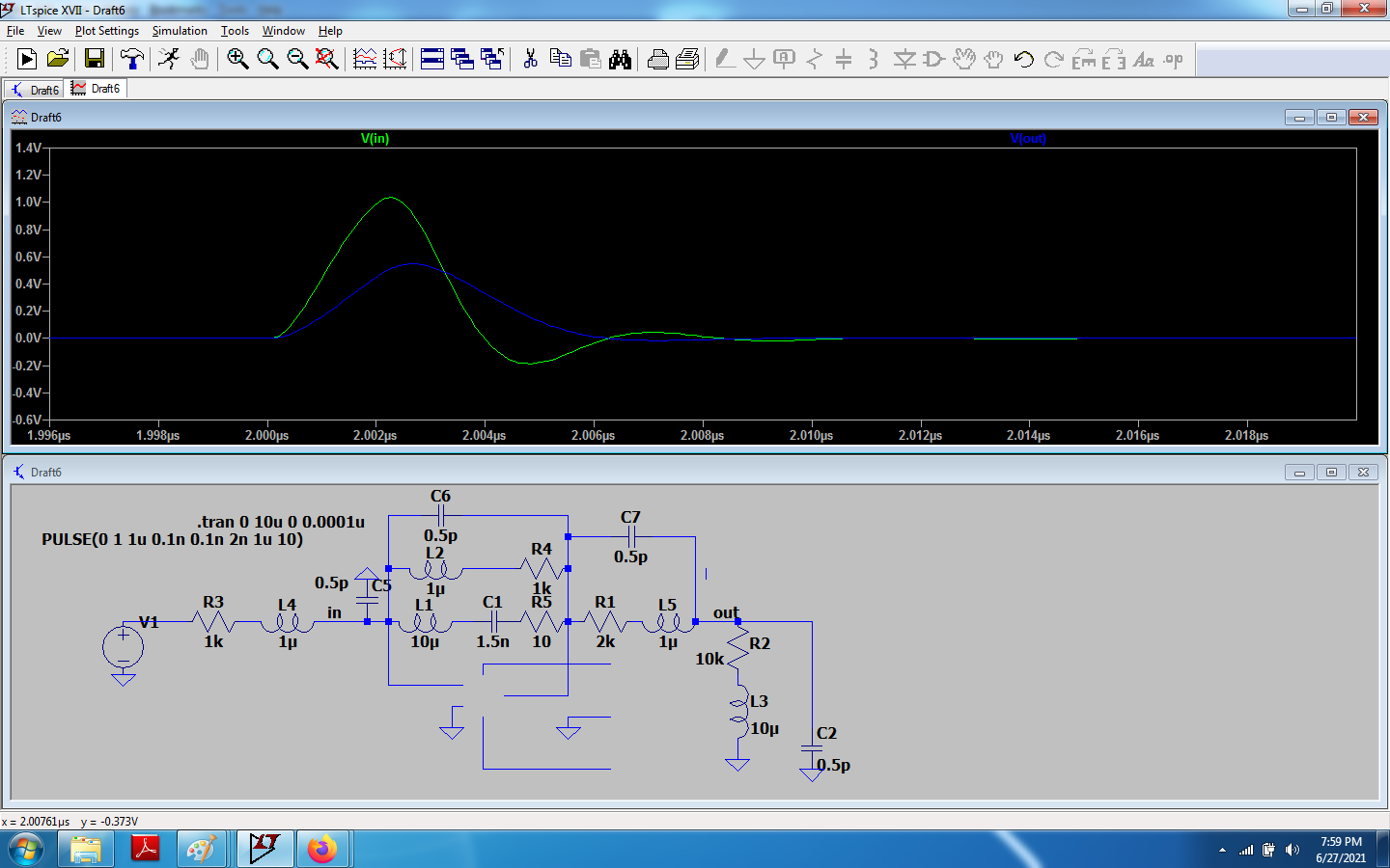

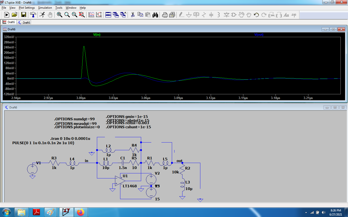

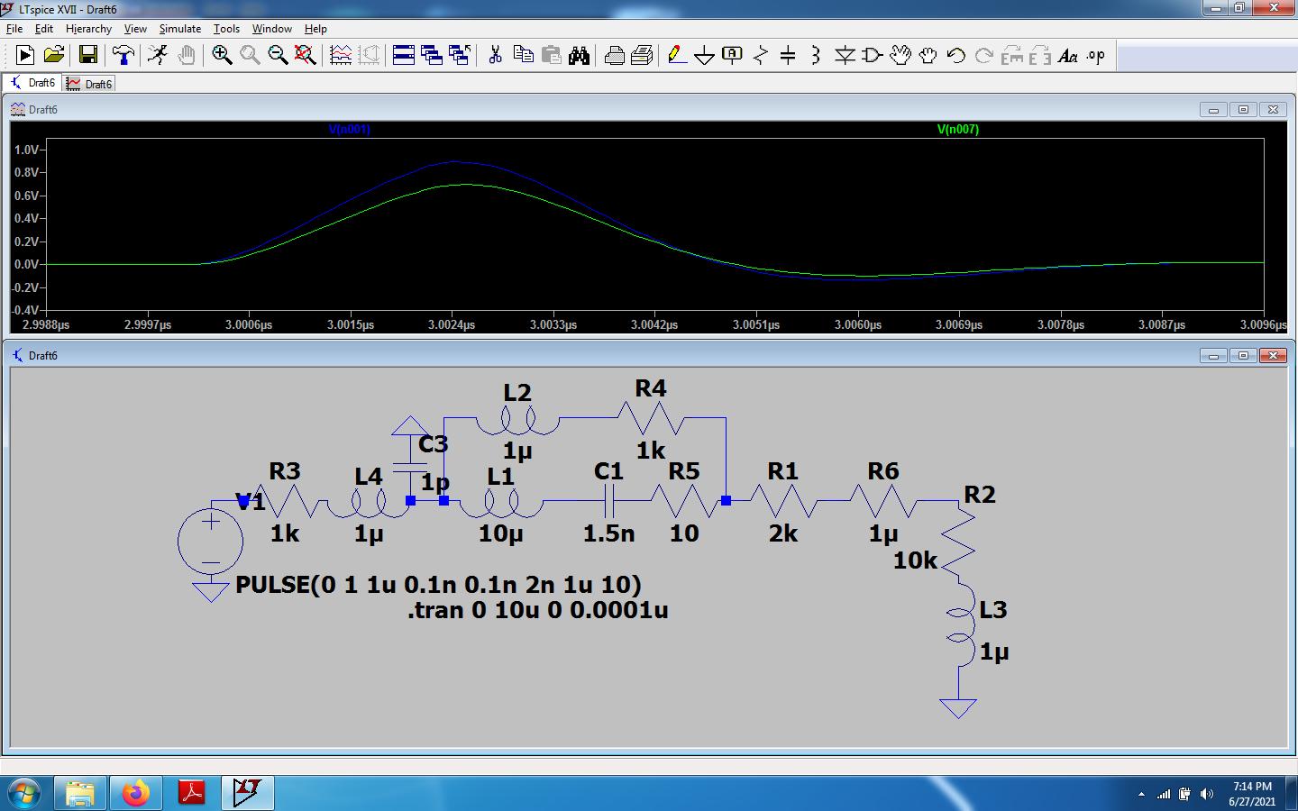

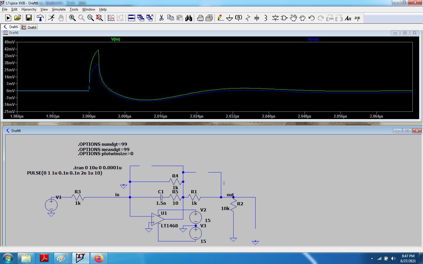

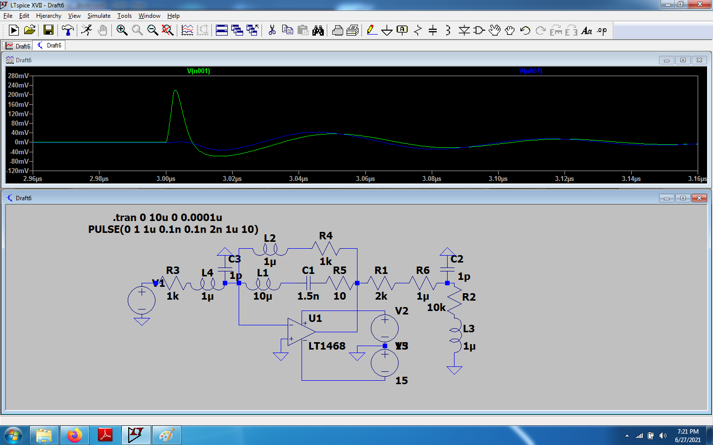

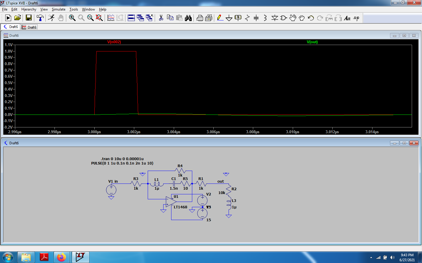

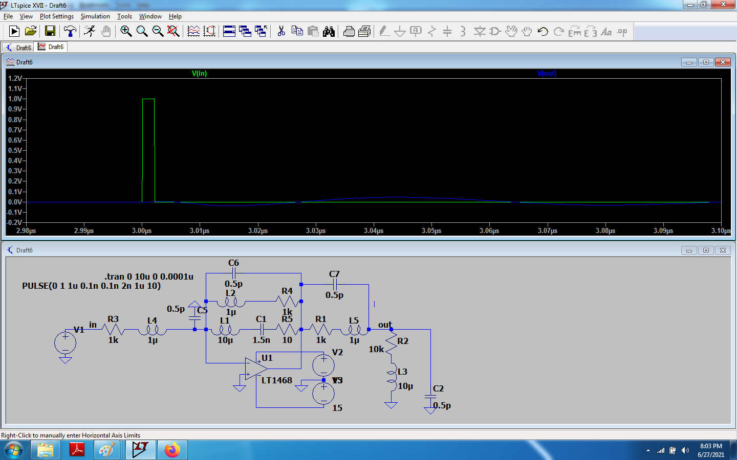

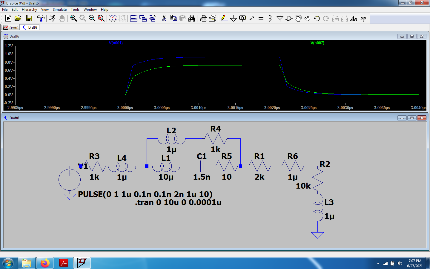

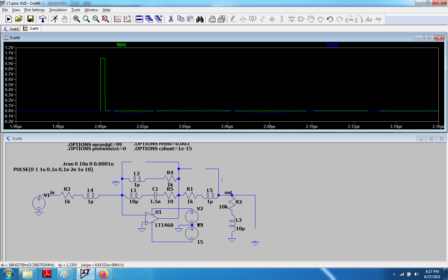

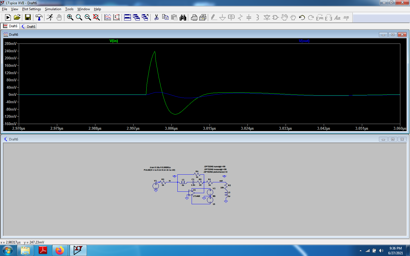

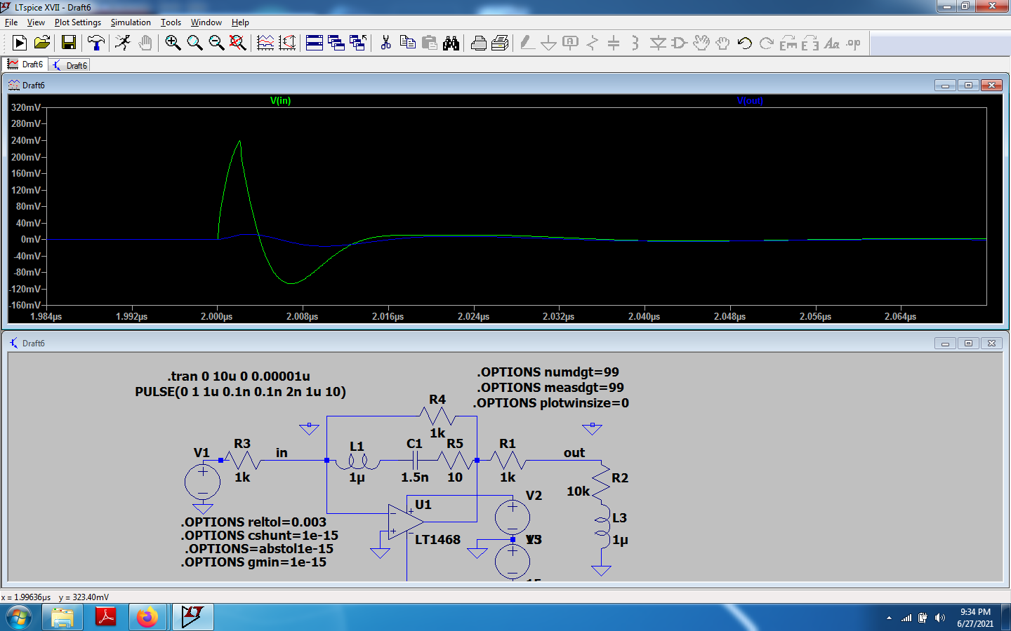

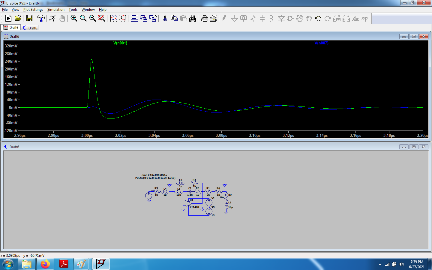

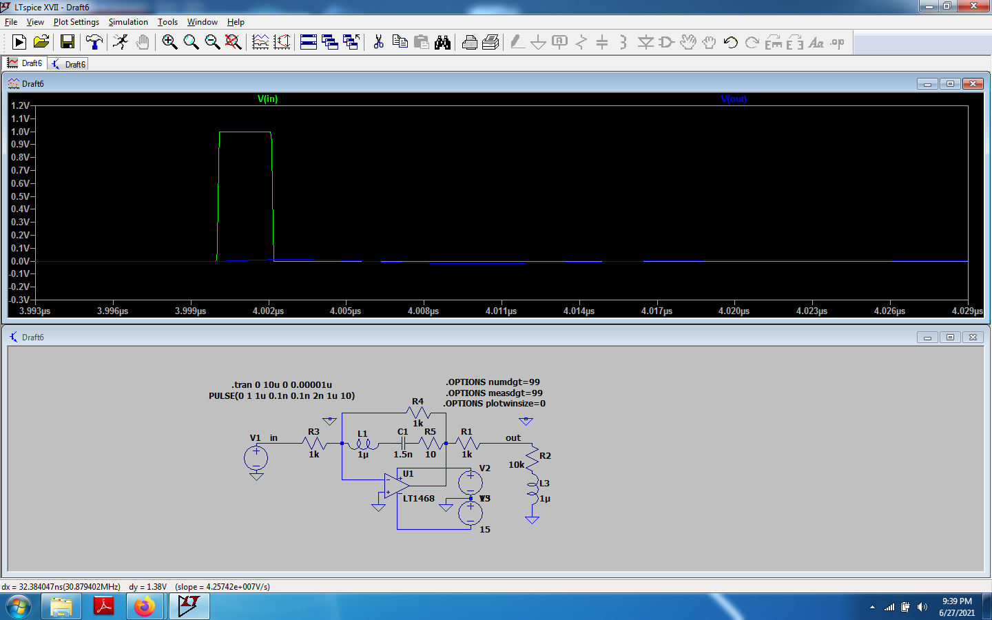

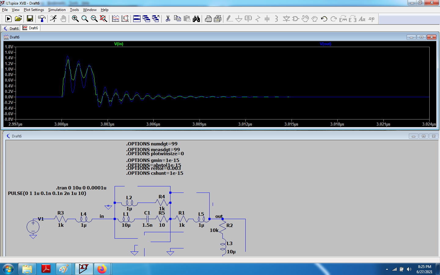

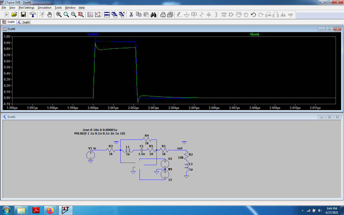

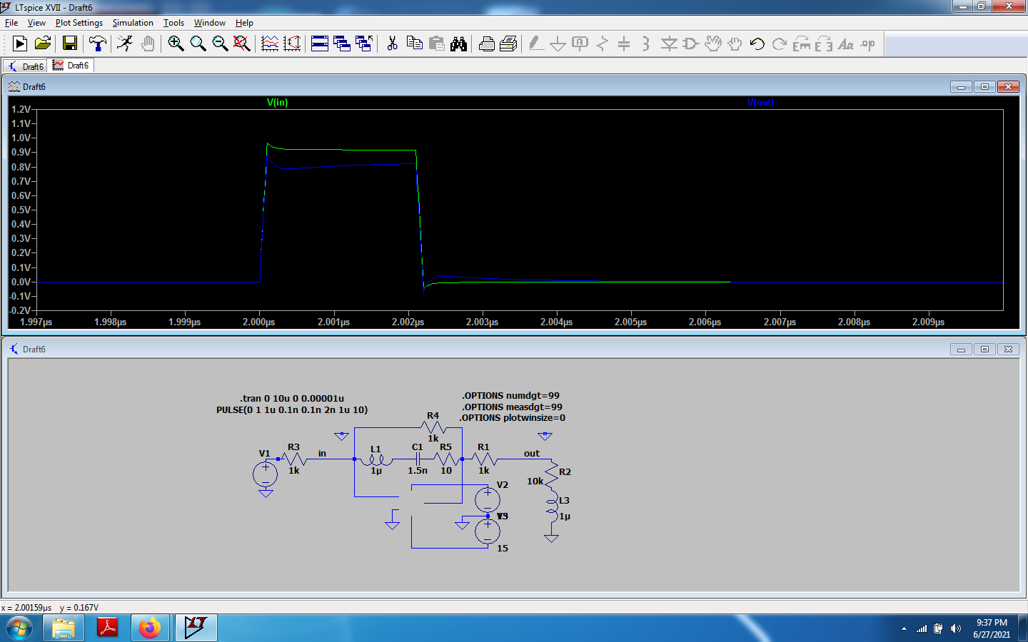

I looked for wima fkp3 1.5nf specs, yet i just had to assume 1u...1mh inductance but 10uh or 1mh give the same results .It seems that the real game changers are the pcb coupling ( probably more than just 1pf ...) and the op-amp itself, but the op-amp is clearly the one affecting the signal the most.The load itself might be inductive by itself and that will work against the op-amp, but not enough. Green signal is the input, blue signal is the output.

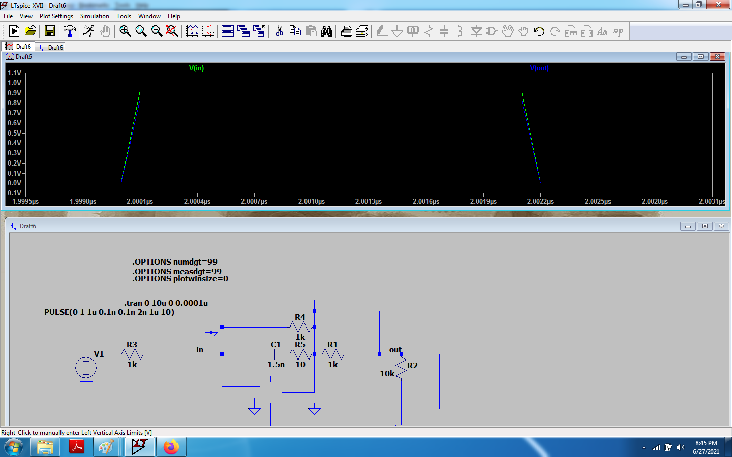

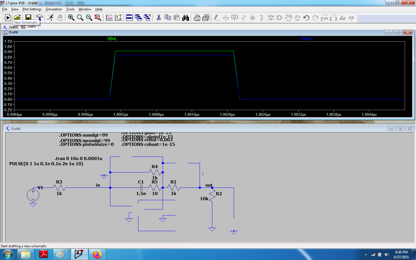

As i forgot to split the 2k resistor when introducing the op-amp....tried that again but obviously the op-amp is still the winner. each resistor will present its own inductance and capacitance at nanosecond signals. You have now the input signal before being transformed into current and what it is seen at the op amp virtual ground .
Well...try and measure 1.5nf fkp 3 wima capacitors with 1ma of 2ns signals...i bet you get much higher values than what i used, but you can remove them all and still see that the op-amp is doing most of the attenuation there as the inductances and capacitances of the components aren't doing much by themelves, while the stray capacitance usually found with pcb tracing coupling will muffle the signal with no inductance or higher inducances than what i used....Besides using LTspice medium should give the best sim model for LT1468, right? i could have used .cshunt directive to create stray capacitances everywhere and muffle the signal even more , but this way you can see clearly the results.The passive components by themelves can't reduce the input signal more than 1/3rd of the input energy.It's the op-ap doing the greatest job.Even more, removing completely the inductances you get better results when the op-amp is in, while the usual 0.5pf stray capacitances are pretty low for a real circuit.
Now given the fact that you presented us simulation results pretending they are real measurements, that's disturbing enough for you credibility when atacking other's real measurements and simulations...
The first is an old project.
Simulation is on improved designs with reduced noises.

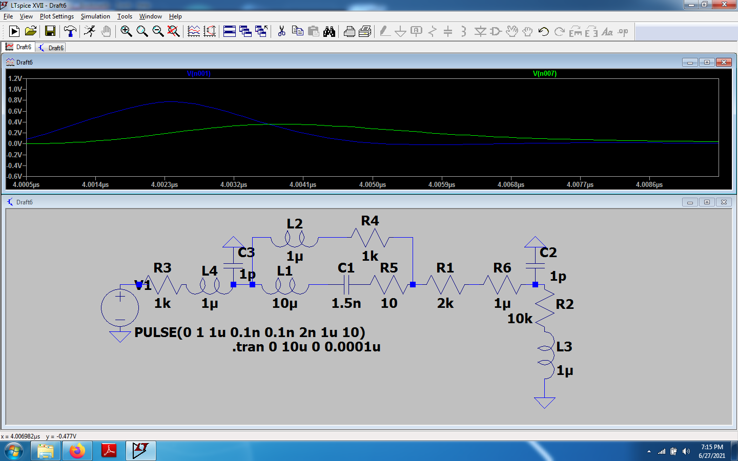

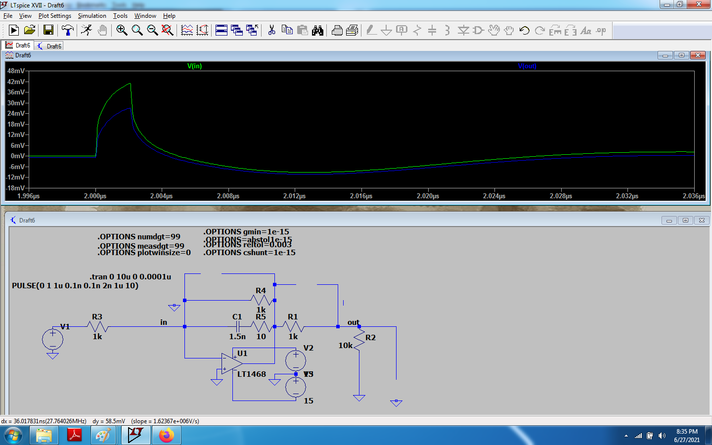

You can not use FKP WIMA to filter frequencies> 10-100MHz.
Something like that
Type MLCCs

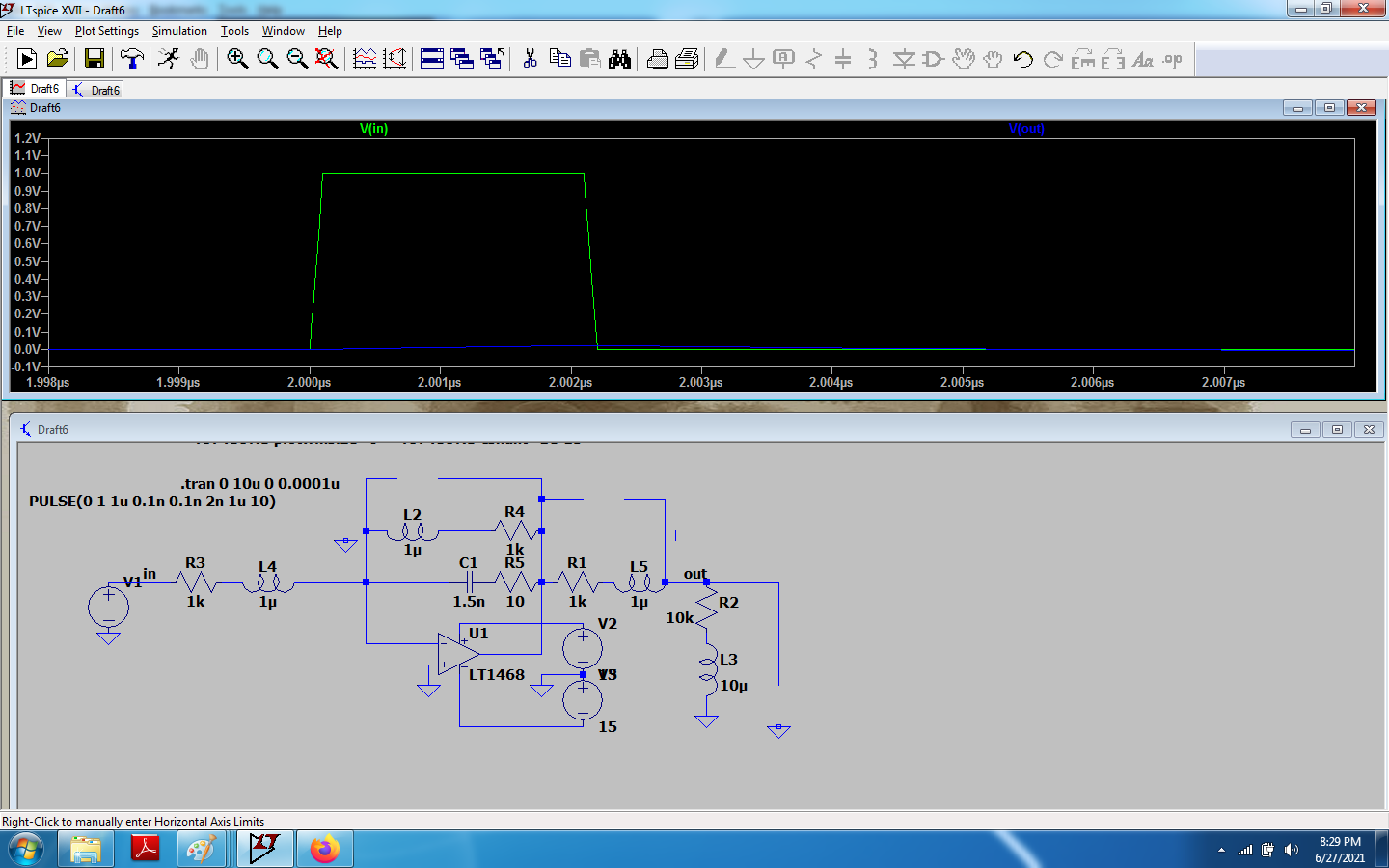

I just show Hans what to try to measure with this simulation.
Something like that
Type MLCCs
10 times smaller timestep than the rise/fall time which was already 20 times small than the 2ns impule length so basically 1/200 resolution for the signal plateau, with or without convergence...same sh...t
