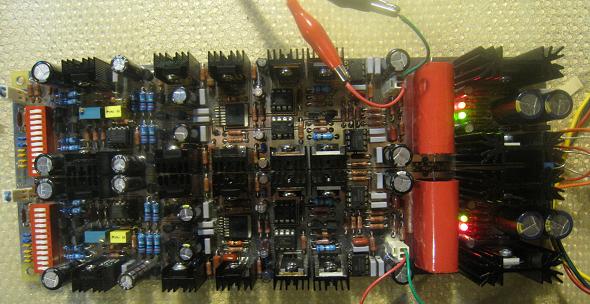

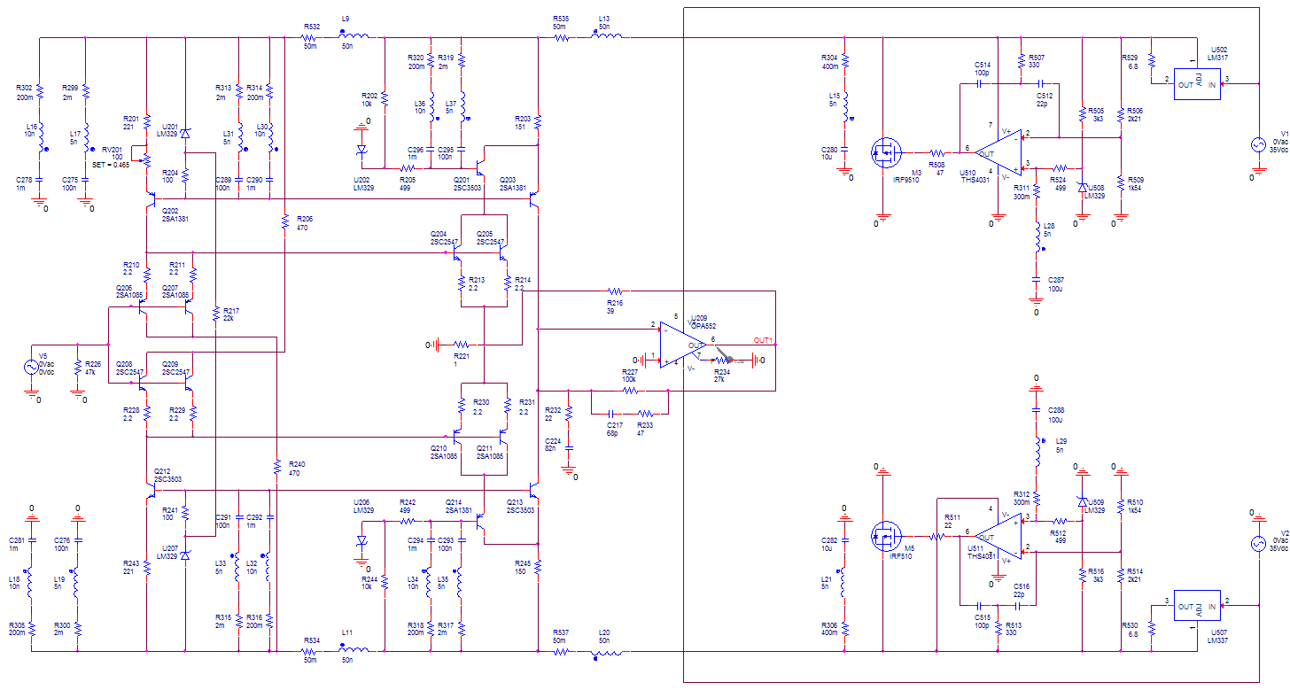

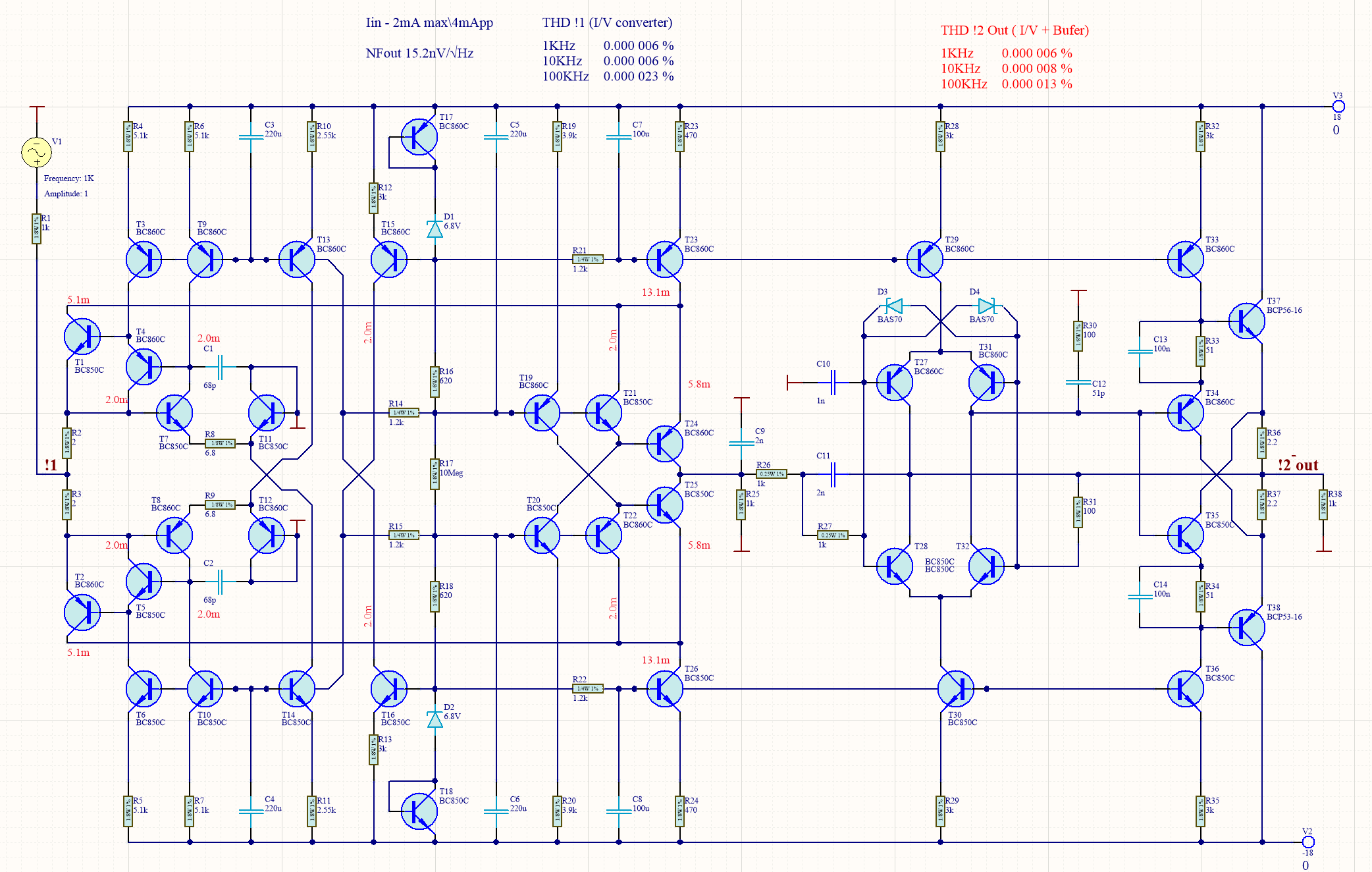

OP1005 is not a pure discreet amplifier.
For DC-10Hz there is an integral part of OPA333.

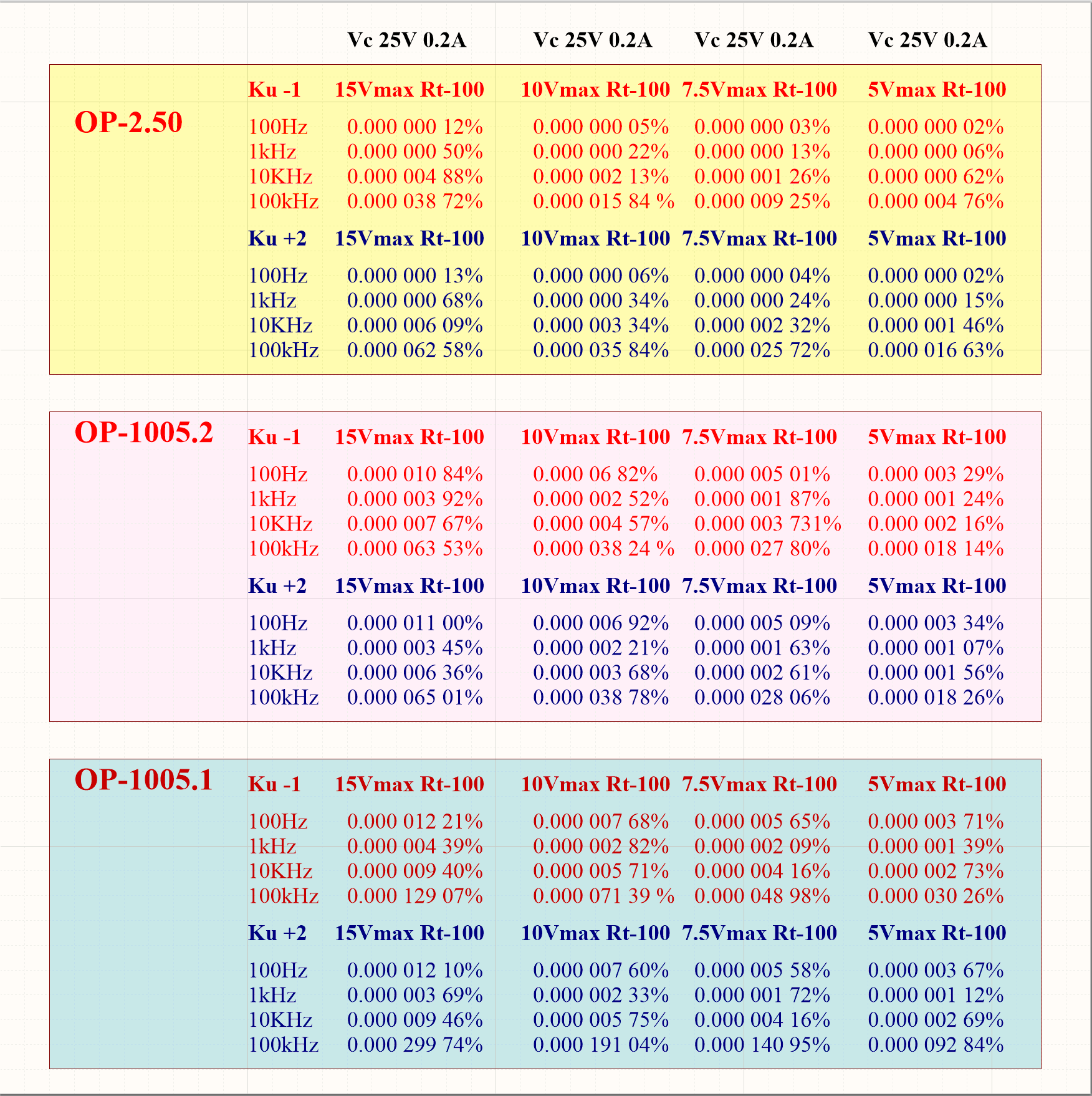

With what combination of integral circuits (compiled amplifier) you will achieve something close to the OP-2.50 per 100 ohm load and 30Vpp
The cost of the OP1005 is only 5 euros on 200 pieces made.

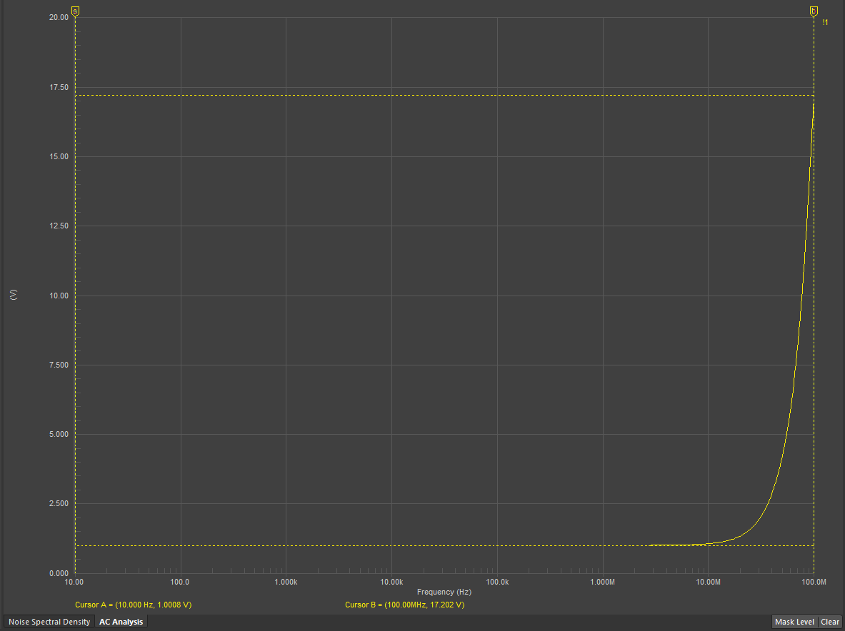

Graph of input resistance 1ohms for 10Hz-1MHz
17.2 ohms for 100 MHz

Sandy, any thoughts about the OPA861 for that I/V non feed back purpose ?
Certainly not the best measurement of the world, but can better Thd, be heard and pass the subjective test of a better sound ? It could be interresting for listening subjective tests to know how you power your circuits for the best results.
I do know nothing in electronic, but often I experienced X7R caps on such circuits gave me bad sounding results ! Any thoughts about that and alternative choice of caps, or does it need a perfect capacitance matching to achieve your wanted result ?
It's very complex though you succeed to make it short on a little circuitry 🙂

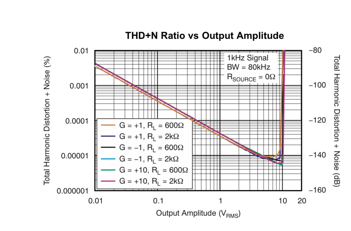

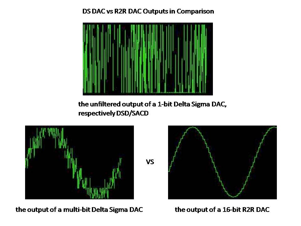

The specs of your discrete amp are very nice, but your opinion that fast opamps are producing a lot of noise and THD is simply nonsense.
There are quite a lot of fast opamps with noise below 2nVrtHz.
Also the supposed large opamp THD is beyond reality for audio applications.
See image below for a OPA1612.
Last but not least, no Dac in this world needs 3600v/usec amplifier, very nice but a complete overkill.
The output signals you show produced by various Dac types are true, but not telling very much and rather suggestive.
The R-2R signal looks nice on a scope compared to a multi bit delta sigma signal, but all this ultrasonic HF is in the Mhz range, potentially without any impact on the perceived audio signal.
Hans

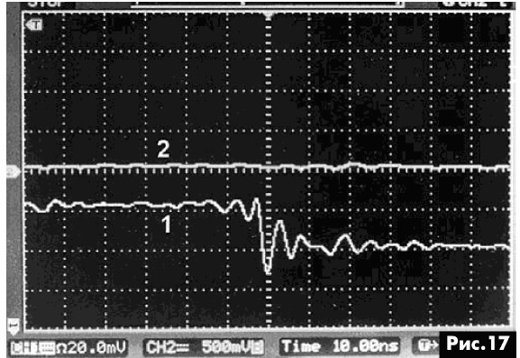

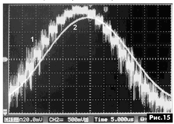

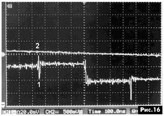

The output of PCM1794
Graph 3 is visible best.
Peaks with amplitude 1ma and time 2ns.
And this should be integrated accurately.
This overloads each integral audio operating amplifier.

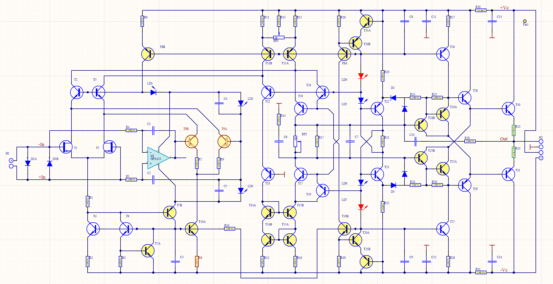

Thank you again. Next time would you be so kind and copy paste, in the right forum, the right schematic, not a simulation model, and some real world measurements results? Some (not you, of course) may be interested in some ultra low noise implementation details.
