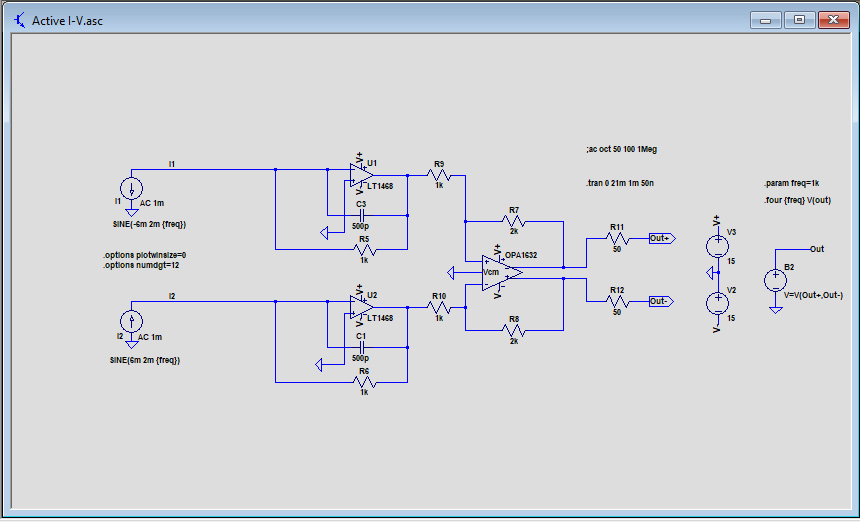

In this context is about very low THD I/V converter. I did the simulation and I can confirm it is very low THD. I understand how it worked. The question is the implementation. What about the measurement?
If you do not understand how it worked you can ask. If you do not believe it can be implemented, than you can ask the measurement.

For PCM1794
With all respect, but what exactly would be the reason to build a very complex discrete I-V converter these days.
With modern opamps as in the image below, one can achieve simulation figures of resp. 2ppm%@1Khz, 10ppm%@10Khz and 137ppm%@100Khz for +/2mA in and +/8V out while just producing ca. 3uV noise from 20Hz to 20Khz.
For the 1794 gain should be halved since it produces +/-4mA, the above figure were to make them comparable to yours.
Hans
Hans
My version show 0.000015% at 20kHz 4V peak in simulation (buffer output), just saying...

those values of distortion are only reached in a simulation with identical values of each transistor pair. Maybe a monte-carlo analysis should be done even when it takes a long time to simulate.
You also have to have a proper model of your DAC working into your input impedance, that is where most problems will arise.
I think 2 good opamps and a modern differential output DAC will give you much better results.
I'm totally agree with this!
More interesting will be to see measurements that confirm the statement that the people that still use op-amps are stupid.
The main function for the OPA1632 is to levelshift the signal to zero volt and to produce a true differential output signal with one single amp from both input signals.
For a PCM1792/1794 as an example the bias from the Dac is -6mA giving a permanent 6Volt output bias from the first opamps that has to be level shifted.
Hans
