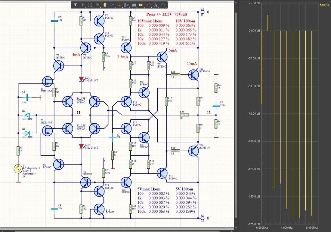

We need to know the capabilities of both integrated circuits and discrete ones.
Only then can we use them optimally.
Show us with which integrated circuit you can achieve such parameters.

I can see that this was fun to design. My own fondness for fully complementary designs may be showing. The complexity may not be warranted, but so what. If Sims are true ( often they are not unless stroked correctly to bring out their shortcomings ) the performance is excellent whether there are 3 or 4 zeros in the distortion result. Were there any other design constraints than distortion and noise considered. Cost, size, power, for instance?
These are very wrong results.
Can not simulate exactly THD of an integral amplifier model is very simple.
The result of the simulation must always be confirmed by the measurement.
Then how did you measure -150db THD on your circuit if everyone else but you is not allowed to show simulation results??
By the way , i've used 4 different simulation models with the basic virtual ground op-amp i/v and all show -150..-200 db thd and making a more complicated circuit only enhances the ods or the even harmonics, never reducing both of them at the same figures you get with the simplest op-amp model you can find .This topic becomes ridiculous as many others, but I already know a local company selling discrete dac's for 20 000 dollars and you always get an audiophiliac able to swear its new aquisition is better than anything else , the newest review meaning actually that he's advertising its new toy maybe he'd find the next stupid guy to buy it from him and save some damn money or jut get some discount from the company if he's smart enough to give a quick review before others do it first ...That is usually how audiophile componet get upper in price cause no snob is able to admit he lost tons of money on a worthless POS who's same specs or even better could have been purchassed for 100 times less money ...
I have to admit that I'd be seriously envious on anybody selling for serious money a 100 transistor crap that simulates worse than a 1 dollar op-amp simply because I can't do it.

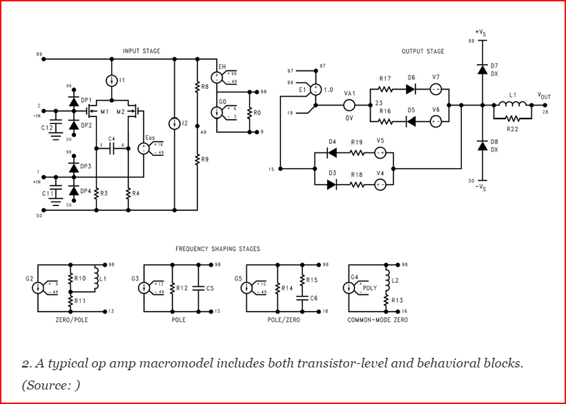

I see that you do not have the technical knowledge you need to find out what is about the simulation of an integral amplifier.
To be exactly THD, the model should contain all transistors with their exact models as it is in the discrete scheme.
No such complete operating amplifier model.
Look at what one such model contains.
If someone thinks with such models can model Thd it does not understand anything from electronics.

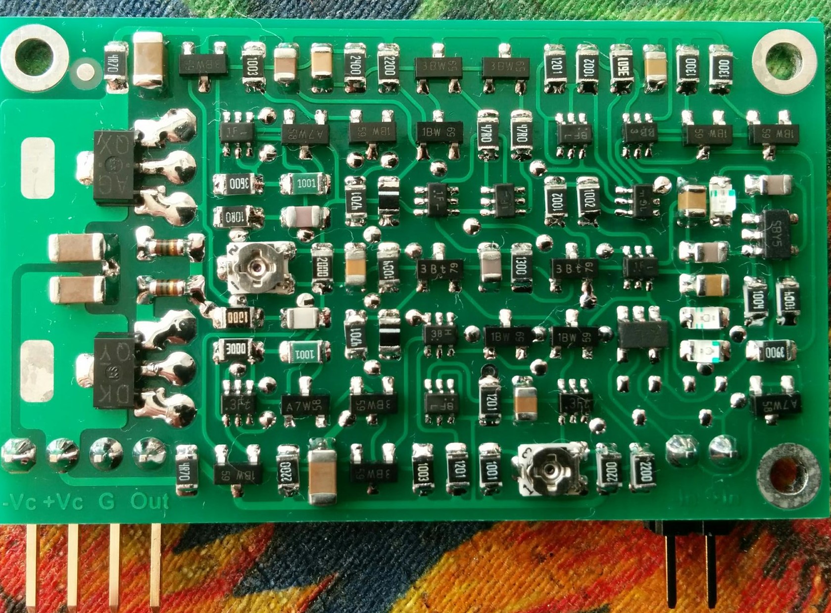

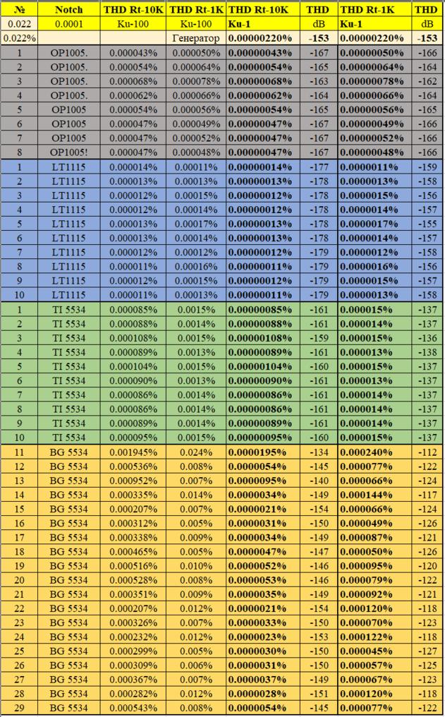

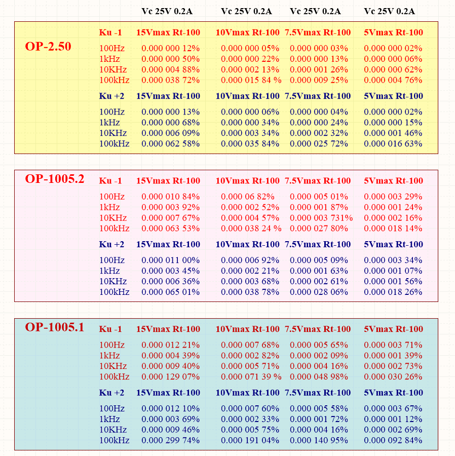

With a little insight into the subtlety of Hans' comment, you see that he is not saying that the IC can be simulated as accurately as a more complete, discrete model; he is saying that the difference between the 2 methods is so small in reality that it is swamped by the difference between simulation and reality in general, so you need to build it and measure in BOTH cases.
Modern op-amps have a THD so small that it cannot be measured directly by any instrument.
However, there are methods of such measurement.
These are real measurements
And simulations
