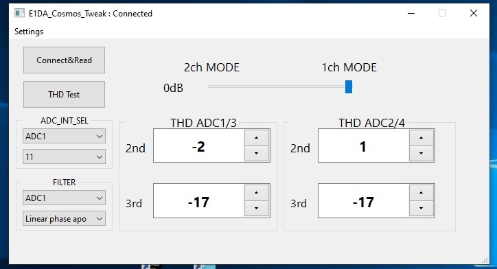

Thank you all I will try. I'm facing some othe isue, for example TweakCosmos app, when I move slider to the left position and when I click on connect&read slider is again at the right position, looks like can't be set to stereo. Also setting button, when I click on it all the things is grayed out, I have no idea why. To be sure if that app is working I have tried to change filter and when I click connect&read it didn't move to the previous value so filter settings wrork. All the things in relation to Cosmos adc is a bit of pain and lack of manuals. I will try to move my xlr to the right channel, all the time I have xlr connected to Cosmos left xlr input, maybe if I connect to the right channel it get correct db measurements. Curently I don't have another xlr cable to try booth channels and will need to make another one, until that I will try to change volume on my windows in hope leds on Cosmos at least change led color : )

I think you really need the driver in order to manipulate the volume - that volume trick is of course just some made up signalling trick to the ADC to change mode... if you dont, the ADC will go inte basic mode and you will get output but you cant use the utility app as you have discovered...

No, the volume has noting to do with any levels whatsoever... its only to switch between mono and stereo. You need to set it to 0 to get Stereo.For example if I set windows volume to 50% is not that I will get -44.2db to an allready wrong value -22.1db ? Value -22.1db is allready half of the real value!
I will try! Seems for my setup stereo might be switched on bcause I have using only one xlr input on cosmos? My Comos is version B without iso. I will make isousb211 when it become available for buy.

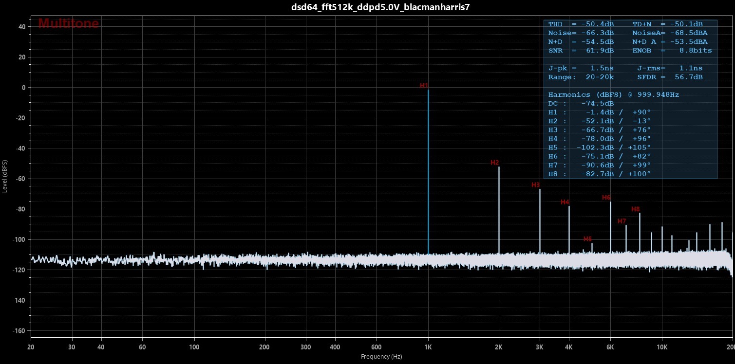

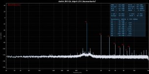

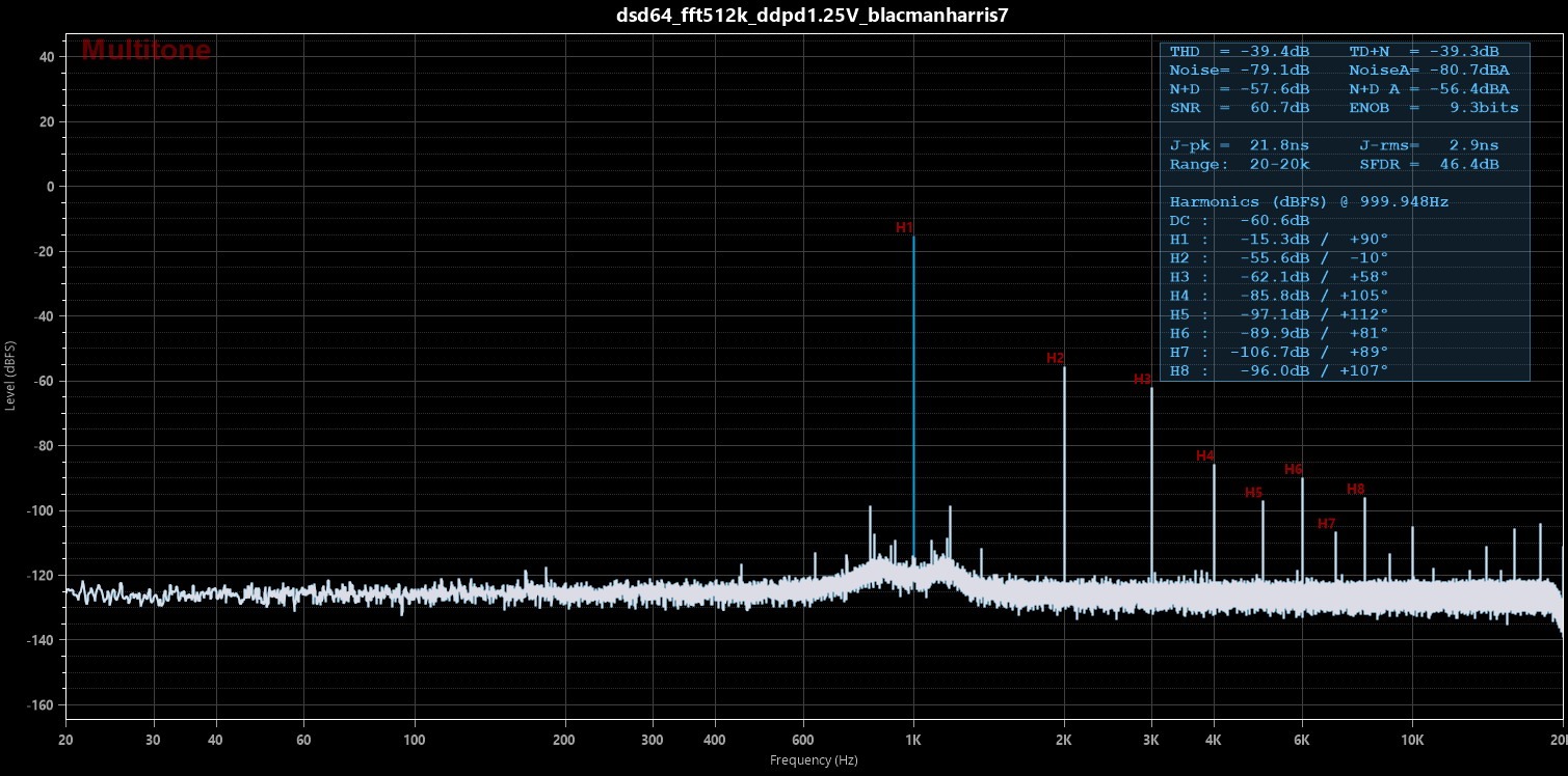

I think I have finaly understand how to setup Cosmos. Right now my setup is: right xlr input of the Cosmos is connected to the right output of the DDPD. All volume levels on my win10 is 100%. Trick here is to use right channel of the Cosmos since right channel is always mapped to the right channel. Seccond trick is to move volume slider inside TweakCosmos to the left position so that Cosmos switch to stereo mode. Doing this Cosmos leds is no more blue for booth channels butnow ir green on the right channels which seems is correct now. And now we can see -15.3dvFS inside H1 which is very close to what I have expected -15.4dbFS ! Right now I think my settup is finally corect. What I will need to do further is nthe right interconnection so that I do not have ground loops and thing, right now I don't have usb isolators and I still can't expect the right measurement, but I think it even enought to play with some things for example I can now do some tweaks in relation to dead time setting inside ddpd, I will try to change it until result get optimal. : ) I can see Cosmos is clipping with red led while ddpd is on 5V which is indication that all the measurement things is close to ok, excluding the fact that without an aux filter 20-20k the result can't be optimal. For dead time adjustement this will be probably good enought.
