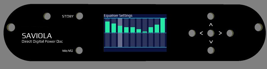

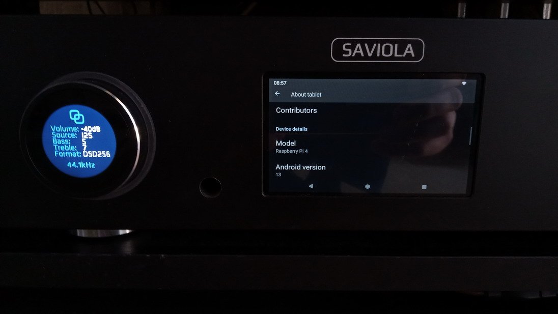

Half analog one, which is still not fully finished yet , putting that cm4 and display to our mini version, completely self-contained device, would be my goal for ddpd mini v3

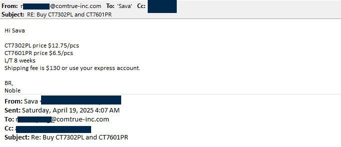

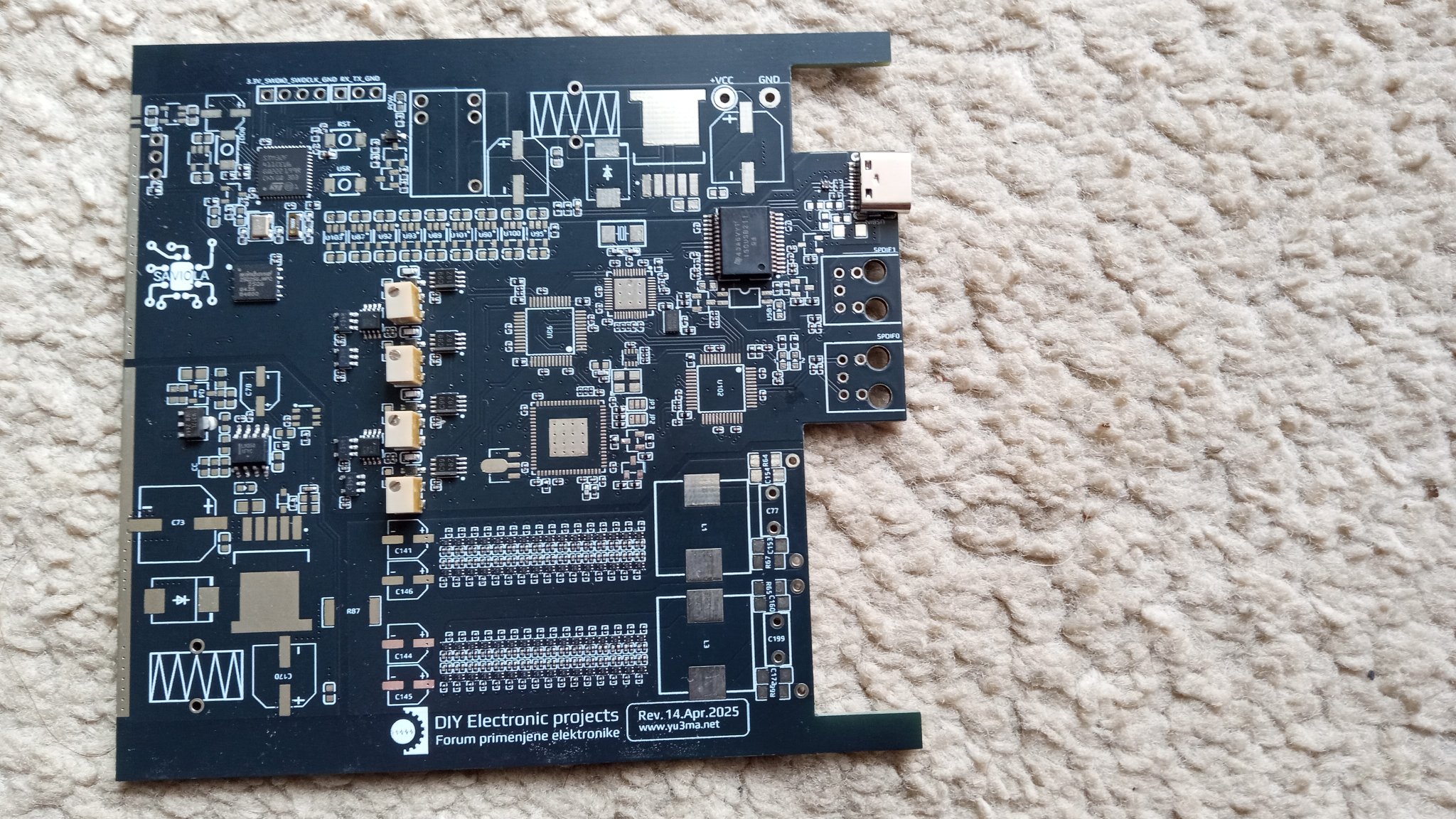

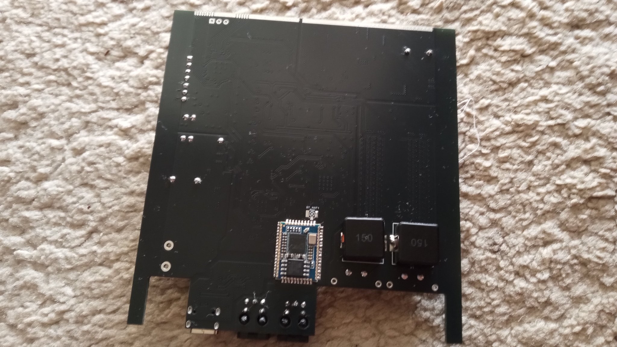

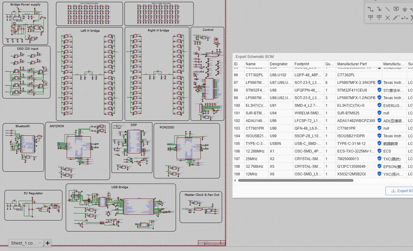

JlcPcb is the cheapest one, there is apsolutly no cheaper one on the world. Saviola ddpd mini v2 is expensive because it contain 109 unique elements multiplied with nuber of components per component, for example one device contain more than 500 components on pcb size 100x100mm, that cost a lot because almost all components is 0201 and feed machine is the most expensive since $1.xx cost per component when it goes to the feed machine for soldering, thats expensive. For example if my components is bigger than 0201 than I have no problem to solder them myself, that save money a lot but since our components is 0201 and I no want to mess with it, its not easy to solder myself so I decided to pay for soldering service, even its not that expensive because 500+ components is on the pcb! Saviola biger one, half analog have all self-contained things like android device, 4.3" lcd, optic inputs, usb input, i2s in-out, bluetooth, android, ..etc, complete mini PC like based audio device including 2x180Wats Hypex ucd180 modules, dsc2 diferential discrete dsd dac, analog preamplifier with i/v, tone control with relay based pots digitaly controled... etc. But saviola ddpd mini v2 is fully digital, no preamplifier inside, no dac, no opamps...etc, the only thing which is missing is android device and their display, maybe in v3 I will include booth. In bigger ddpd it will contain everything as like in saviola analog version! The interesting thing is cm4 module, you can install whatever you want on it, linux, android, windows, or some distro like Kodi, Daphile...etc and everything is reclocked with asynchrone sample rate converter, in my case to 48k fixed, so only one clock and fanout bufer is need for 12.288MHz clk : )
See how many components is inside mini v2

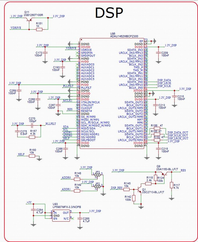

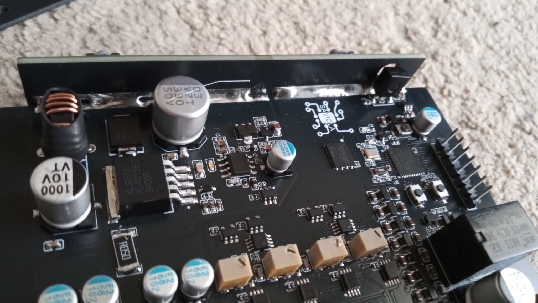

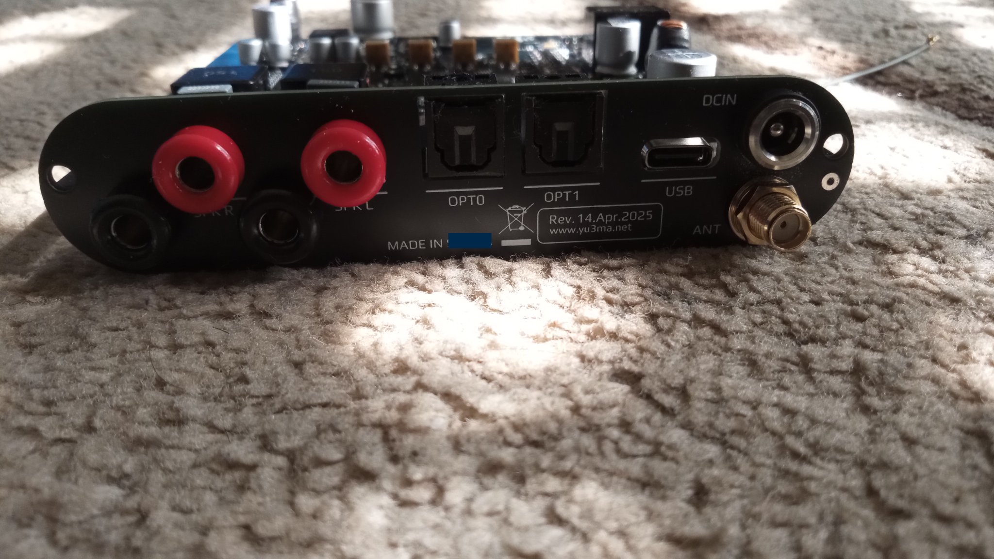

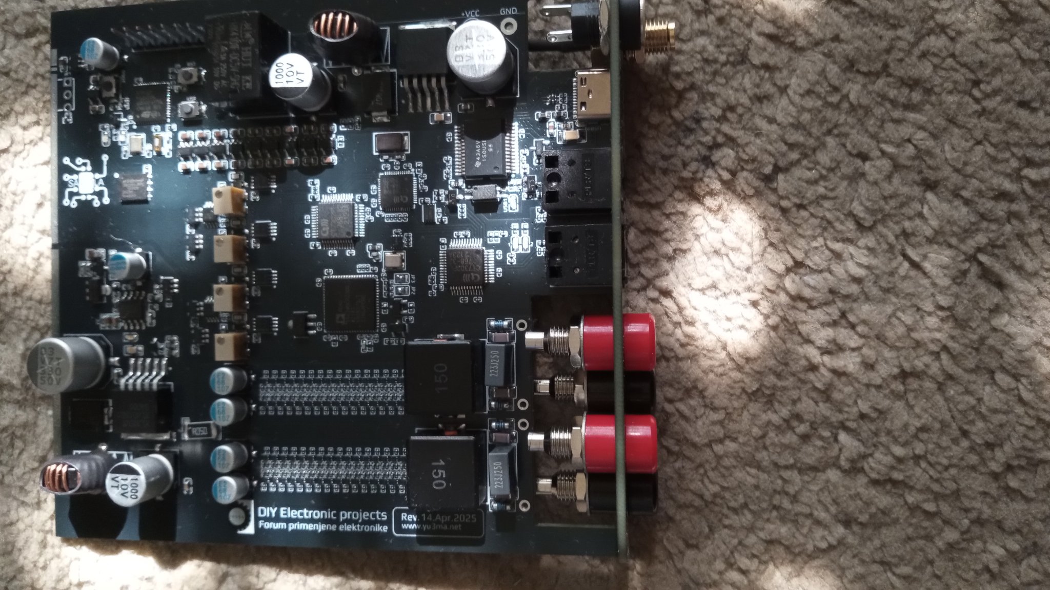

Main pcb finished, had problem with short circuit, at one point I thought it was over! Two hard days until figured out that gates in H bridge must have an minimal load, without minimal load it simply not tolerate floating pins and it simply makes whole thing like an short circuit, but afer I put coils at the botton as a part of the LC output filter in H bridge and their 10k load rsistors (minimal dummy load) the things started to work. Tested all regulators and seems everything is work corectly now. Now I am ready to program things. Have missing tft display but until I order them I can do things trought UART, uart is now display : ) Hope everything work! This is not an simple project, an very complicated project.

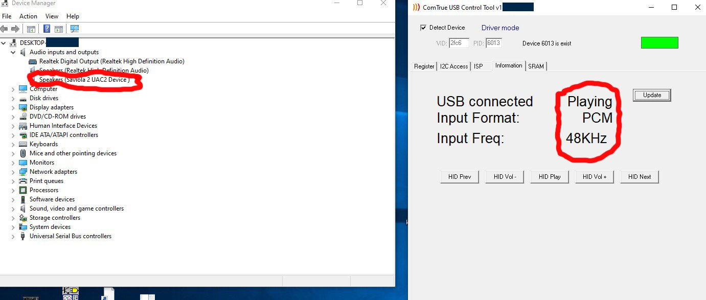

Initialization went well, all devices on the i2c line were detected, successfully initialized. There also was some problems, for example if dsp is not initialised first the whole i2c line is not work. After fixing that another problem appeared with the gpio on the usb iso side, the gpio signal is there but the opto doesn't respond, after debugging I found that the problem is in drawing the schematic on easyeda (new feature called autolabel), when I copied and pasted the label on another part of the schematic, the autolabel did its thing, so I didn't notice, instead of usbvcc the label was assigned as usbvcc1 so now there is no connection on the pcb and that's why the opto circuit is not activated, luckily the pin to pin is very close so i will be able to make the missing connection with a jump wire. I think everything will be working on the speakers by Wednesday. If everything is ok than software development is a next step and finaly putting all together into enclosure.
I regret that I didn't install a four-channel digi pot with i2c instead of analog pots for dead time adjustment, it would have been much simpler and more precise to adjust from the software than each of the 4 analog pots individually, there would even be the possibility to automate from software auto adjustement, for example DC offset adjustement... etc. : )
It's not that important here because the voltage is low, but I should plan for a future larger project with gallium nitride transistors and much higher power, and having a digital pot for DT would be a very good exercise for the next project so that it is also integrated.

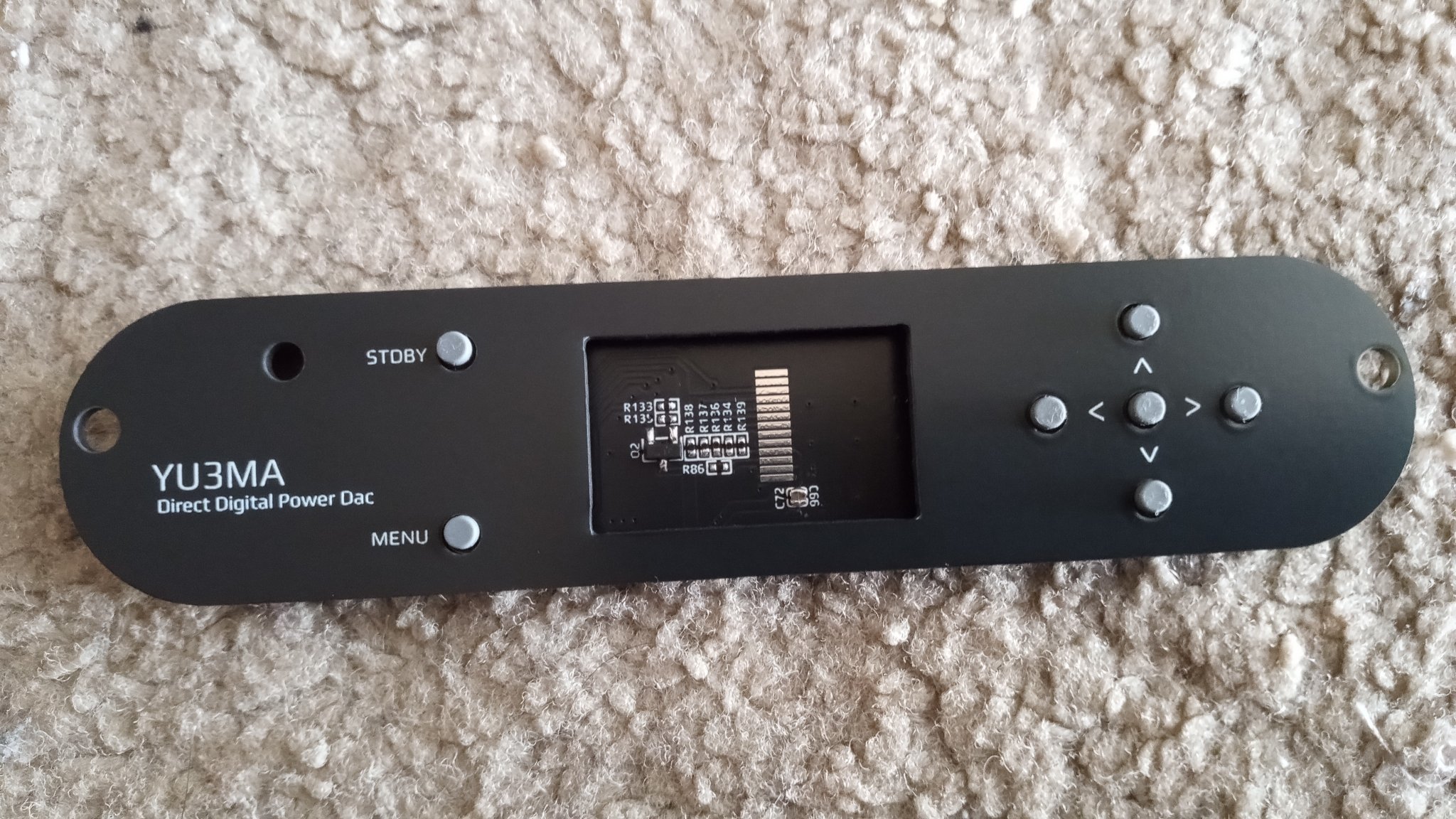

Thanks! There is one reason that I will not reveal, I think it is better to say made in Home? No, it will go open source as like one from first post. Some more work. Tommorow hope interconnection is done and hope display ordered as a last part to solder.
