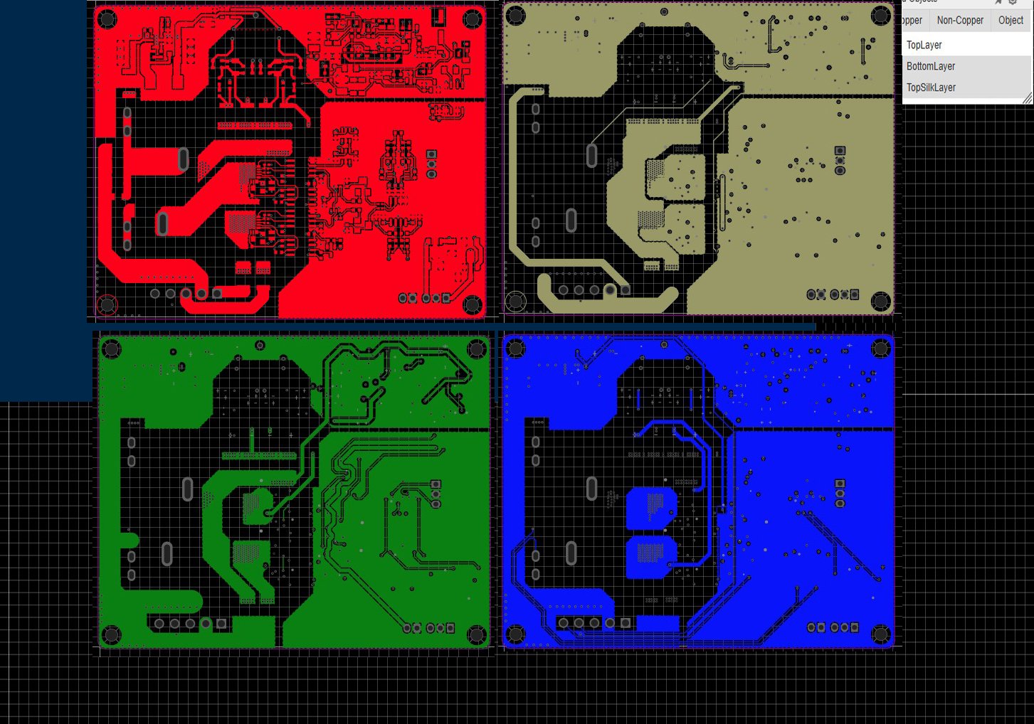

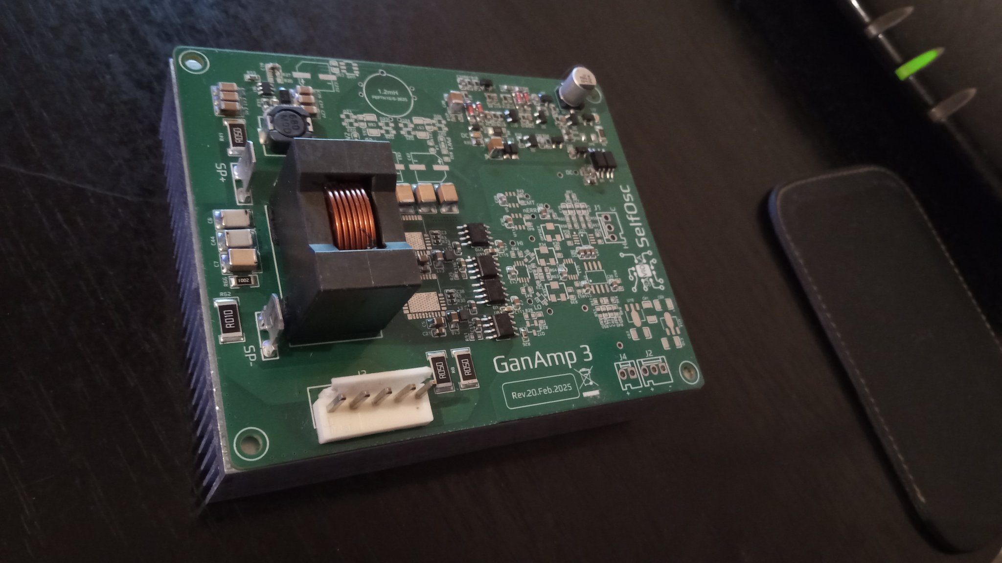

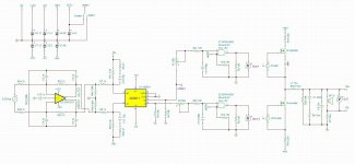

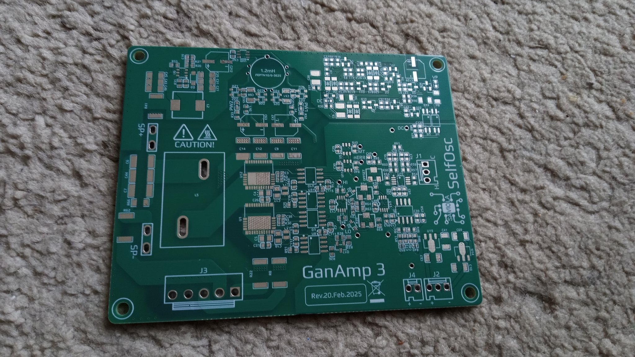

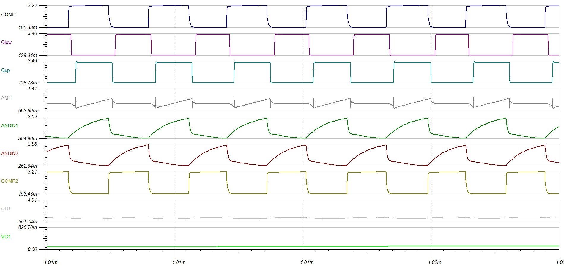

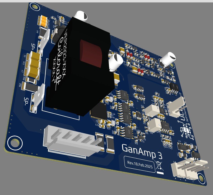

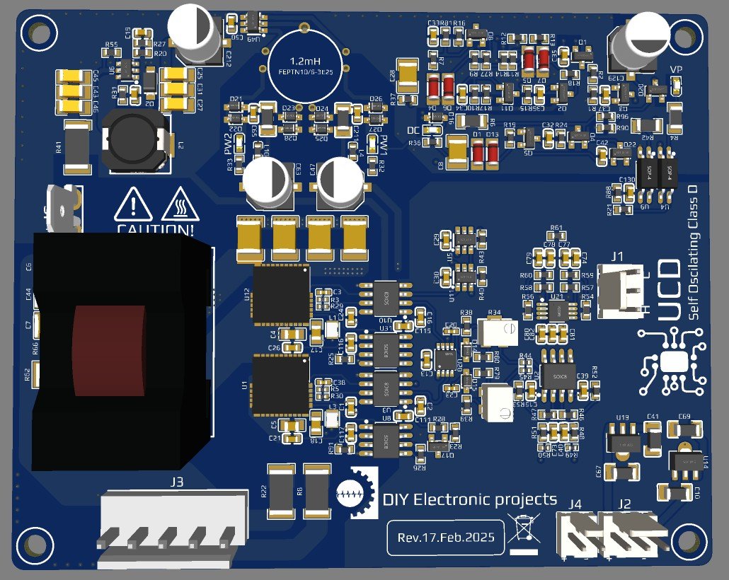

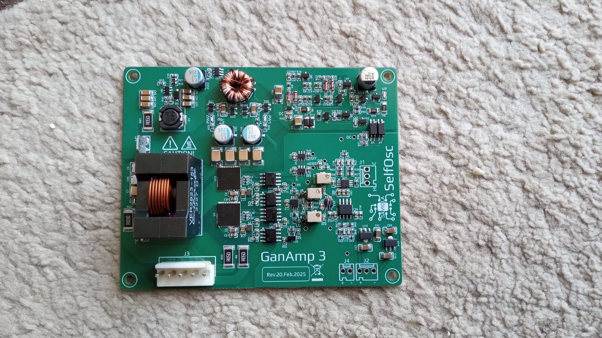

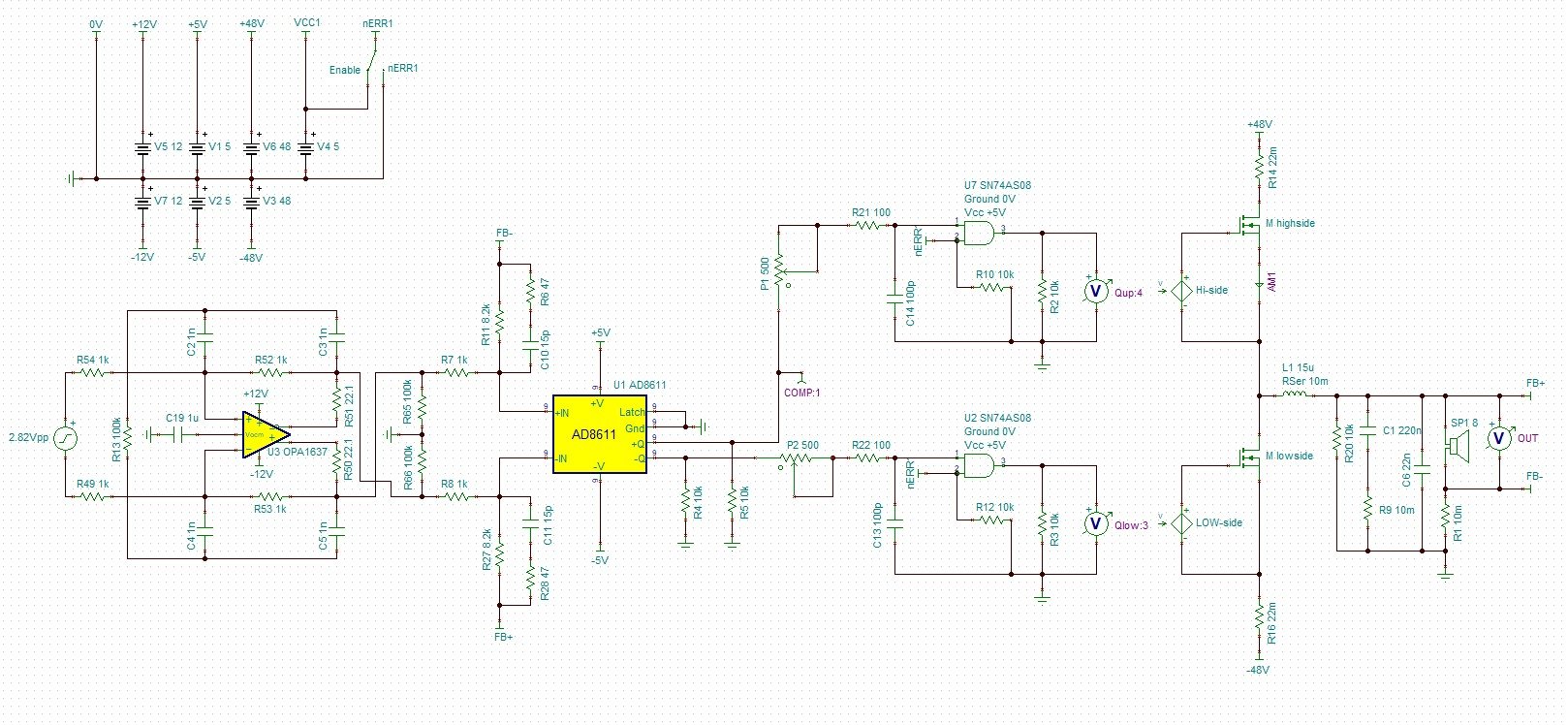

Sadly DDPD gan version half vridge with lmg3411r050 doesn't work, missing some parts in dead time arangement, can't be fixed, instead I designed new pcb and converter our half bridge to ucd type, self oscilating. class D, worth a try! Also designed isolator for my Cosmos adc tool, ordering booth next day : )

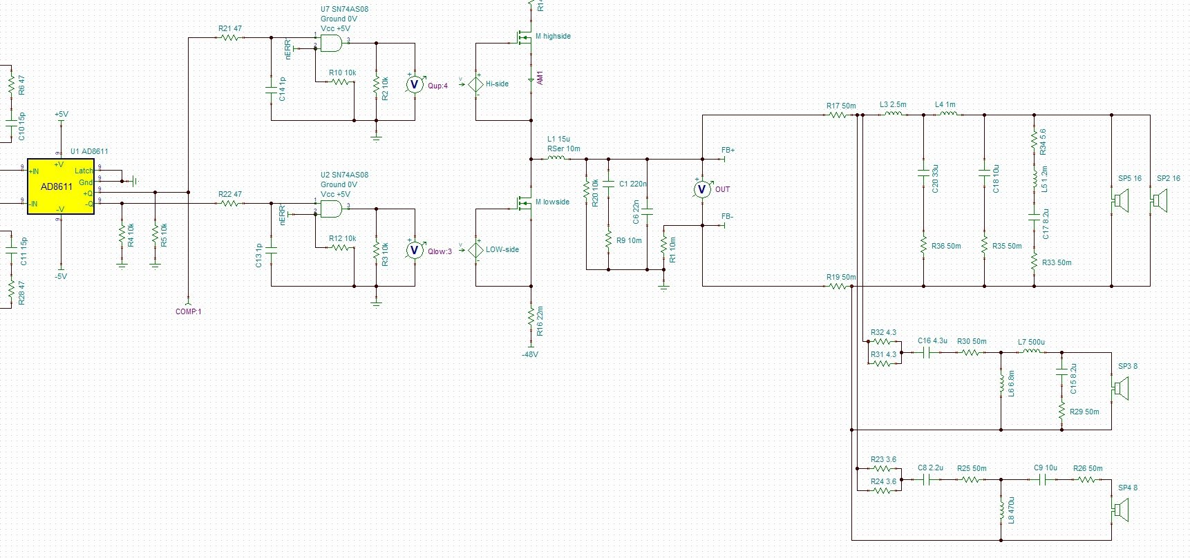

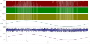

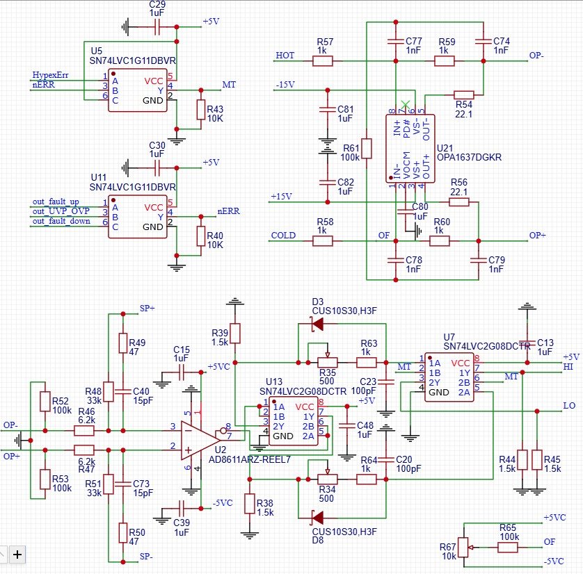

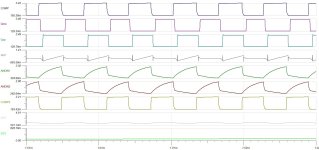

Sim tells that self oscilation is working in all situation, 0Vin to 2.81Vin, with load, without load, even I added an crossower + speakers into sim and self oscilation is working, hope this work too on real circuit. : ) This is final lauout

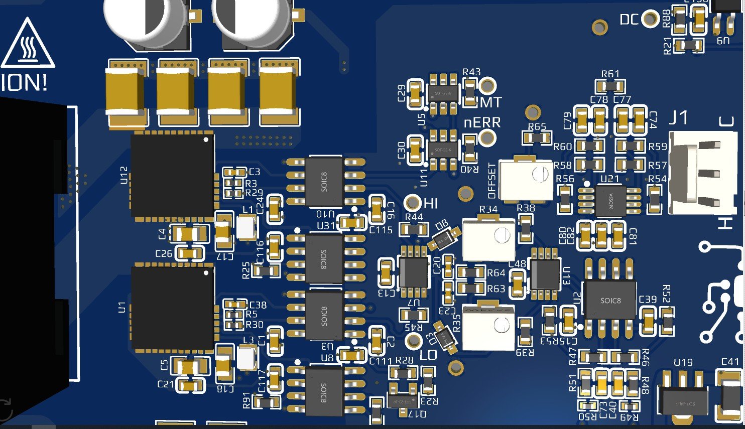

Some modifications in booth sim and pcb, added buffer for comparator, added some pots for fine tunning, added test points... etc, this square waves is what I expect from real pcb : )
Self oscilating gan amp is the next on my workbench! : )

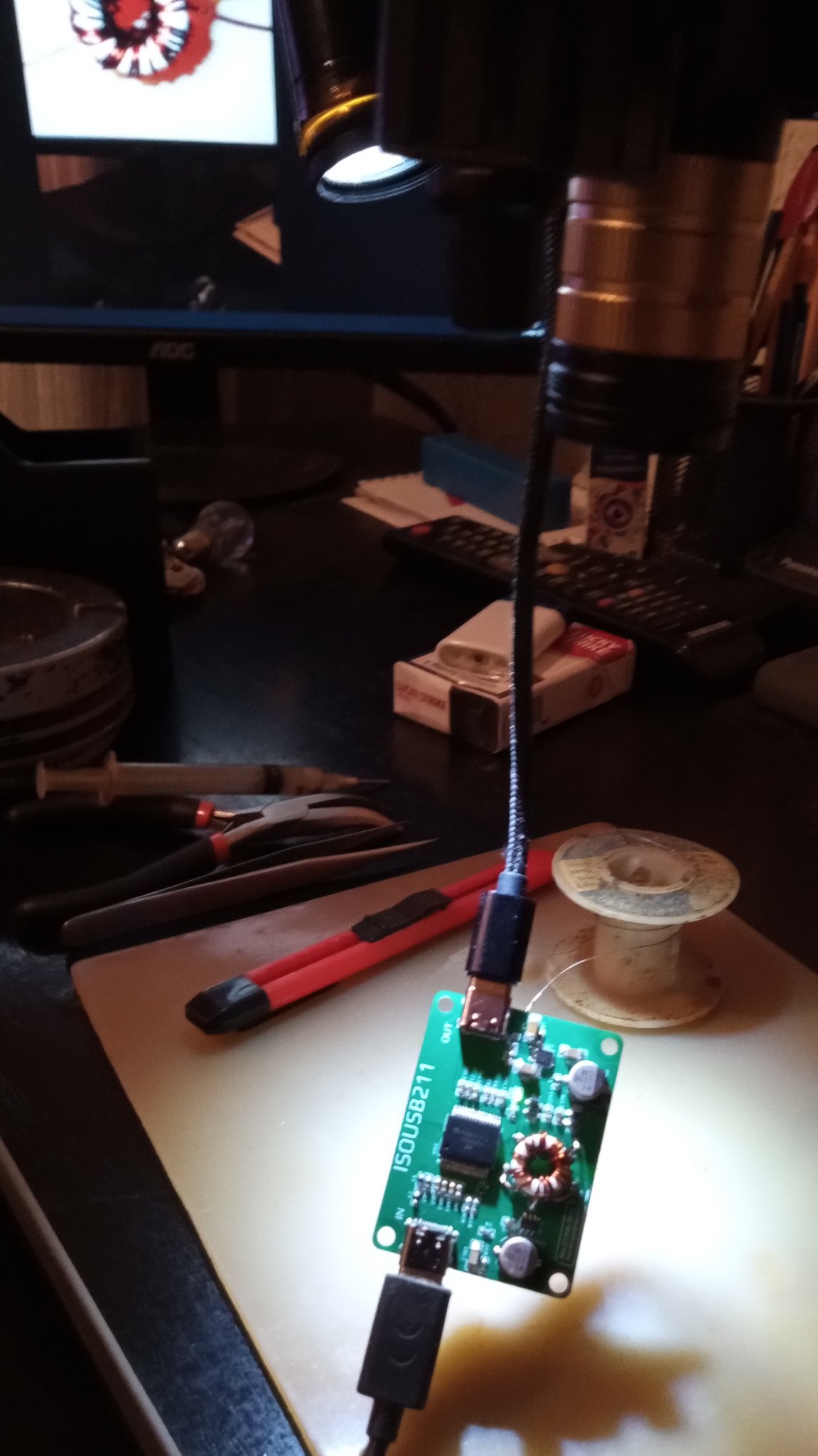

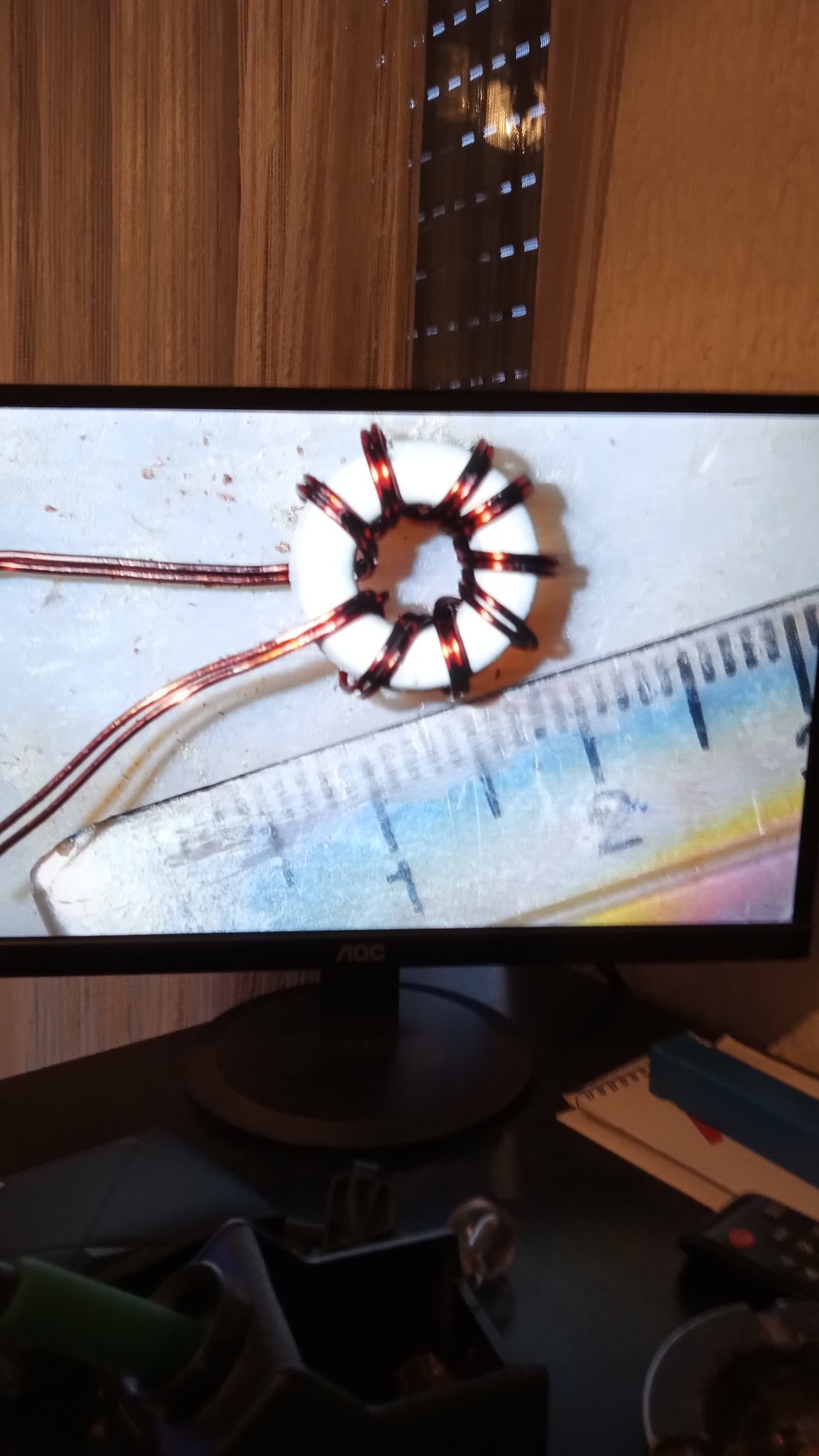

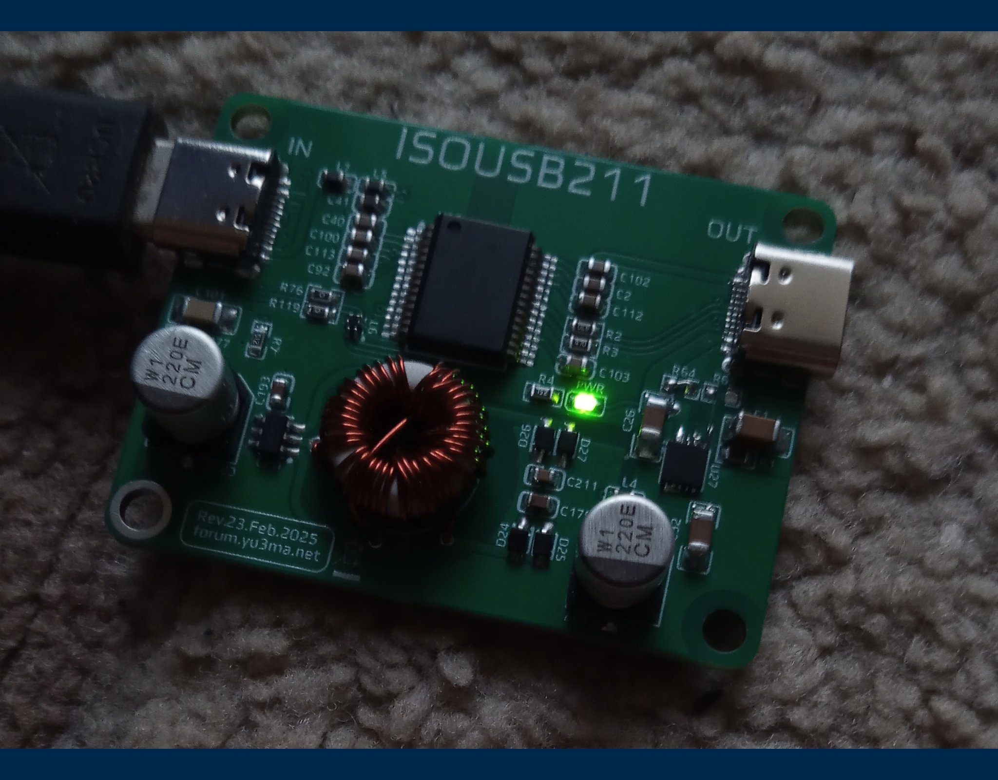

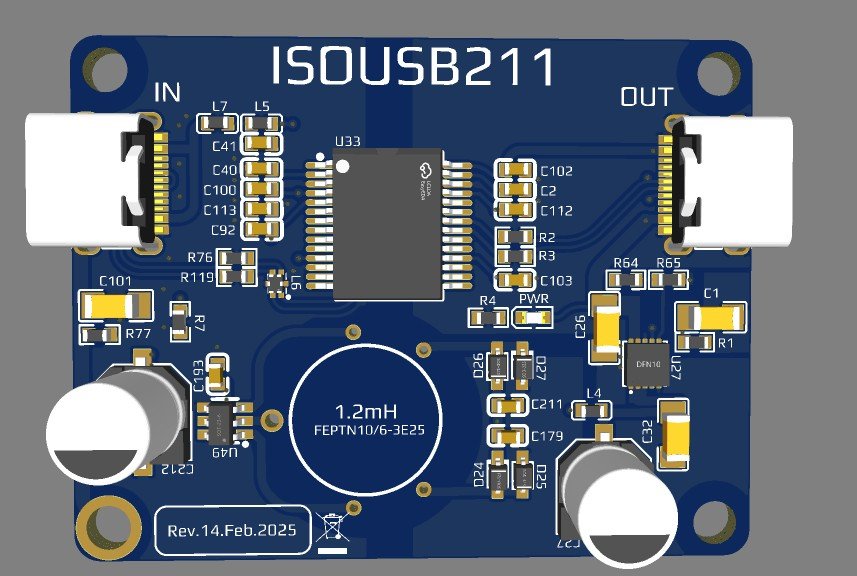

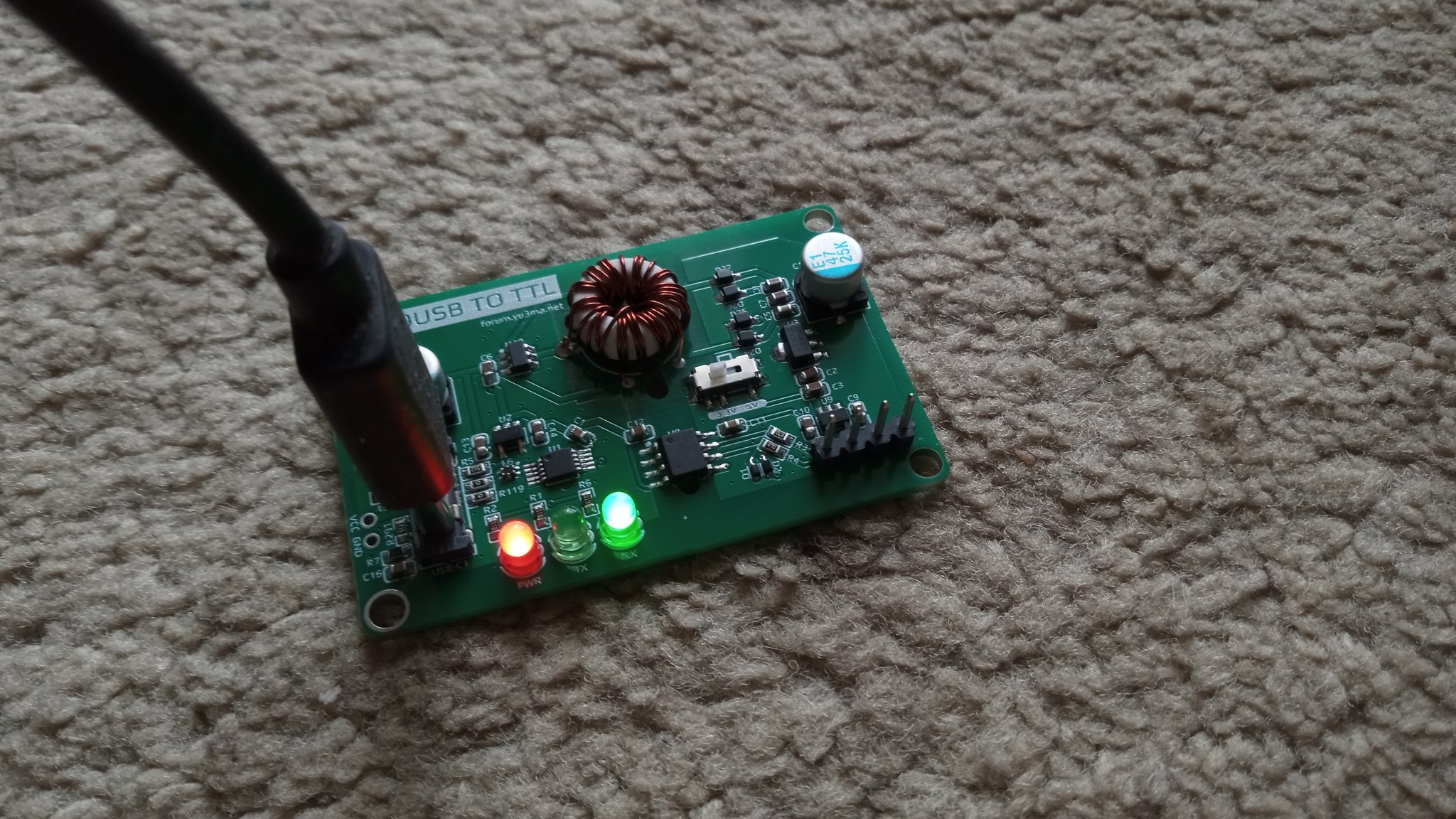

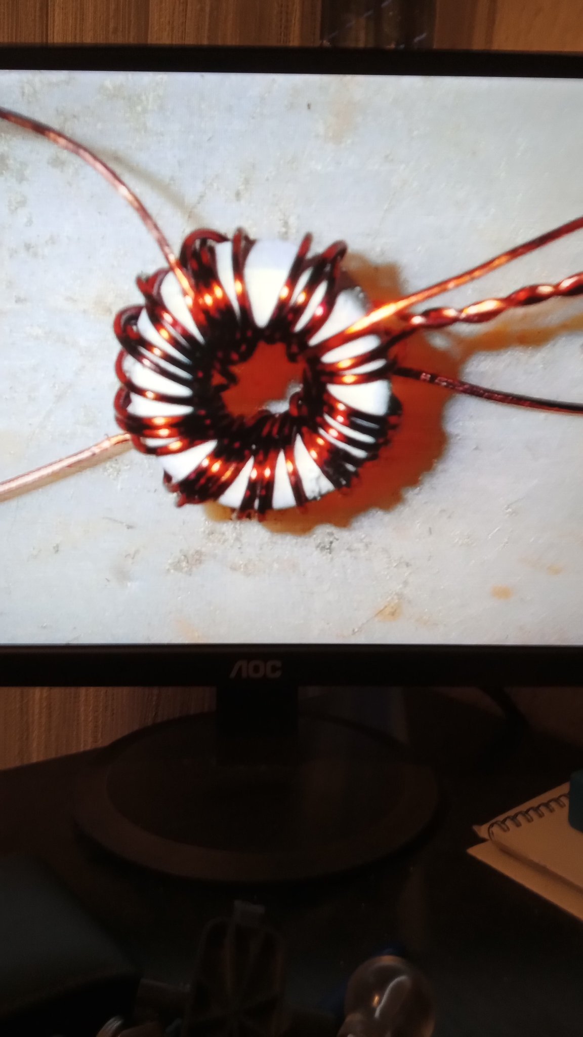

Isousb and isousb to ttl success! Got some problems with winding iso transformer and finaly found the most good way for winding them to get nice eficiency, and now Iso push pull is capable to drive booth camera and led light, unbelievable! Postregulator for iso push pull predregulator is LT3045 for up to 500mA, booth pcb's works very stable and very nice, my hope now E1DA Cosmos ADC will not get problem anymore with ground loop and 50Hz isues so I will get clean measurements for booth further DDPD and UCD type gan amplifiers.

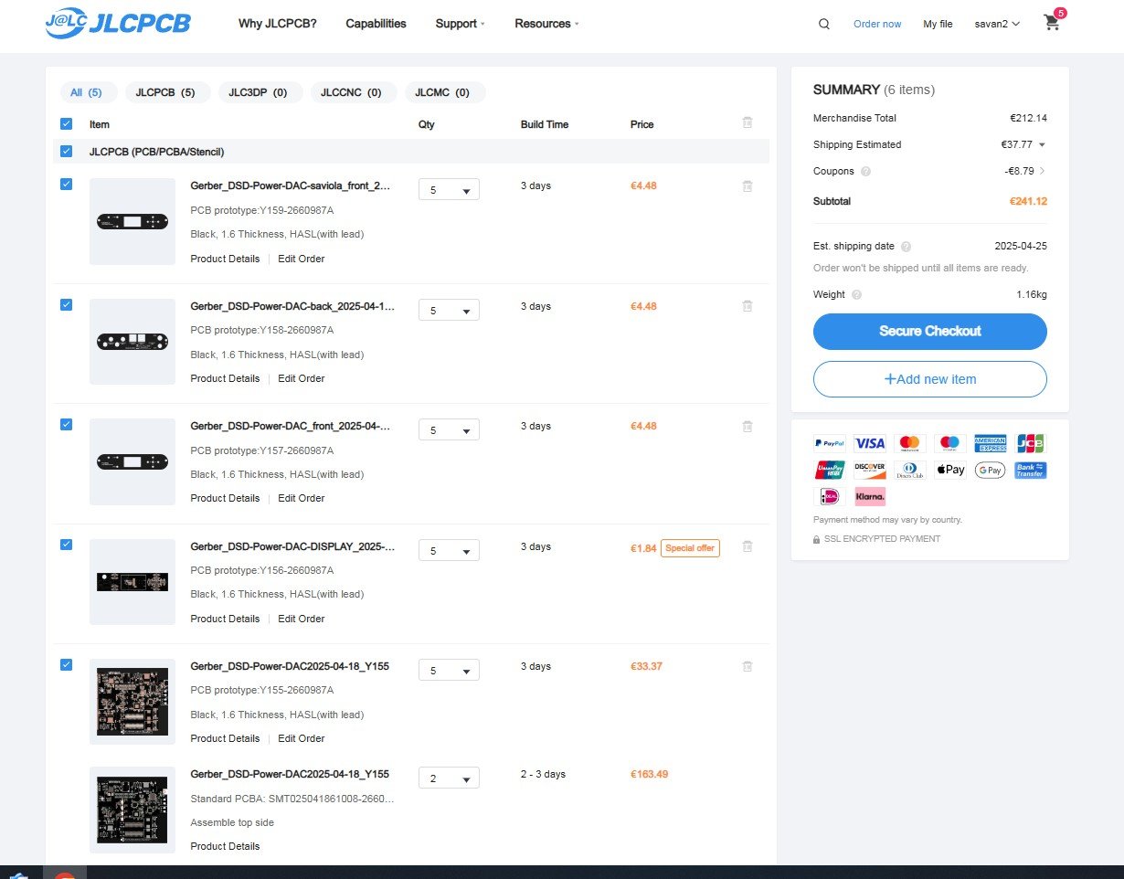

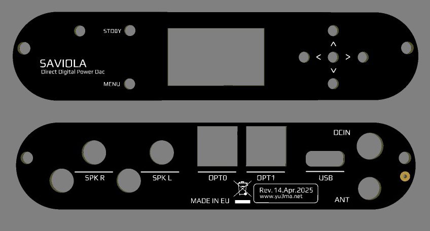

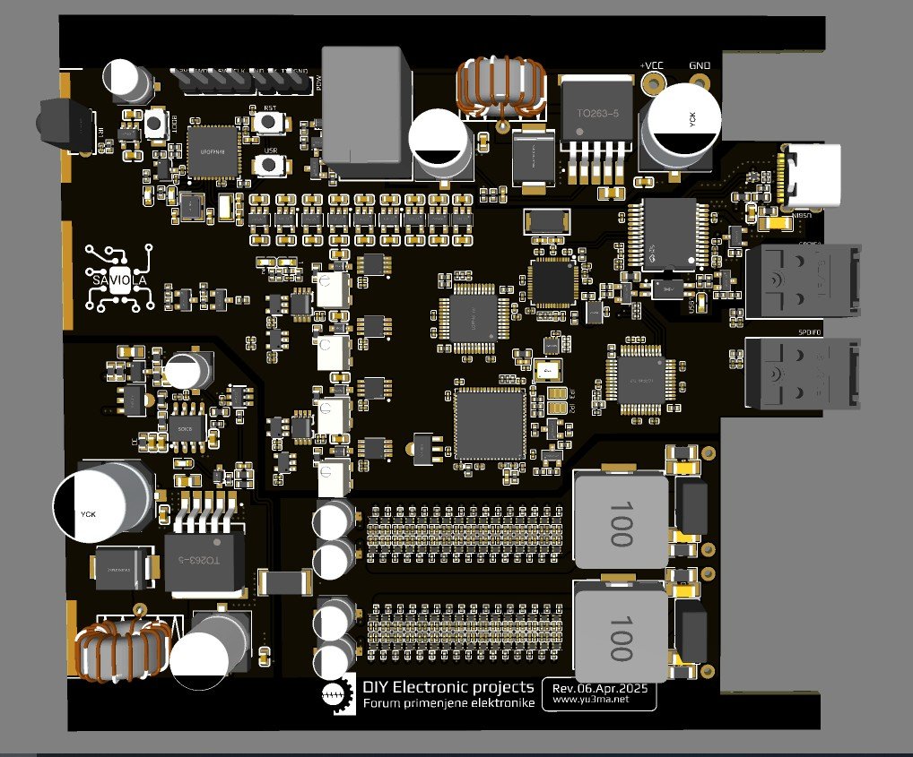

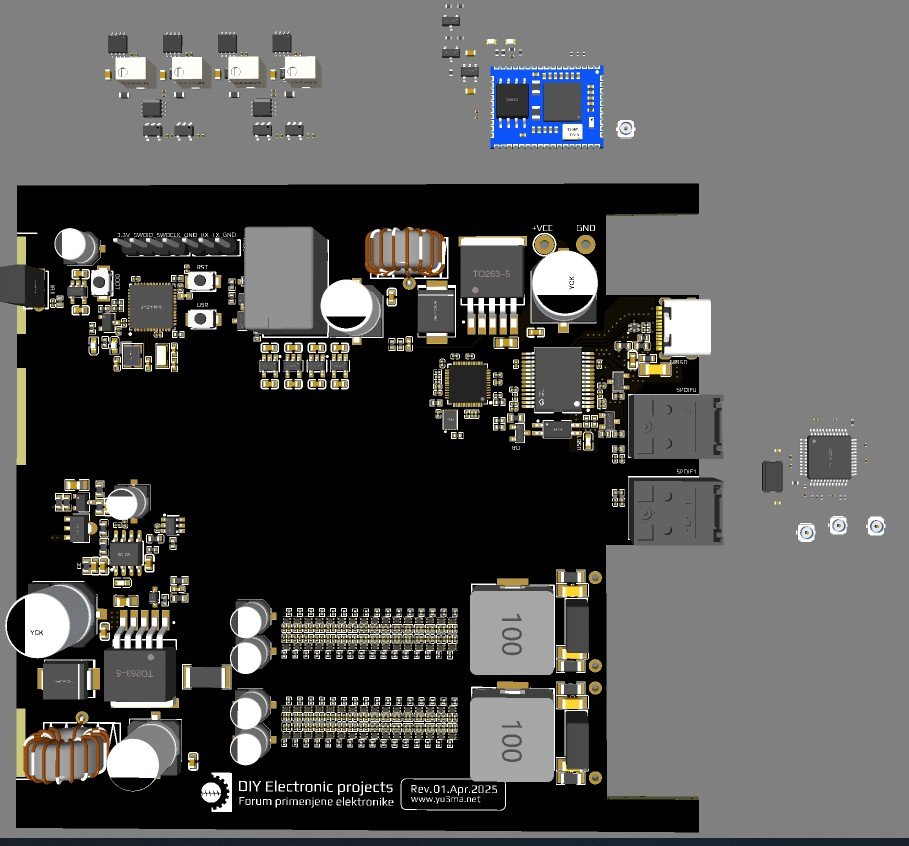

Until waiting for some missing components in relation to post #251 I'm redesigning mini DDPD which goes to the same enclosure -> https://www.diyaudio.com/community/threads/direct-digital-power-dac-ddpd.395974/page-4#post-7508606
But now this small DDPD will contain two optic audio inputs, one usb audio input with isousb211, bluetooth audio, new tft 1.14" color screen, stm32, two ct7302 one for anything2pcm and seccond one for pcm2dsd, between two ct7302 is adau1462 dsp, master clock with tcxo and fanout buffer, remote control, variable power supply as a volume control... etc, this will be my main audio device when I finish them and probably I will sell some small batch for those who want it! This is some work in progress

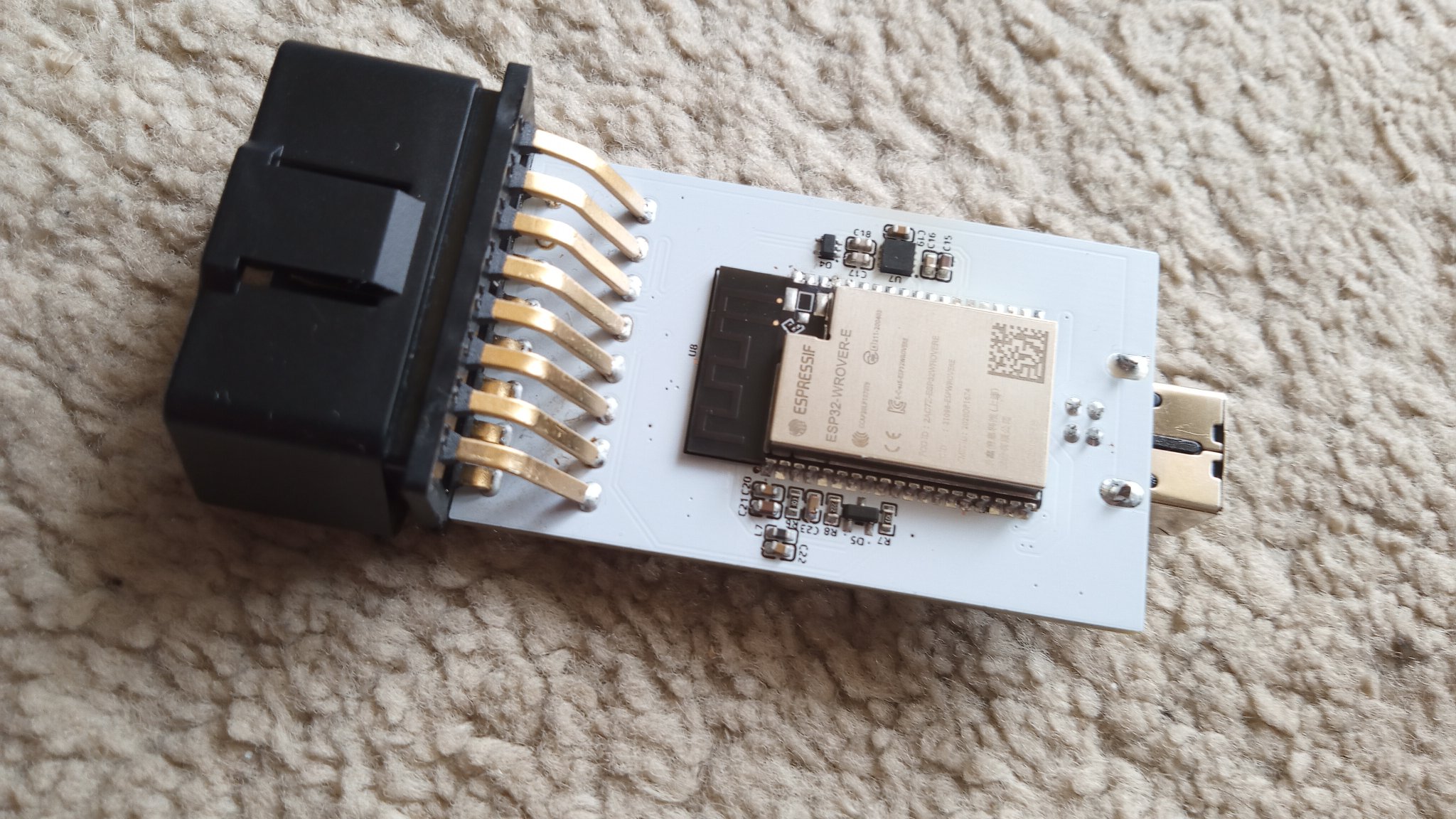

UCD type is on the hold util I buy some bench split supply, but in the spare time I continues to DDPD Mini, and aslo made some OBD2 tools for my Golf R tune : ) DDPD Mini is almost finished, few days and I think it will be ready for JlcPcb. Got better idea for front panel, instead of buttons, instead of rotary encoder I will do it with Jog Ball, its magnetic type and is long-lasting, easy to maniulate menu with it, the same time an nice ilumination can be done

Concept is allready fully functional! To be honest nothing I had in my home is close to ddpd concept in relation to instruments localisation and huge dynamic! In May concept ddpd mini v2 will be rady for testing, the next project is the similar but gan version. Linear power suplly is ok for mini version but in my opinion its not need at all. For further gan version I will think about an synchronised power supply to dsd freq, an gan based power supply with tracking and pfc would be the best option. Gan concept minimal voltage is 0V as it have their isolated 12Voltages, for mini minimal voltage is 1.5V, but mini concept v2 from picture now have two optical inputs, usb, bluetooth, color tft, pcm2dsd, dsd2pcm, dsp, and price is increased a lot. This on picture is 2/3 of the material for two devices, When thing get developed I will tell the price for device for those who want to have one in their home. This one going as a main device in my home music.
