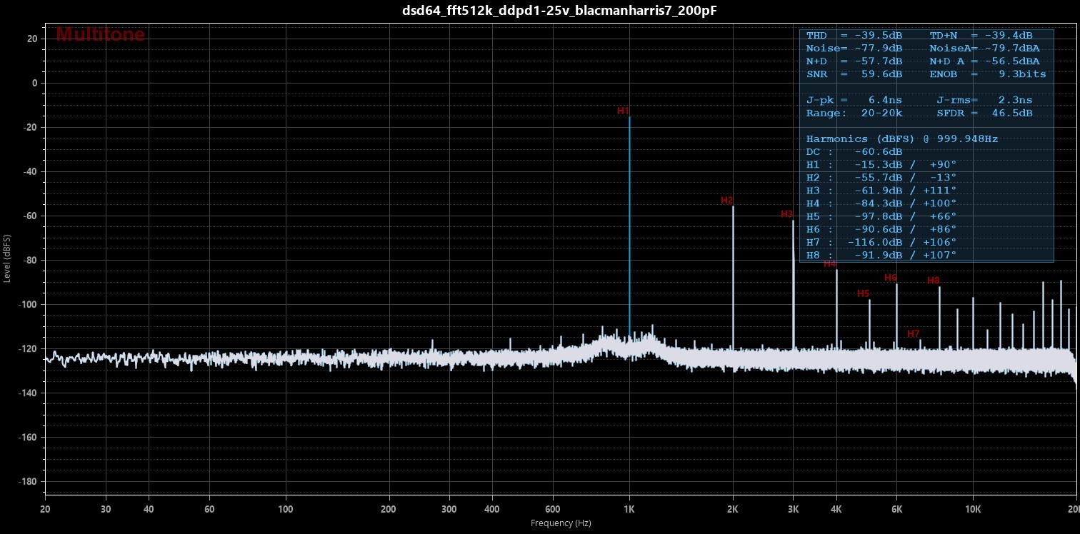

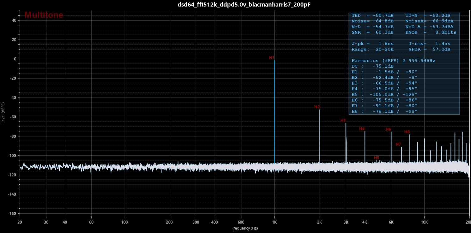

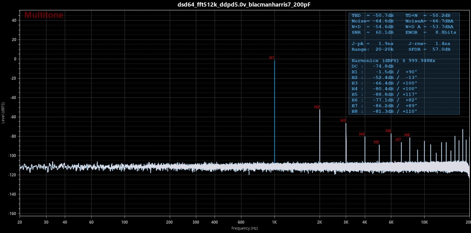

Measurements in post 149 is with dead time RCD network as per schematic from post #1 (100 ohm , 100pF) , now I have changed capacitor value to 200pF and this is a result. In your opinion which is beeter, with 100pF or with 200pF? Dsd64 and dsd128 is supported and recommended.
edit: added another ddpd5V 200pF sample (picture 2 and 3). In my opinion better result is with 100pF in high frequency end, but with 200pF a bit smoother but with a bit highr noise in high frequency end.
Its a fun exercise but we must be honest and say that it only achieves 8-9 bit of resolution. A CD has 16. A simple DAC and a simple class-d amp will have much lower noise and distortion at 10x the power.
I agree! It's a fact, measurements have shown it without error. The subjective feeling is different, the sound stage is realy huge. I will continue tests on https://www.diyaudio.com/community/threads/ct7302pl.357501/page-5, currently I'm waiting for two month Aliexpress CC,CV SMPS power supply and I will need to modify those ganFet concept a bit to be able to play music from zero volts, just few modifications is need
Mini ddpd on this concept have 32 gates per channel to form an average current with their own output resistor and it is quite possible that each gate has its own difference and not work idealy at the same time. I'm believing ganFet will get much bettr measurement result. The sound would be subjectively not much diferent. I will open ddpd mini v2 opensource, probably I will not sell mini ddpd product, sorry to say that, 250eur is a lot for this with a fact of high measured thd, and I can't sell for less. I will continue on something with better measurement result with a lot of more power. If you need ddpd mini v2 I will put gerbers, schematic and things on this thread for those who need one! JlcPcb can solder things for you with a resonable price. In day or two V2 will be fully open source! I think it's fairer than if I sell to someone for 250 euros so that they are not satisfied at the end. I will put my focus on ganFet ddpd, its on hold for almost one year, I will modify those pcb, will remove MAX flybuck and put something better, an simple push pull which will not give me noise problem as I have using MAX flybuck. The seccond thing will be to ganFet make half brigde independent, right now it was designed to share their +HV and PGND with MAX flybuck, and I had problem with noise. Frontent is also on hold for almost a year, I have received all the pcbs and things, just need to solder them. It will be ideal for further experiments. : )

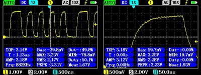

Stay tuned! I think I found cause of high thd and resolution lost, my diy amanero is bad definitelly, see how bad square wave it have, its the 10x our ddpd mini dead time and thats why ddpd mini have only 9 bits in Multitone : )

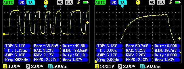

The strange thing DATA pin on amanero is so short and there is no capacitors at the pin, its realy strange why square wave is that bad, do you have idea? It have almost 100ns propagation delay, very strange!

It looked like the square wave was just HF limited - i.e. rounded on the falling edge... might be your scope also - what analog bandwidth is it?
Have you checked the series termination resistor (R2)? It should probably be less than 100ohms. Does the square wave look the same on CPLD side of R2?
I didn't, resistor is 47 ohm in design, but I didn't checked its real value, thanks for pointing me that out!
edit: I just checked it by unimere, its definitelly 47 ohm.

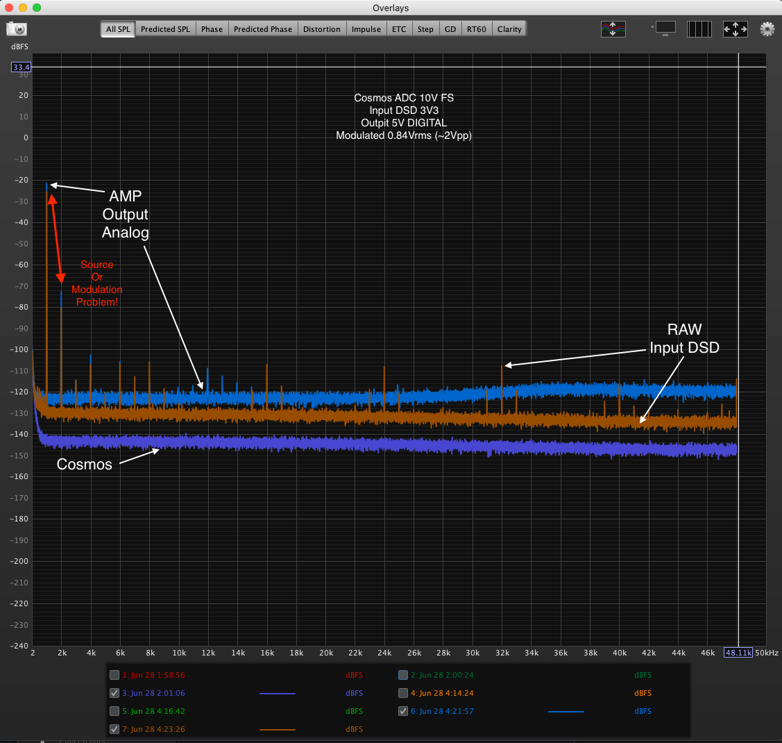

Hm this old picture shows modulation problem, in our case my colegue measured ddpd some months ago but also nobody measured the source of problem hmm seems the only problem here aka my diy amanero : )

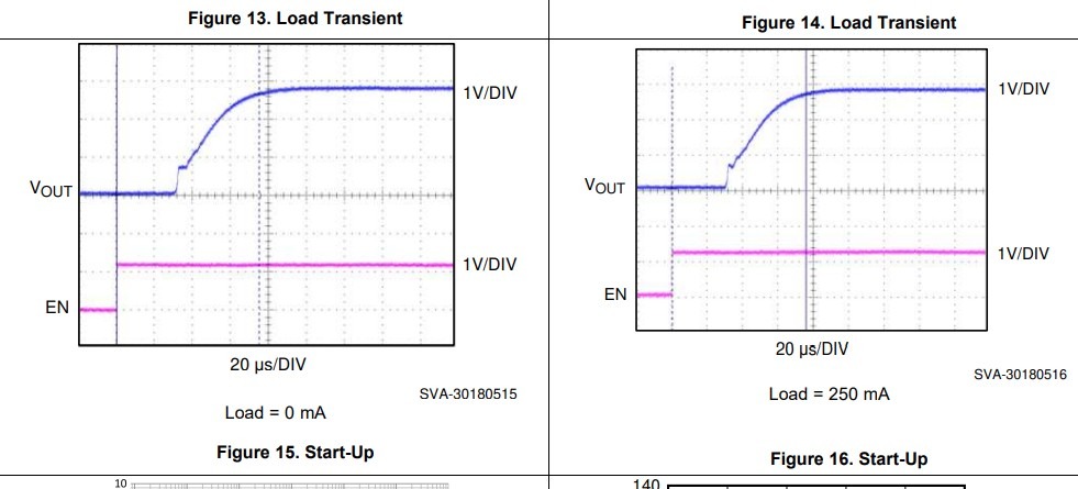

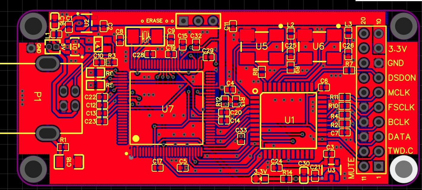

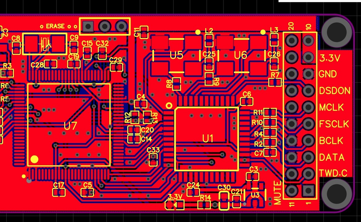

U2 on our diy amanero design is LP5907MFX-3.3/NOPB and U2 also supply that U3 and all the things here, migh be that U2 is simply not enought to supply all the things here? OMG! : ) Looks like square wave I have got seems nicely track figure 15 and 16. I will try to add some big boiler capacitors to the 3.3V line for next test
LP5907 has higher output current than ADP150 so that in itself is probably not the problem. Have you measured the Amanero data line when it is not connected to your amp board?

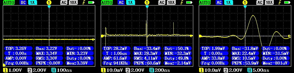

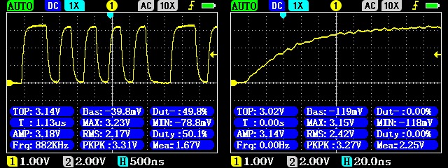

Yes, amanero is measured when no load at DATA pin! Also I have measured 3.3V line on amanero while amanero play dsd track, LP is definitelly ok! Picture 1 is while amanero is play dsd track,, measured on 3.3V line. Picture 2 is when I added an boiler capacitor 2200uF to 3.3V pinout of amanero, notice no changes on DATA out square. Hmm than what migh cause bad square wave I have realy no idea : ( Might be that cpld track clock source wave? I don't think it work that way on amanero. Osciloscope definitelly is able to display 10ns with no problem, notice around 150ns propagation delay on amanero data out pin when no load is there, 150ns rising edge and 100ns failing edge, this is realy strange. I will try to add some resistor load next day to data out pin!

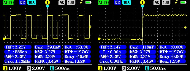

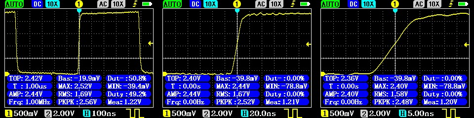

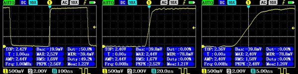

I'm sorry for wasting your time and this whole page! The truth is my probe x1 displays it wrong, its almost ten times the wrong from the real. Probe 10x looks ok, after calibrating it its close to +-10ns error, and this is the truth about my amanero after calibration and switching probe to 10x . Picture 1 is calibration process and seccond picture is measured amanero square wave. So Amanero is ok!
