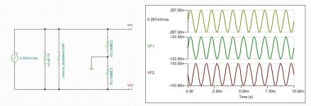

Simulation result shows that when Cosmos impedance is added to my attenuator attenuation is 89.325 times : ) so 1.49Vrms / 89.325 = 16.6mVrms = -35.6dbFS , but my attenuation is probably a bit more so what I got in Multisim around -40db is seems a right value! Thank you so much dkfan9! I think I will stop measurements until frontend get finished, have no sense measuring attenueated small signal while Cosmos is switched to 1.7Vrms, other than that have no sense measuring things without attenuator & while usb isolators is missing for booth Amanero and Cosmos, that way I have ground loops trought my PC.

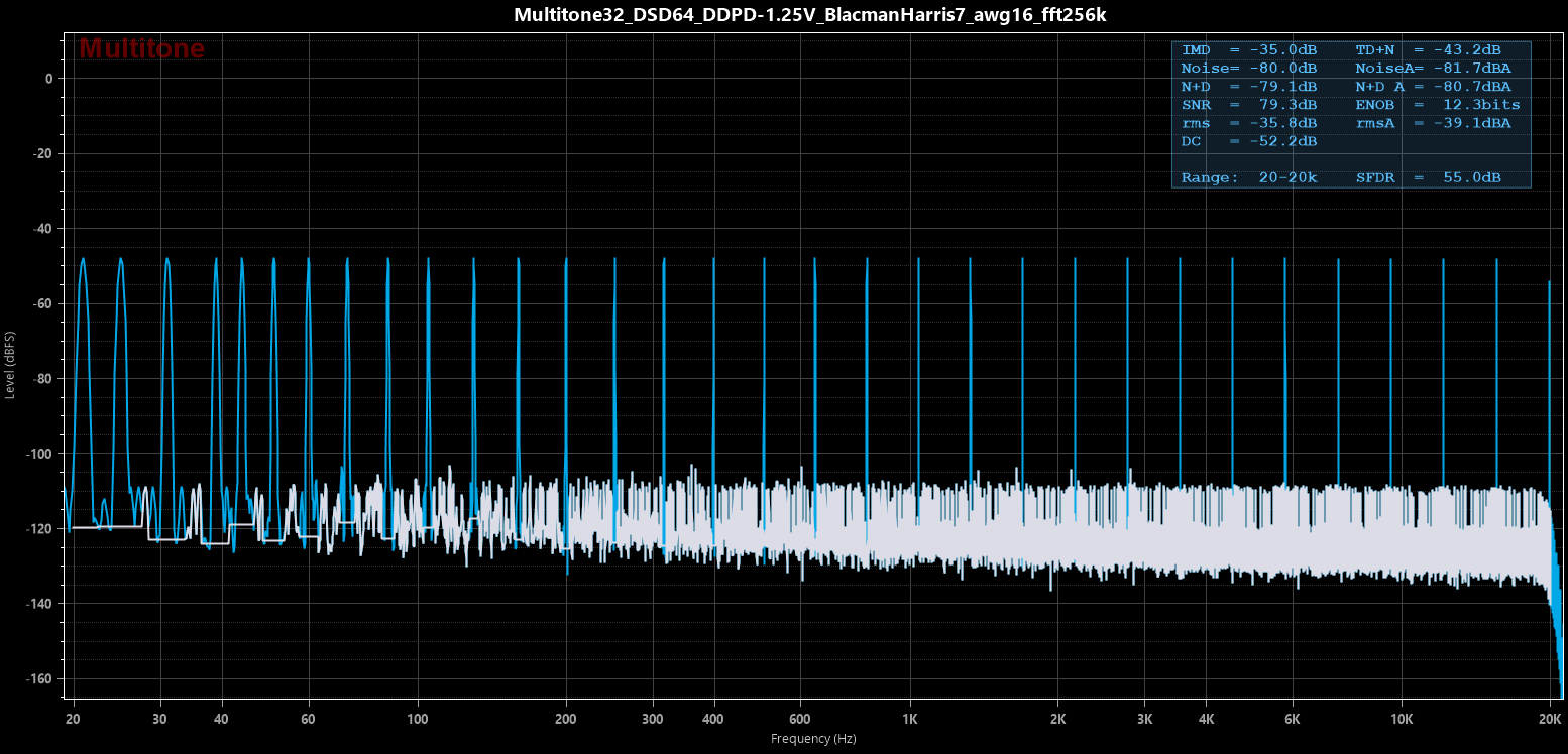

DDPD=1.25V --- 450mVrms when no load --- 309mVrms while 10 ohm load --- = 4.56 ohm output impedance

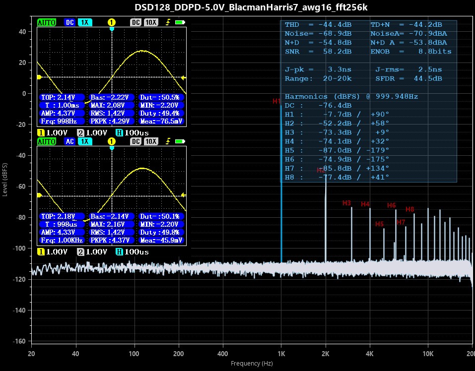

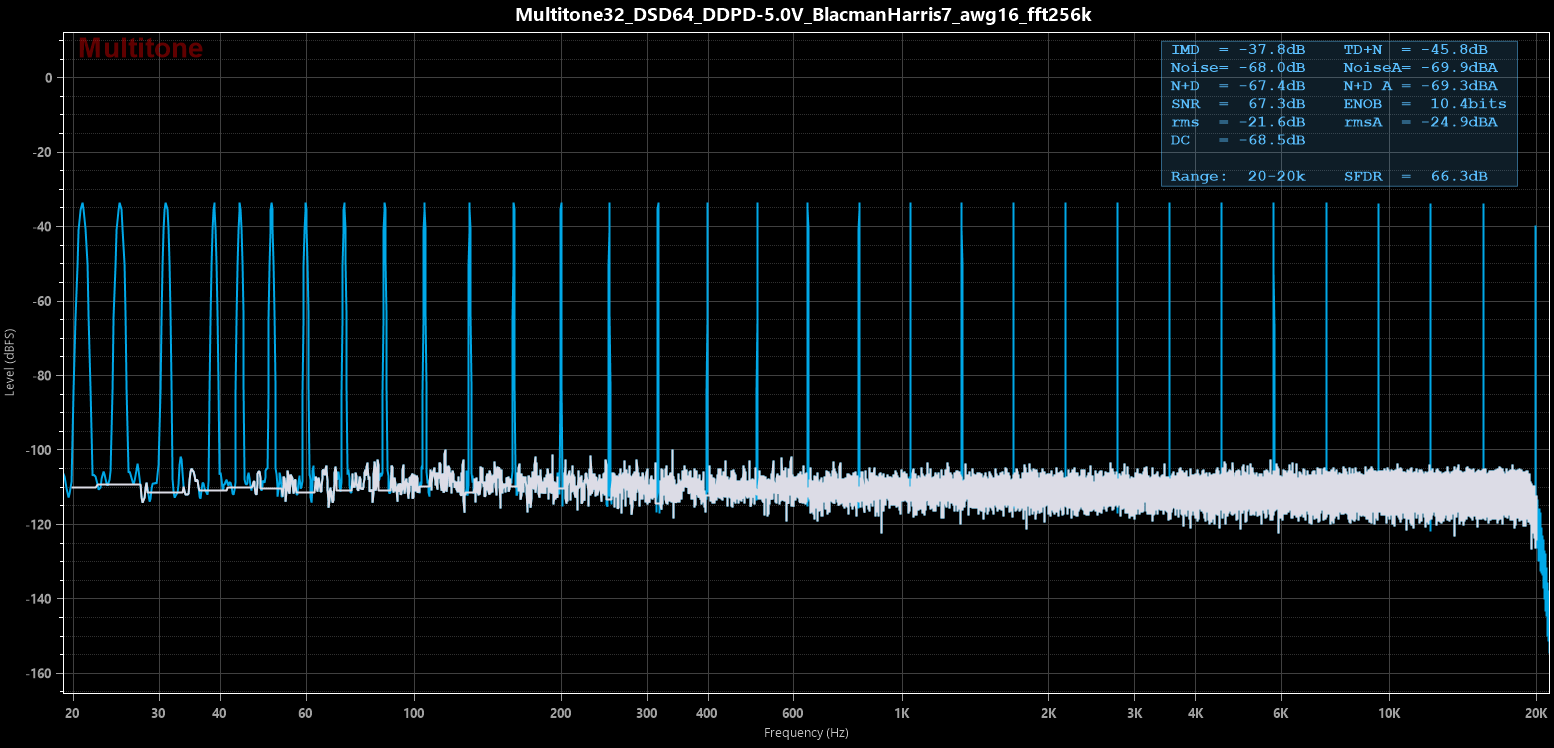

DDPD=5V --- 1.77Vrms whwn no load --- 1.53Vrms while 10 ohm load --- = 1.57 ohm output impedance

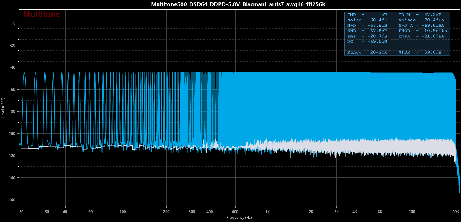

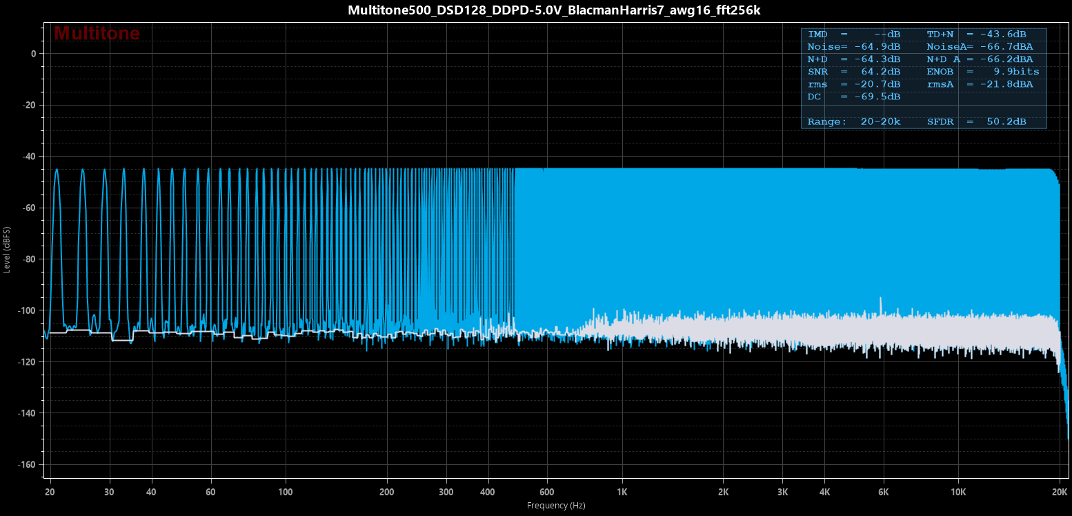

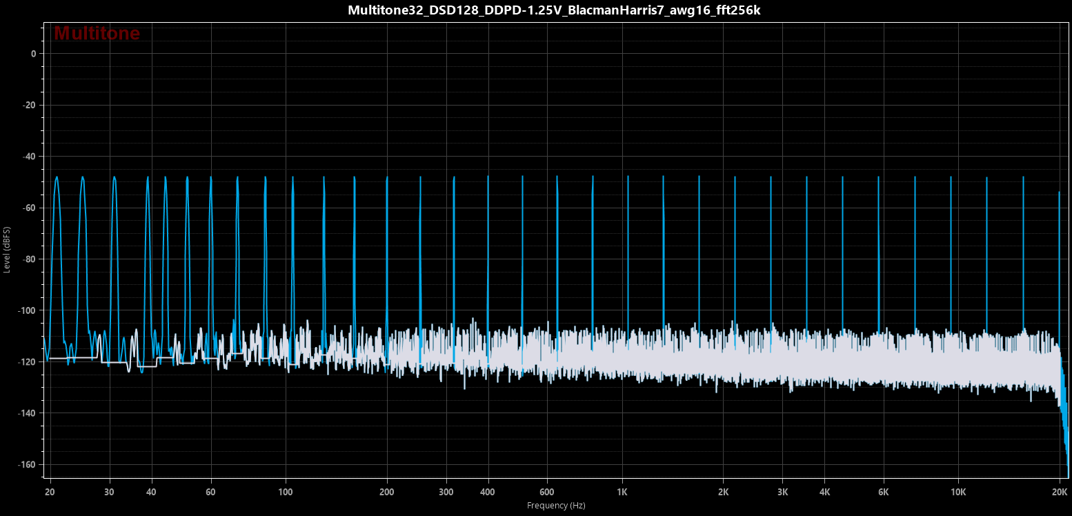

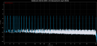

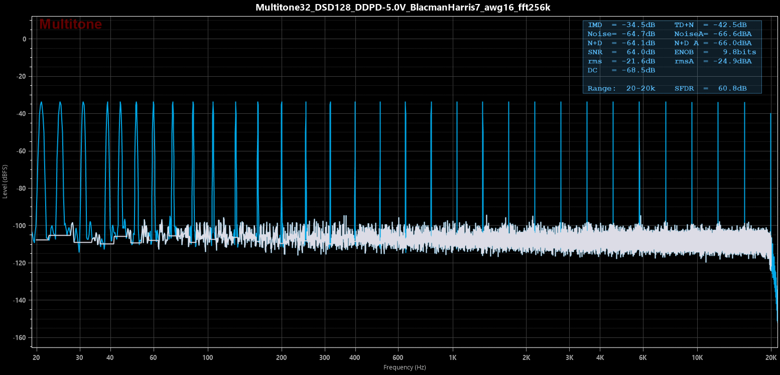

I'm tried dsd256 and results is not good, maybe because of fixed dead time which is now around 10ns. This DDPD right now is capable only to dsd64 and dsd128! I will play with dead time adjustement, maybe I get some better measurement results, in the same time maybe even dsd256 and up get working! Deadtime maybe is not need at all? I will focus on DSD64 and try to find right and optimal dead time, next day!

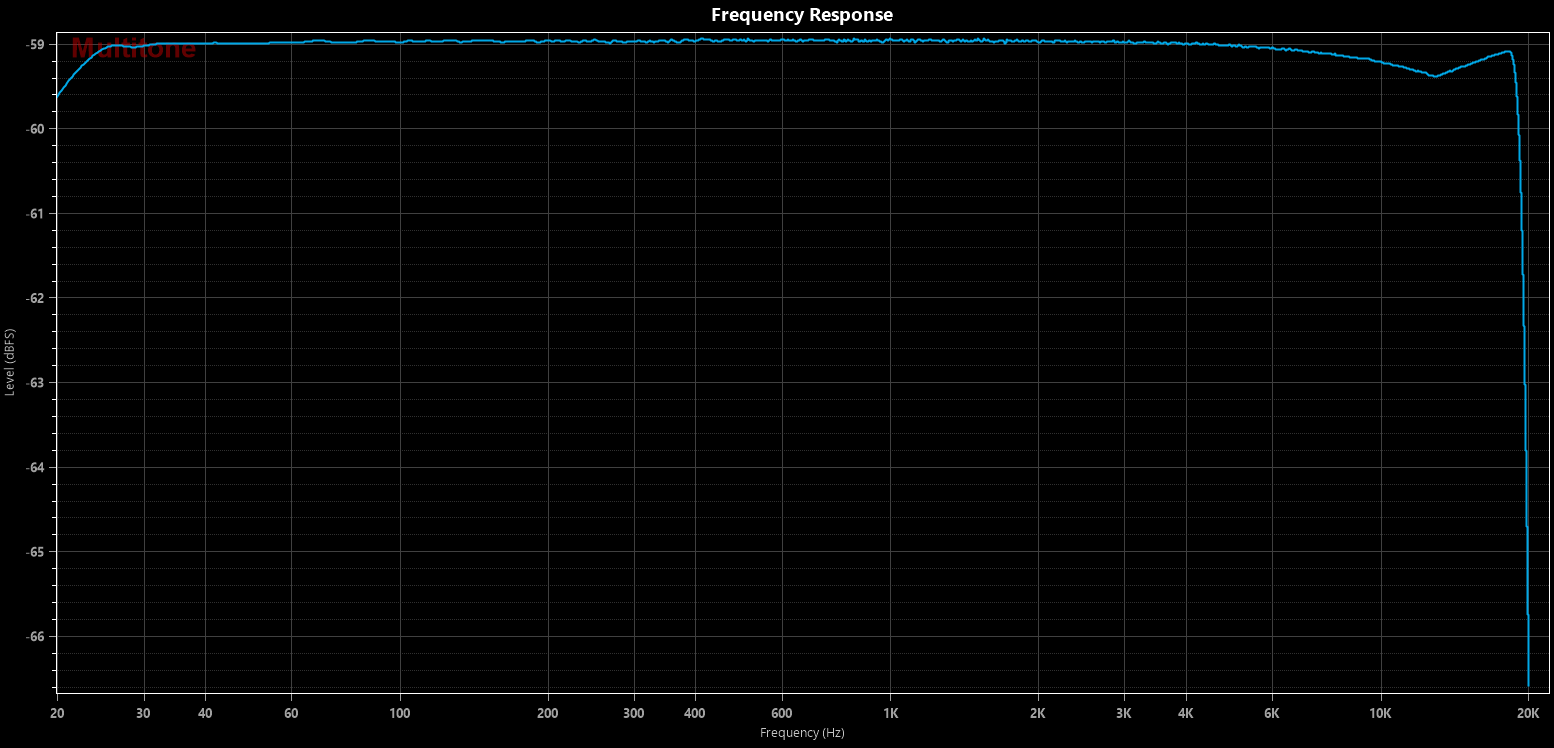

First 4 pictures contain booth Multitone result and also my hardware osciloscope measured at load resistor. My measurements:
Multitone32_DSD64_DDPD-1.25V_BlacmanHarris7_awg16_fft256k.png42.5 KB · Views: 93
Multitone32_DSD128_DDPD-1.25V_BlacmanHarris7_awg16_fft256k.png36.3 KB · Views: 94
Multitone32_DSD64_DDPD-5.0V_BlacmanHarris7_awg16_fft256k.png37.7 KB · Views: 88
Multitone32_DSD128_DDPD-5.0V_BlacmanHarris7_awg16_fft256k.png39.8 KB · Views: 84

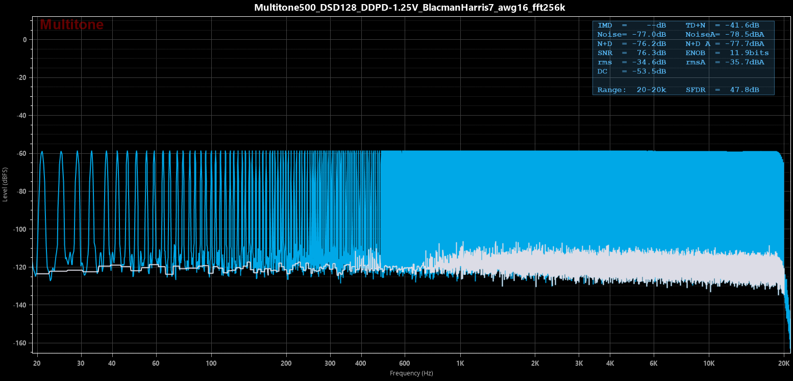

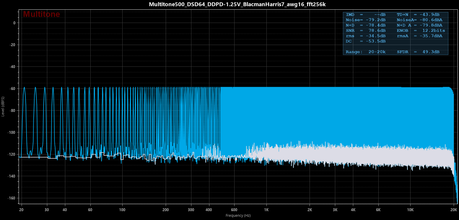

Multitone500_DSD64_DDPD-1.25V_BlacmanHarris7_awg16_fft256k.png44.1 KB · Views: 83
Multitone500_DSD128_DDPD-1.25V_BlacmanHarris7_awg16_fft256k.png43.9 KB · Views: 79
Multitone500_DSD64_DDPD-5.0V_BlacmanHarris7_awg16_fft256k.png41 KB · Views: 85
Multitone500_DSD128_DDPD-5.0V_BlacmanHarris7_awg16_fft256k.png41.4 KB · Views: 87

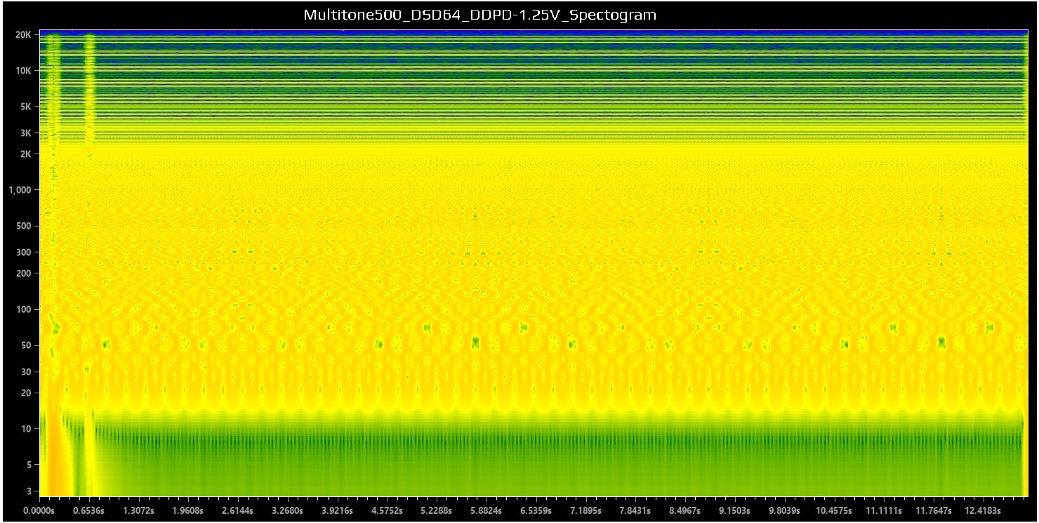

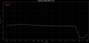

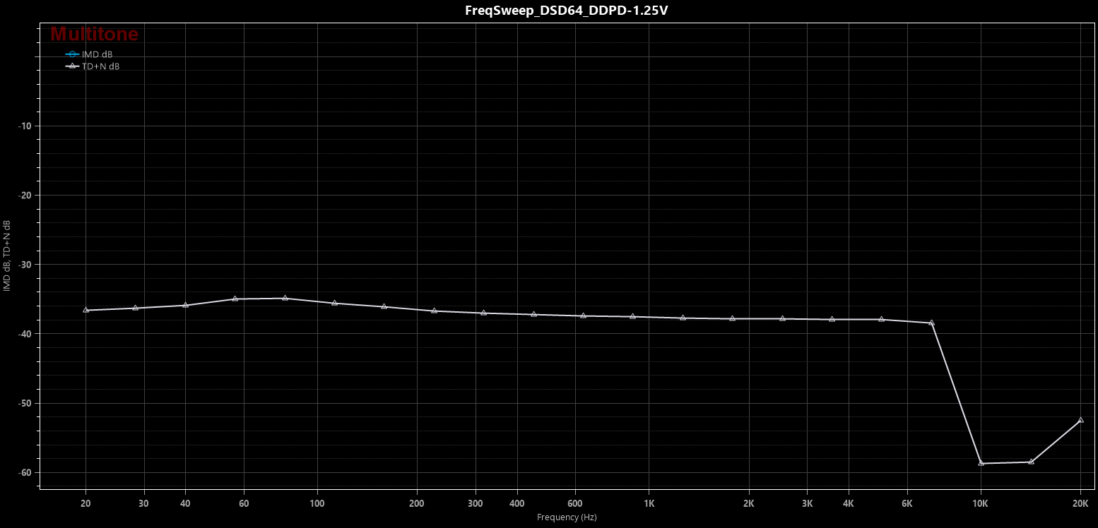

I have found also twisted wire pair from-to dut gives diferent result, I have used twisted wire as a better result. Also to note, my Amanero is diy, it didn't play dsd512, might be that my Amanero is not good at all. Also count hacked SMA connectors from ddpd to Amanero, Amanero have clasic pins and my ddpd have coaxial SMA, wire from-to ddpd-Amanero is hacked, on the one side is sma on the other side is pins, its not an optimal interconnection. Final measurements when frontend get done and when all the things get corrected. : )

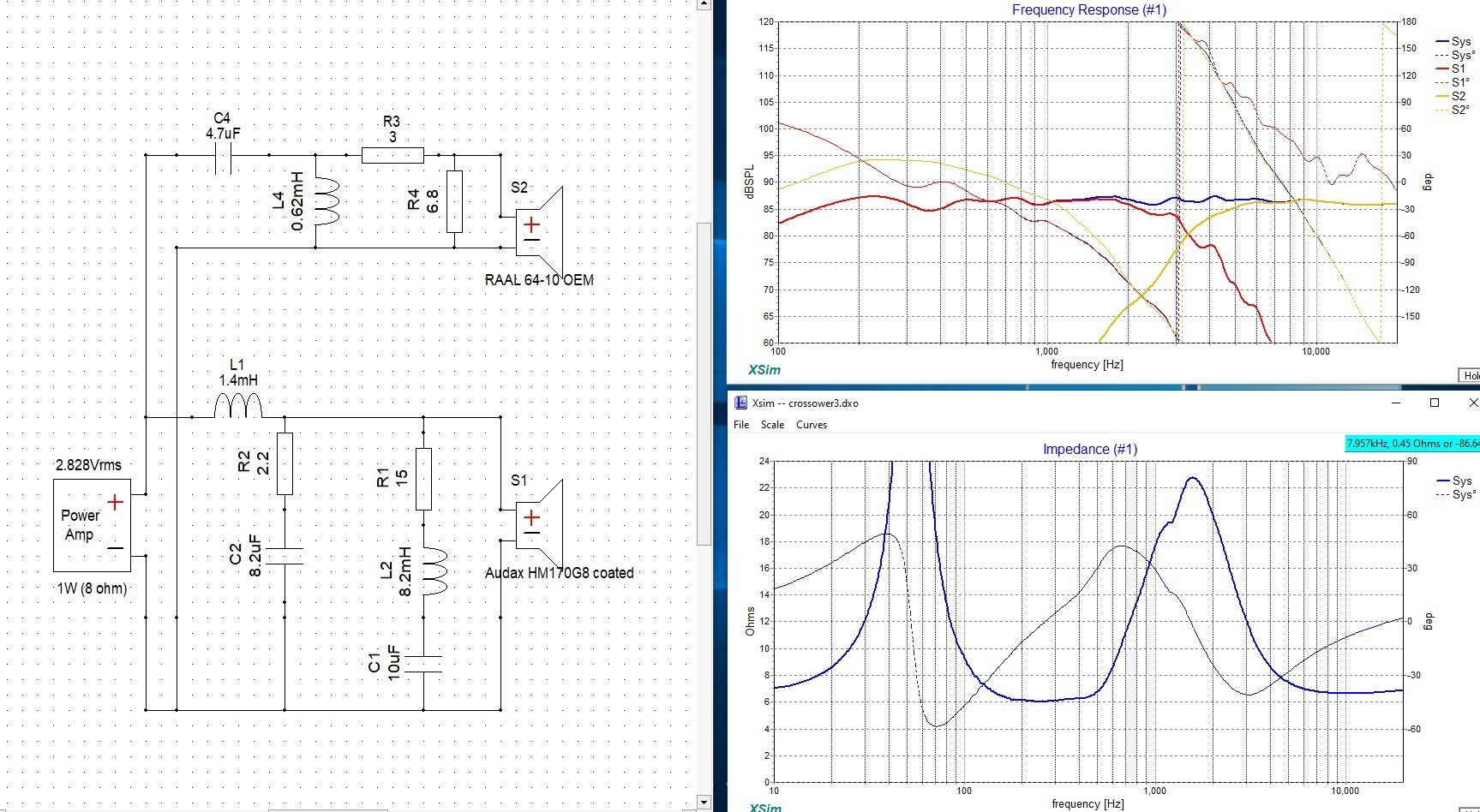

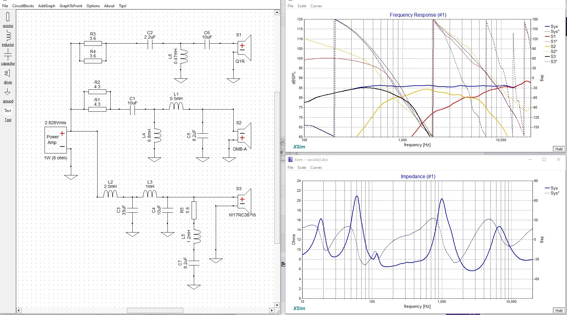

I don't know how it is calculated. When ddpd is on 1.25V the volume level in my room is allready loud and need to adjust volume by sw, when 5V its very loud, I'm believing 2x 3Wats it have. My speakers is 8 ohm.What output power do you anticipate in 8 ohm?

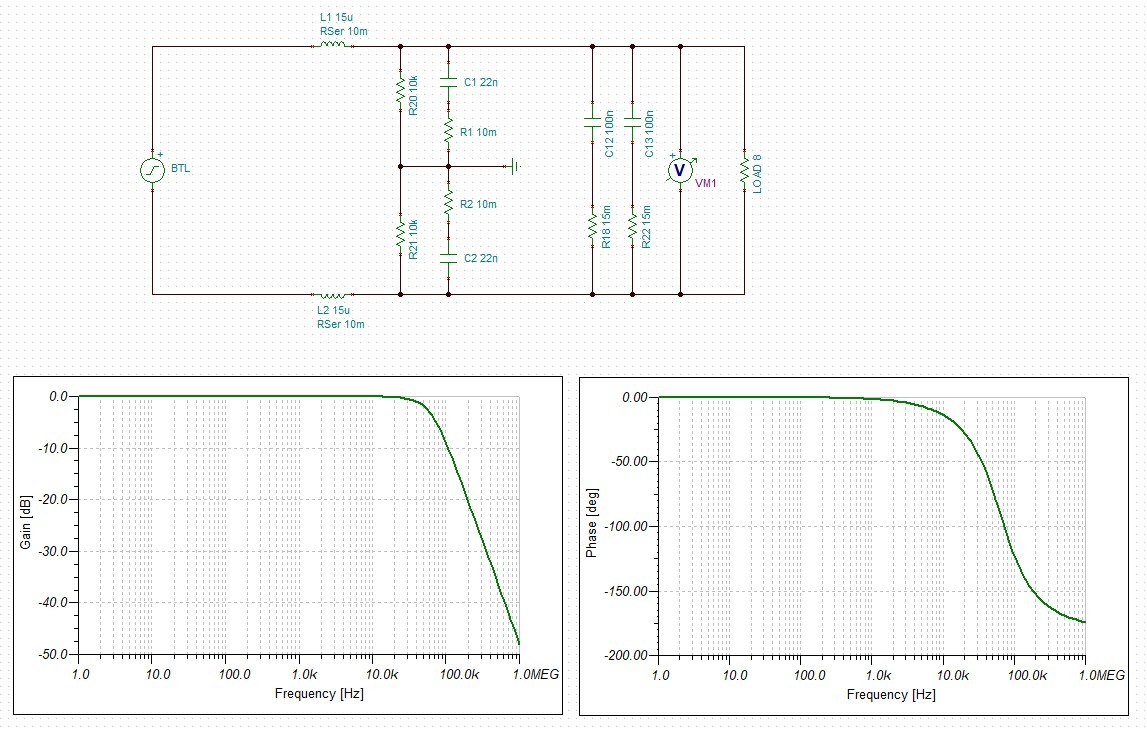

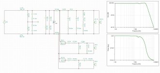

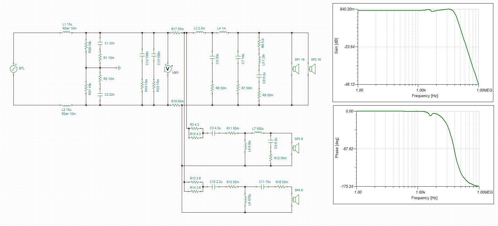

BTL filer used on DDPD, booth simulation with any 8 ohm load and also simulated specialy with my speakers : ) Booth sound amazing, expecialy one which have Raal, attaching boot schematic of my speakers collection, booth is transmission line, designed for my room and listenning position. Ye video from first post is recorded while ddpd sound trought speakers with with Raal, you can hear how it sound booth with an good headphones, recorded not with an good recorder but with an android phone, dynamic can be heard if nothing else. : )

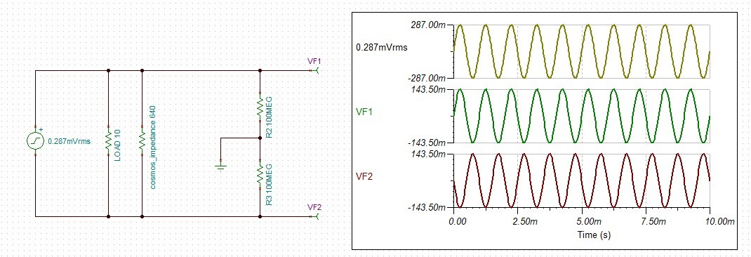

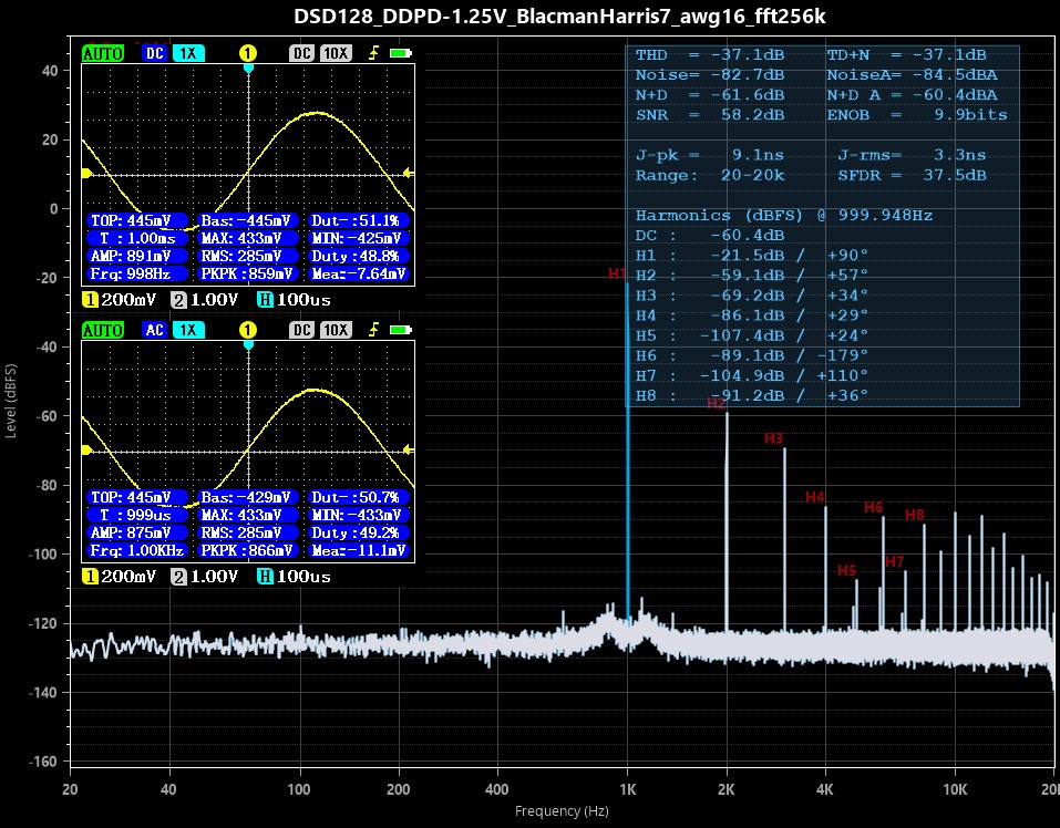

Measurements from post #129 is still wrong! I have no idea whats going on right now, probably Cosmos have some sw setting to be adjusted? Also the impedance at the Cosmos input (640R) has no influence on the measurement result because the current flowing through it is negligible compared to that flowing through the load.Is the 65mV reading with Cosmos connected or without? Just a quick look at the attenuator schematic, 2k output impedance and Cosmos' 640 input impedance is a -12.3dB voltage divider. 64mV is -28.5dB ref 1.7V. Throw in some tolerances and -41.2dB is the right number.

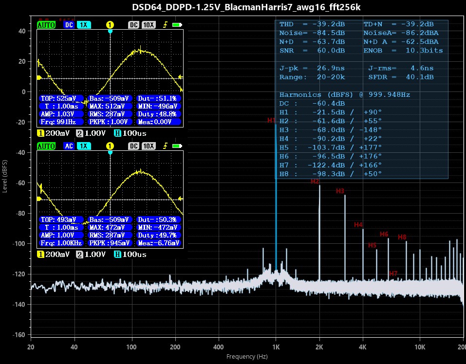

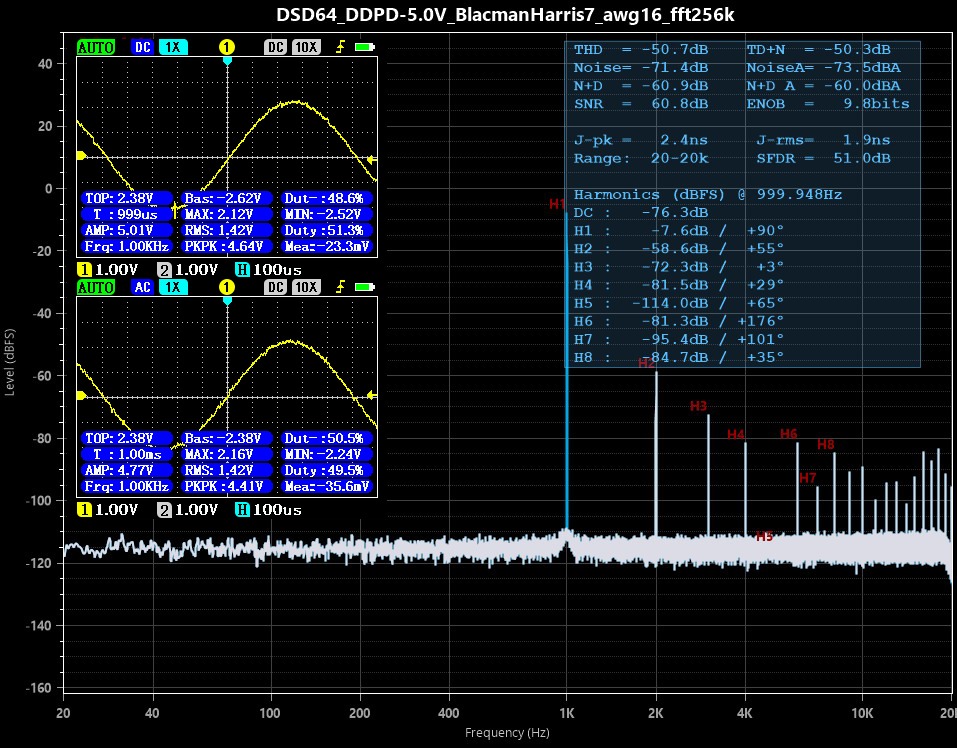

However, the voltage measured by the oscilloscope at the output of the ddpd does not agree with the one seen in the spectra.
For example, in the first spectrum, the oscilloscope shows 287mVrms, and H1 is at a level of -21.5dB ref. 1.7Vrms (Cosmos range), or 143mVrms, which is exactly half of 287mVrms. I'm checked xlr cable and also by multimetre gnd position inside cosmos xlr, all is right here. What might be isue? Looks like cosmos see this as a single ended. Does cosmos maybe have something in their sw configuration in relation to SE/DIFF ?
Nothing SE/DIFF in the Cosmos. Only stereo / mono...

Please take a look at this picture, notice osciloscope Vrms measured diferentialy at the load resistor, I have measured it 287mVrms. Now look into H1 , notice -21.5db, thats half of my osciloscope measurement! So all measurement I done is invalid because something is wrong here. Looks like cosmos see my diff outpur as a single ended. Also spectral analise shows some iregualities at first 1 seccond. Something is wrong in my measurement setup and I have no idea right now what. Somebody say that Cosmos starts in the so-called Mono mode, which means that the signal must be fed simultaneously to both of its inputs, which achieves a 3dB noise reduction. If the right input is empty (as like in my case), then the result is half the voltage of the left input and this is most likely the cause of the error. I realy have no idea how to connect Cosmos with my ddpd.
Cosmos isnt an absolute voltage measuring device. If you want to use it as that you need to calibrate it to 0dBfs. You figure "21,5db" is just a relative number - it doesn't mean anything in the real world.
To get Cosmos to be an ordinary Stereo ADC, you have to set the "Volume" (I know, strange, but thats how you do it) in the program that you connect to Cosmos with to zero. You will see the LEDs on the front blink green when you have entered stereo mode.

MONO/STEREO modes are switchable by the UAC2 volume commands, for example, if your Windows volume slider position is less than 50%(0 to 49%) the device works as 2 channel ADC, if more than 50% it is a MONO ADC with summed Left+Right inputs mapped on the Left channel(Right input is always mapped to the Right channel). In the MONO mode, both channels need to be tied together L+ to R+, L- to R-.

Looking at the performance of your DAC I dont think at this stage you need to optimise on the last dBs but rather on getting your measuremnts up in an orderly fashion. This means just one channel, using it in Stereo mode.

You're correct, now that you have the filter out of loop, the Cosmos input impedance is irrelevant. Based on the manual snip you posted and @TNT's experiment, setting volume below 50% should fix your 6dB loss. If the Cosmos is currently working in mono mode and you have only one channel hooked up, it's presumably averaging the two channels, one at 287mV RMS and the other at 0 and registering the digital equivalent of 143mV RMS at the ADC output. (I hope that makes sense)Measurements from post #129 is still wrong! I have no idea whats going on right now, probably Cosmos have some sw setting to be adjusted? Also the impedance at the Cosmos input (640R) has no influence on the measurement result because the current flowing through it is negligible compared to that flowing through the load.
