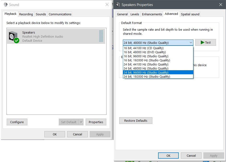

If Multitone uses Windows default sample rates, then set it in Windows Control panel to the sample rate you want to use:
The green circle on the left with the white checkmark is not good. That indicates Windows has assigned the device to serve as a Windows default device. As Bohrok2610 said, better to assign some unused sound device as the Windows Defaults. Then Windows is less likely to mess with the sample rate. However, if you plug the sound device into a different USB port then Windows may assign it as default again. So you have to keep an eye on that.

Multitone does not use Windows sample rates with DSD/DoP signals.If Multitone uses Windows default sample rates, then set it in Windows Control panel to the sample rate you want to use
