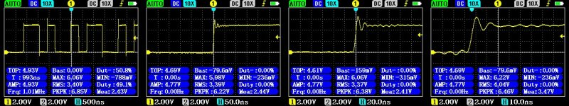

I'm sorry for wasting your time and this whole page! The truth is my probe x1 displays it wrong, its almost ten times the wrong from the real. Probe 10x looks ok, after calibrating it its close to +-10ns error, and this is the truth about my amanero after calibration and switching probe to 10x . Picture 1 is calibration process and seccond picture is measured amanero square wave. So Amanero is ok!
A x10 probe on x1 setting has much less bandwidth as its not compensated correctly to match the cable and load. Probe cables have significant resistance to allow critical damping in x10 mode - however this breaks the x1 performance - its very unusual to use a x10 probe on x1 in practice.
Thanks, yes I know, after some trials and errors I found that probe moved to x10 and also osciloscope internal switch moved from x1 to x10 gives ok result while booth is on x10, in my case while mesuring some freq result is good with error about 10ns only not bad at all. But while measuring something unrelated to freq the better result is while using x1 e.g. while measuring noise of something. At least in relation to my current pocket osciloscope : )
Sorry google translate... what I meant was, when I measure something trought x1 for example some small signals like few uV I can do it only trought x1, my osciloscope is pocket version and not allow me to do that on x10 precise. But situation is totaly diferent while I I want to measure frequency e.g. an square wave signal e.g. few MHz, see some posts in back what happened. While on x1 and while measuring frequency error is ten times worse than x10. So it is better using x10, and vicewersa when measuring small signals its better to use x1. Thats it about "better" : )

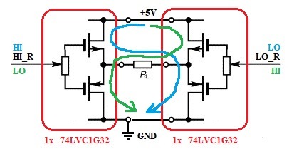

Idea for our ddpd come from that discrete dac, its very similar, in case ddpd we don't have d/a conversion based on resistors but directly d/a conversion at LC + speaker. LC filter in our ddpd mini is designed for 8ohm load, even I have put my speaker crossower parts into simulation to verify if LC is optimal, yes it was ok for booth simple 8ohm resistor and my crosover+speaker. Measurement was done without speaker but an 8ohm resistor, the things confirms that something is not good on mini ddpd and I'm believing single buffer for 8 paralel gates is simply an bad idea. Using two lmg5200, which each one have their own gate driver, in full bridge mode, and using an digital isolator for complementary hi/lo will make ddpd much better than ddpd mini. Power capability a lot more. And finaly an variable HV power suply as a volume control will make pdm source at full resolution bits. Volume level from 0V to 46V in comparation to ddpd mini which have 1.5V minimal big ddpd will work from 0V. I will start working on this till after I finish my old work by revised design https://www.diyaudio.com/community/threads/signalyst-dsc1.254935/page-111 and it will be my last half-analogue amplifier work, I will focus to ddpd.
Sorry my bad, one bufer is driving 16 half bridges in ddpd mini, thats definitely bad idea and probably reason for enob triple lost. I don't have free time right now to debug ddpd mini, soon I will try to desolder all the half bridges and put only two with one bufer to confirm this...

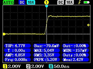

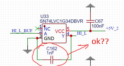

Got some free time to mess with DDPD, a lot of oscilations on pre-input or post-buff, to remind my bug was one buffer for 16 half bridges which is definitely my bad, and this is how things look, a lot of oscilations (picture 1). I have tried with 150pF but ended with 1nF and oscilations is drasticaly gone (picture 2), is this ok to have 1nF load capacitor on buffer out? Having plan to put 45pF on each half bridge input, that way it will form 1nF load for buffer. Looks ok?
