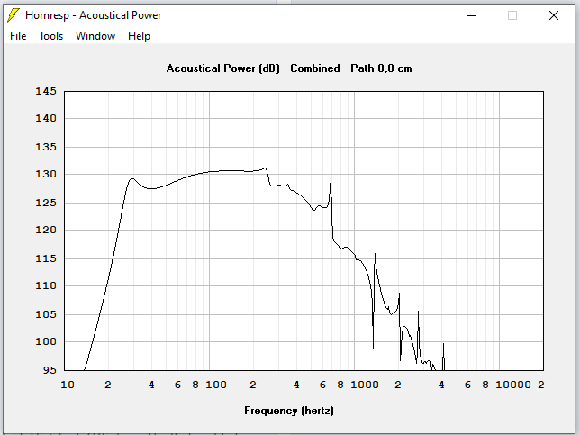

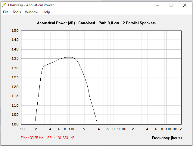

Ok Kaffi, 2 PRV 15SW2000 , if we use lets say the size of a srx828 can we hit 30hz?For 150$? Buy them before they go extinct! This is two per 266 liters:
You MUST have Aero ports with those drivers! And you need a 2KW output amplifier as well.
900W per driver.
Two of those boxes (4 drivers) go like this:
150$ each PRV 15SW2000 Clearance at PE is a lot of air shoving ability for the money.
How about an audio technical Encyclopedia?101 note book about this things
Audio calculations
Efficiency
Site search engine for so much more

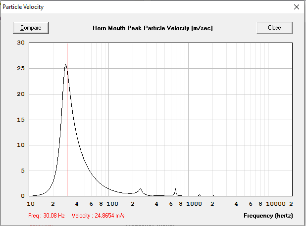

Those drivers are very hard to persuade to go lower in a good way, putting them in a bigger box at 330 liters or so and tuning it lower will make that particular hump more pronounced:Ok Kaffi, 2 PRV 15SW2000 , if we use lets say the size of a srx828 can we hit 30hz?
It is a bit on the edge of what a high FS + high QTS driver like that is able to do.

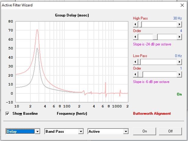

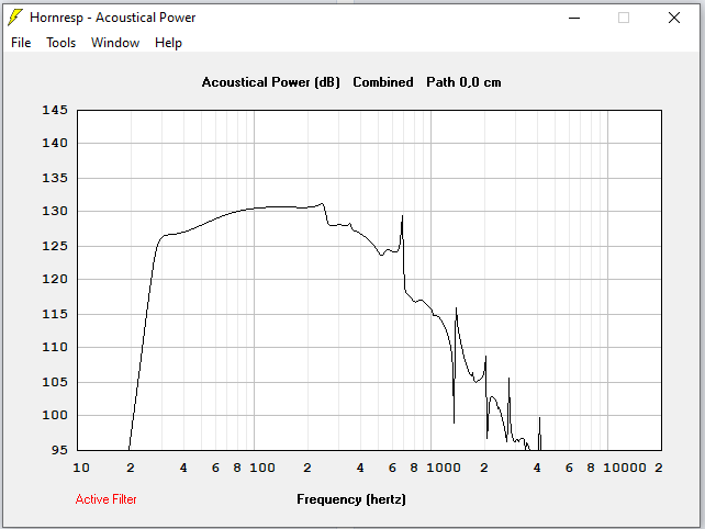

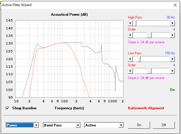

If we apply a 30Hz 4th order Butterworth filter at 30Hz we get this:
And as long as you apply the 30Hz HP you do not have to worry about chuffing either, it will be just about inaudible at this SPL, and 30Hz notes at full voltage are a bit rare:
Group delay will increase because of the filter, but it is still below 20msec at 40Hz so it is not noticeable.

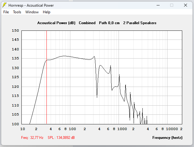

From 50Hz up it should be just about impossible to tell this box apart from a closed box, from 50 hz down you get a lot more SPL and compared to a Linkwitz Transform solution this bassreflex will have better power handling and much higher spl. The difference in group delay between this and previously mentioned closed box with LT would be negligible at best.

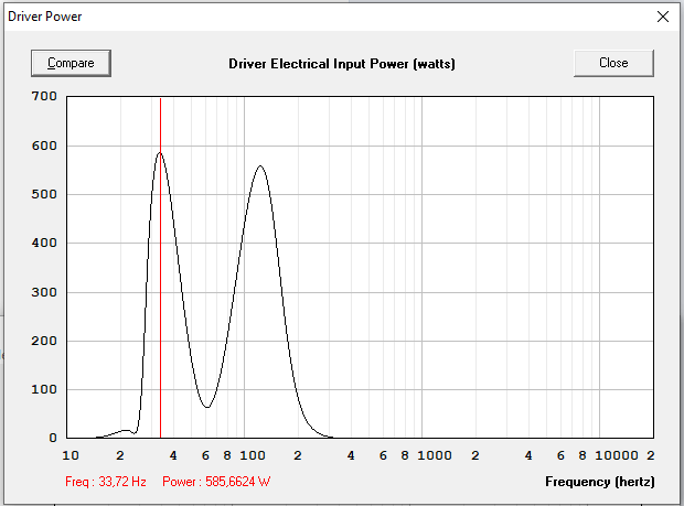

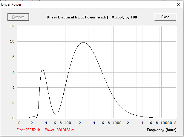

And driver power is around 600-1000 Watts at this level, so you need 2kW per sub.

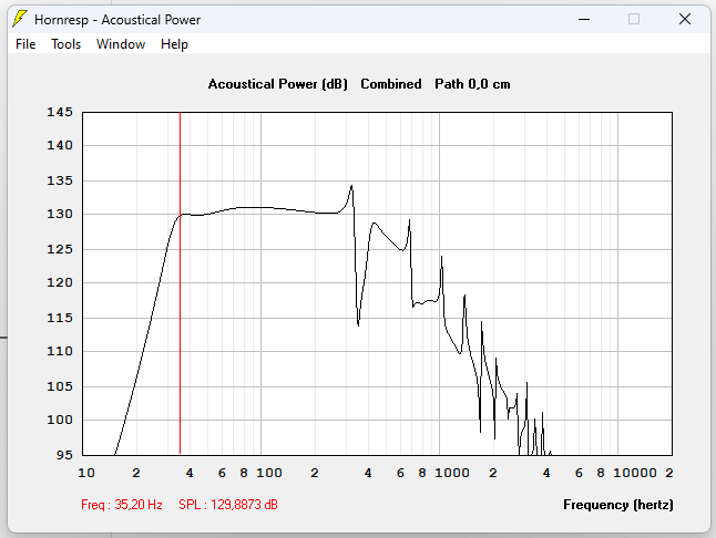

After applying a 150Hz 4th order low pass you get this:
You get slightly more breathing space for your tops than if you choose another type of design.

Two of those boxes, so 4 drivers in total, gets you just over 131dB/30Hz:

Sorry about all the editing, just wanted to show the power per driver after applying active filters:
