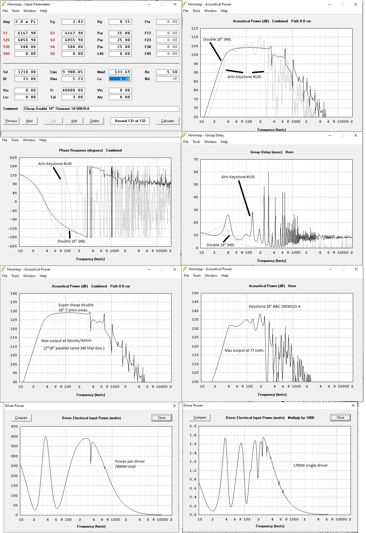

If you have two individual boxes, the failure might bring effect only in the max SPL. Take a look in the attached project. Two boxes combined into a single box, but they work individually. They will be heavier to transport, but you save some woods to build them.

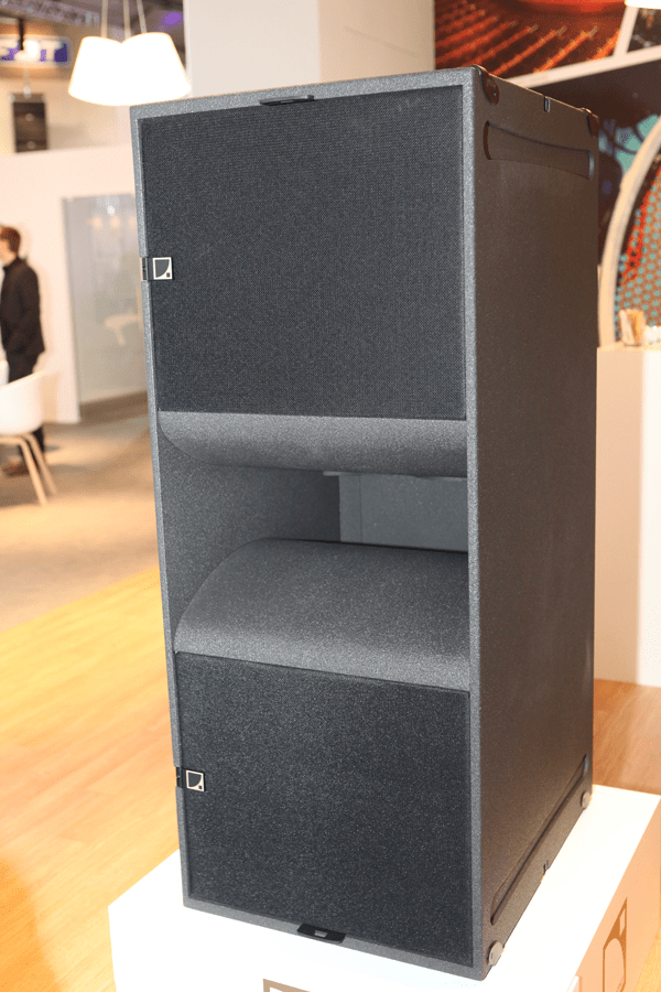

I get how individual boxes behave, the design you posted are 2 cabinets sharing a side so practically is like having 2 single 18's next to each other ,but how do you input in hornesp a dual reflex cab sharing the same chamber for both drivers. See the attached pic that I took YouTuber Mr.Flexy .
